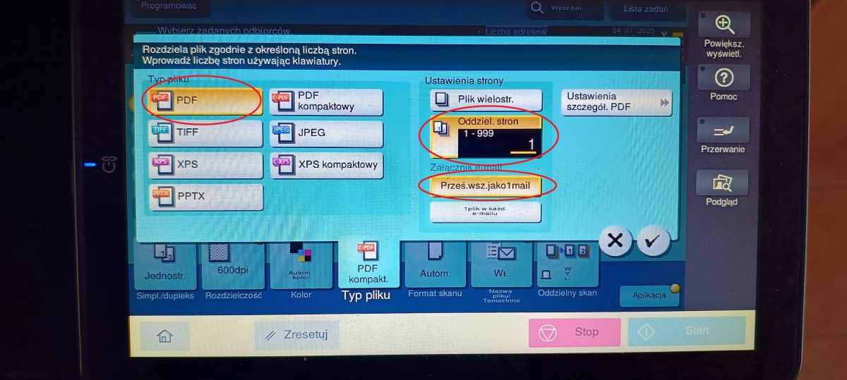

  • Scan feeder output split into separate PDFs
    #9 21615509
    Gregorius000
    Posts: 6
    Gentlemen and ladies, I have found an effective solution to the problem mentioned at the beginning of this post, namely how to scan a file of sheets of paper inserted into the scanner feeder and have each scan sent to an email in a separate PDF file. Although we use a KM C250i at work, the procedure will be similar to the others.
    I have marked everything in the picture, but I will still describe everything. We have to go to "File type", where the default setting is "PDF Compact". The last thing to do is to select "Send all files as one e-mail" so that all files are sent in one e-mail, unless you want each file sent in a separate e-mail, in which case select the option below "1 file in each e-mail".
    Interesting fact:
    If you want it to create PDFs with several pages if you have a large packet of cards to scan, then enter the number of pages you are interested in in the "Output of pages" box.
    Example:
    We have 30 sheets of paper to scan, but we want it to create PDFs with 5 scans, i.e. the scanner will scan all 30 pages, but it will divide them into 6 PDFs and in each one 5 more pages from the entire 30-page pack will be scanned.
    Scanner settings screen with PDF selected, page separation set to 1, and email option enabled.
