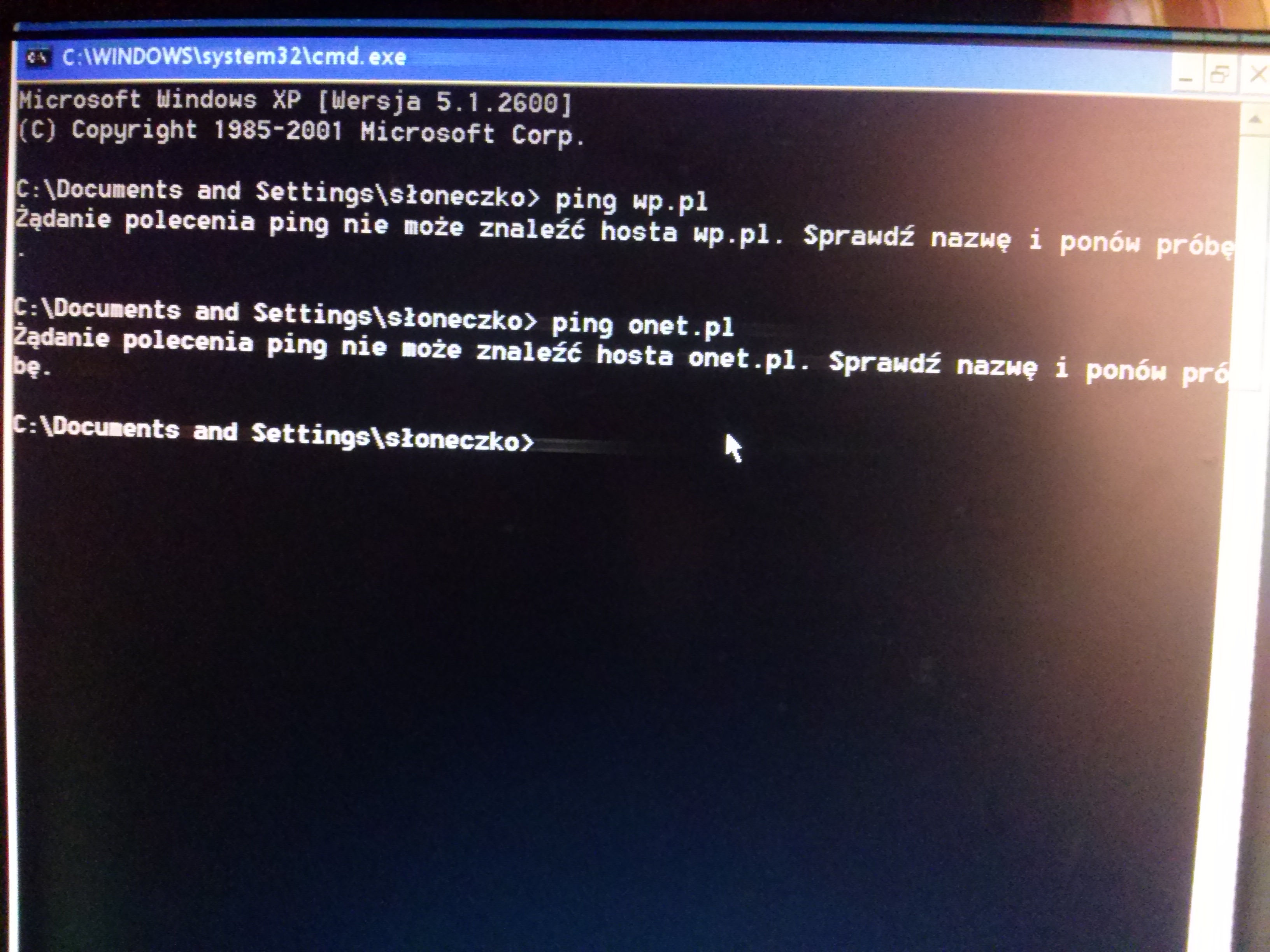

    Check also:
    ping wp.pl
    ping onet.pl
    e.t.c...
    Nslookup FINALLY returned SOME correct answer.

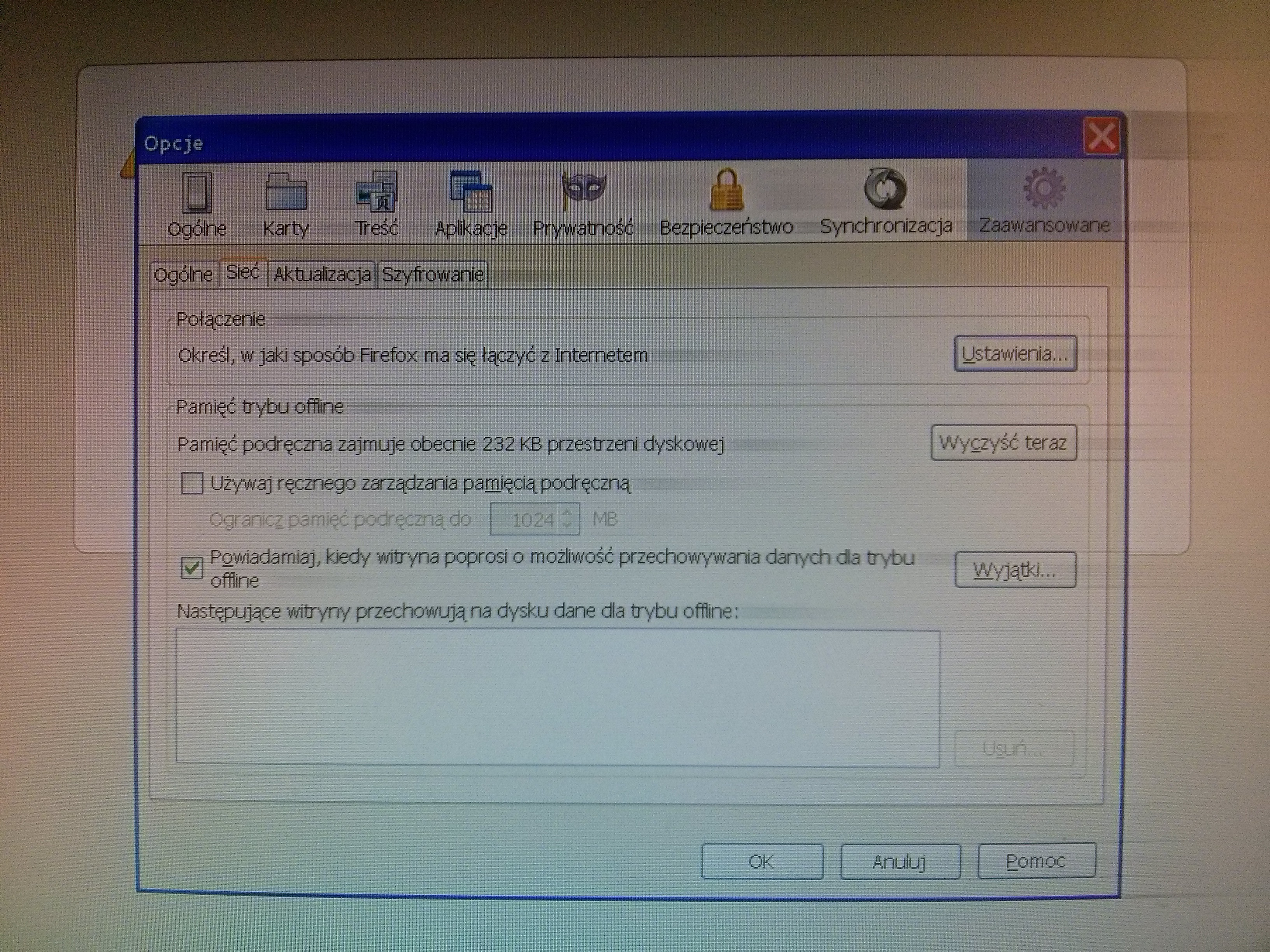

    Check how your web browser is set up (browser connection to the web).
    In IE this is Tools-> Internet Options-> Connections
    In Firefox Tools -> Options -> Advanced-> Network

    This is a picture from firefox:
    Windows XP – network connects, but no internet in browser, what to check?

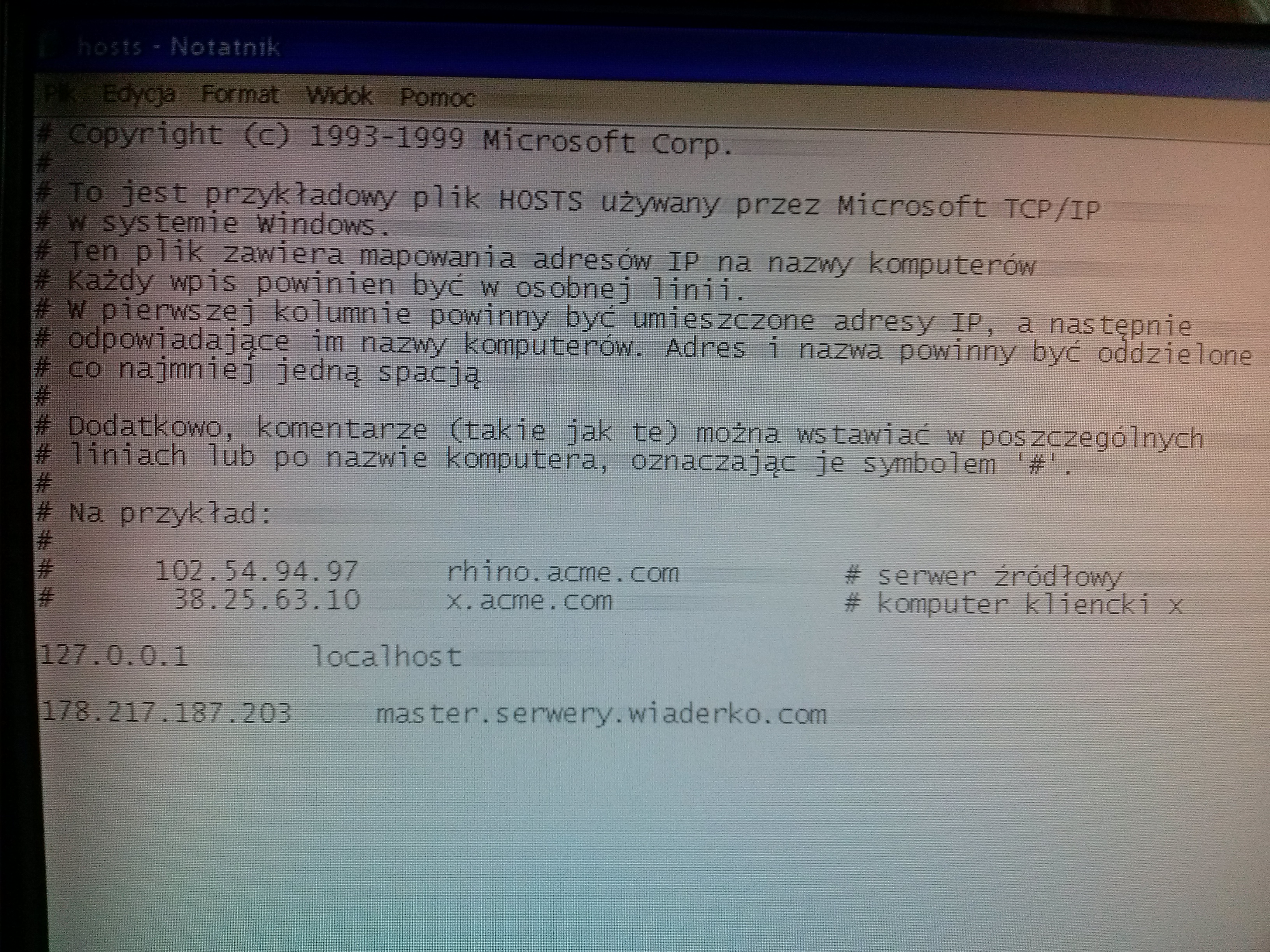

    1. How many network connections do you have on your computer?
    2. What is the contents of your HOST file (C: \ Windows \ System32 \ Drivers \ etc \ hosts)?
    3. Is your Firewall / Antivirus blocking these sites for you?
    4. What do the commands: ping 212.77.100.101 and ping 213.180.141.140 do?
    In Firefox, click on settings and select "no proxy".
  • #34 13876948
    BlackArrow
    Posts: 21
    Rate: 24
    1. I have one "Local Area Connection".
    2. The content of the host file shown in the picture: Windows XP – network connects, but no internet in browser, what to check?

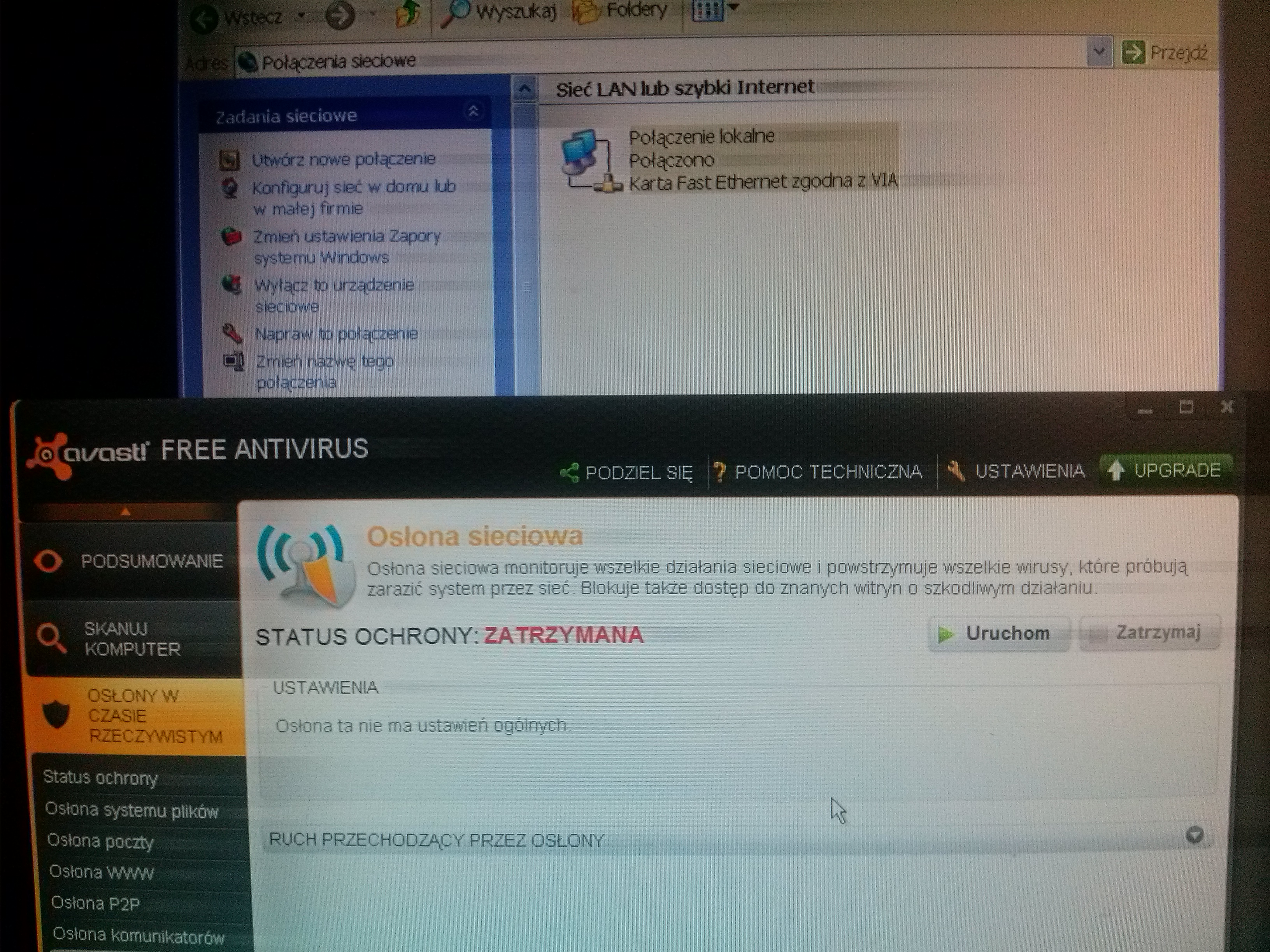

    3. The firewall is turned off and the antivirus is rather too (screen): Windows XP – network connects, but no internet in browser, what to check?
    4. The result of the commands (screen):
    I chose "without a proxy" but it still doesn't work :(
  • #35 13877239
    hermes-80
    Posts: 12014
    Help: 1177
    Rate: 743
    Uninstall Discover

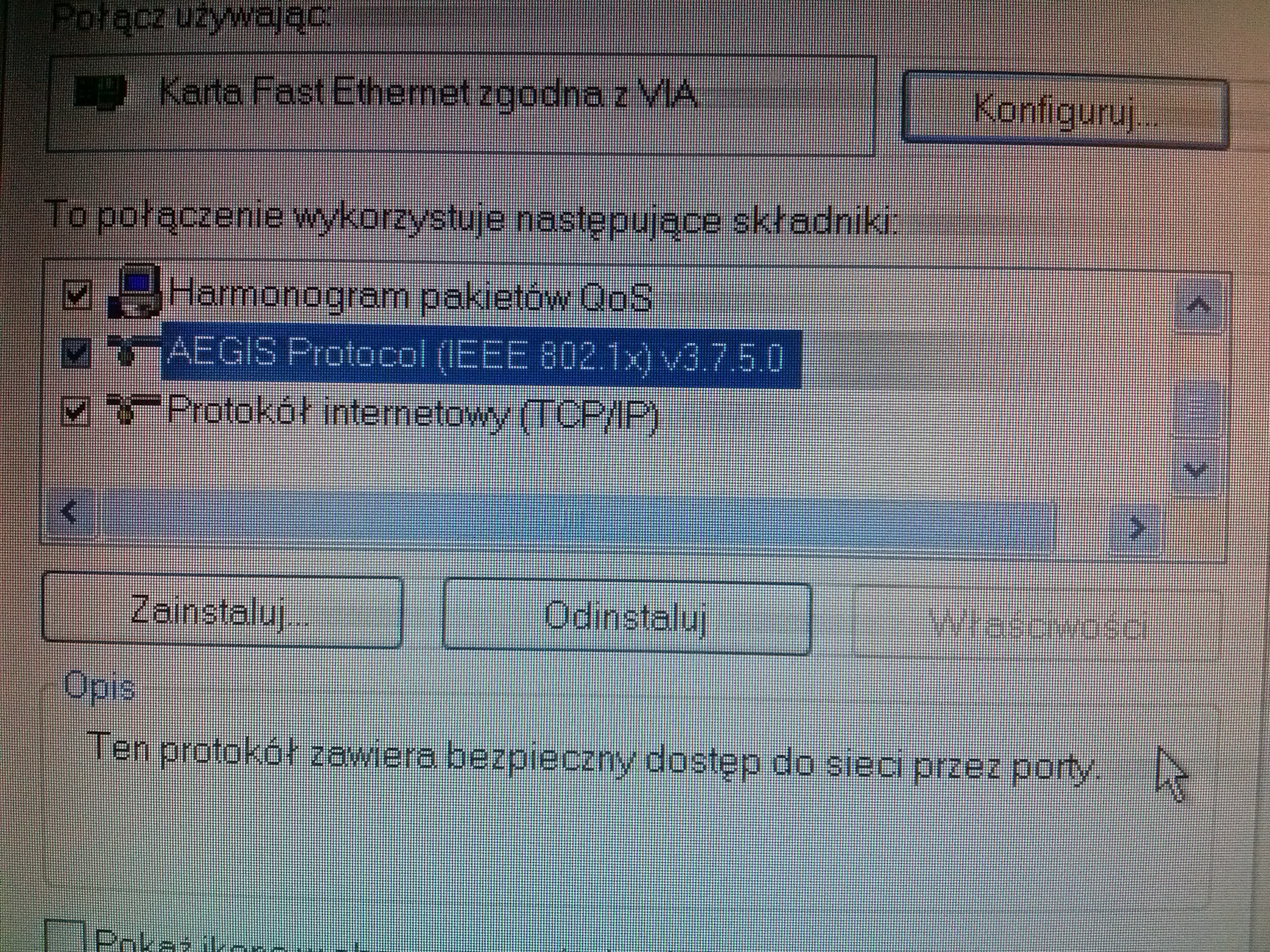

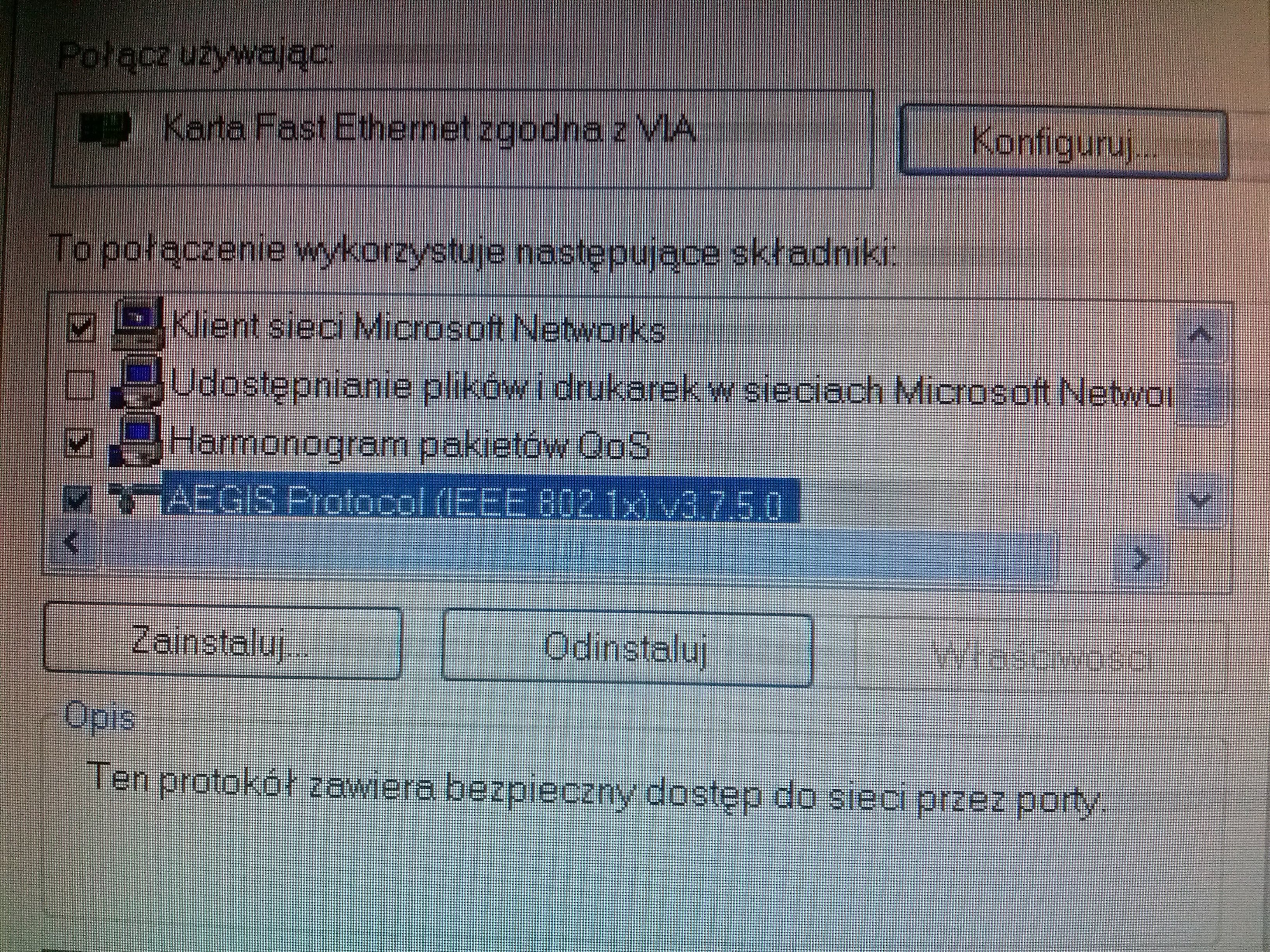

    And I have 5 ingredients:
  • #38 13877368
    xE5150
    Level 25  
    Posts: 789
    Help: 56
    Rate: 82
    Disable AEGIS Protocol and restart the system.
    All you have to do is mark a checkmark next to it and accept the changes.
    Check if it will work.
