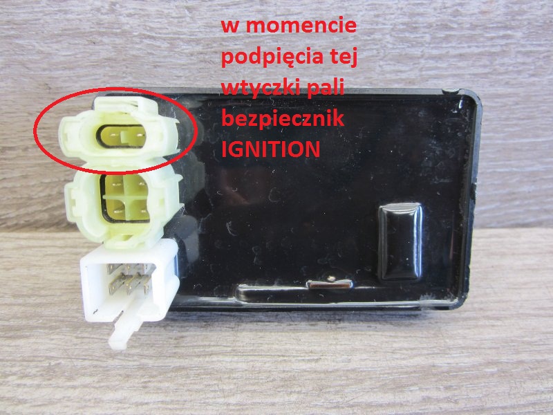

    I warmly welcome. I have a problem with the ignition module in the TGB Blade 425 quad. I need a pin header in this module. The moment I plug in a two-pin plug, it burns the IGNITION fuse. Anyone have any idea for this? In the store they told me that there is no way that the ignition module would burn a fuse.

    According to the diagram (at the end of the service) it appears that there is a DC-CDI ignition installed, so there is a high probability that the module is damaged (short circuit) and blows fuse, unless you try to connect a regular AC-CDI module from a typical (Chinese) scooter.
    I did not browse the entire service, pinout can be given in the chapter with the electrician, only that with the replacement of this module can be a problem. It's best if you ask the importer.

    Hey. Generally, I thought to apply a module from the Chinese quad because the pins are on the electrode, I'm afraid not to burn something else.
    TGB Blade 425 Quad: Ignition Module Fuse Burnout Issue with Two-Pin Plug
    Generally there are three plugins in this module. I just read that after unplugging the last 6-pin plug, it will work in such a way as if the electronic block was removed so I think about using some such module with regulation. What do you think?

    It is unlikely to fit a Chinese quad - AC-CDI types are usually used there.
    I advise you to buy the original from TGB.
    Substitutes are hard to recommend, because it is Chinese shit or too expensive.
