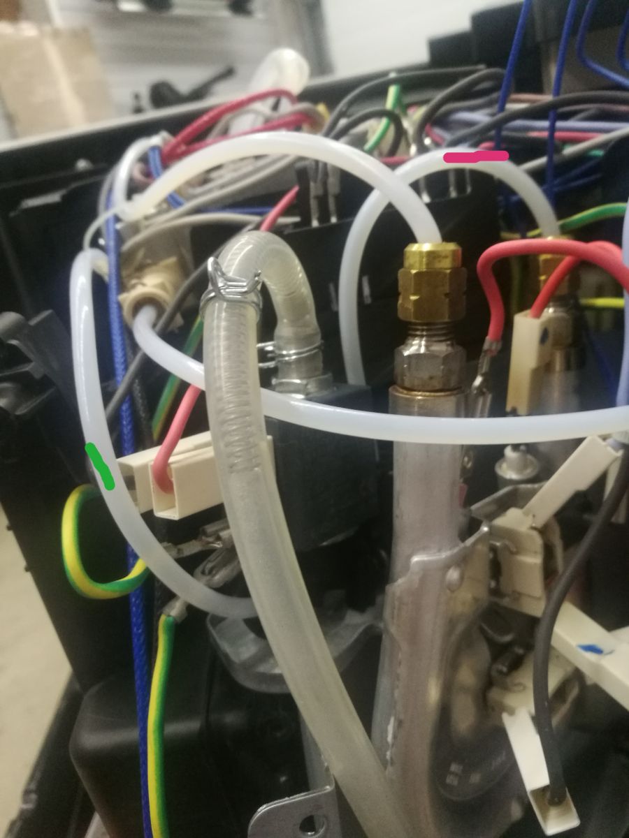

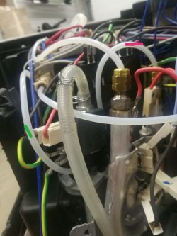

    Hi everyone, after a year of fighting the problem, I give up and post my problem on the forum. My model is EBC54524ax and I've been fighting the message "ground coffee too fine" for over a year. All the repairs so far have only helped for a while. First there was the flow meter, after replacing it, it was about 3 months. Later I cleaned the thermoblock, it was ok for about a month. In addition to not making coffee, rinsing in the grounds container does not work, wet slush collects. Until now, it helped to simply turn on the rinse several times, until something unlocked and worked for a week, two, sometimes longer. After the last time, I decided to replace the thermoblock and it was for good, i.e. I managed to unlock something by running the rinse several times, but after a maximum of 2 coffees it stopped. I decided to check if something was clogged in the system. In this way, I unhooked the thin hoses starting from the pump and started rinsing. I got to the solenoid valve at the back of the device that discharges the steam. When rinsing and disconnecting the hose in front of the valve, water flows, and when unscrewing the hose in front of the heater, the water does not flow anymore. However, I have doubts, because it is a foaming solenoid valve and is this a good clue, should the water pass through the heater when rinsing the system? In the photo, the hose is too green, from which water flows when rinsing, and the pink hose is behind the solenoid valve, where water no longer flows. I undressed this solenoid valve today, I blew it, but the coil is still ticking at the beginning.

    piomiki
    Check the hoses if they are not clamped by conical rings - these 10 mm nuts are too tight.
  • Pump wear likely caused the fine-ground error
    #53 20652524
    gustdelf
    Posts: 40
    As a colleague wrote above, the pump was to blame. Probably earlier repairs, removing deposits, cleaning all sorts of sieves, etc., made it lighter and worked for some time, besides, the ball that is there after time is broken and wedged. I found a description on the net of how such a pump behaves after use, if the pump pressure drops from the nominal one, etc. But to diagnose it, a special pressure gauge would be needed. Anyway, it works great now.
