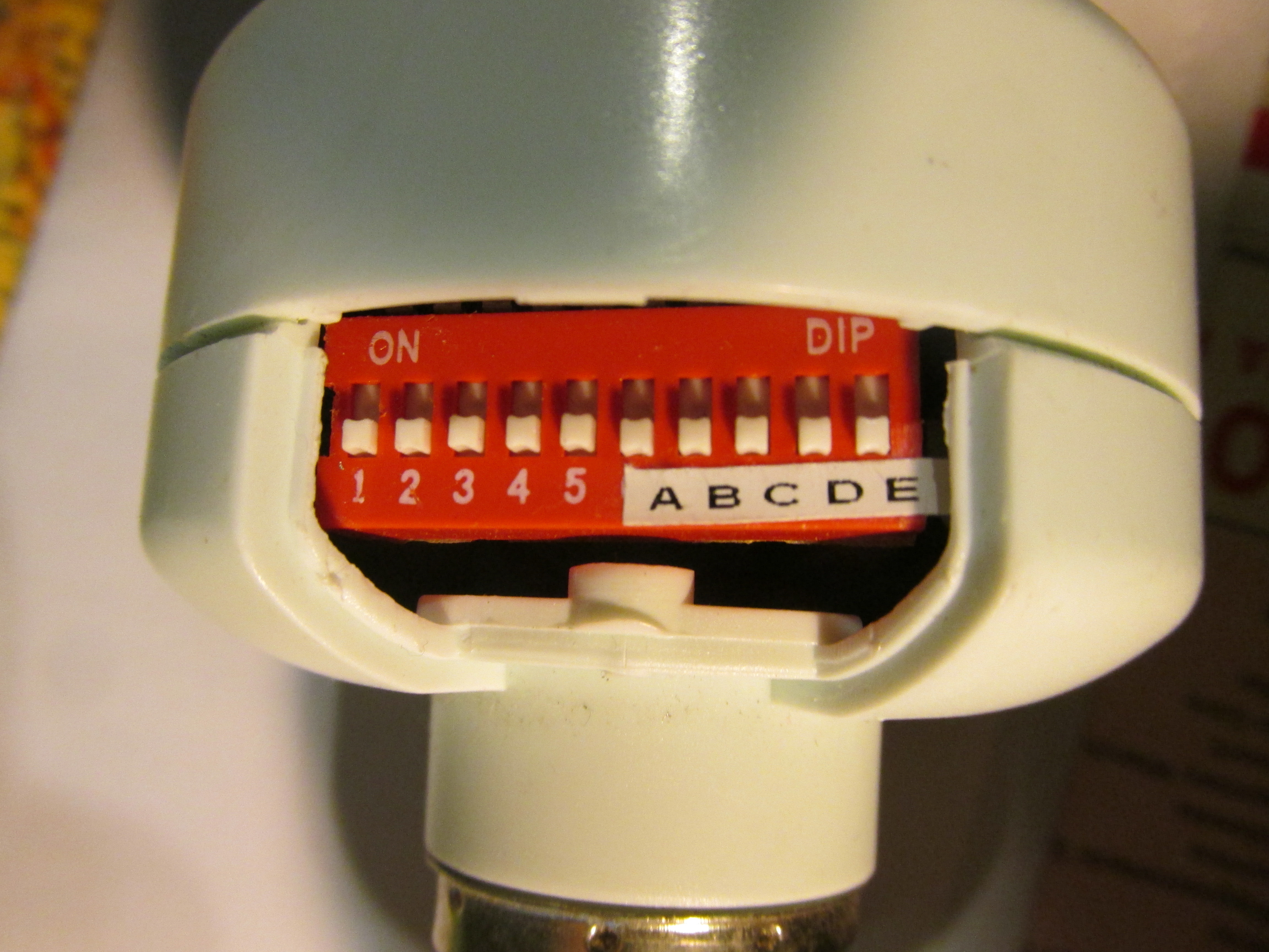

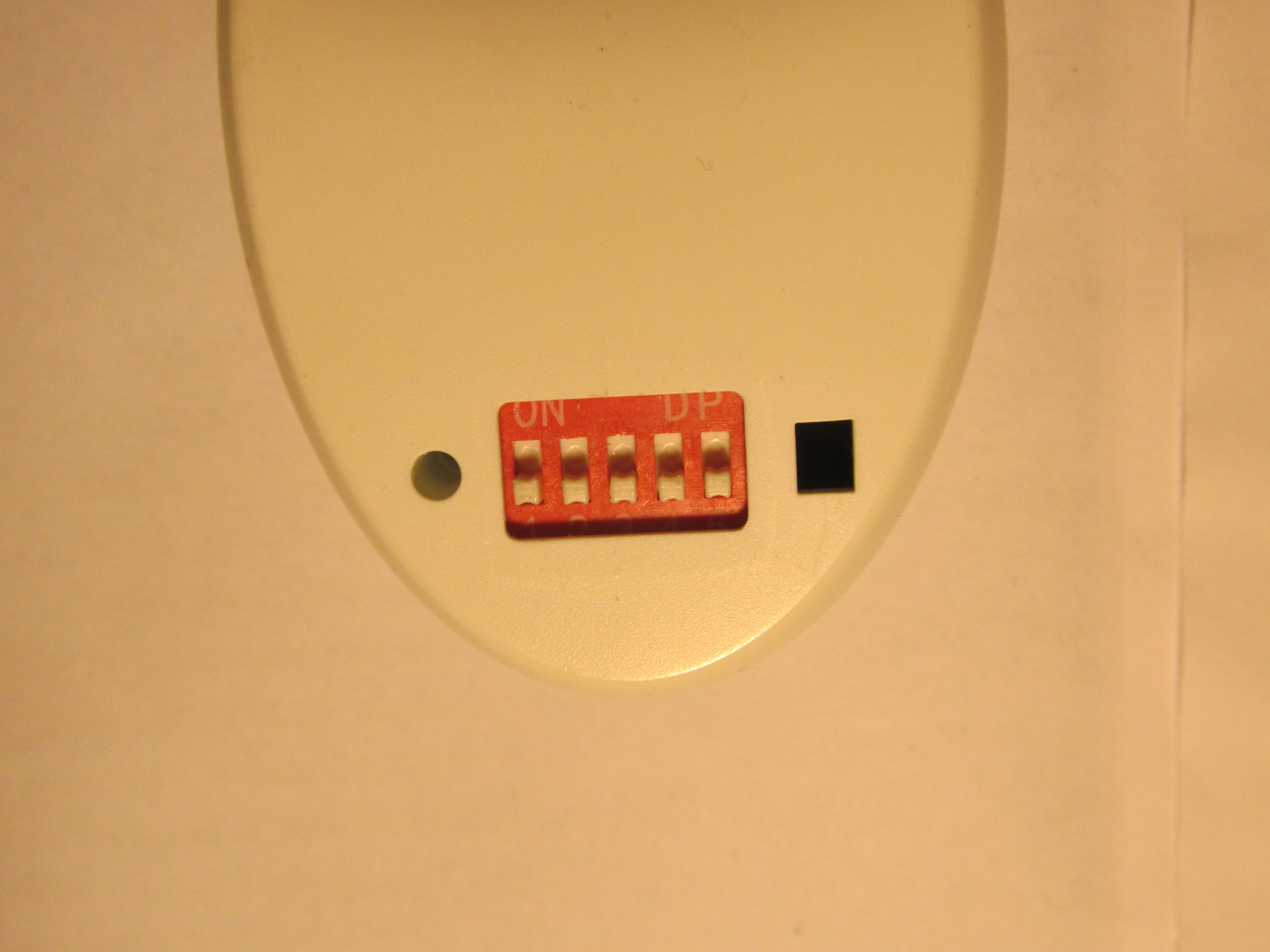

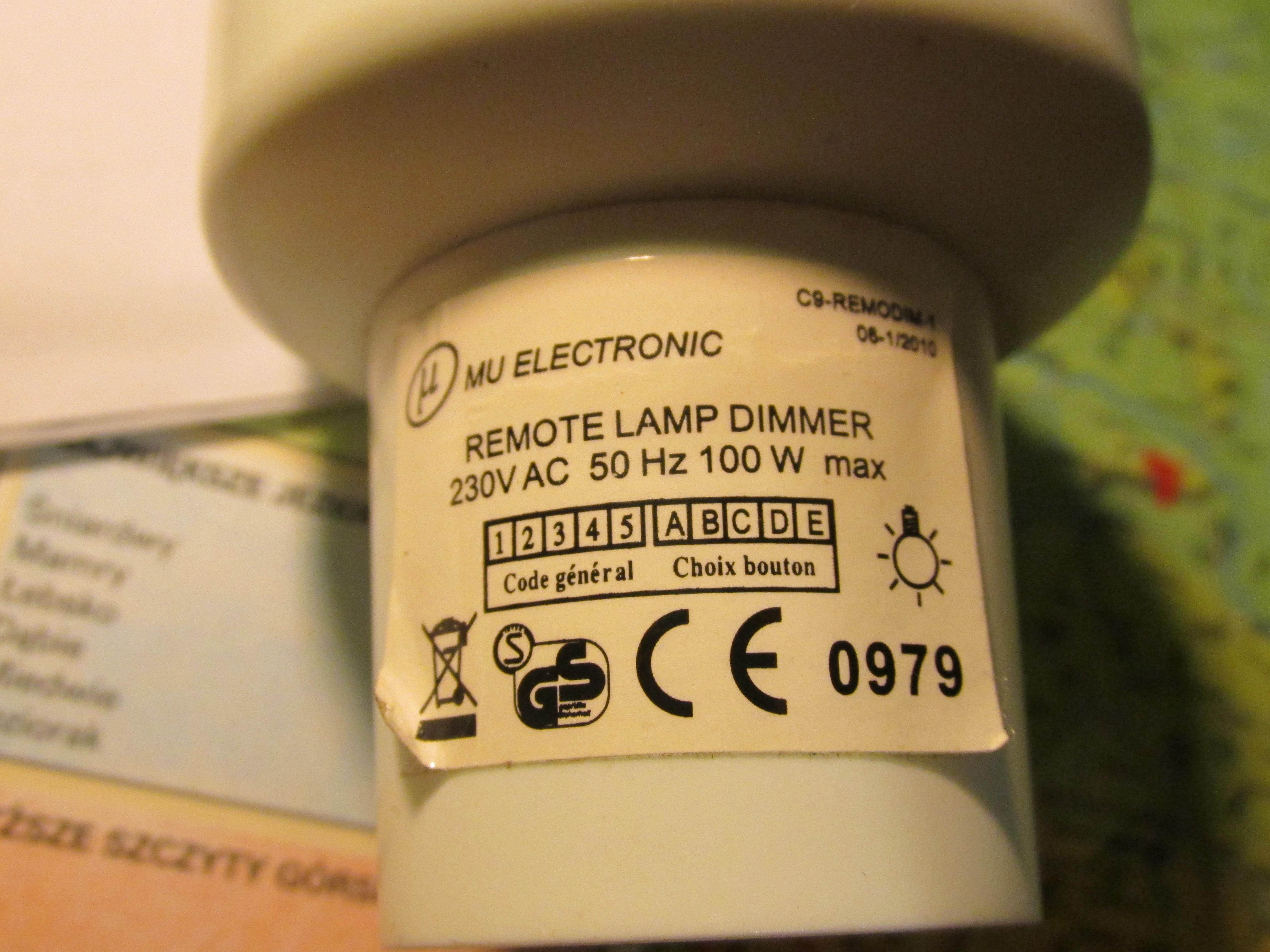

    Hello !
    I have a remote light switch. You screw a bulb into it and mount it in the lamp. The light is switched on by remote control. I have a problem with it because it's decoded (it used to work but through stupidity I started messing with it and now it's impossible to turn the light off and on) I need an explanation of how to arrange these switches on the remote and the receiver. I've tried so on logic (1 of 1, 4 of 4 etc) but it doesn't work for me.
    • Remote Lamp Dimmer: how do I match DIP switches on remote and receiver? IMG_2739.JPG (3.12 MB) You must be logged in to download this attachment.
    • Remote Lamp Dimmer: how do I match DIP switches on remote and receiver? IMG_2737.JPG (3.06 MB) You must be logged in to download this attachment.
    • Remote Lamp Dimmer: how do I match DIP switches on remote and receiver? IMG_2738.JPG (2.82 MB) You must be logged in to download this attachment.

    spinacz
    Level 42  
    Posts: 8575
    Help: 1204
    Rate: 2651
    Raise 1,2,3,4,5 in the receiver as you have raised them in the remote control and additionally raise A. If this does not work then A down and B up and so on until you find the right configuration.
