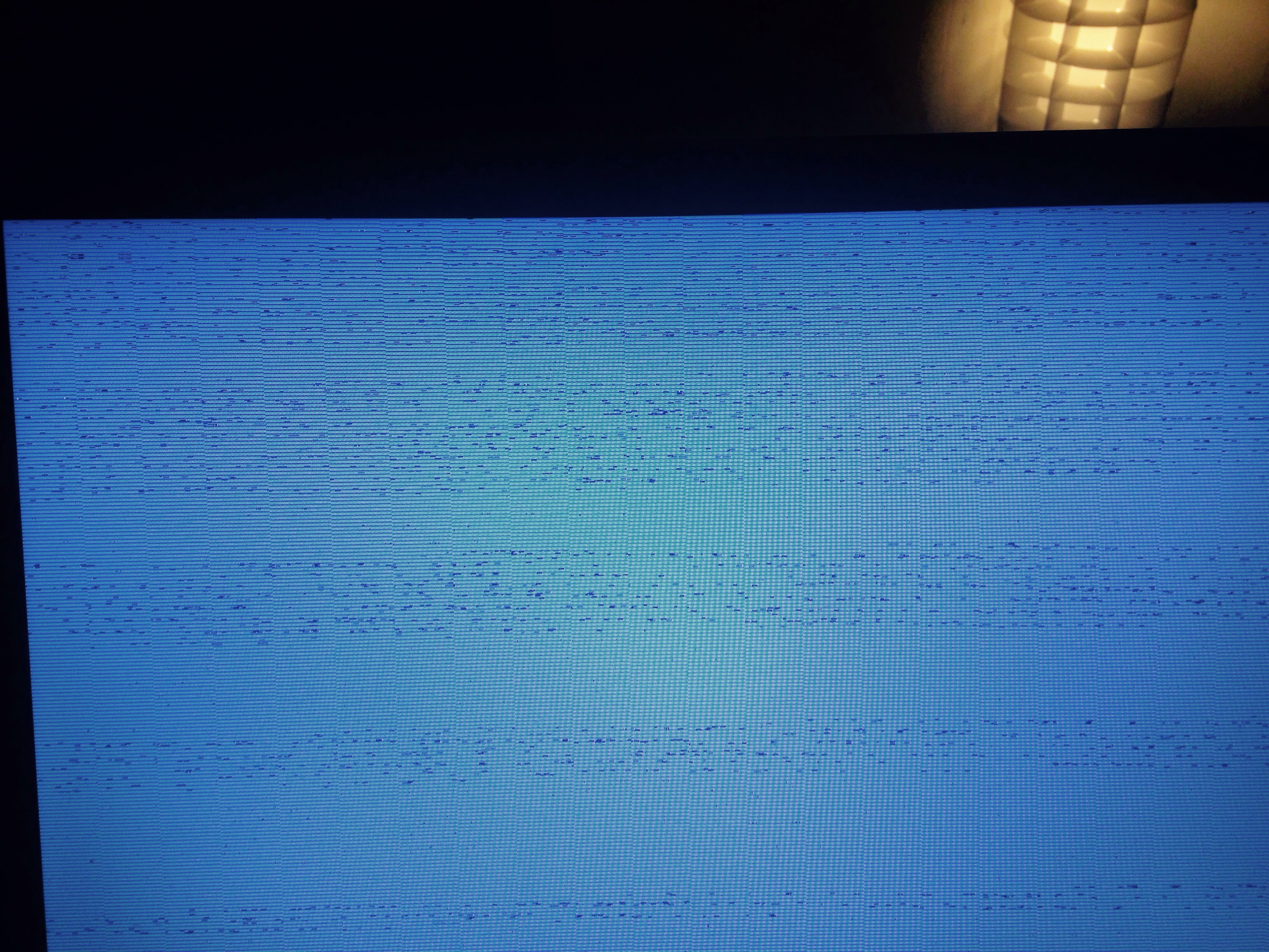

    Hi,
    Can you advise whether it is worth repairing my laptop or how much may it cost ...?
    I am the owner of a Mac book Pro (apple), which is only 3.5 years old.
    For some time now strange things have started to happen with him ....

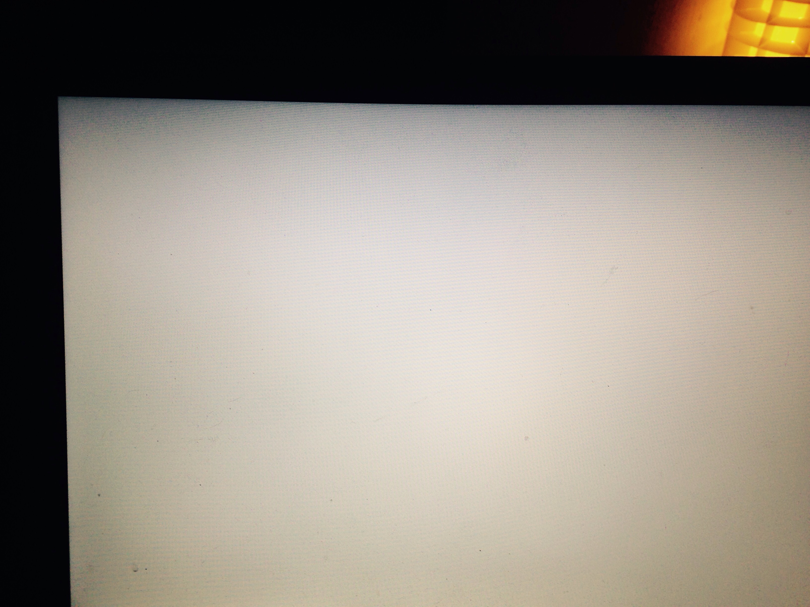

    The computer "freezes" and overheats from the bottom many times a day.
    After a few minutes of break, it restarts it by simultaneously pressing the D + start button. Then stripes and stripes appear on the screen: dashed, horizontal (previously there were vertical stripes), sometimes the screen is blank.
    Everything works fine after this self-repair, until I use pages, keynote, imovie, sometimes skype.
    Thanks for your valuable advice
    PS unfortunately I don't have Polish letters.
    Edyta

    Probably the cause is too high temperatures on the integrated graphics chip in the processor (Intel HD 4000). The GPU, overheating, displays artifacts on the screen. It would be useful to maintain the cooling system.

    Many thanks to everyone, and especially to Argennto for the hints, so far it has helped, best regards. Edyta

    Apple service replaced the graphics disc for free, due to the fact that it was a production error :-) . Now the computer works great.

    Yes, it was due to a manufacturing error. I found information on the Internet that all laptops from this production line (I was in the norm) are subject to free replacement or repair. Then I reported to the Apple service and they fixed it :-)
