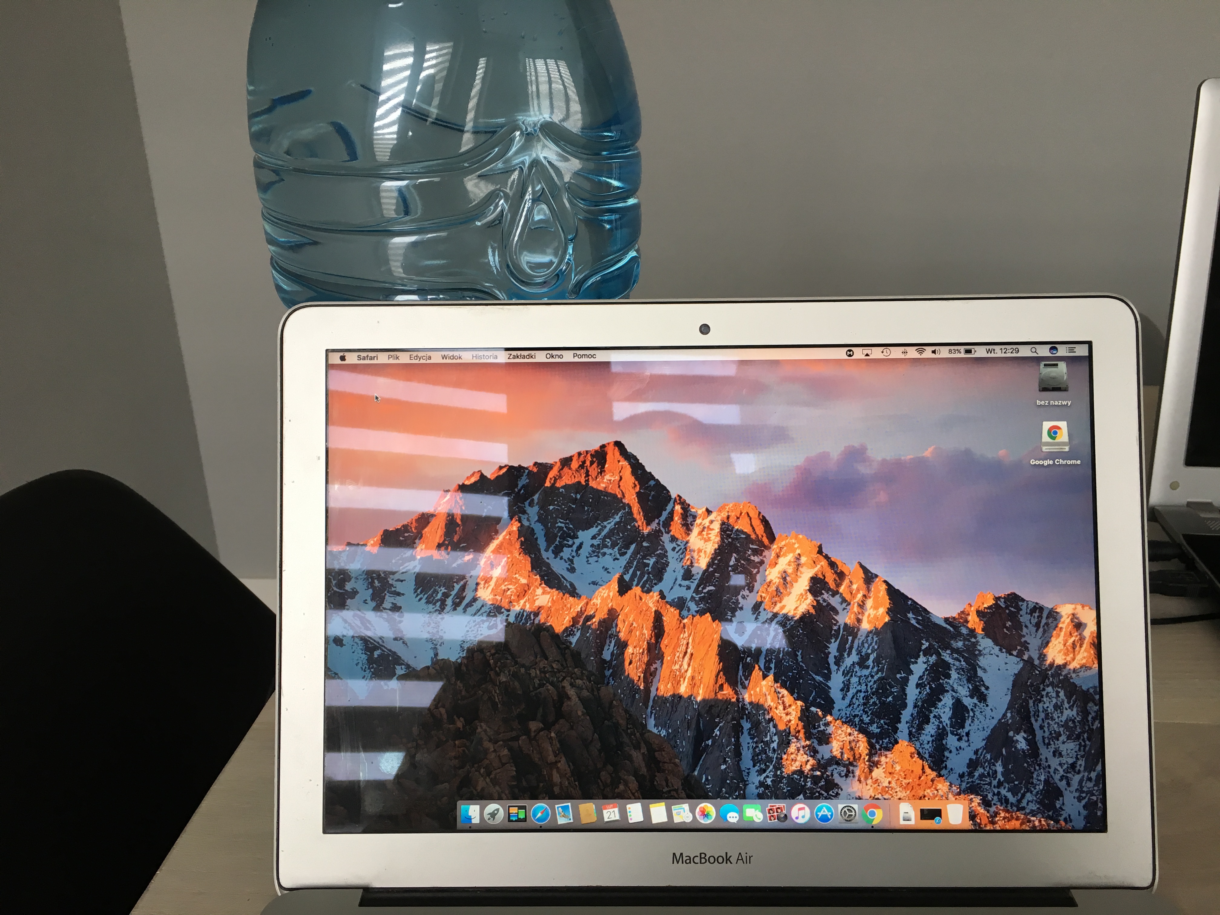

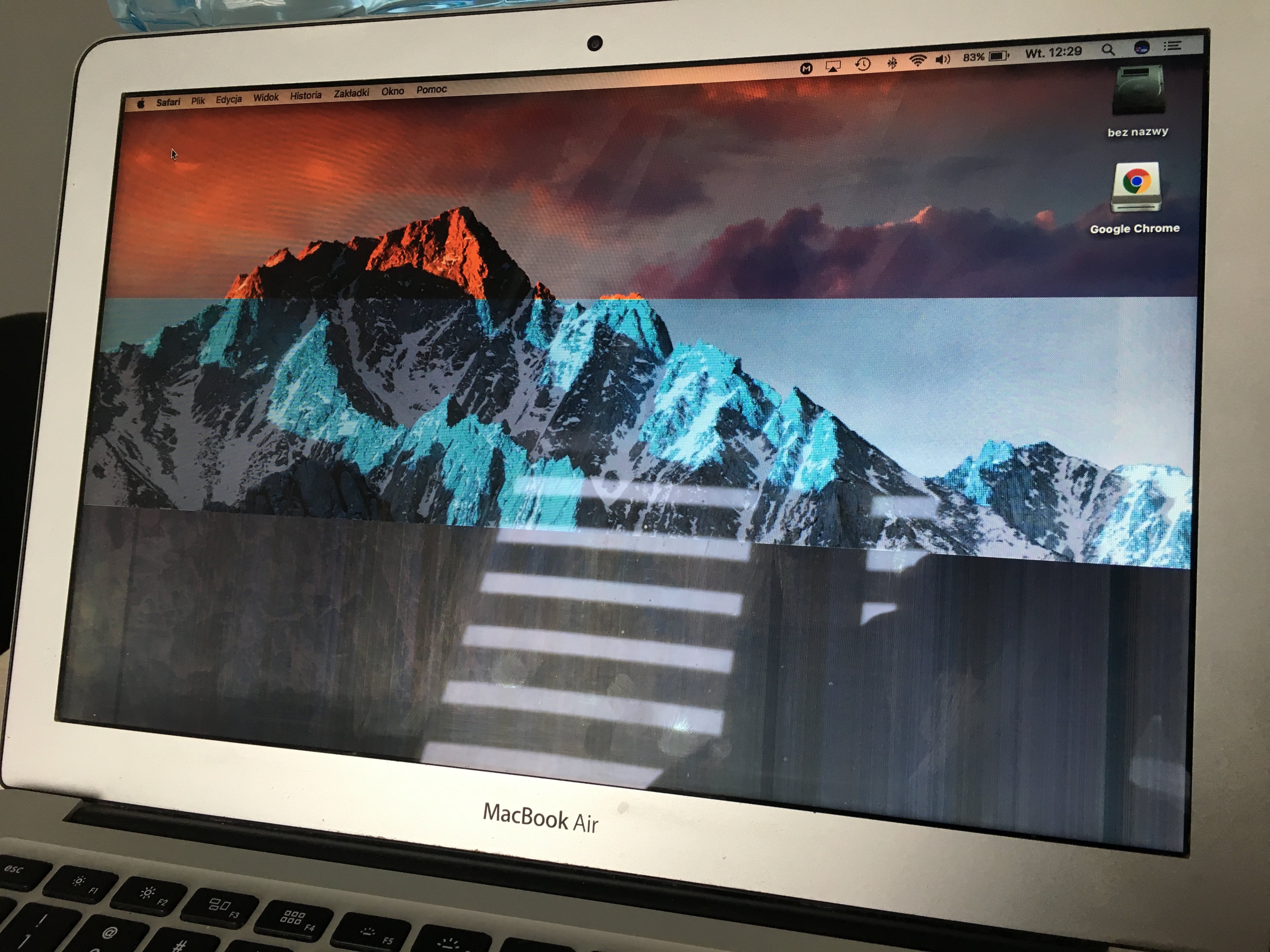

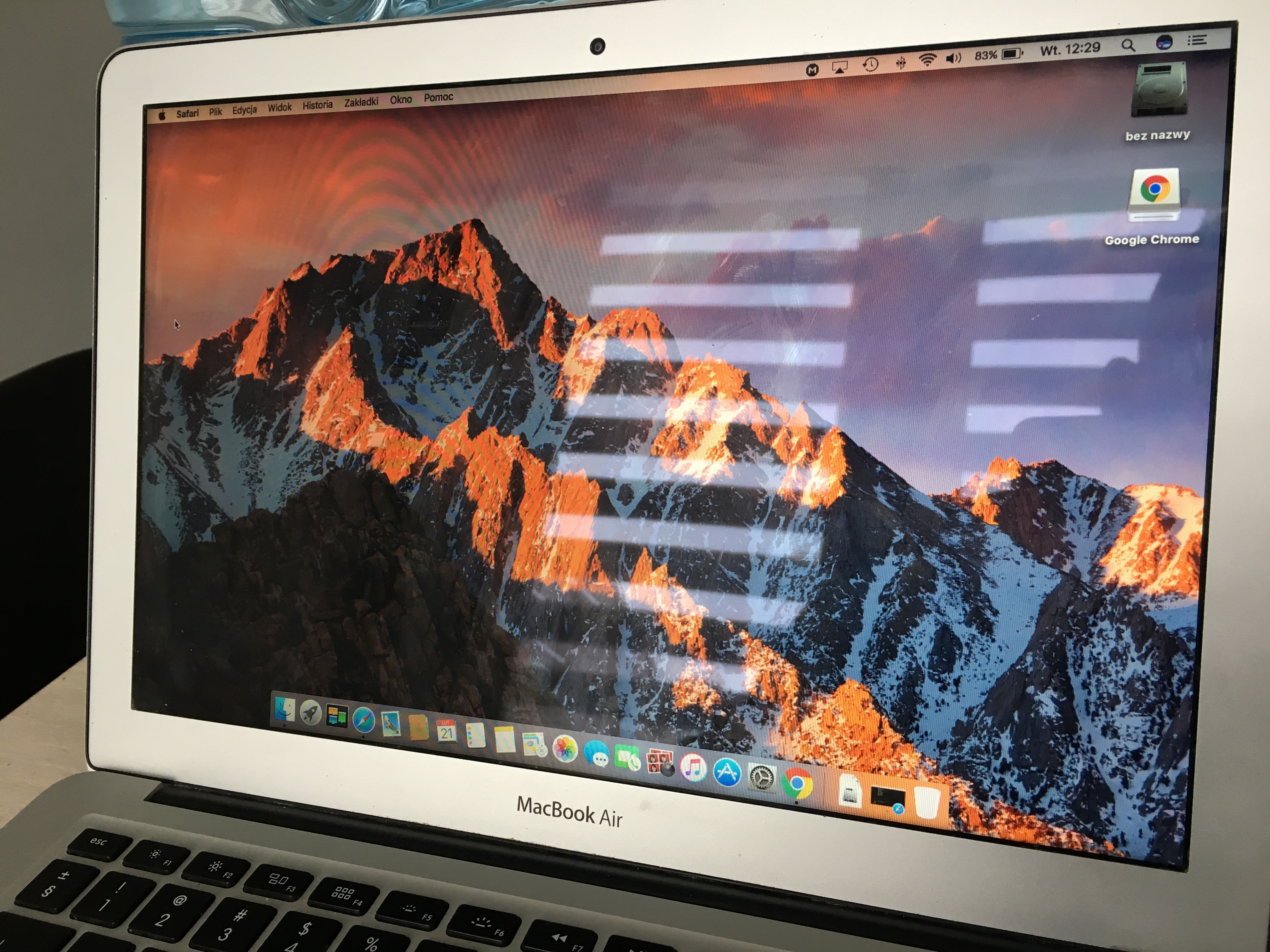

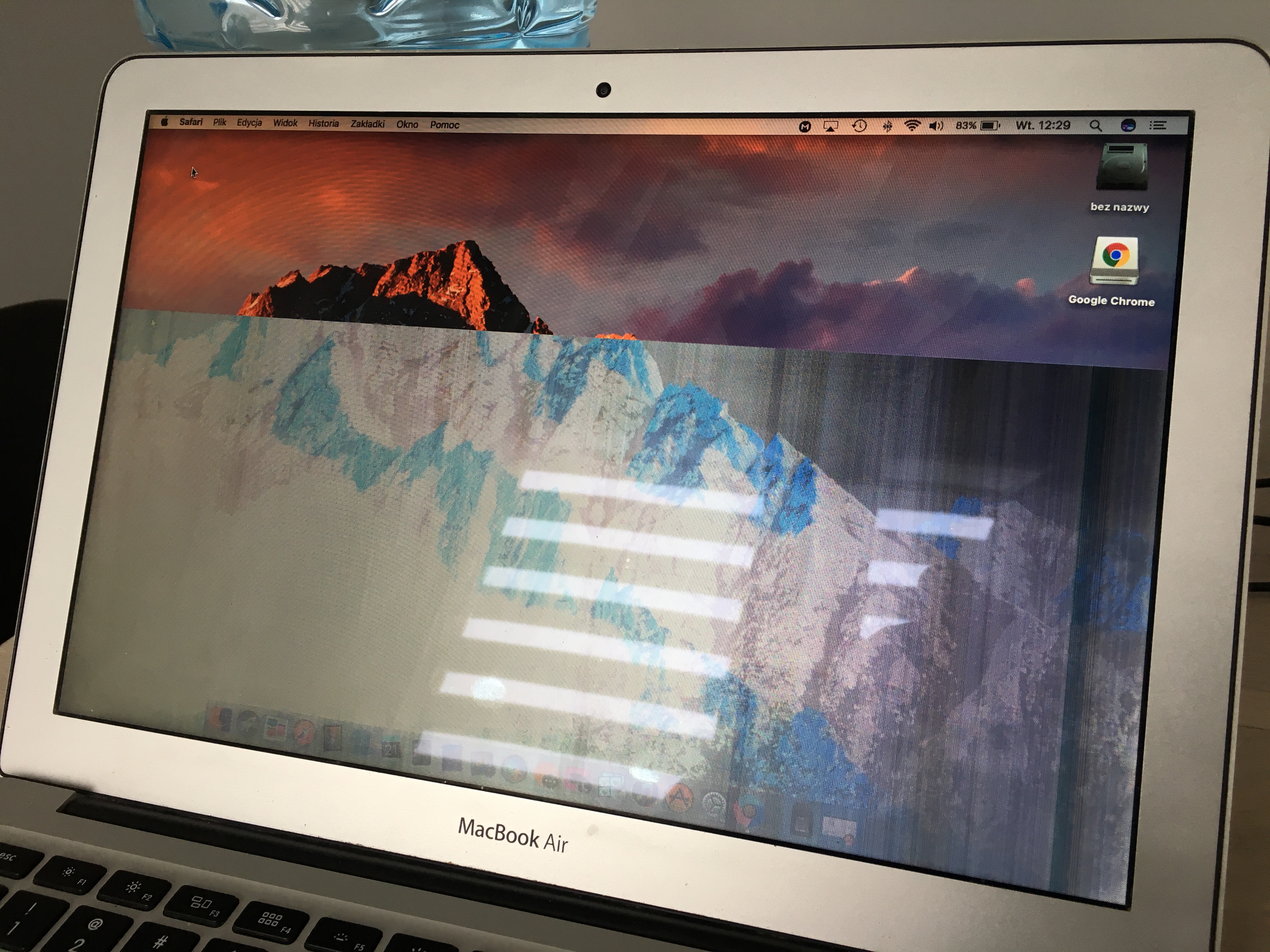

    I am attaching photos so that you can see what it is about.
    When the prompt is based on something, in this case, the cylinder works fine, but when I want to move the monitor up-down or take it out of my back, stripes appear like in the pictures.
    Maybe someone met with this, is it a tape or a monitor to be replaced? Macbook Air i5 2012 - stripes on the screen, tape fault or more screen? Macbook Air i5 2012 - stripes on the screen, tape fault or more screen?

    For verification purposes, please check on the external screen.

    I also bet the tape is damaged, but it still needs to be verified by connecting an external screen.

    If you bend the matrix flap holding its upper corners with both hands and there are changes in the displayed image, the matrix needs to be replaced.

    Matrix of scratch, its failure estimated at 90%.

    yes, everything is correct as you described. all you have to do is touch the back of the screen with your hand on the left side from the back and it's all right. I wonder if when I take out the matrix and stick it, for example, with a little tape on this side, or if something helps - I know, I know the makeshift ...

    When replacing the matrix in this laptop, it consists in leaving the backlight (all films, reflectors and diffusers) and replacing the "glass" itself. The procedure is not too complicated, but you should pay attention when folding that nothing gets caught between the backlight and the matrix. Or the entire cover with the matrix and then the purchase cost is huge for a Mac.
