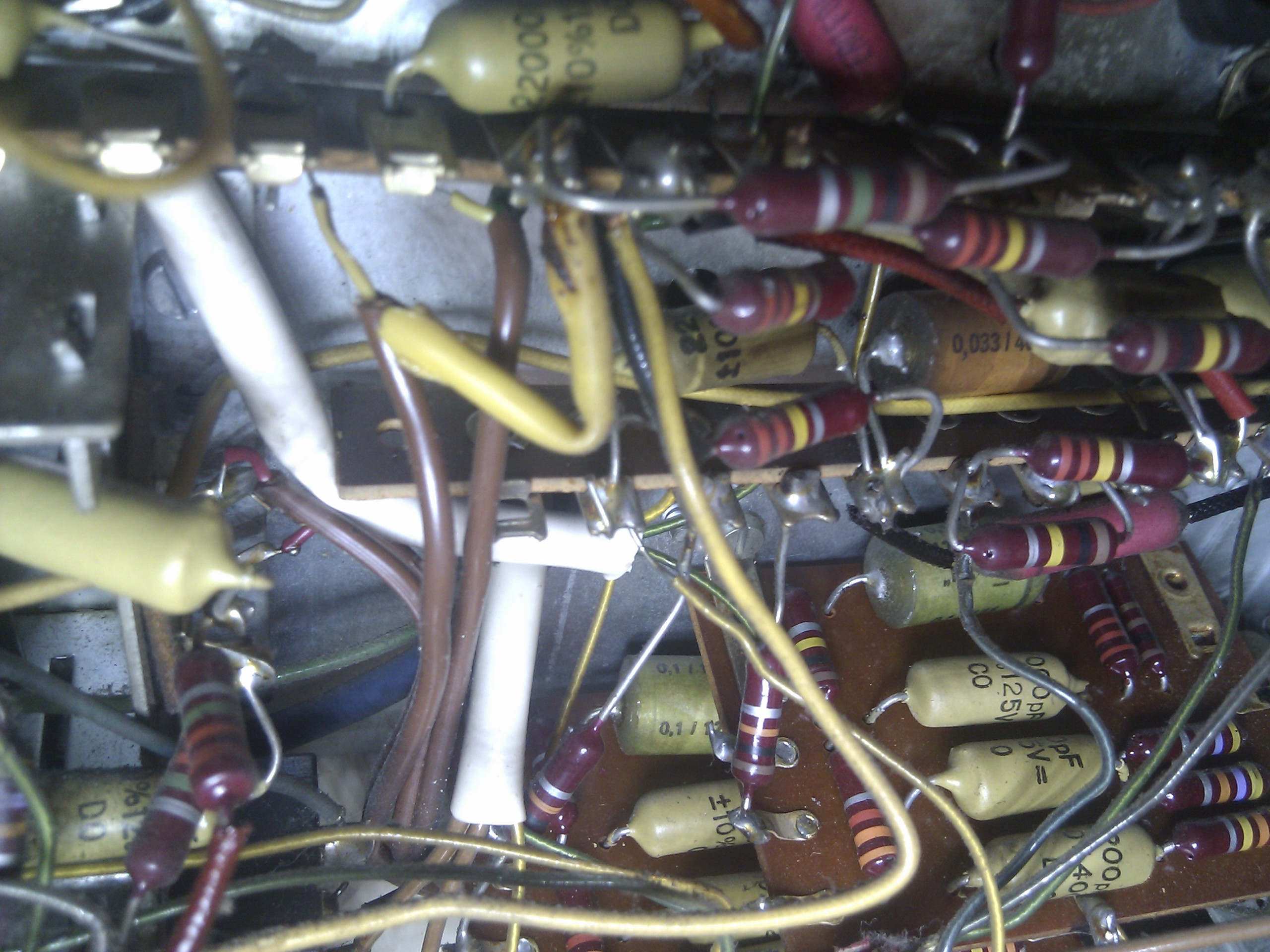

    Two EL84 lamps overheat in my radio.
    Capacitors on the radio all, none is bulged or poured,
    radio cleared from dust
    The sound is clear and loud, only minimal background noise can be heard, but I think it results from the antenna, lack of good setup or age of capacitors.
    I do not know exactly the temperature of the tubes, but after about two minutes of playing the tubes quite heavily in their hands in their half
    I will also add that the left lamp glows slightly more than the right one
    The rest of the lamps is not too hot, hence my fears.
    I have marked the lamps on the photograph.

    Measure the voltage on the 3 lamp legs. The voltage should be the same in both lamps. During the work, the lamps heat up, as a colleague wrote, more than 200 degrees and the working time at this temperature is unlimited. Do not just close the ventilation openings on the back cover.

    You categorically do not recommend changing all capacitors, you will waste the radio. Only electrolyte capacitors can be replaced.

    Regeneration of capacitors takes place with the voltage on them. 3-5 days turn on the radio for 2-4 hours and you will be regenerating. But, I think, electrolytes, capacitors will not help much. The radio has many years and electrolyte capacitors may have lost some of the capacity. I can not see electrolyte capacitors on your picture, I think they are down or their transformer closes.

    Capacitors of constant capacity, with the exception of electrolytes, should not be replaced. Categorically it is not recommended to replace capacitors, which are used in the input, heterodynach contours and filters of the intermediate frequency - it will trigger the transformation of their frequency. Such capacitors are changed only with a 100 percent guarantee that they are inefficient. Each capacitor has its capacity (tolerance). After replacing the capacitors, the coils should be tuned to the appropriate frequency, and the generator is needed for this. An unskilled capacitor (pierced or which has a leak) always violates the regime of this cascade, where it is used. And a good capacitor does not make sense. I want to please you - these capacitors will protect the normal functioning of the radio receiver not for more than a decade.

    Yes, but without changing the two paper coupling capacitors, you can usually assume that the EL84 will fall quite quickly.
    Though they may have been better than the 1960s, there would be a photo from the bottom of the chassis ...

    A colleague, piotrekjjj Relatively two paper coupling capacitors. The removal of these capacitors in the twinkling of an eye will affect the regime of the output tubes and change the sound quality (at the end) or quite move this regime (when puncturing)), which will not be noticed impossibly. Even a modern capacitor can get injured who can guarantee its ideal. I reanimated radios 30 years of the last century, where paper capacitors were used. They were all working. And he often exchanged capacitors for 80-90 years. Which element will fall and which time even Gypsy will not guess.

    Here are photos of the lower chassis.
    I can not make any better photos.

    Mate, Nitro 36! I do not know what experience you have in resuscitating tube radios. I'm sorry, but I want to recommend you this method - never change 1 item for 1 time. Replaced the item - check the radio. If you change all the elements for 1 time, turn on the radio, and it does not work, the search for damage will be very heavy.

    If there is a brum at the minimum volume, this only confirms what the electrolytic capacitors of the anode voltage rectifier filter should be replaced. If the brum can not be heard from a distance of 0.5-1 meter, capacitors may not be interchanged. At maximum volume, even without the antenna, you should hear noise on all diapazons. He's hot if there's no hype.
