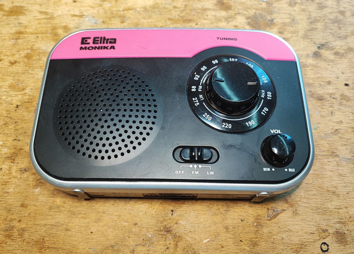

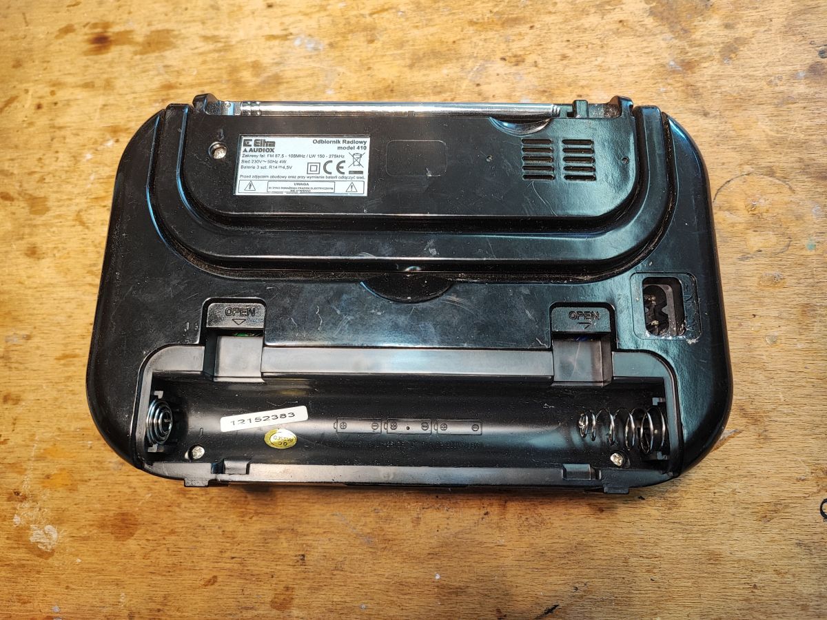

    I've already shown some older radio receivers, so this time it's time for something more contemporary. Here's a simple budget allotment from Eltra, a portable radio receiver with a long wave and UKF range. Powered by 230V or three LR14 batteries, plus offering a 3.5mm jack headphone socket. I got the equipment from a friend who heard that I like Polish radio receivers, which is not what I had in mind, but let's have a look.... The product is listed on Eltra's website as archived:

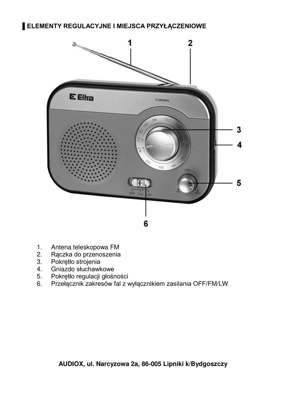

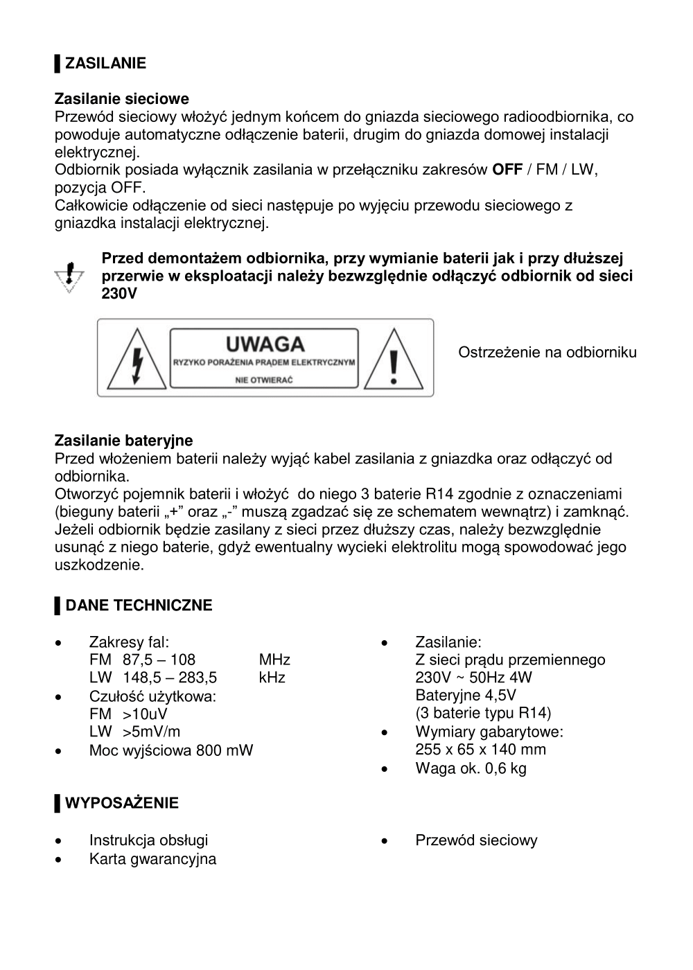

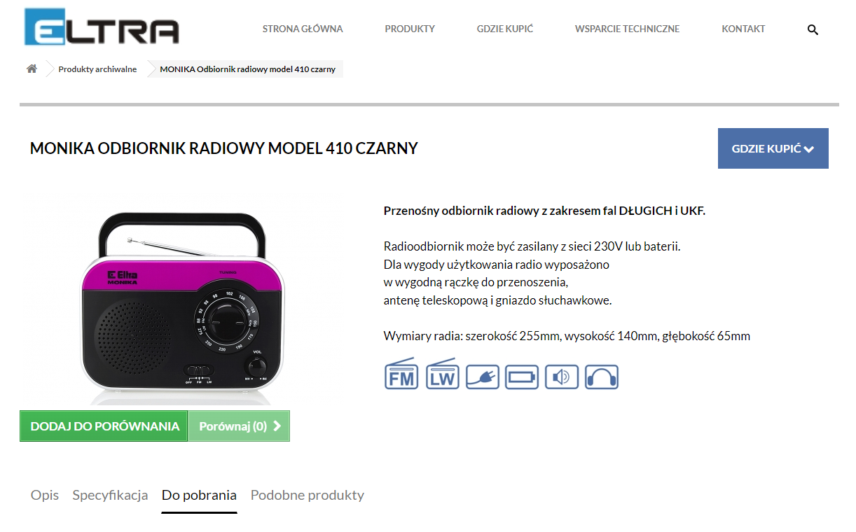

    Unlike completely 'no-name' Chinese products, here you can even download the manual and declaration of conformity:
    Interior of Monika radio from Eltra Audiox, model 410, FM/LW Interior of Monika radio from Eltra Audiox, model 410, FM/LW Interior of Monika radio from Eltra Audiox, model 410, FM/LW Interior of Monika radio from Eltra Audiox, model 410, FM/LW Interior of Monika radio from Eltra Audiox, model 410, FM/LW
    Interior of Monika radio from Eltra Audiox, model 410, FM/LW .
    Manual dated 2015.

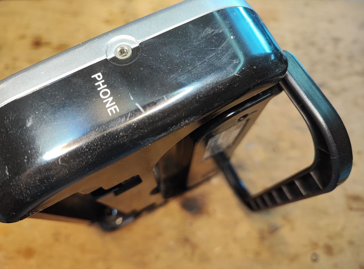

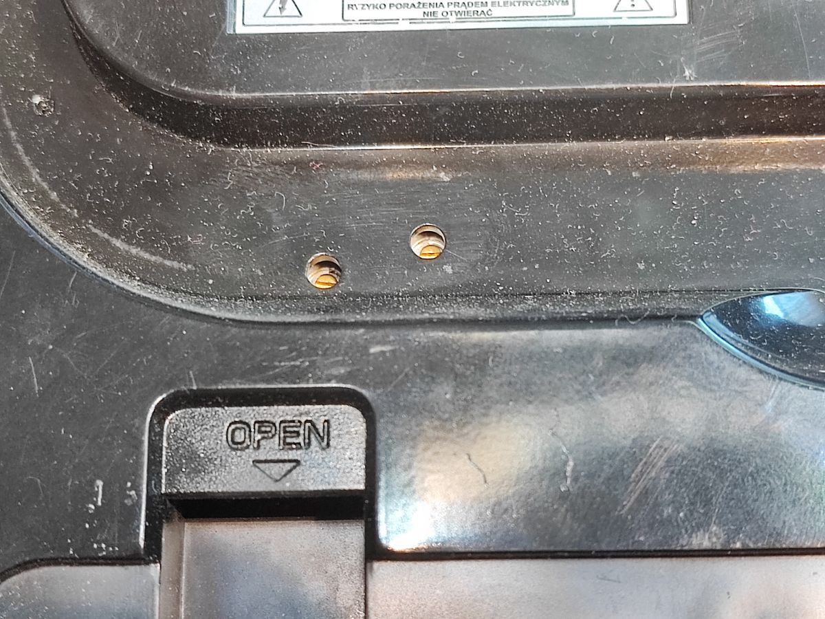

    There is a tuning barrel on the housing:

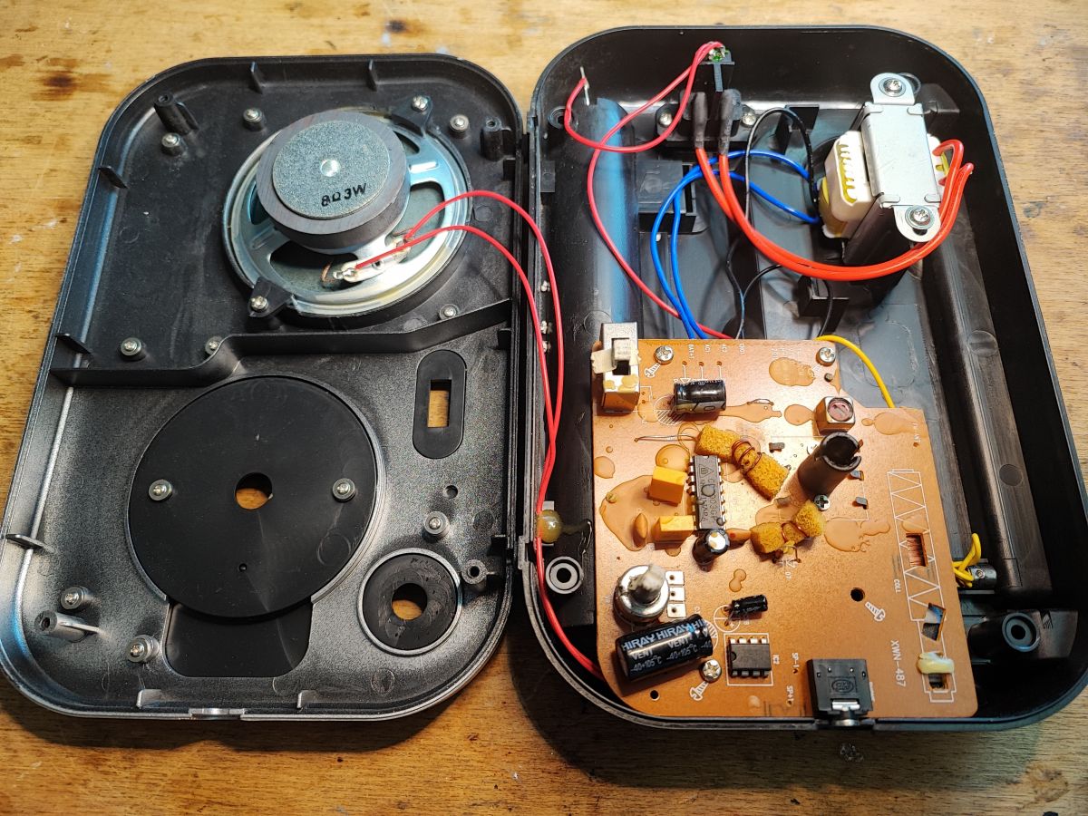

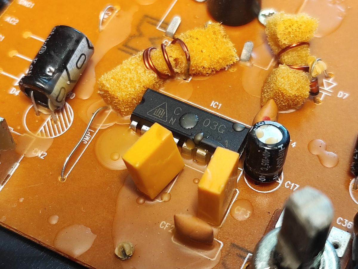

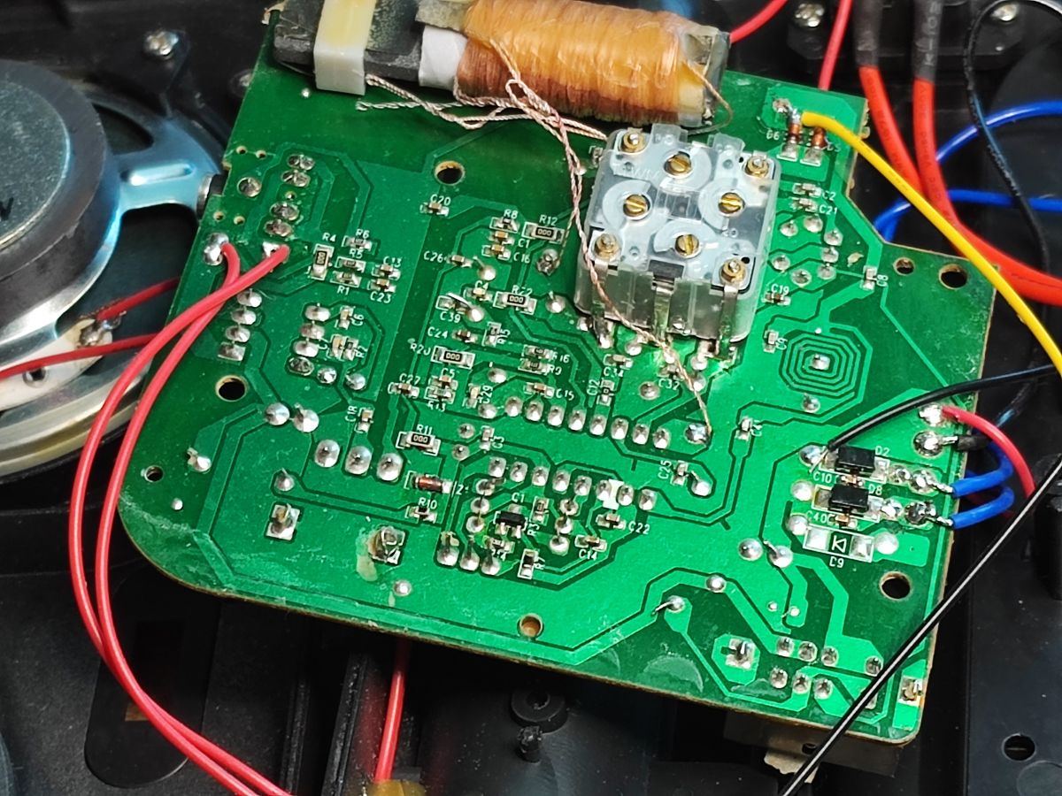

    Now let's take a look inside:

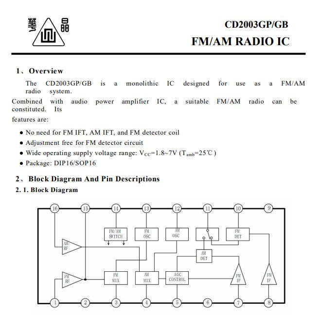

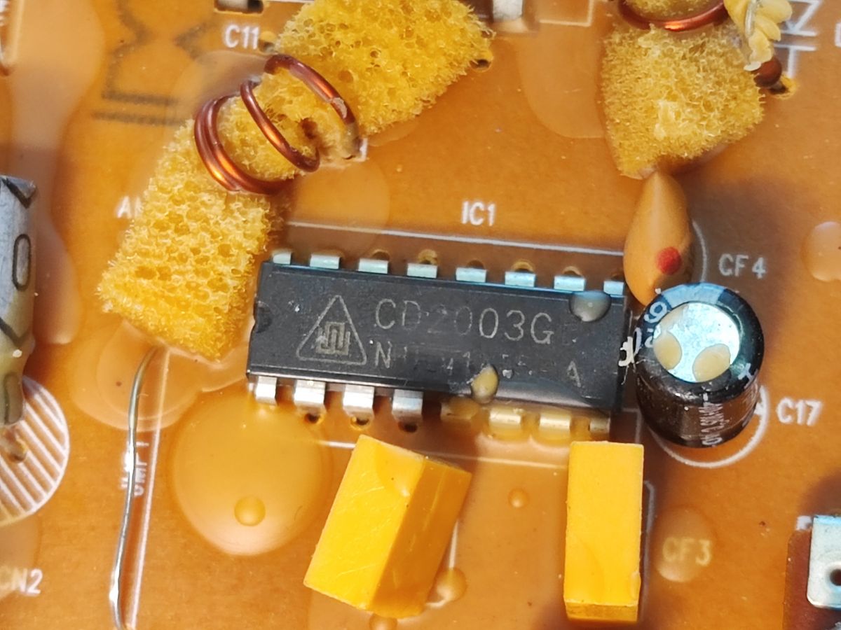

    The radio is based on the CD2003:
    Interior of Monika radio from Eltra Audiox, model 410, FM/LW Interior of Monika radio from Eltra Audiox, model 410, FM/LW .
    A very popular FM/AM receiver chip, available in DIP16/SOP16 housings, operating at 1.8V-7V.

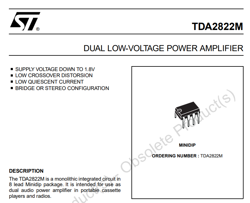

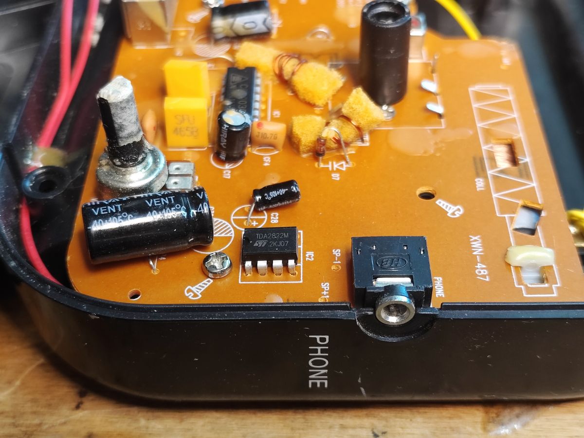

    Also inside here is a single-channel audio amplifier, a TDA2822M:

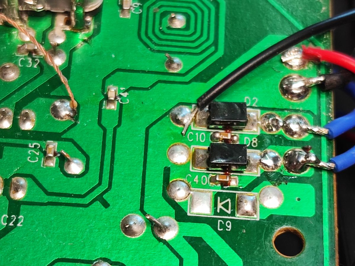

    A mains transformer is used for the power supply, there is no switching power supply. It is interesting to note that the transformer used is with a centre tap on the secondary winding, there is no four diode rectifier bridge, there is but a two-terminal rectifier:
    Quite poorly these solders look.

    What use are sponges in coils? Stabilisation of the winding?

    >>21272699 .
    Yes, exactly. When the radio was dropped or bumped, for example, the coils were not jittered.

    szymon122 wrote:
    What is the use of sponges in coils? Stabilisation of the winding?
    The sponges are soaked in something paraffin-like - the idea is to dampen the vibration of the coil.
    The voice coil vibrating on impact will detune the circuit and the vibration will be heard in the loudspeaker (so-called coil miking) The effect is most noticeable on the heterodyne coil - the vibrating coil introduces additional frequency modulation in the rhythm of the vibration.

    Unfortunately, shoddy receivers have been produced for years in which the tuning knob is attached directly to the rotary capacitor. In addition, you have to buy batteries or have access to mains power.
    I already prefer electronically tuned ones with a built-in rechargeable battery and power from a phone charger. Especially as I received such a wda as a free gift with my purchases.

    This is exactly what I wanted to point out - no gear between the tuning unit and the dial, thus zero tuning precision, just to save a few pennies on hardware and scale. It would be interesting to know if it holds the station alignment, or if you have to correct it from time to time.

    The bigger problem is the extremely poor, lead-free soldering, which will sooner or later become a problem. The author of the topic has already pointed this out.

    there is also a single channel audio amplifier here, TDA2822M
    Error. The TDA 2822M itself is a stereo (two-channel) power amplifier, only with the ability to bridge both channels. This manages to produce more power with the same load and power supply parameters.
