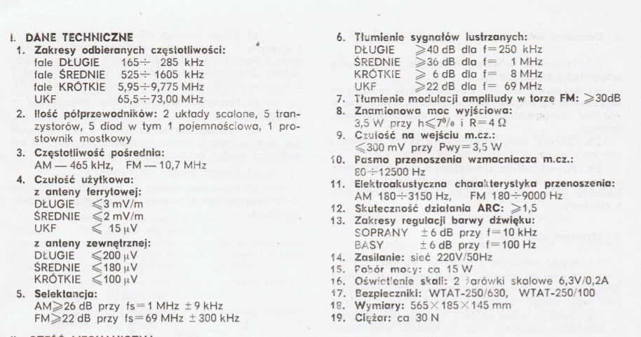

    Taraban 2 receives long wave, medium wave, short wave and UKF. The AM intermediate frequency is 465kHz and FM is 10.7MHz. For more details, I refer you to the manual:

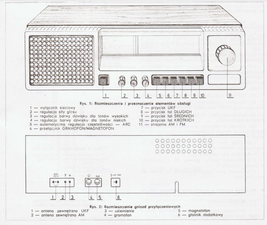

    Which connector is which, button roles, etc:

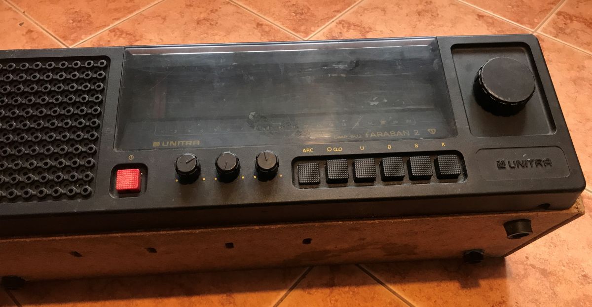

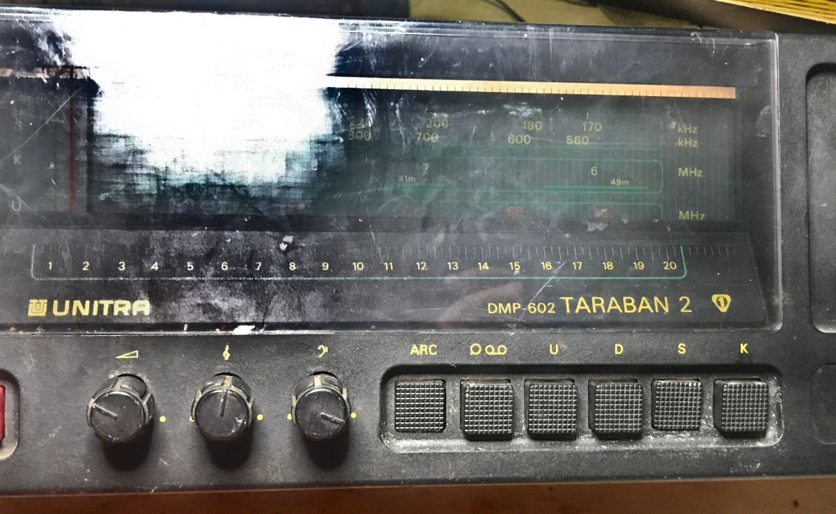

    Photo of the front, the scale is illuminated using ordinary 6.3V/0.2A bulbs, which we will see soon.
    Unitra Taraban 2 - DMP-602 - interior photo gallery, schematic diagram .

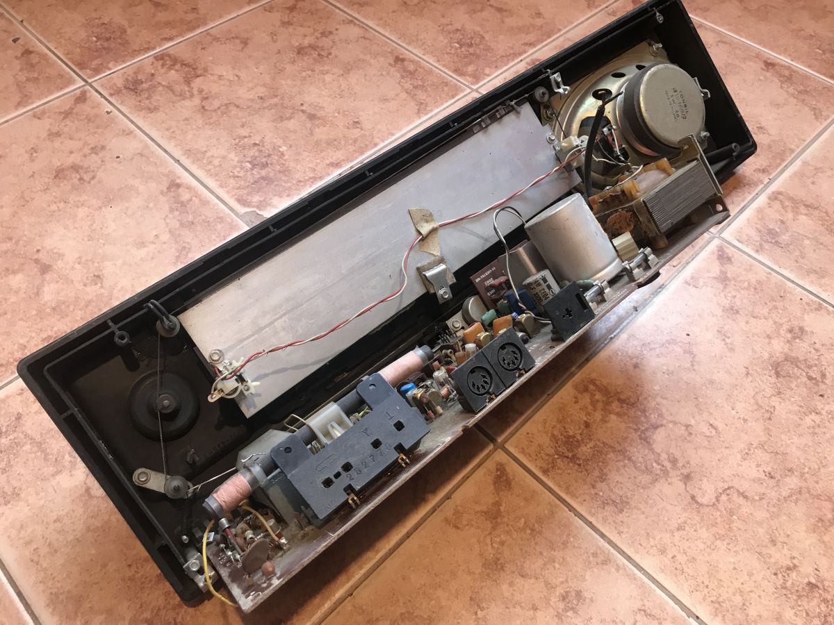

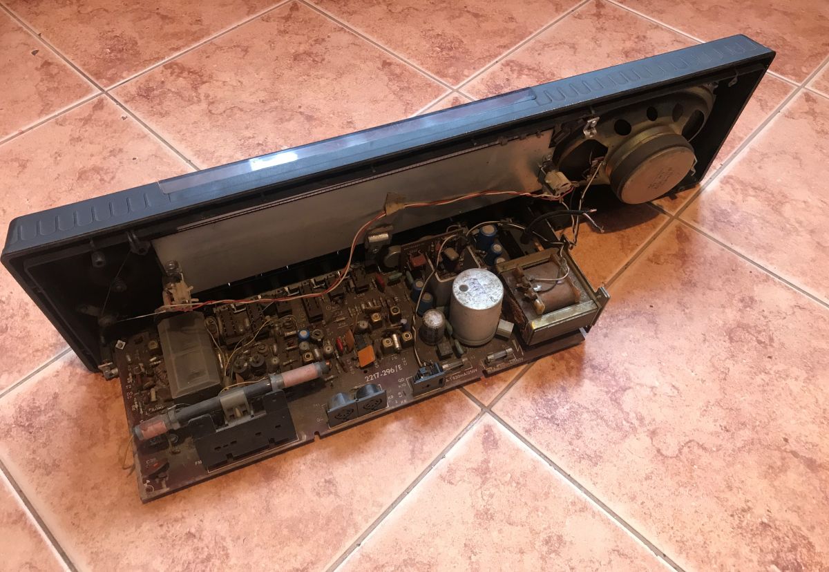

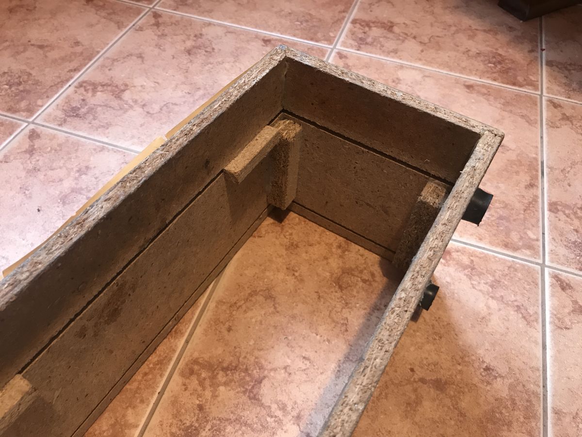

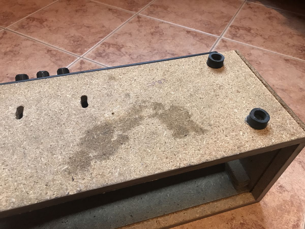

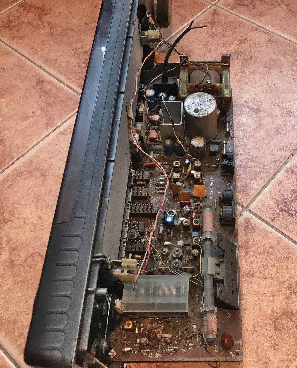

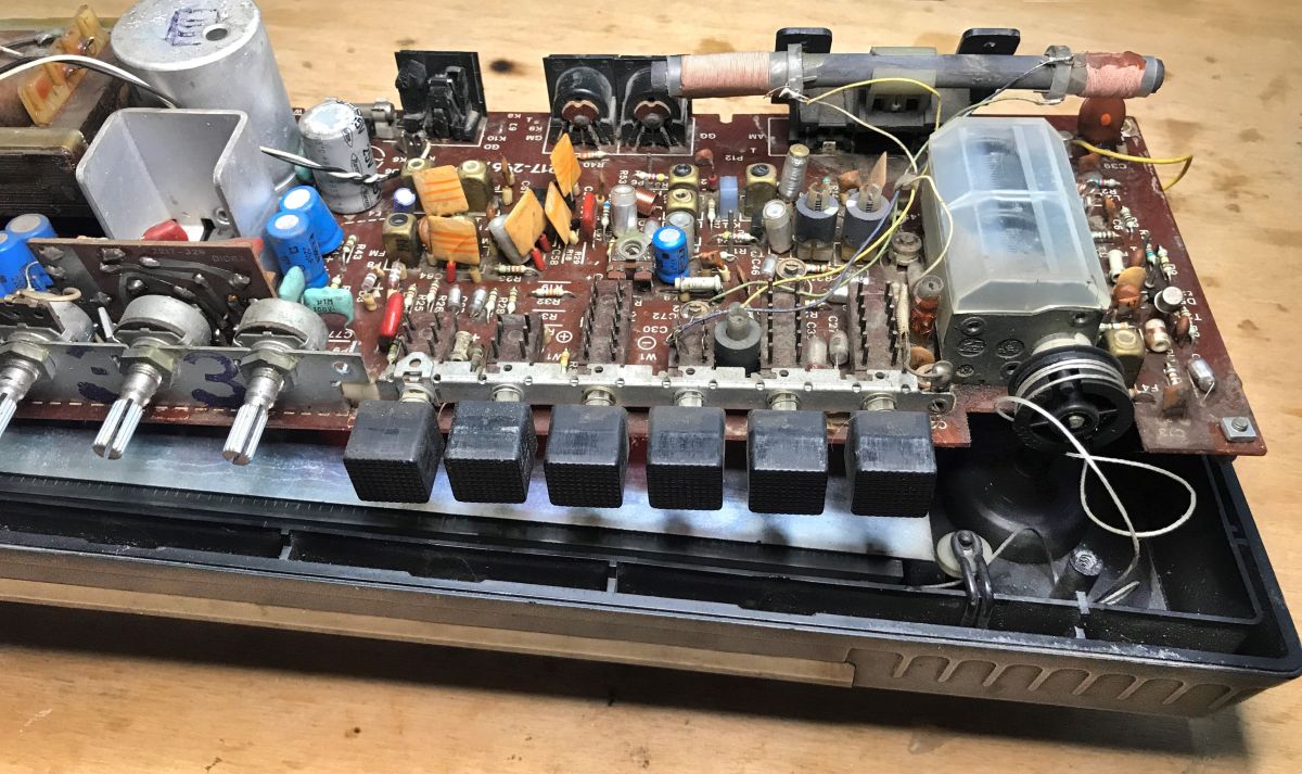

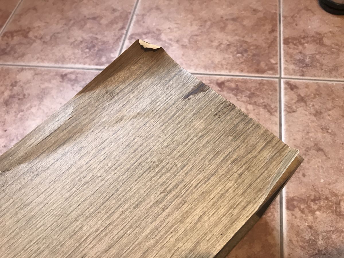

    The receiver, unfortunately, I have already salvaged in very poor condition. Both the casing and the interior:
    Unitra Taraban 2 - DMP-602 - interior photo gallery, schematic diagram Unitra Taraban 2 - DMP-602 - interior photo gallery, schematic diagram Unitra Taraban 2 - DMP-602 - interior photo gallery, schematic diagram Unitra Taraban 2 - DMP-602 - interior photo gallery, schematic diagram .
    The back plate is missing, the electronics can simply be removed along with the front:
    Antenna connector also torn out:

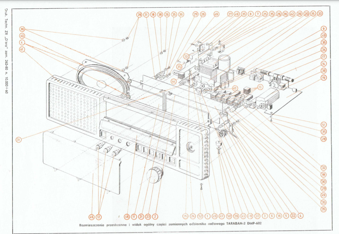

    There is a spatial arrangement of the elements in the documentation:

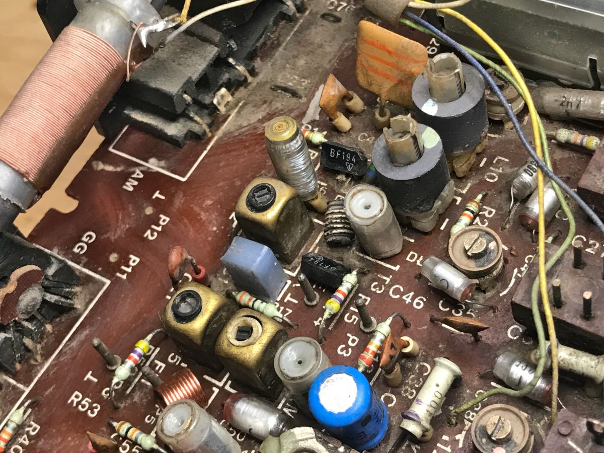

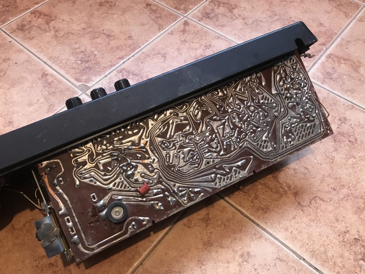

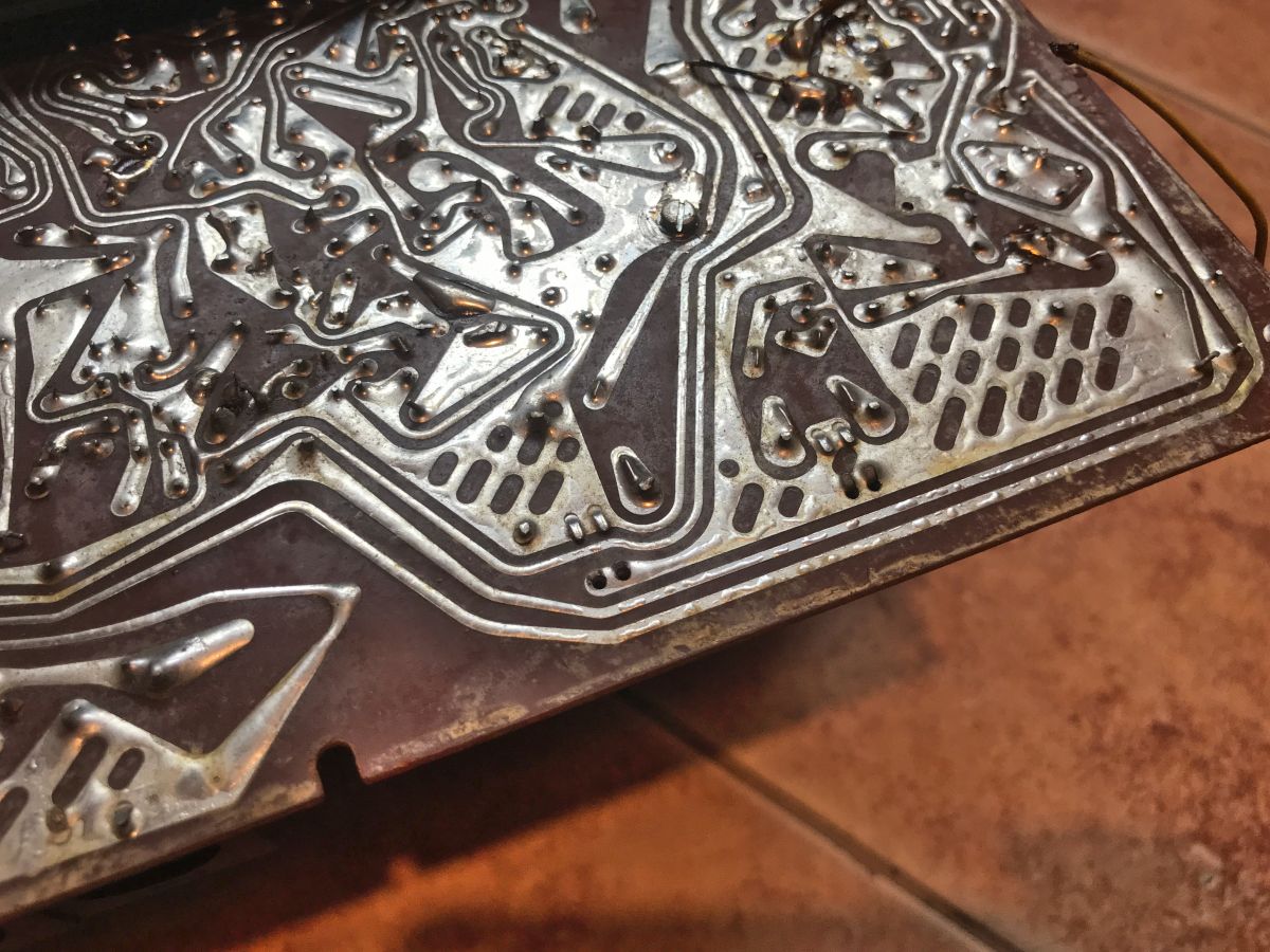

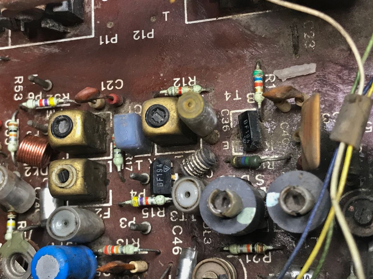

    PCB tracks. Some of the solders look poor:

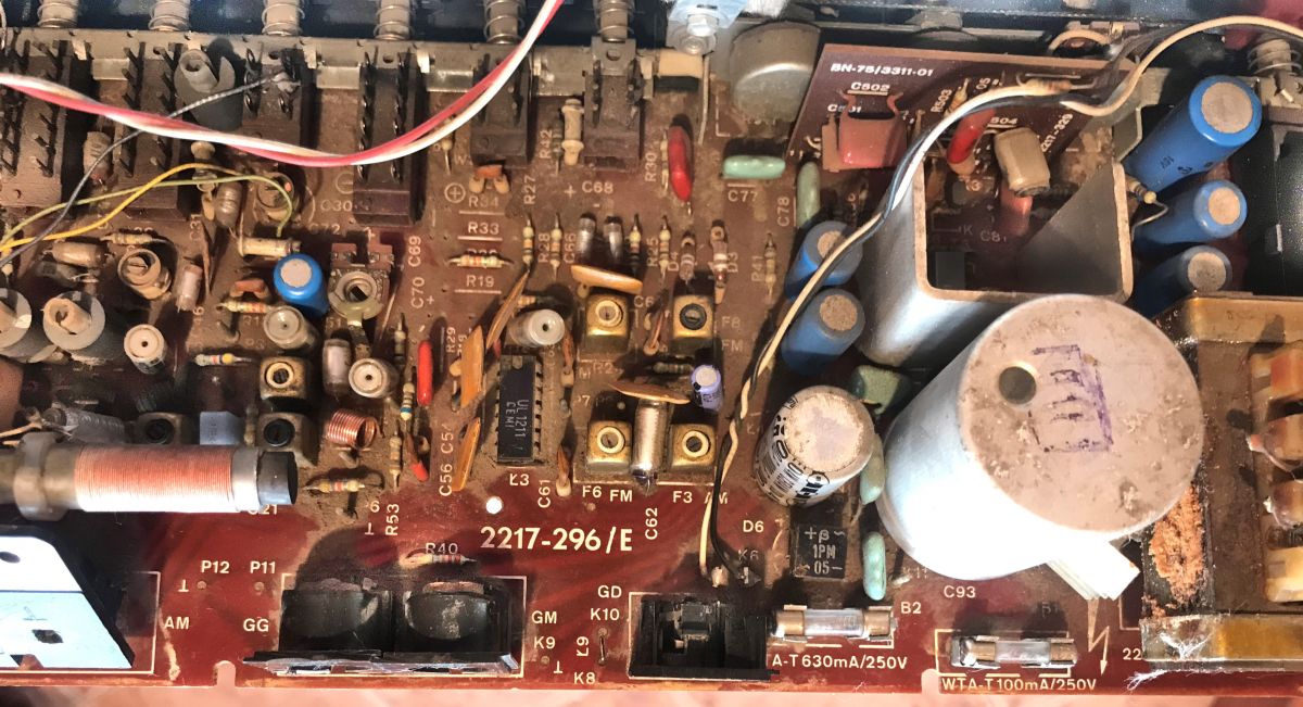

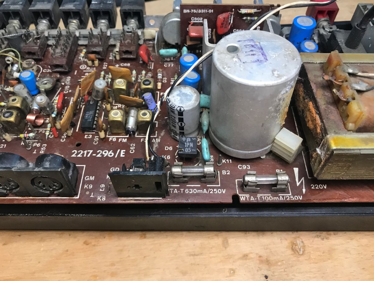

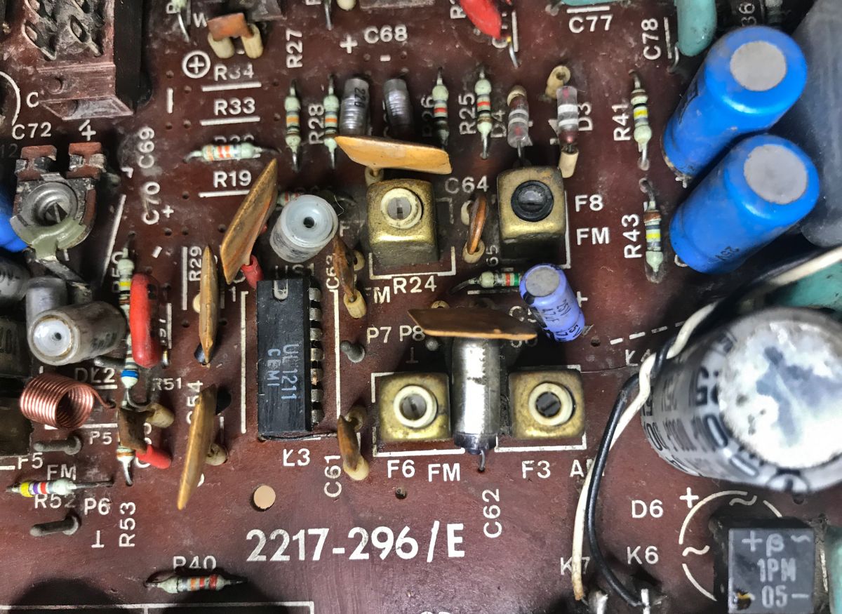

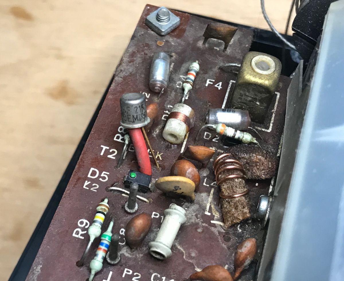

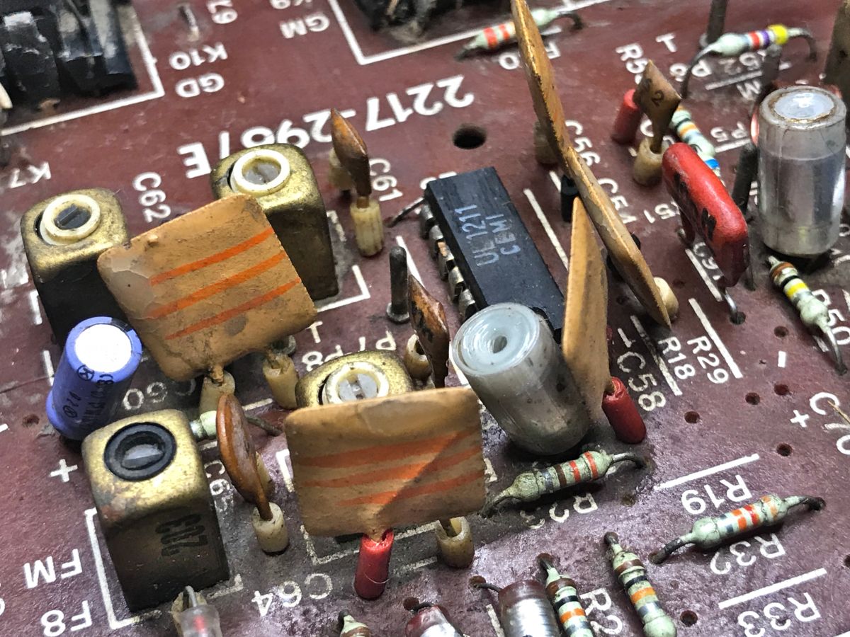

    Time for clearer pictures of the board. I had to at least pre-clean it, the layer of dirt is extremely thick.
    Here you can see, among other things, the fuses, the 1PM05 rectifier bridge and the UL1211 IC:

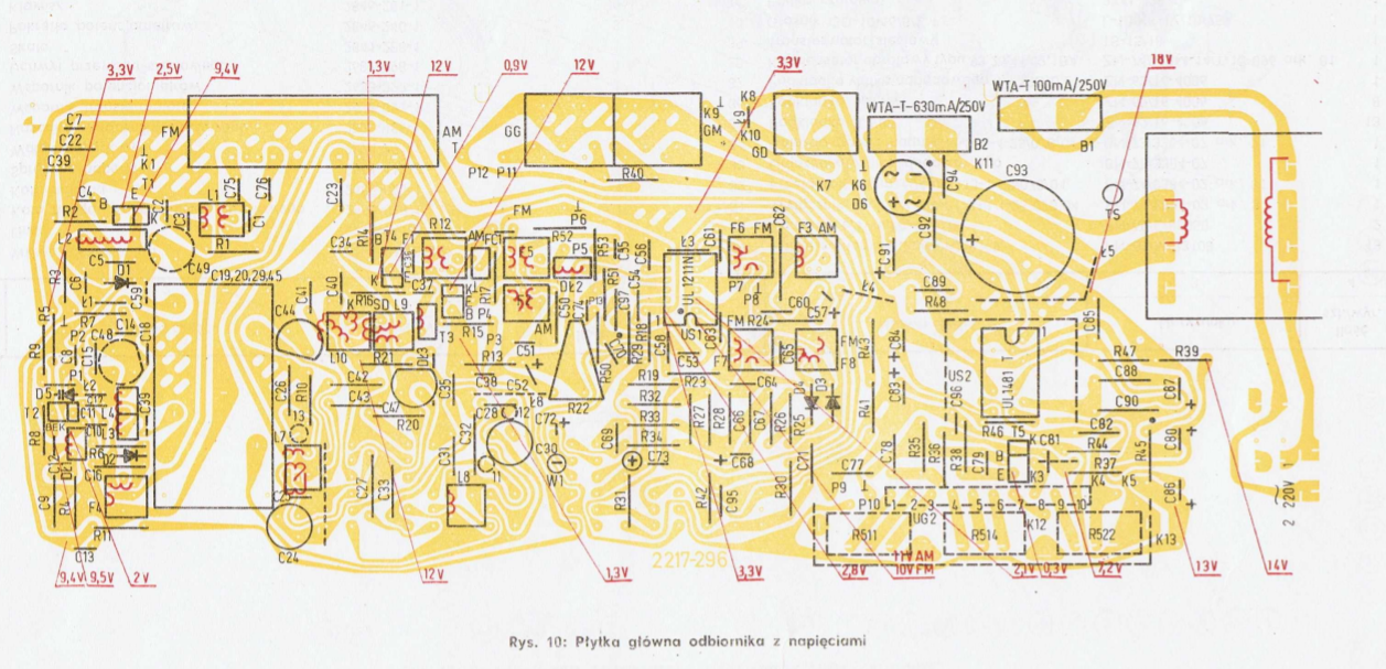

    We even have the board voltages listed in the service manual:

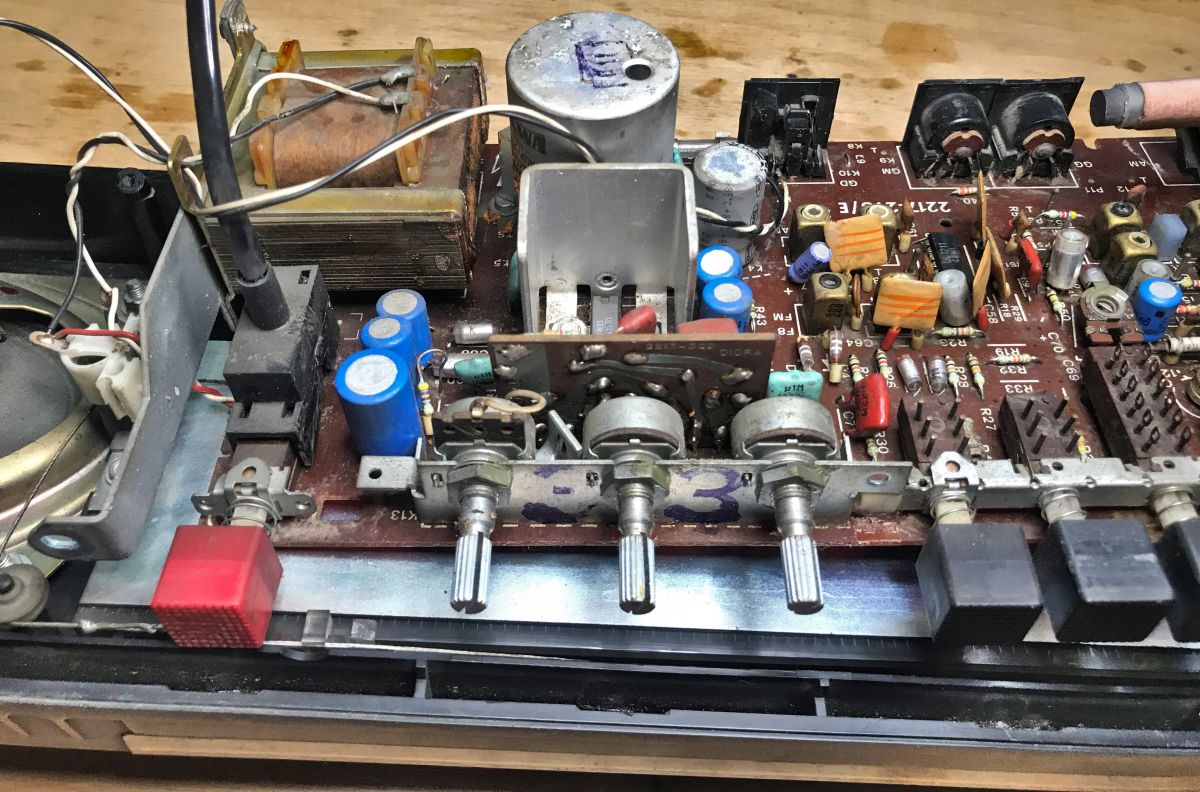

    Rails with potentiometers, switches:

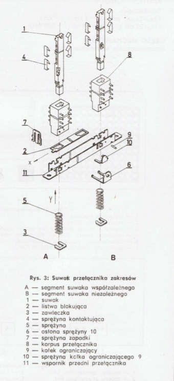

    The mechanism for switching ranges is shown well in the manual:

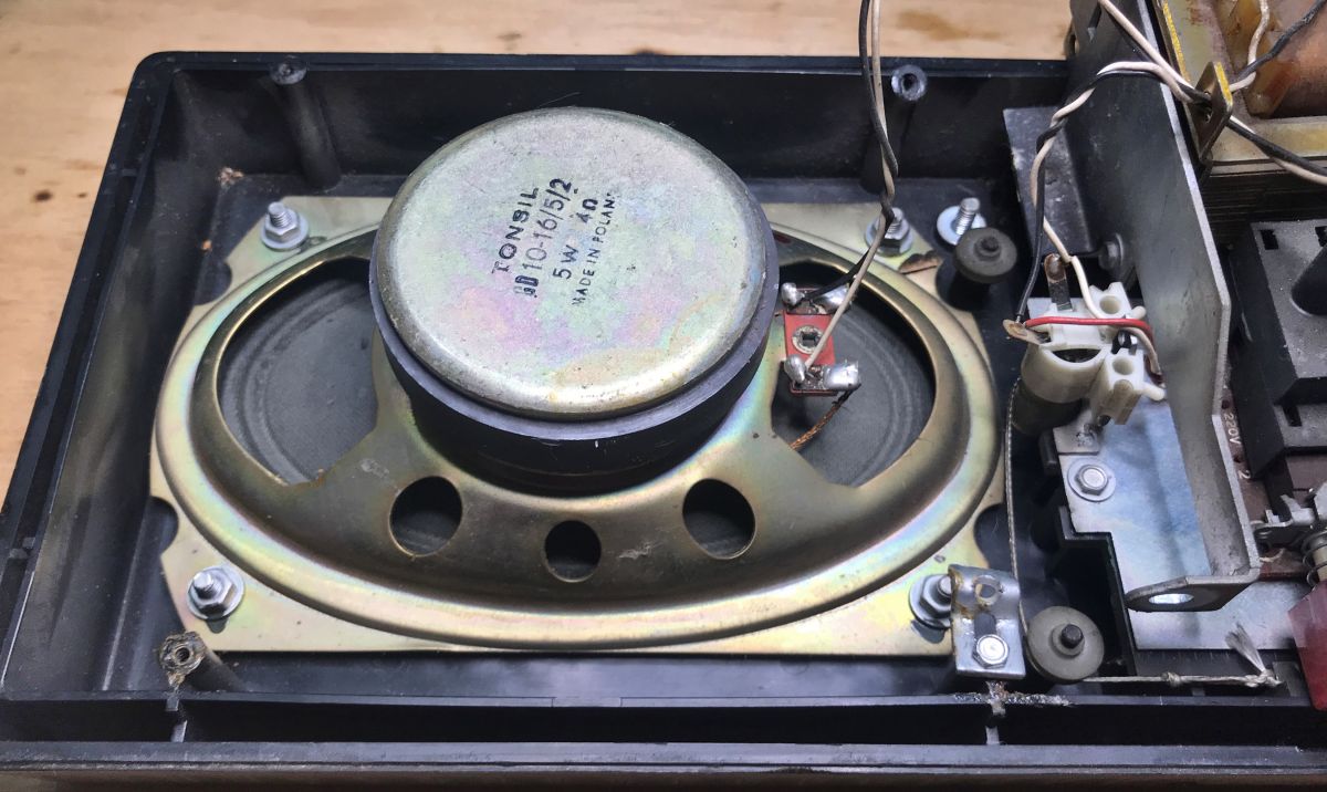

    Tonsil speaker GD10-16/5/2 5W 4Ω Made In Poland:

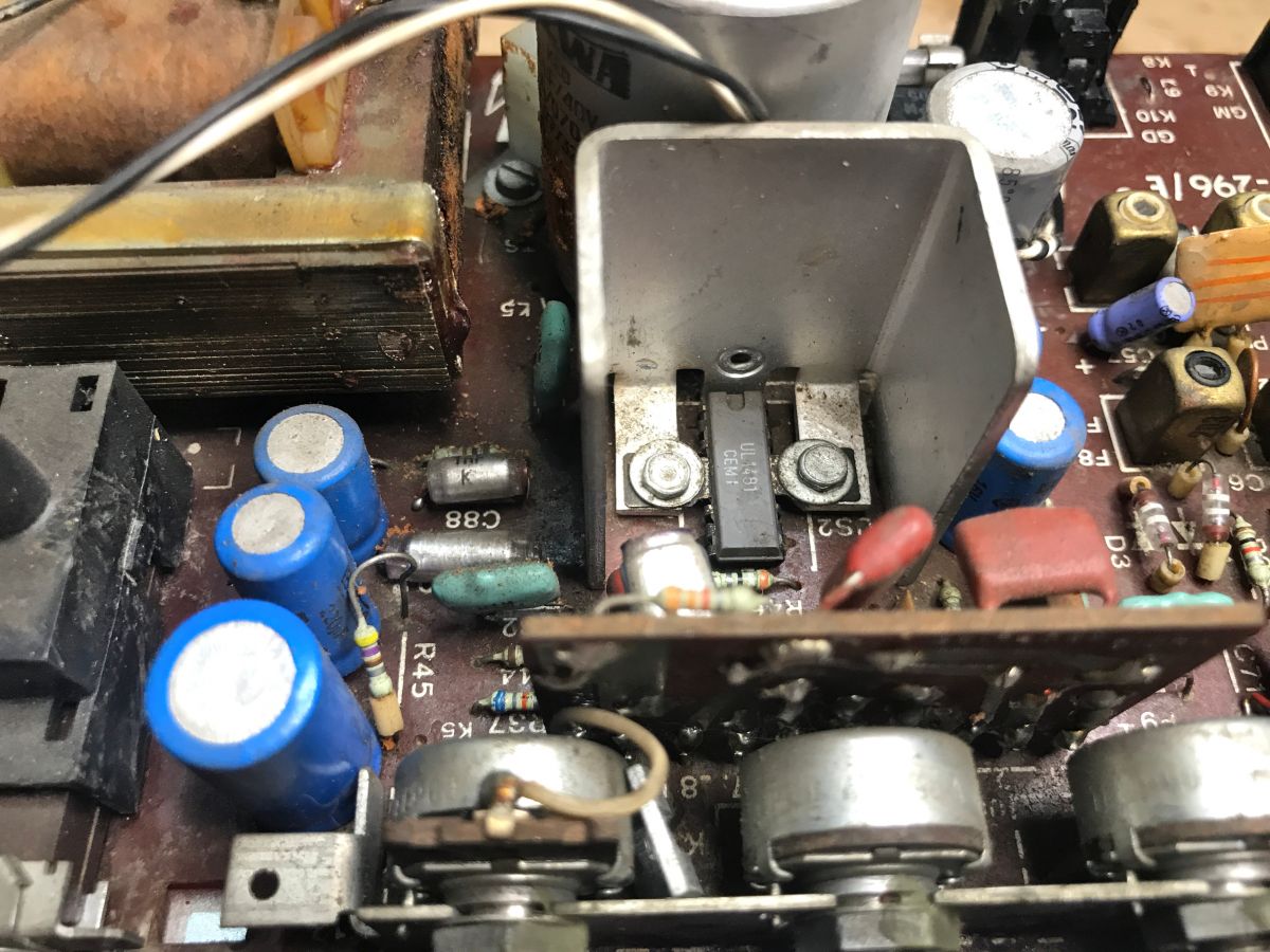

    The second IC inside is a UL1481 CEMI, together with a heatsink:

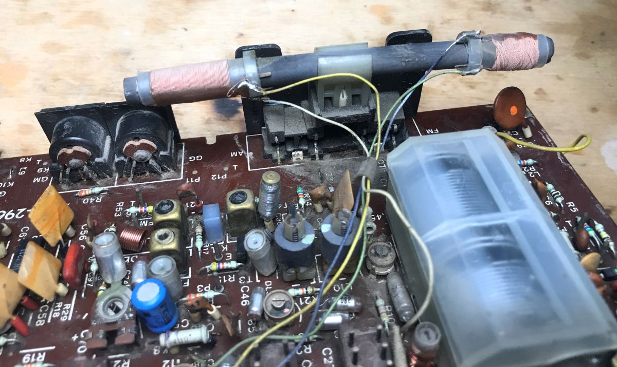

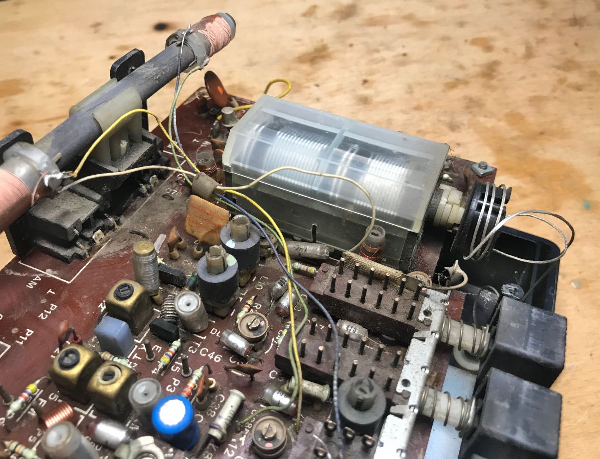

    Ferrite antenna, tuning capacitor:

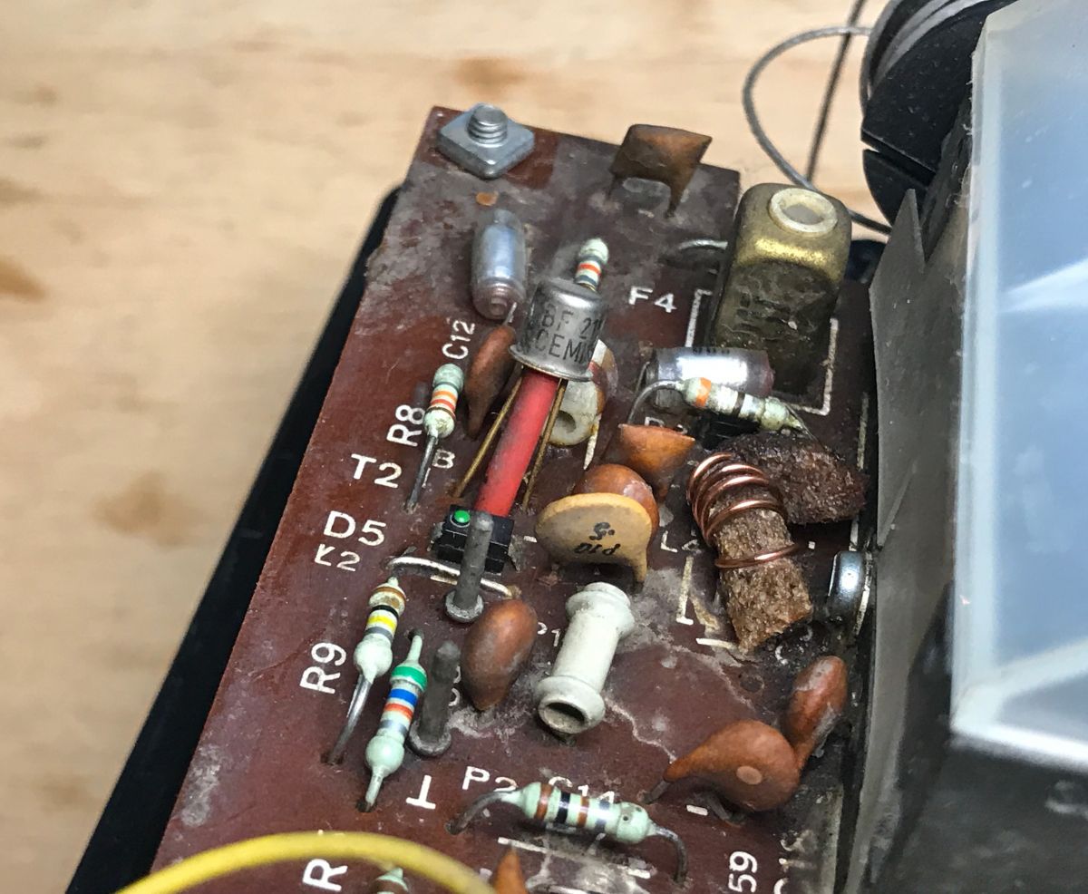

    Transistors w.c. BF194 in the characteristic housing of the time:
    BF215 transistor and a characteristic capacitive diode (warp) with a green dot, probably BB105G (yes, I checked on the schematic).

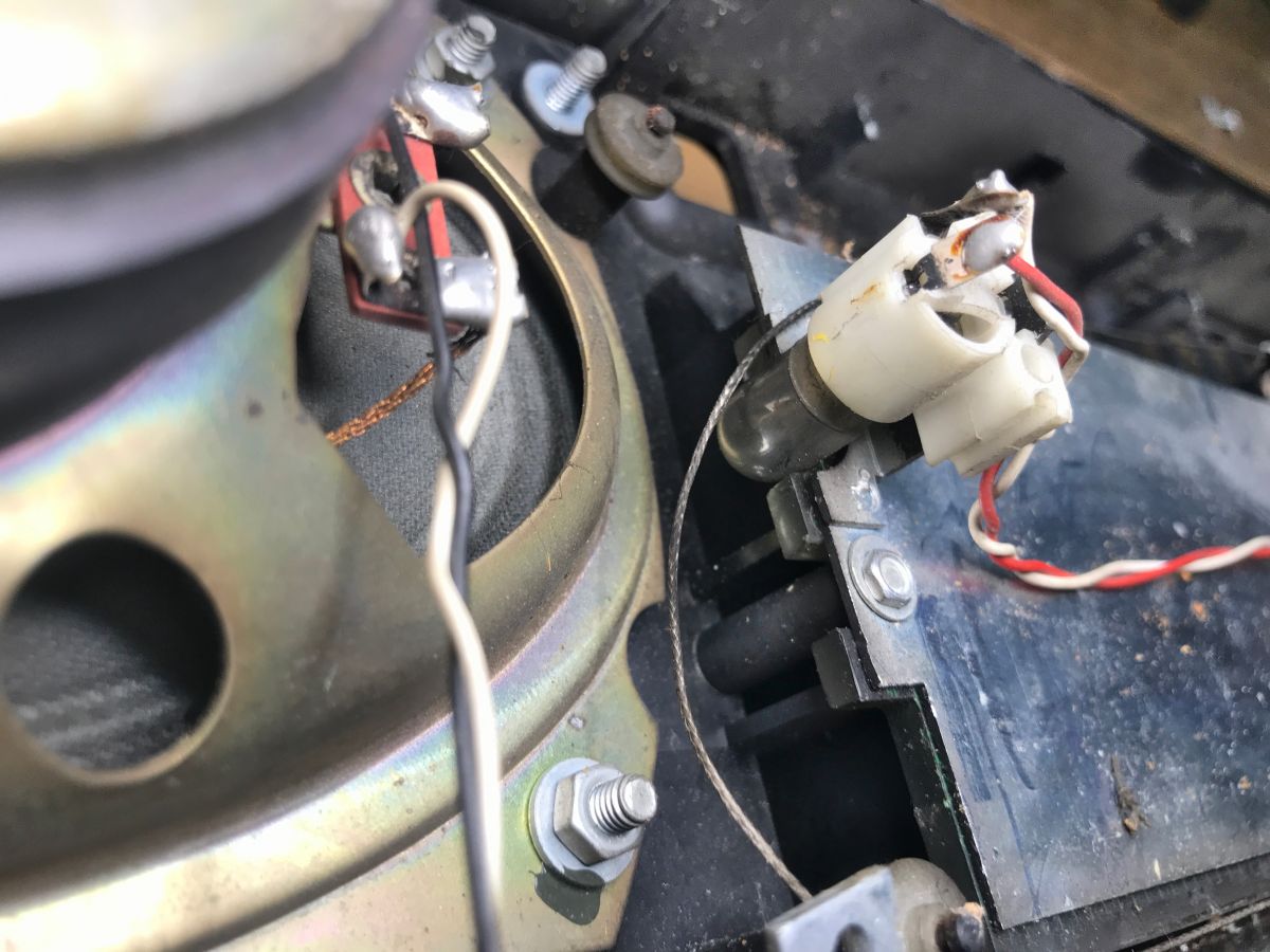

    The aforementioned backlighting - the bulb:

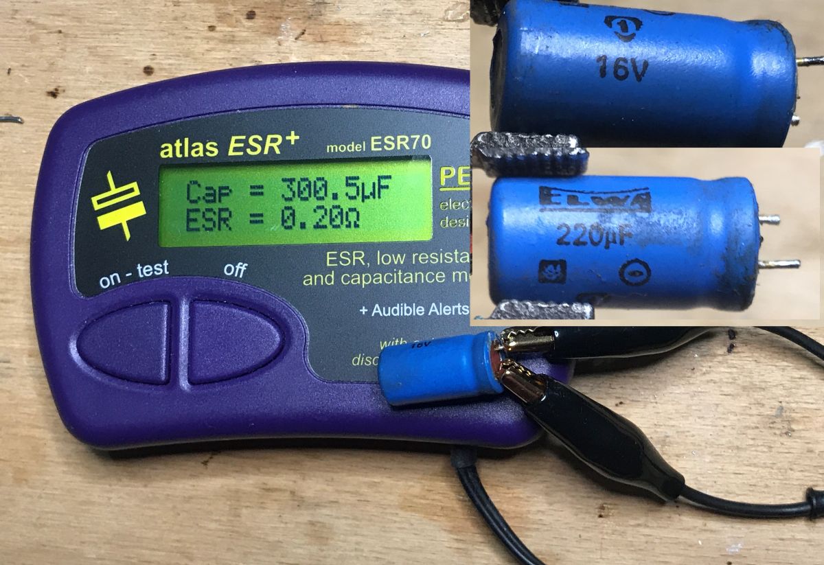

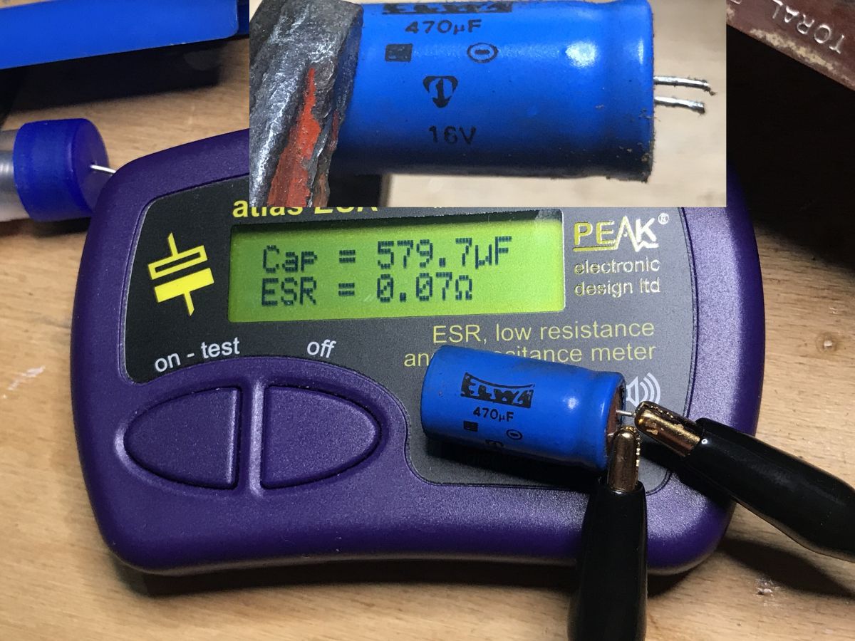

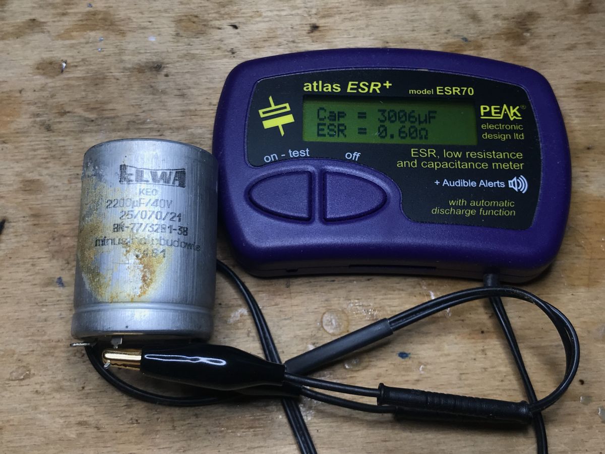

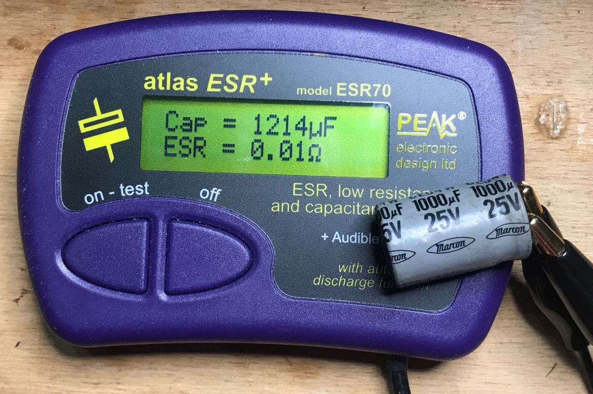

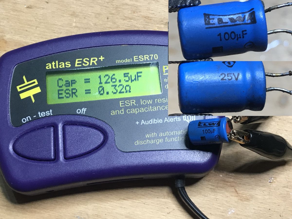

    Out of sheer curiosity I decided to check the capacitance and ESR status of the ELWA electrolytic capacitors from inside this radio. For this I used a rather expensive ESR70 meter that I have tested and know does not overestimate the measurements. Would the capacitors be in poor condition or also perhaps their capacity has increased? Let's see:
    Unitra Taraban 2 - DMP-602 - interior photo gallery, schematic diagram Unitra Taraban 2 - DMP-602 - interior photo gallery, schematic diagram feUnitra Taraban 2 - DMP-602 - interior photo gallery, schematic diagram Unitra Taraban 2 - DMP-602 - interior photo gallery, schematic diagram Unitra Taraban 2 - DMP-602 - interior photo gallery, schematic diagram Unitra Taraban 2 - DMP-602 - interior photo gallery, schematic diagram
    Capacities are consistently higher than nominal, but overall it is not so bad, although I refer to the ESR tables to assess specific results. The results are repeated for a further 100uF/220uF not included in the images.
    Service manual (in Polish) .
    For this radio, detailed documentation and instructions in Polish are available online. I don't see the need to over-quote it here, I'm simply attaching the PDF for download (schematic also inside):

    On the large electrolyte you have a production date of 0481 - April 1981, this is more or less also the production date of this receiver, with a deviation of plus a quarter
  • Need to reform electrolytics before ESR measurement

    Out of sheer curiosity I decided to check the capacitance and ESR status of the ELWA electrolytic capacitors inside this radio.
    Such a measurement is best carried out after such a capacitor has been connected for at least several minutes to a voltage close to its rated voltage and then discharged to zero. Especially if the capacitors have been unused for years and the radio itself has been stored in extreme conditions. Measurement results can vary quite a lot.
  • UL1481 overvoltage risk and TDA2009 replacement
    #10 19791509
    pawelr98
    Posts: 6464
    Help: 413
    Rate: 1155
    The head is identical to many other Dior designs.
    In my 1:1 Duet it's the same, even the layout of the components on the laminate is similar.
    Tuning, apart from the L3 coil which is cumbersome to tune, is not a problem.
    You have to bend these coils a bit in all directions until you have the correct tuning range.
    As for the radio itself, as always it was a combination, not doing the right thing.
    UL1481 and 18V power supply, above 15V no protection in this power amplifier works anymore.
    There is no voltage stabilisation, so you have to be careful what the mains voltage is, as the UL1481 can withstand up to 20V maximum.
    I didn't combine with these carcasses (2xUL1481), I just put TDA2009, in this radio you could also put something more tolerable with parameters and safer.

    Even so, ELWA used to make good capacitors. So much time, and the capacitance holds BA! with a hook. In those days ESR was not as important as it is today.

    rnb_bolii wrote:
    Although, ELWA used to make good capacitors. So much time, and the capacitance holds BA! with a hook. In those days ESR was not as important as it is today.
    . Except for the small ones so up to 10u 22u These are generally always replaceable.
  • #14 19798661
    rnb_bolii
    Posts: 4173
    Help: 635
    Rate: 1177
    audiofil wrote:
    rnb_bolii wrote:
    Although, ELWA used to make good capacitors. So much time and the capacitance holds BA! with a hook. In those days ESR was not as important as it is today.
    That's right. They can even short-circuit the inside and mess with the circuits.
