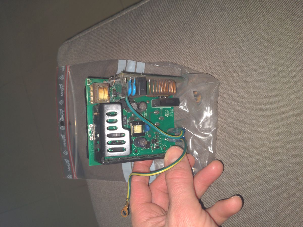

  • #35 21435663
    xftaz
    I have a problème with my same card of Electrolux vacuum cleaner, do you have the value of the varistor, surtensor? On my card it is complète destroy 😂
    Many thanks for your help
