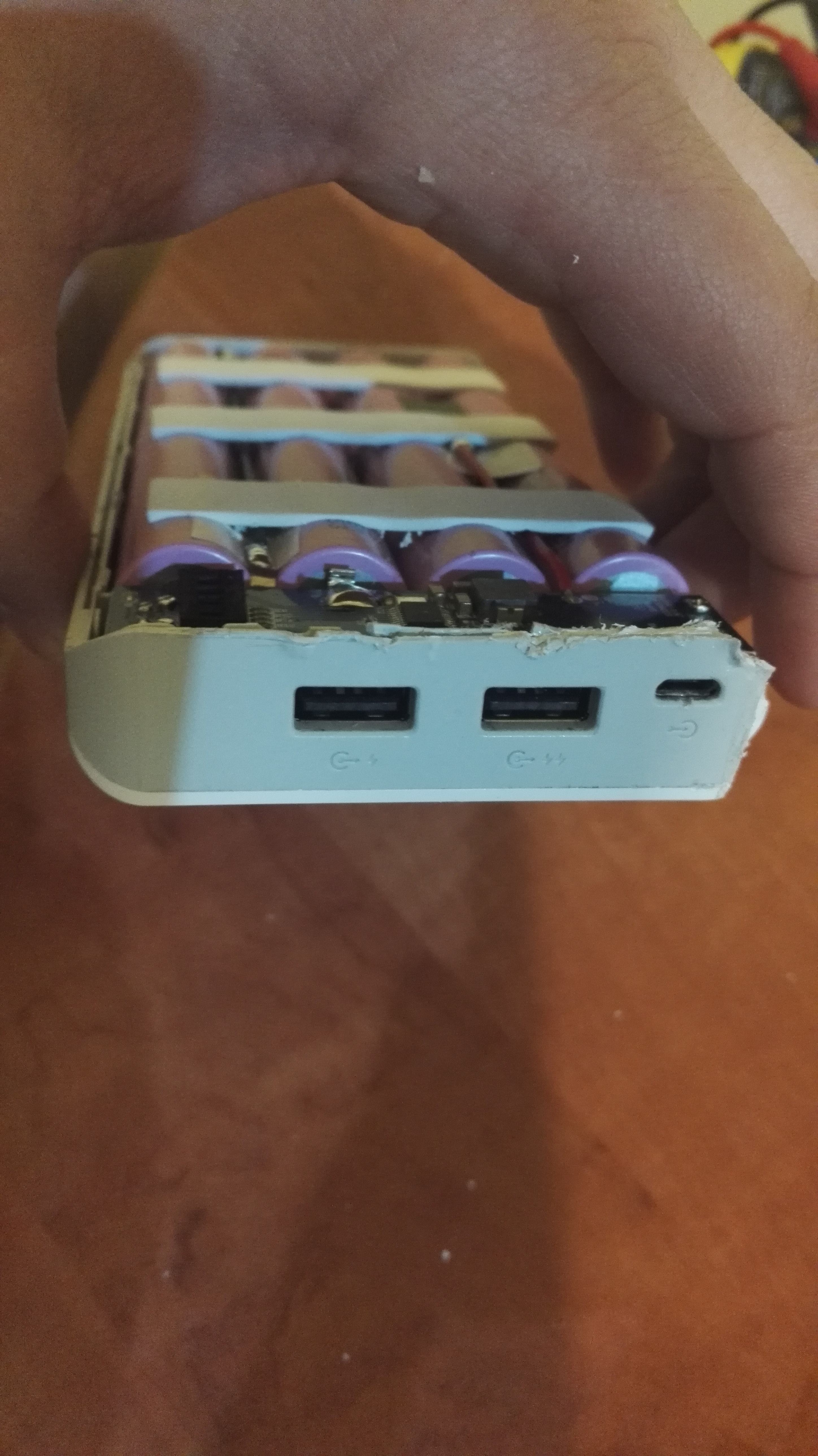

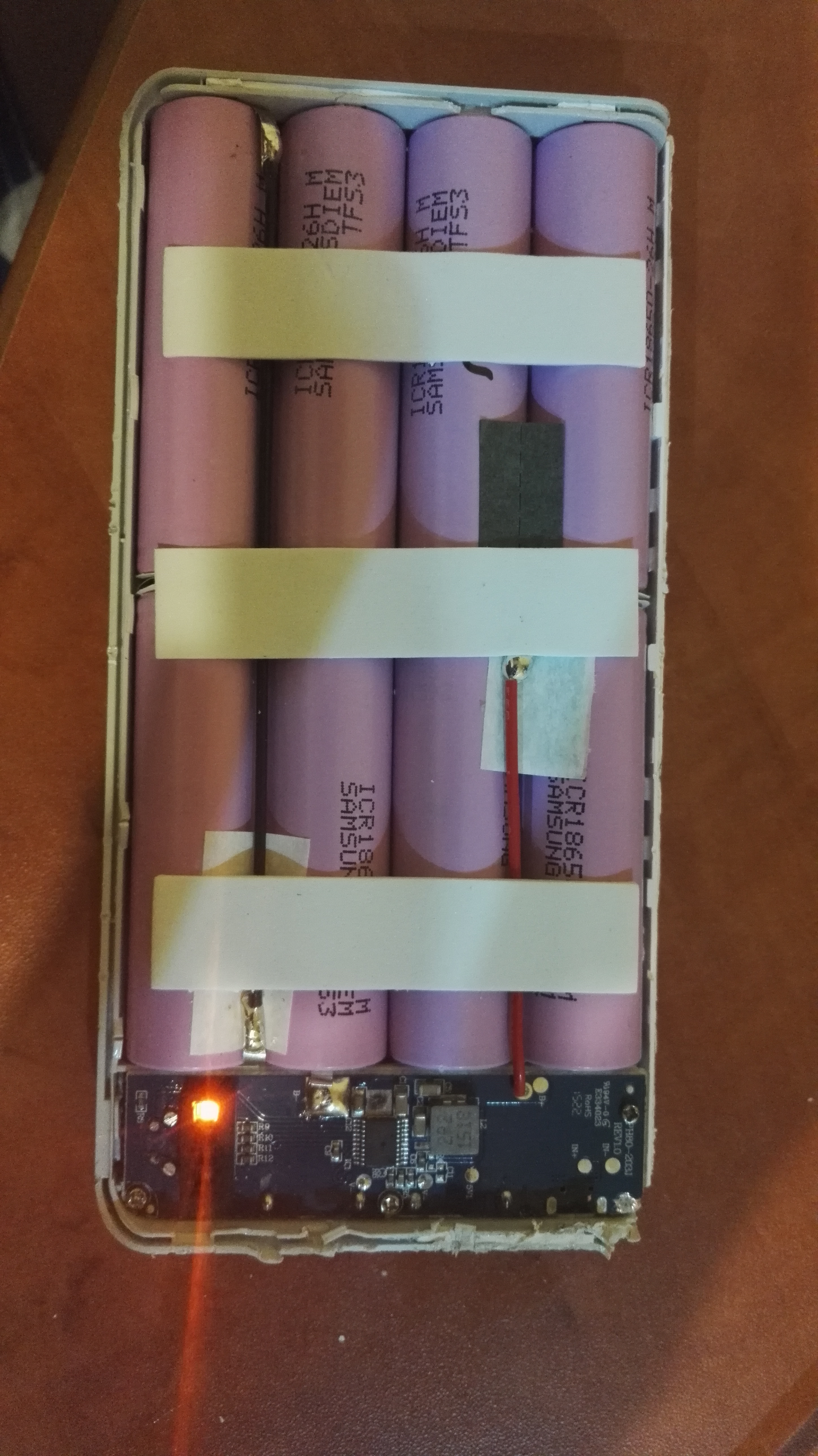

  • #12 16175038
    kacper.diablo
    I go to the topic, I have the same model only 16k, I charged it maybe 3 times and now it cannot be charged, after connecting it for a moment it shows as if it is charging, then one paw blinks (like when the battery is discharged) and that's it. Is not charging. Someone has a similar problem, mine is practically new and I hope to find a receipt and send it back, unless there is a way to do it?
  • #13 16198291
    Dziczku13
    Posts: 25
    hello and I want to reactivate the question I have the same power bank and I have the same problem, save me, I gave PLN 200 for a power tank and here is a lime just after the Guarantee something went down ...
  • #14 16199132
    jdubowski
    Tube devices specialist
    Posts: 21595
    Help: 2511
    Rate: 2804
    Any measurements taken? The battery can be charged with an external charger outside the power bank?
  • #15 16199197
    Dziczku13
    Posts: 25
    Currently, I have been charging it for over 2 hours with a regular charger from Huawei Honor 7 2A and the second LED on the PB has jumped.
    Charging is continuous and uninterruptible at 5.06v. When connecting the 18650 batteries, they had 3.58v, currently they have 3.78v, I am waiting for 8pcs of batteries to reach 4.2v. It is supposed to be charged with a 2A charger max 14h and recently it was charged after 16h and barely one line jumped .. Please forgive the disassembly, but this Korean-Chinese miracle was additionally covered with plastic and there was no chance to get it out of the clamps normally. I had to use force. And by the way, it is possible somewhere to buy a plate with even one charging output 2.1A to transfer the battery to a new module and use it ?? Because the current battery supports me with GPS and LTE mobile internet and it's enough for me for 20 hours of driving :) Below you have photos like something, write what may be the reason for the failure. Only once or max 2 times I had the chance to leave the car in the night when it was frost -10 degrees, is it possible that it would hurt even though it was in a fabric cover ??
    • Romoss Sailing 6 20800mAh Power Bank: Stopped Charging Overnight, Possible Fuse or Cycle Issue IMG_20170113_191732.jpg (5.45 MB) You must be logged in to download this attachment.
    • Romoss Sailing 6 20800mAh Power Bank: Stopped Charging Overnight, Possible Fuse or Cycle Issue IMG_20170113_191740.jpg (5.28 MB) You must be logged in to download this attachment.
    • Romoss Sailing 6 20800mAh Power Bank: Stopped Charging Overnight, Possible Fuse or Cycle Issue IMG_20170113_191445.jpg (5.84 MB) You must be logged in to download this attachment.
    • Romoss Sailing 6 20800mAh Power Bank: Stopped Charging Overnight, Possible Fuse or Cycle Issue IMG_20170113_191524.jpg (4.9 MB) You must be logged in to download this attachment.
    • Romoss Sailing 6 20800mAh Power Bank: Stopped Charging Overnight, Possible Fuse or Cycle Issue IMG_20170113_191518.jpg (5.11 MB) You must be logged in to download this attachment.

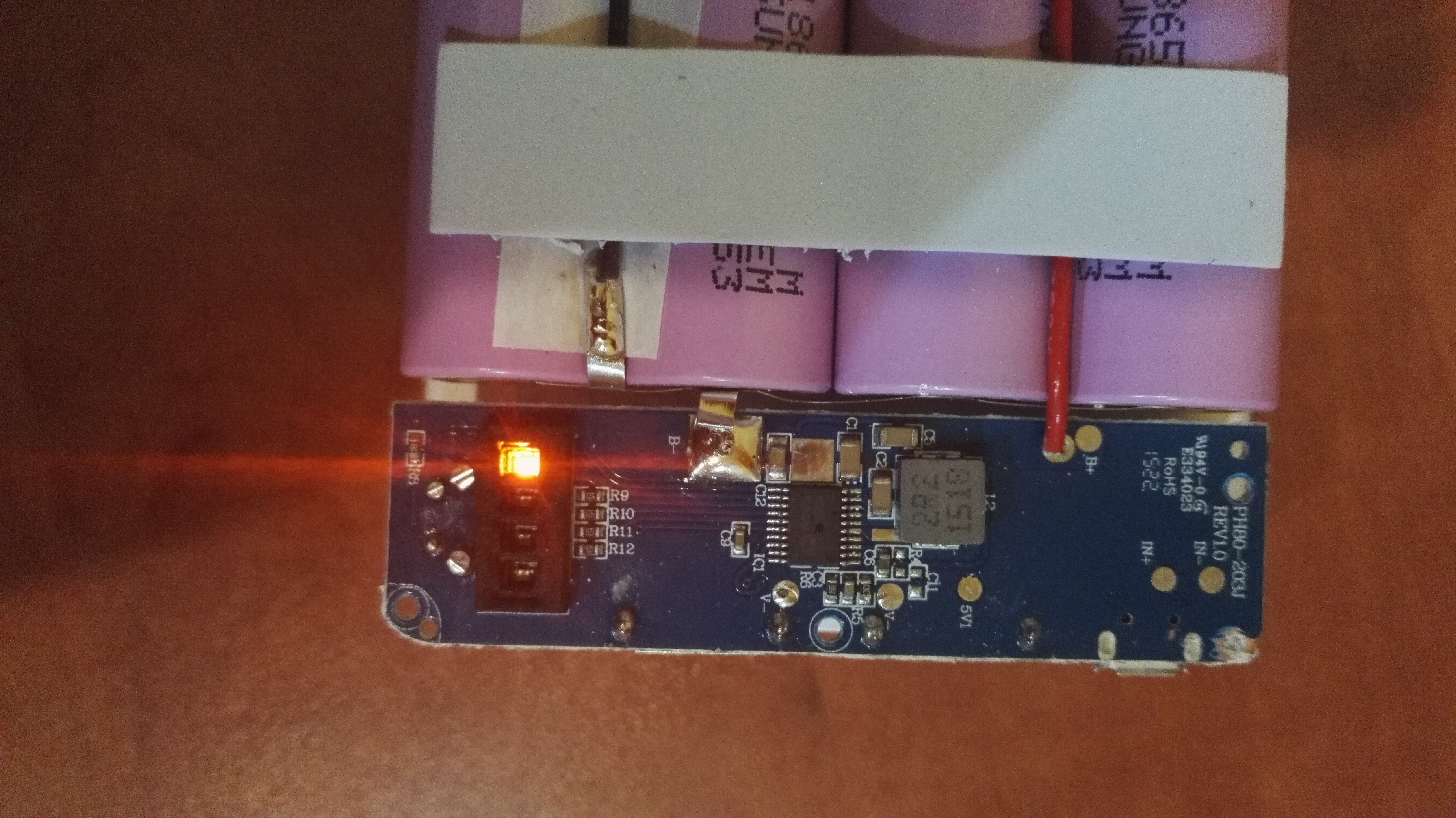

  • #16 16199223
    Dziczku13
    Posts: 25
    I do not want to post under the post, but the 3 diode jumped up, i.e. after measuring the 2xp 4 batteries have 3.80v, it generally charges but the charging current dropped to 5.05v
    Charging is continuous and uninterruptible at 5.06v. When connecting the 18650 batteries, they had 3.58v, currently they have 3.78v, I am waiting for 8pcs of batteries to reach 4.2v. It is supposed to be charged with a 2A charger max 14h and recently it was charged after 16h and barely one line jumped .. Please forgive the disassembly, but this Korean-Chinese miracle was additionally covered with plastic and there was no chance to get it out of the clamps normally. I had to use force. And by the way, it is possible somewhere to buy a plate with even one charging output 2.1A to transfer the battery to a new module and use it ?? Because the current battery supports me with GPS and LTE mobile internet and it's enough for me for 20 hours of driving :) Below you have photos like something, write what may be the reason for the failure. only once or max 2 times I was able to leave in the car at night when it was frost -10 degrees, is it possible that it would hurt even though it was in a fabric cover ??
  • #17 16199301
    jdubowski

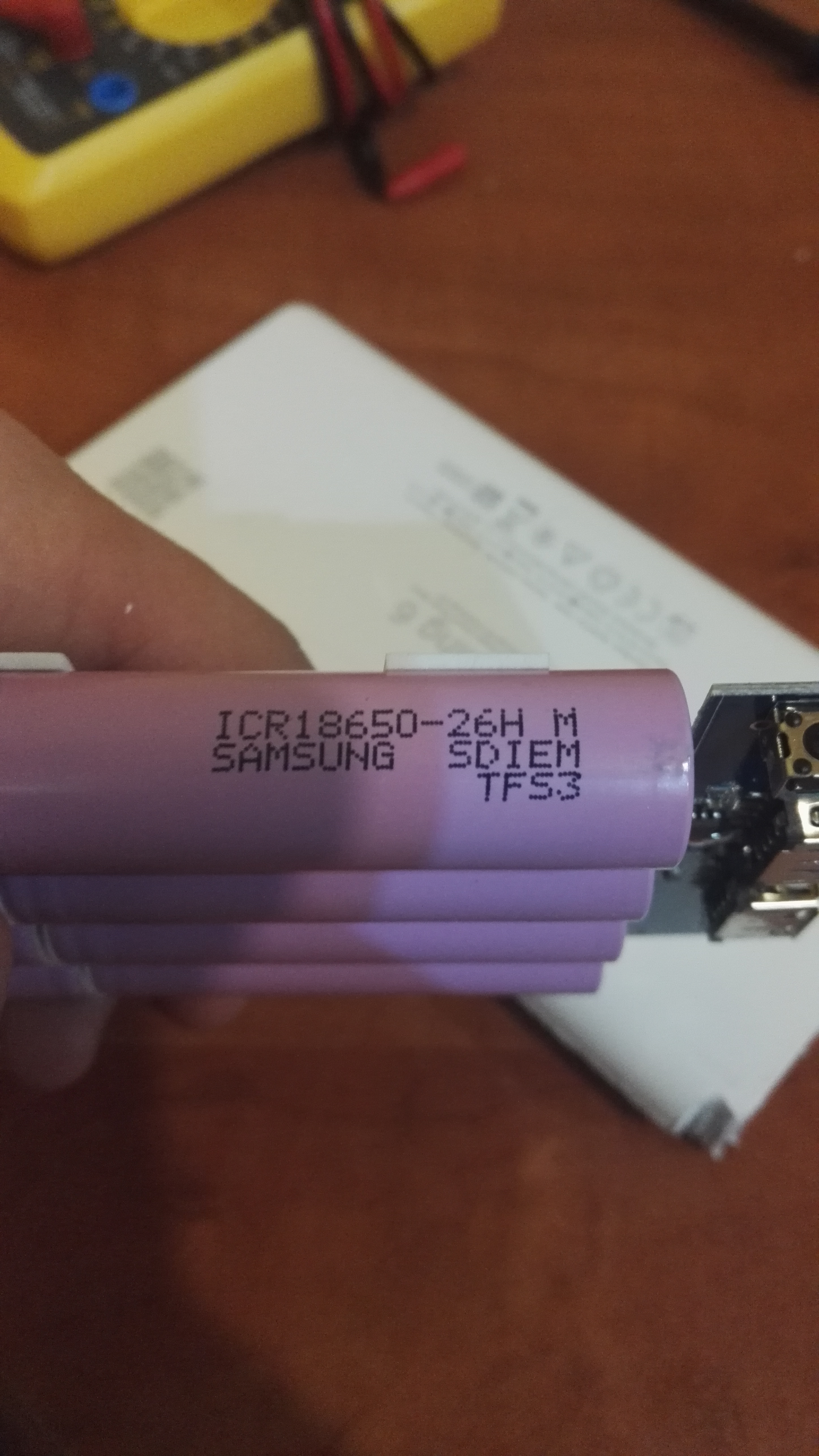

  • Measured 15 Ah output prompts search for 8-cell enclosure
    #26 16208462
    Dziczku13
    Posts: 25
    There is nothing to write about, PB goes to the bin and the cells stay .. The only salvation is to buy a new PB housing for 8 cells. From 10% smartphone to 100% smartphone where the battery is 3Ah, it was charged for 4h12min. So both USB charging outputs may drop, and that's a lot. Only the efficiency is still the same, because it will fully charge my smart 5 times .. With 20,800 real capacity of the cells themselves, I get about 15Ah. That is why I am starting to look for a ready-made housing with electronics with an efficiency of 80%. What ready-made housings do you recommend?
  • #27 16209502

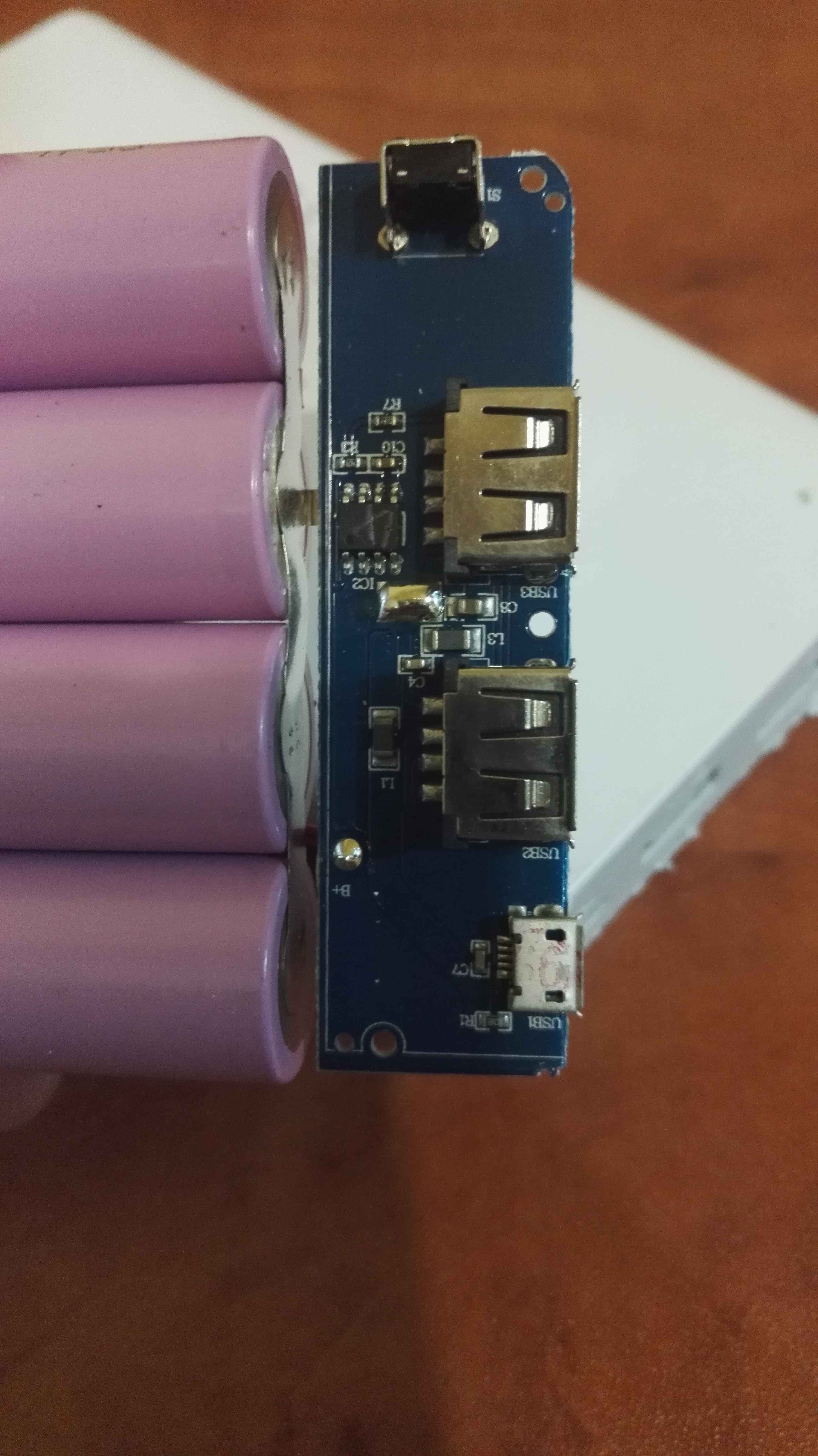

  • Damaged PCB short caused converter charging fault
    #29 16319692
    Dziczku13
    Posts: 25
    I want to say that some time has passed since the last post and after playing with my PB I ordered a new one and this one has a damaged PCB. I do not know how, but the varnish came off the PCB and exposed the paths, and then there was a short circuit and damage to the converter, which results in charging but with a slightly higher current than the standard USB gives. There are sometimes jumps from 650mAh to 930mAh and so it can still charge 680-720mAh for several hours. The 2A output has a max of 930mAh and the 1A output is 720mAh. It's a waste of time, so I ordered from banggood.com PB for PLN 25, I will only put the accessories in it and that's it .. Maybe the efficiency is not 92% but the 80% will be :)
  • #30 18448028
    Dziczku13
    Posts: 25
    After such a period, I want to say that I took the batteries out of the middle and made a new PB of them and they still fly and calmly from 0 to 100 will charge the Samsung Galaxy S7 Edge 4 times, I tested the batteries 3 times on the 1000 km route on Automap, where the PB can be calmly at the end of the route 20% of the capacity remains ...

The usual culprits are an open polyfuse, a shorted charge-controller IC, or reversed input polarity. These faults disable the DW01A protection chip, so the micro-USB port shows 5 V but no current flows[Elektroda, DVDM14, post #14745960]
Does a five-second top-up count as a full cycle?
No. Li-ion cycle life is calculated over complete charge–discharge totals. Two half-discharges equal one cycle. Brief connects add only tiny fractions[BatteryU, 2022].
What happens if I swap + and – from my bike dynamo?
Reversed DC melts the input TVS diode and can blow the 2 A polyfuse, killing charging but leaving stored energy intact[Elektroda, jdubowski, post #14746578]
How many full cycles can the original cells handle?
Samsung-grade 2 600 mAh 18650s retain ≈80 % capacity after 500 full cycles at 25 °C[Samsung, 2014]. Frequent shallow recharges can double practical life[Elektroda, DVDM14, post #14746710]
Is –10 °C storage harmful?
Mild frost slows chemistry but causes little damage if the pack is 40–60 % charged. Below –20 °C lithium plating risk rises sharply[IEC 62660-3, 2018].
Can I reuse the eight cells if the board is dead?
Yes. Unspot the nickel strips, test each cell; any measuring 3.0–4.2 V and <100 mΩ can be rebuilt into another 4S2P pack[Elektroda, Dziczku13, post #18448028]
How do I test the polyfuse?
  1. Open case and locate the green 5 × 5 mm PF1 fuse near micro-USB.
  2. Measure continuity; >1 Ω means tripped.
  3. Briefly heat with 60 °C air to reset, then re-measure. If still open, replace with 2 A rated part[TeardownPics, 2016].

Where can I buy a new PCB?
Search “4S 8-cell power-bank board 2×USB 2.1A” on Banggood, AliExpress, or Łódź electronics shops; prices range USD 6–8 shipped[Banggood, 2023].
