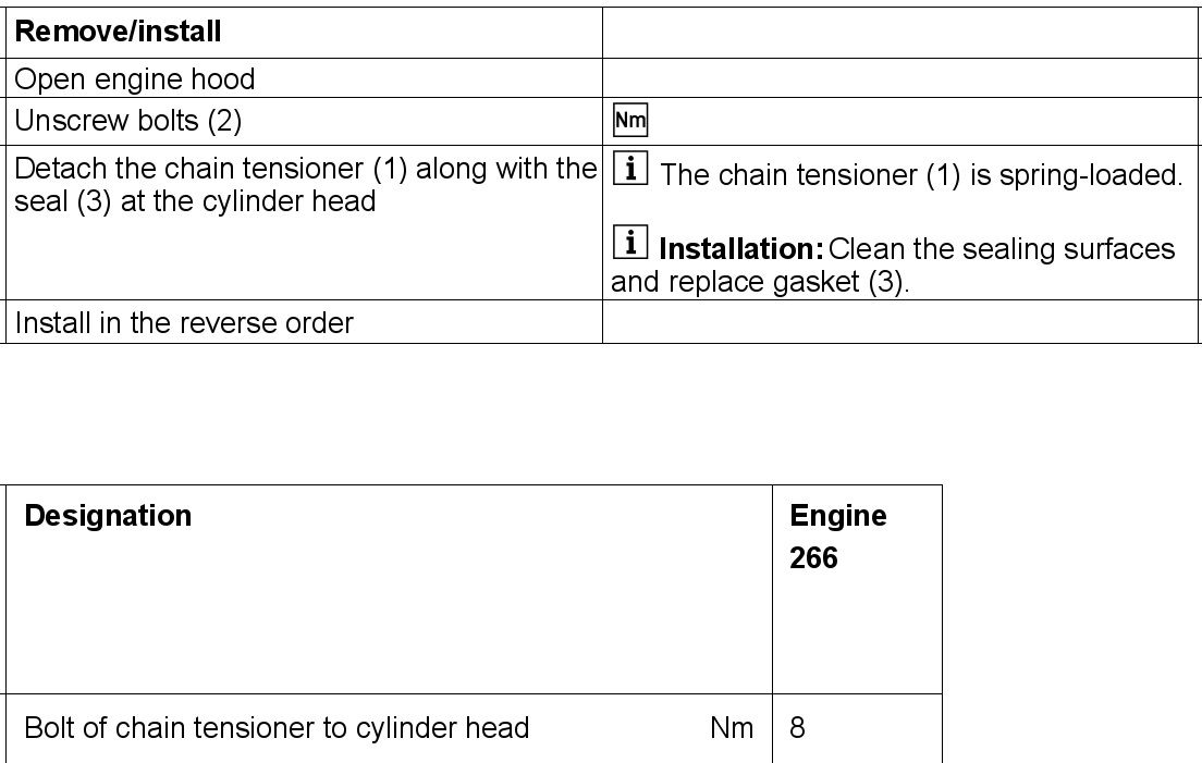

    Do you know what torque to tighten the 2 bolts holding the tensioner? I only have the book "I fix it myself" w169/w245 and there is nothing about it. So to sum up, I pull out the tensioner, put in a new one, start the car and it should be ok?

    #23 20358239
    Gerri
    Mercedes specialist
    Posts: 5699
    Help: 865
    Rate: 3629
    There are two types of tensioner on the 169 with the 266 engine - depending on the chassis number. The moment is the same in both cases.
    Below I have posted a fragment of the instructions for replacing the tensioner - so that it is not that I am talking untruth. If you click on the picture it will enlarge. I'm not a mechanic, I don't know how it works in practice, I just quote what the manufacturer says. It cannot be ruled out that in case of extreme wear of the chain and wheels, there is a possibility that the chain will jump. But why replace the tensioner itself in this case - how should the entire timing belt be replaced???
