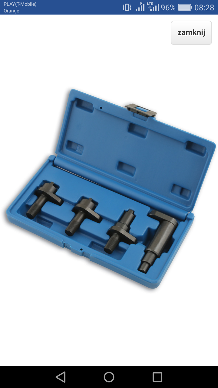

    I still need to try and with the cars I'm doing some kind of experience I already have
    These locks should match whether these two locks are enough

    Theoretically, you would do with those from the rollers, but you'd better buy this full set (blue box), probably not much more expensive

    Hello, in which places should you put these locks? I know from the fight and I can not find it from the wal
  • #7 16420952
    ociz
    Posts: 15844
    Help: 1379
    Rate: 3486
    At the rear of the engine in the flywheel, the largest blockade. This one is a bit smaller for engines on one shaft.

    Just remember not to tighten / turn off the timing gears on the placed locks on the back of the fight, because the lock you shoots.

    I am looking for and looking for and I can not find any hole or plugs around the flywheel
    Of course, it's about blockade of the shaft
    Yes, I know not to tighten or unscrew on locks

    colleague drdrug probably sent you a diagram with AutoData on PW, and there the drawing is quite unhappy, but take a good lamp and you will surely find a hole for the blockade.

    Thanks a lot but I found it, I did not think it would be so hidden
