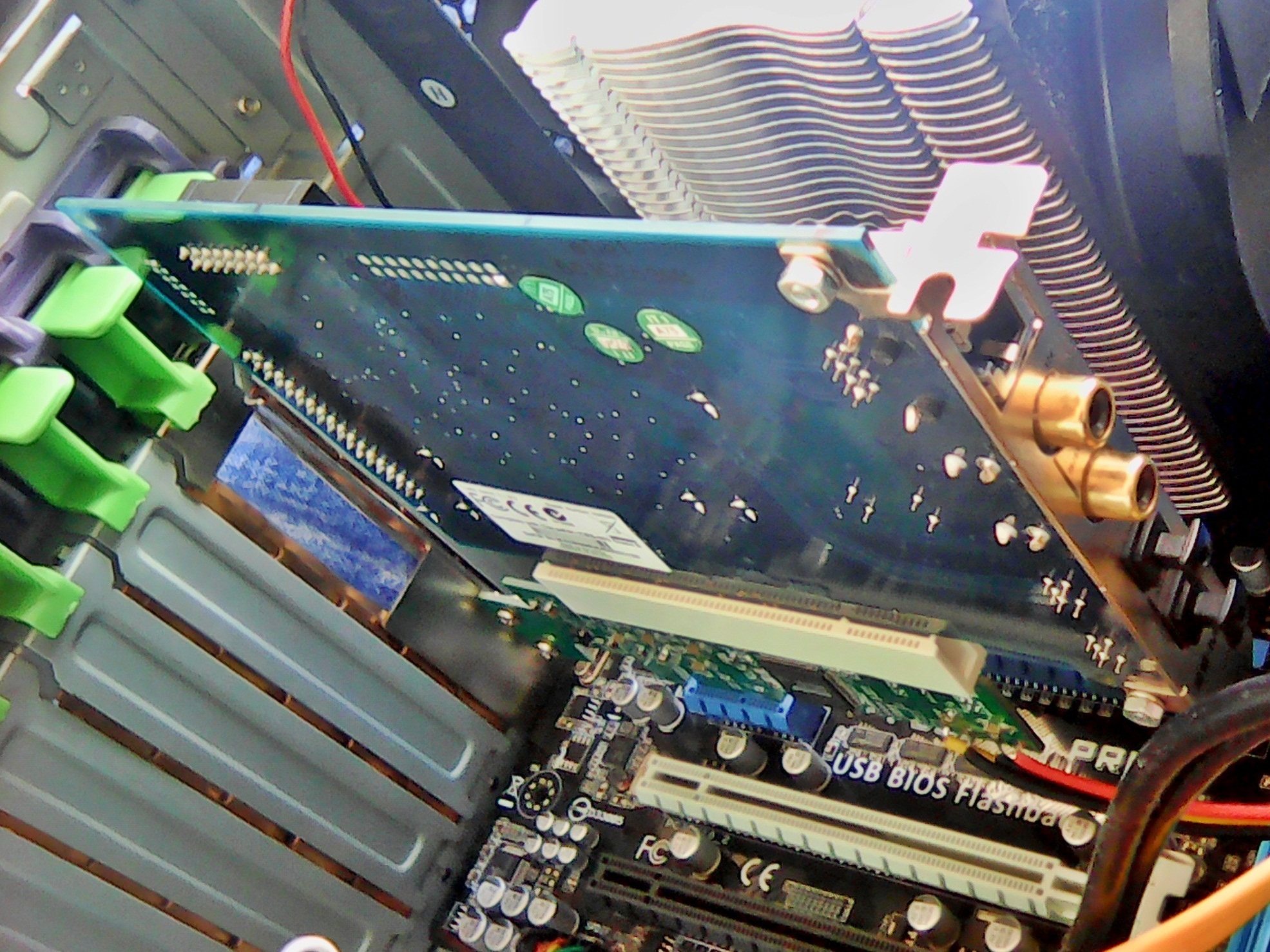

    Hello, forum elektroda.pl, [sorry for the lack of pl characters, unfortunately the keyboard is broken]

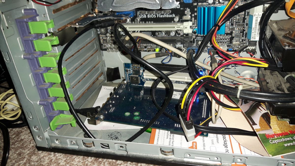

    I have a question and a request for help. My motherboard does not have an older PCI slot. Because the sound card that I really care about works only on such a slot - I bought an adapter that uses the PCI-E slot and the problem would be over if it wasn't for the limited space, besides, the mounting pegs overlap and if it's not a problem, remove one of them, I noticed that physically the card could be turned to the inside of the computer and not to its outside. So here's my question: is this allowed? The number of paths is identical and the same on both sides, so the cuts and the septum fit both ways, but is it actually possible for it to work both ways? [see photos] I don't think so, but since I really care about this card, I risked asking this perhaps naive question,
    PCI-E to PCI adapter - sposoby montazu PCI-E to PCI adapter - sposoby montazu PCI-E to PCI adapter - sposoby montazu PCI-E to PCI adapter - sposoby montazu PCI-E to PCI adapter - sposoby montazu PCI-E to PCI adapter - sposoby montazu
    Please explain if this is acceptable?
    Thank you all for every post on this matter, greetings.

    #2 15021790
    Kolobos
    IT specialist
    Posts: 85178
    Help: 17171
    Rate: 10454
    Type in google: IDE and see what such a connector looks like... then change all IDEs to PCI in your post.
    The card will not work mounted the other way around. You will probably burn the card and/or the disc.

  • #5 15023890
    vxn
    Posts: 27
    You can combine with a riser for PCI - e.g.:
    http://www.dx.com/p/32bits-single-slot-pci-ri...n-cable-for-2u-grey-green-147210#.Vgc74LSrEwQ
    and then you stuff it inside the computer
    or with a PCI-e riser
    http://www.dx.com/p/pci-express-pci-e-1x-to-3...er-ribbon-cable-for-1u-2u-155034#.Vgc8mbSrEwQ
    - then you can throw it outside the case. In fact, it will look... well, hopeless :P But if you don't care about looks, you know :)

  • #8 15025897
    tzok
    Posts: 38873
    Help: 3175
    Rate: 6543

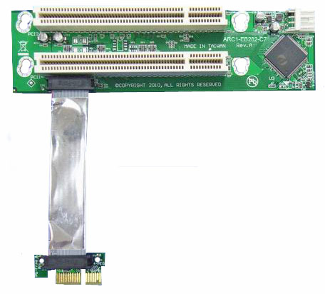

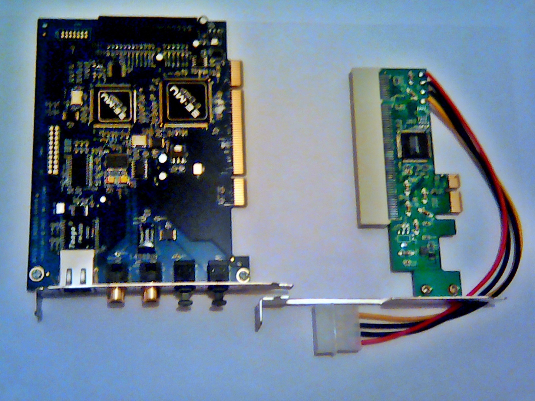

    Unfortunately, your adapter is only suitable for low-profile PCI cards. There are the following adapters for full-size cards:
    They are placed below the motherboard (micro ATX board in an ATX case).

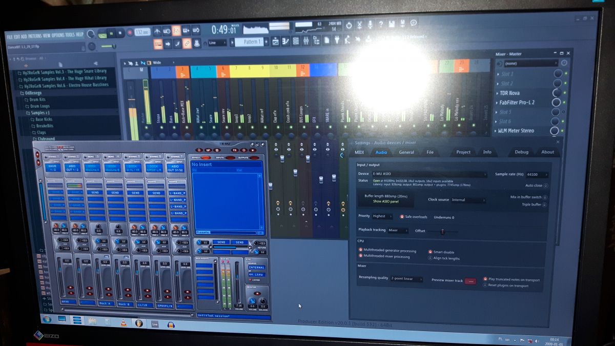

  • #15 18431040
    GRL
    Posts: 27

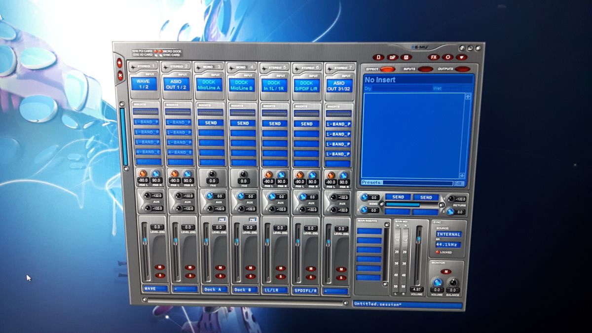

    I launched the card and it works great, my workstation is an intel i5 2500K 4.5Ghz (overclock), the card in cooperation with this processor recently pulled over 30 synthesizers and exactly 70 effects plugins in DAW FL Studio 20 - it's not bad ... my version it's EMU 1616 ... I had to mess around a bit but it paid off because the card is good and can do a lot, although it is not of its first youth, with a heavy load, unfortunately, you have to accept the latency of 10-20 ms
    64-bit drivers work perfectly for me, so there is no problem with that, you need to install EMU Patch DSP Mixer which, in addition to the mixer interface, also has all the drivers for WIN7 x86 or x64
    Thanks to everyone who helped here

    Can you write the exact model of this adapter and provide a photo and/or link - can I see correctly in the photo that there is a USB connection? Couldn't you screw this adapter more to the left so that the track of the PCI card fits the computer case and you can screw the PCI card with a screw?
