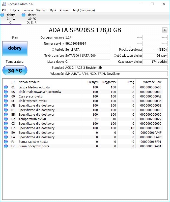

    SMART from the second disk provide.

    Removal of the (complete) KMS had no effect. I am sending SMART of the second disk:
