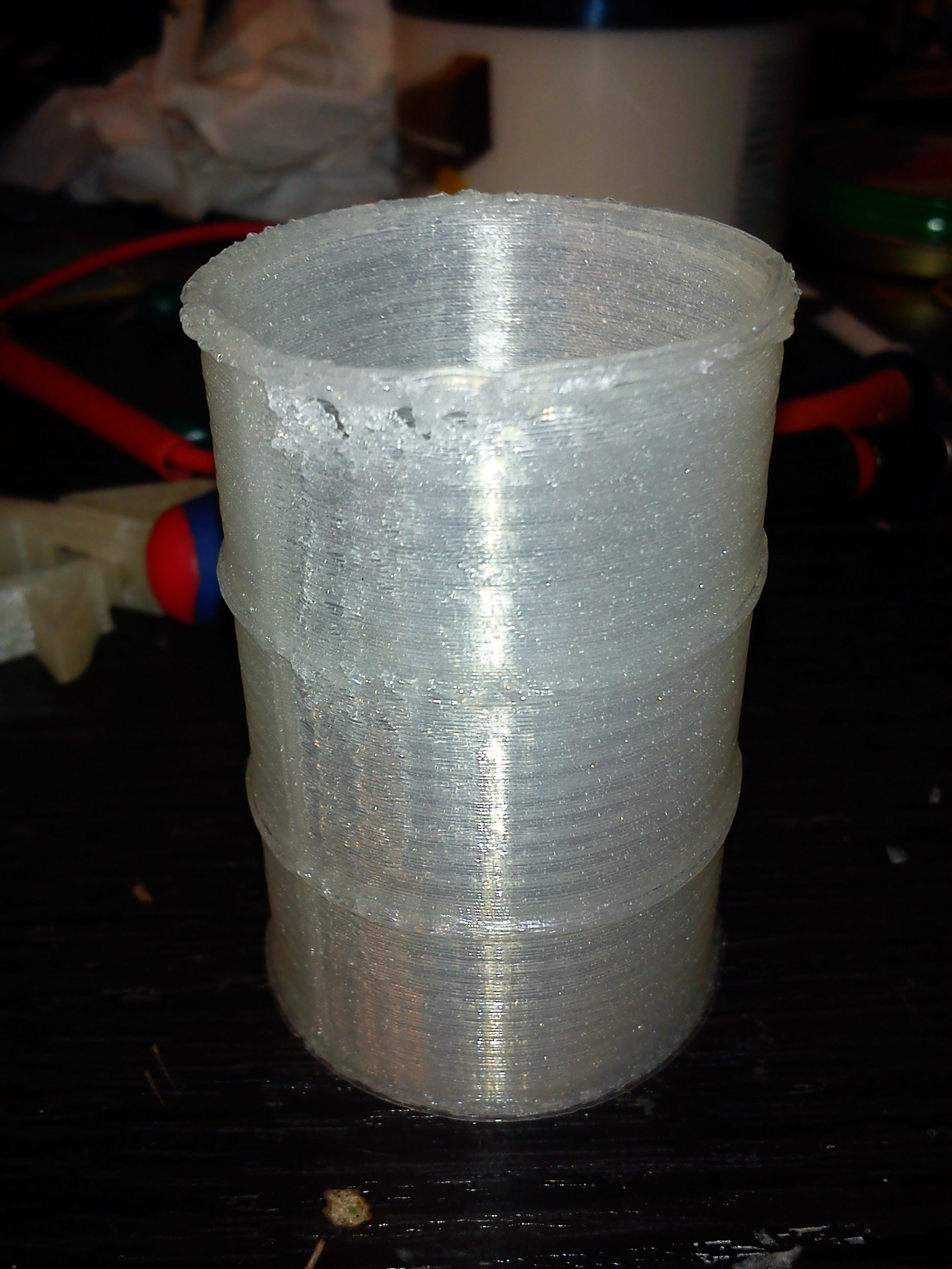

    The big problem turned out to be the Chinese head, because of the heat sink. Its core right on the heat block was incredibly thick, so that cooling at the most critical point was severely limited. This caused the head to clog during operation. The problem was solved by removing the excess material and hot-tightening the nozzle to the heat block. Currently it performs quite well for heads that can be bought for $4 each. :P
    Generally the printer will work on anything that will let it move, but it is worth getting the extruder right or buying a Goliath and an E3D head. The solution is not cheap, but if someone can afford it and doesn't want to tear their hair out, it should be a pretty good solution. Or at least everyone praises them. :)
    The price of the whole thing isn't even as frightening as some people scare, it cost about PLN1000-1200 and a lot of costs could be cut. I bought 3 times as many screws as I needed, trapezoidal nuts with flange are 2 times more expensive than trapezoidal ones, if a friend prints the parts for us at cost, we are another 200-300 zł ahead.
    The printer is still being modified, but it is already printing quite well. Below is a sample print where I increased the speed during printing to 170%. The holes on the top could probably be avoided with cooling and the Lift Z option in the slicer. :)

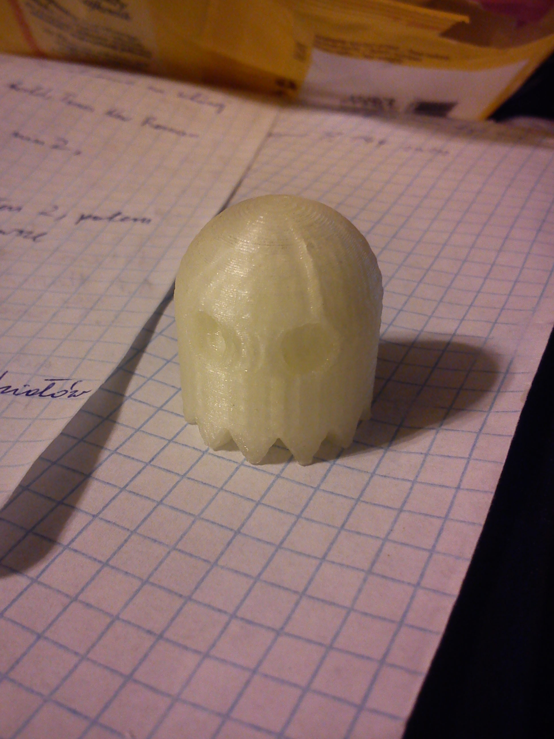

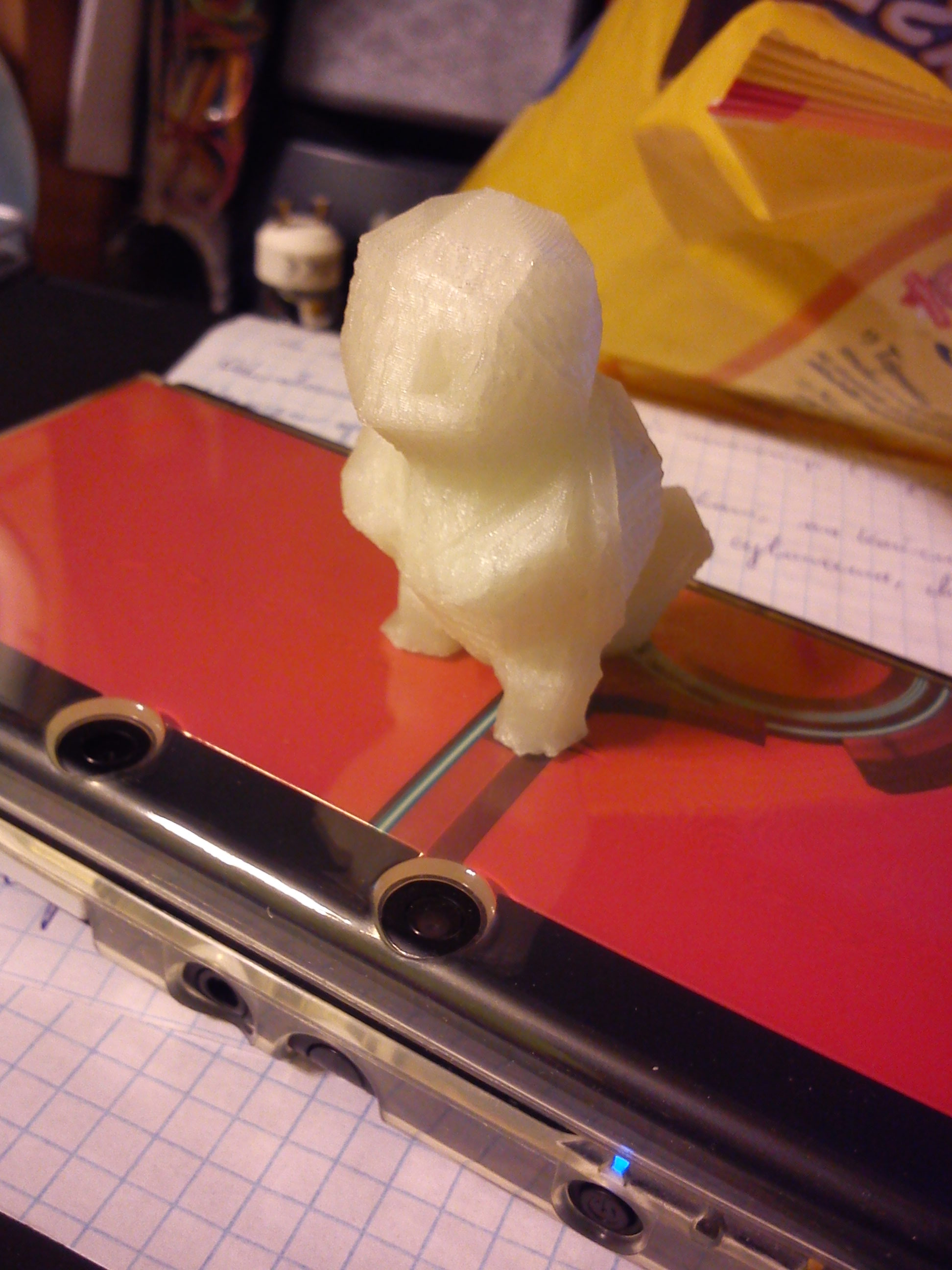

    Quite interesting. How long did it take to print the item shown? Is that red table heated? What are these heated tables for?
  • #3 15299867
    kiriki-kun
    Posts: 21
    Rate: 15
    I can't cut my head off, but probably about 30-40 minutes. Some time ago I printed this :)
    Yes, that red thing is a heated table, a "PCB heatedbed" to be exact.
    It improves the adhesion of the prints which with ABS for example is very helpful.
    A more recent print on which something already looks :)

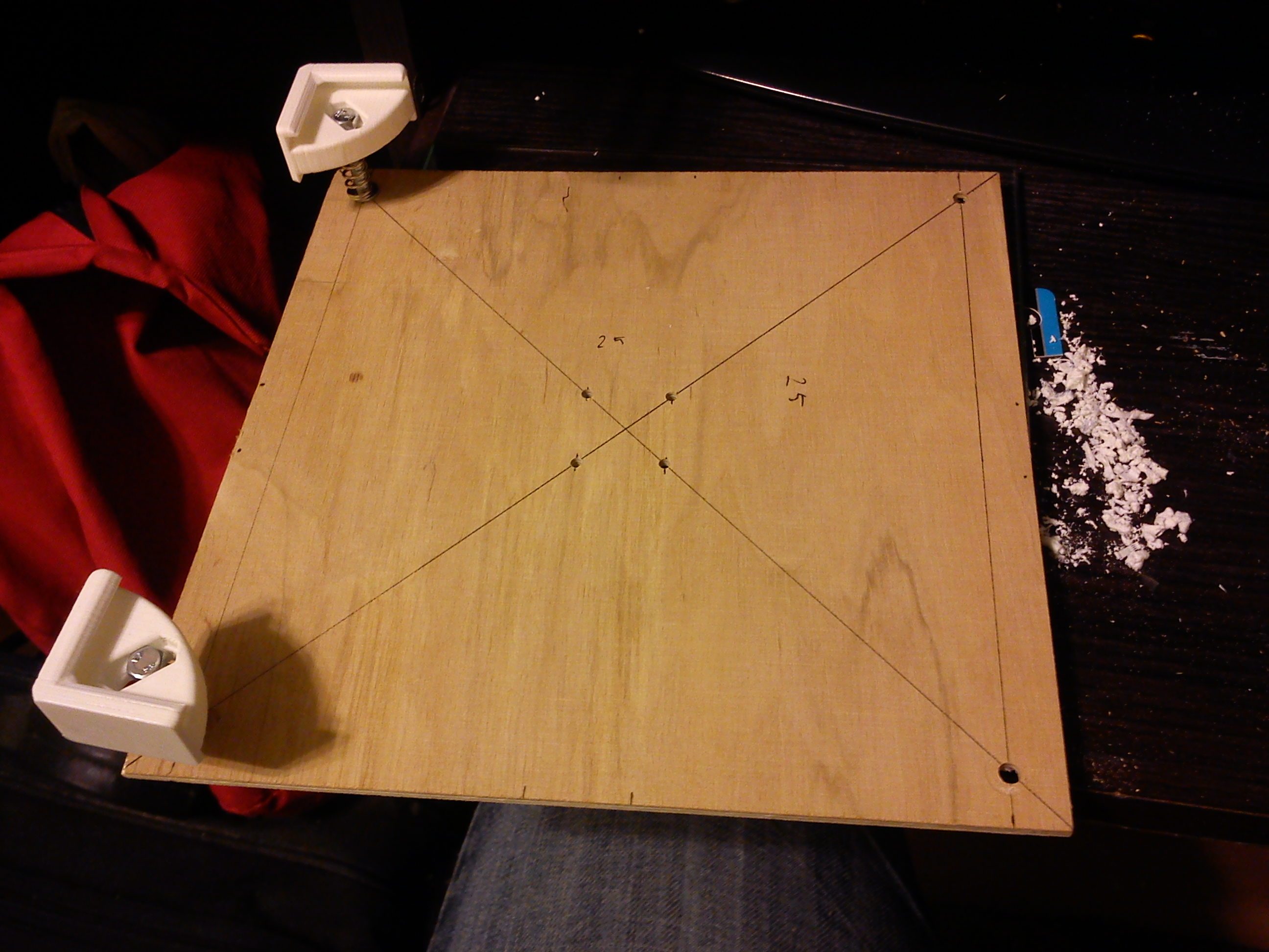

    Which glass do you use?
    All the ones I've used (tempered and regular) warp and I have constant problems levelling the table because of it. I'm thinking of adding an extendable z-axis probe, but I see it's not there at your place and it works.
  • Clamped windscreen glass works at 60°C for printing surface
    #5 15301664
    kiriki-kun
    Posts: 21
    Rate: 15
    Ordinary, cheap windscreen from Allegro :)
    It is not rigidly fixed, but with clamps, and is only heated to 60 degrees. Maybe that's why nothing happens to it.
    By the way, I didn't know something like that could happen.
    As for the levelling, it's very much by eye, but I'm not complaining.

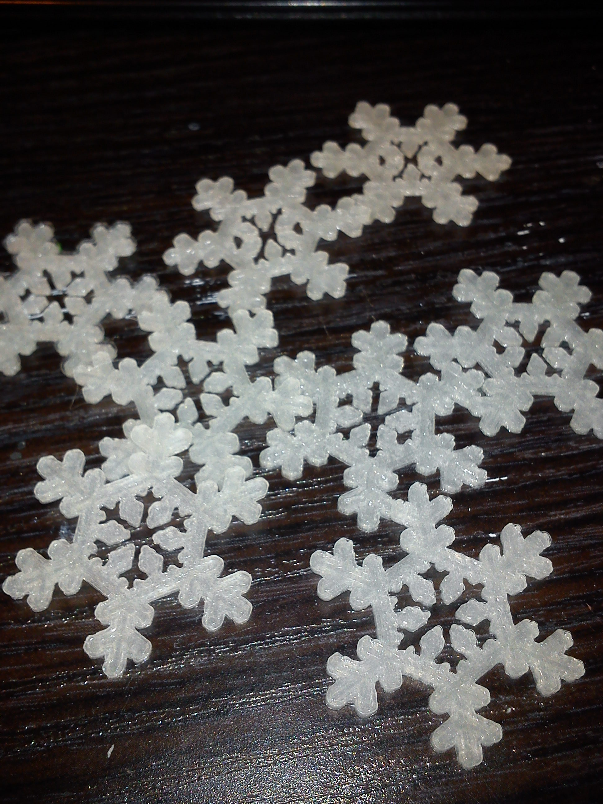

    And below are another handful of prints. I have a chance to show off and in addition you can look at how the quality of the prints looks :)

    Very nice snowflakes, as for the first cats behind the fence these are getting better and better prints, a colleague after 3 months of trials and tests finally gets amazing prints also patience and it will pay off :)
    Greetings
