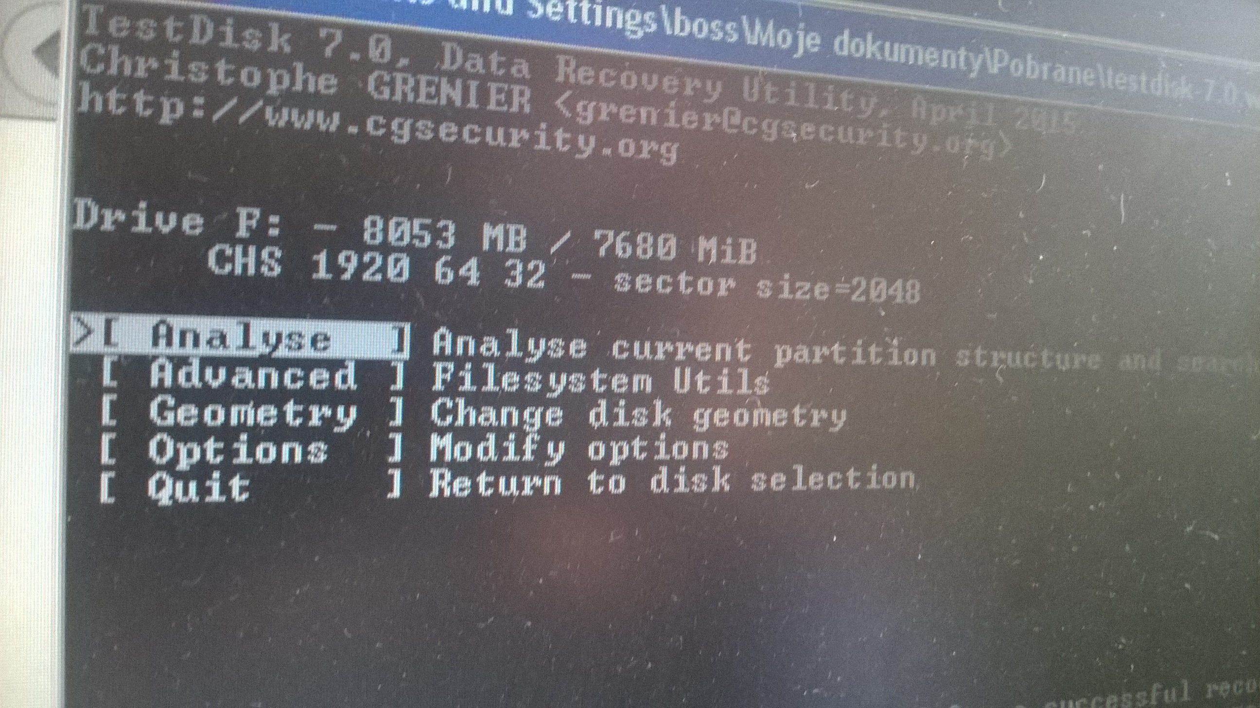

    oto screen

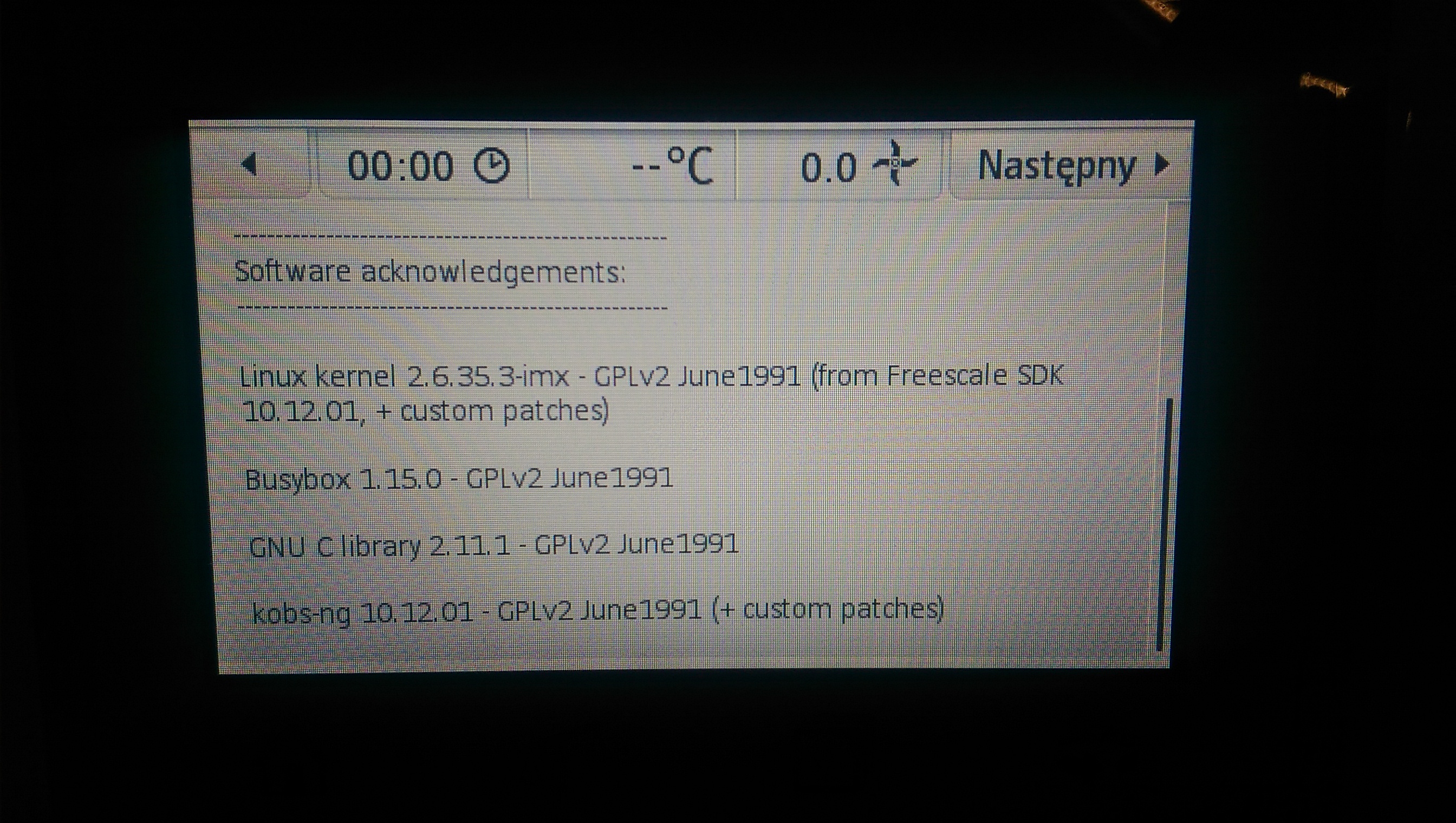

    This is Linux hardware.

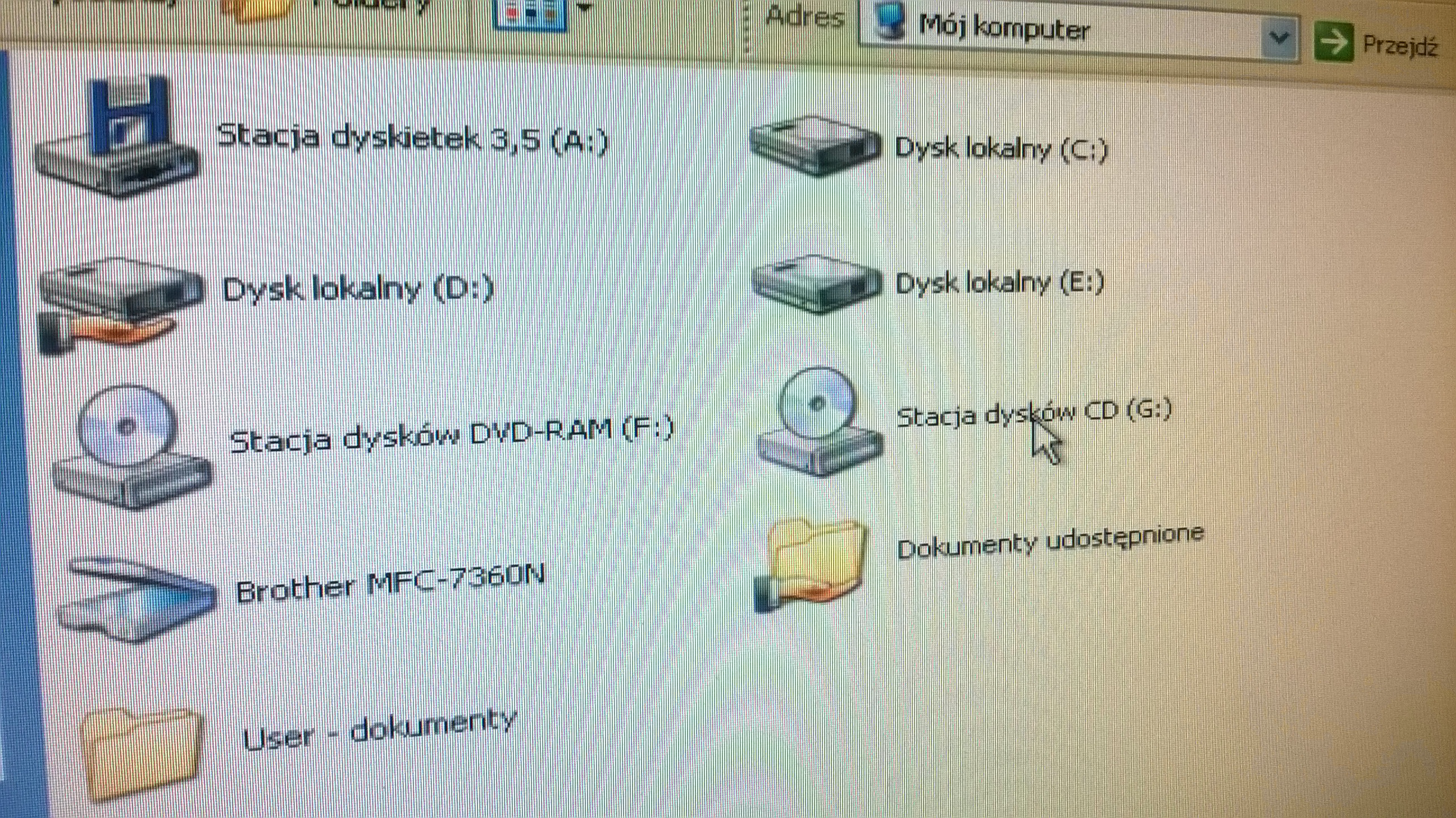

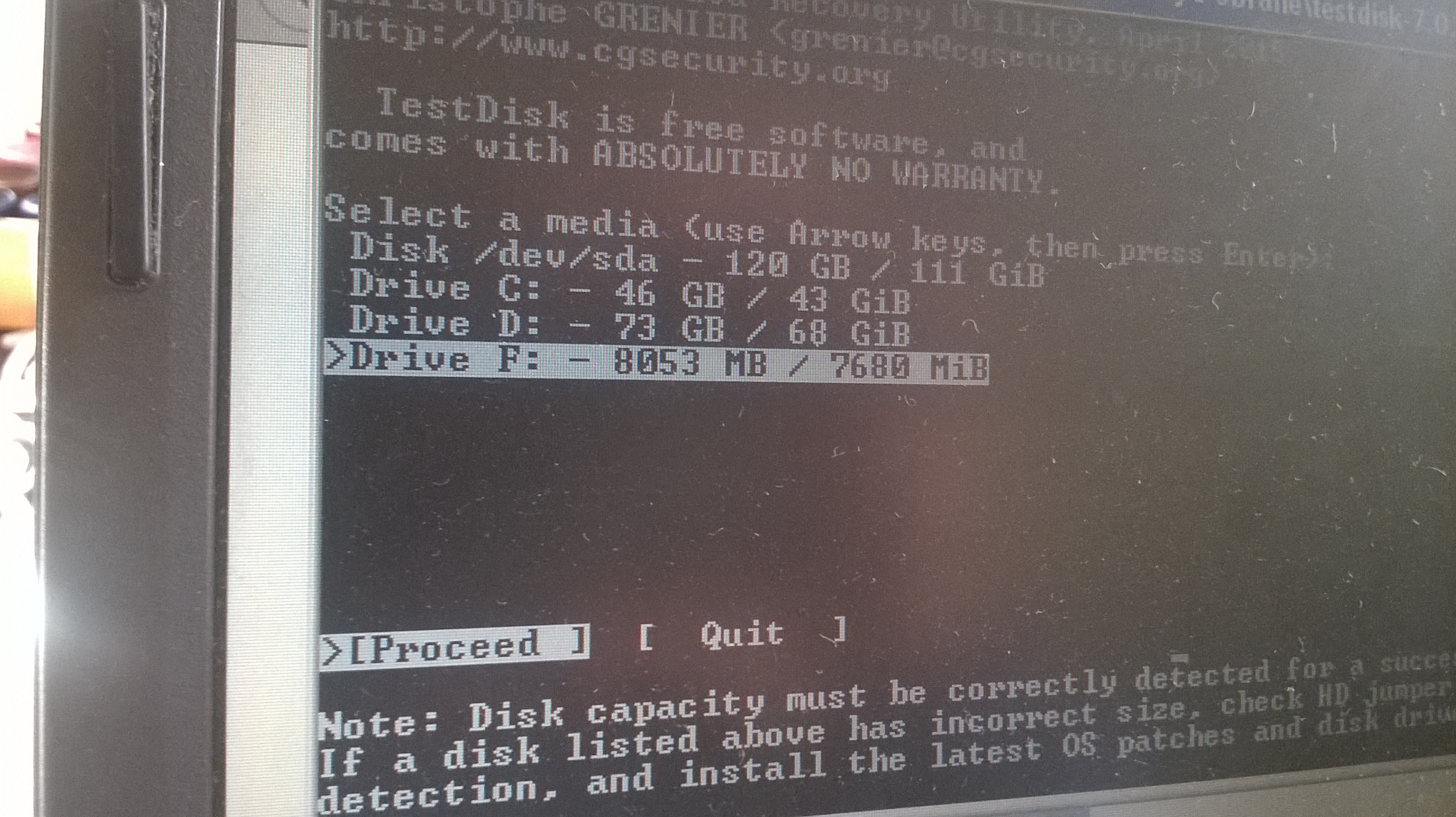

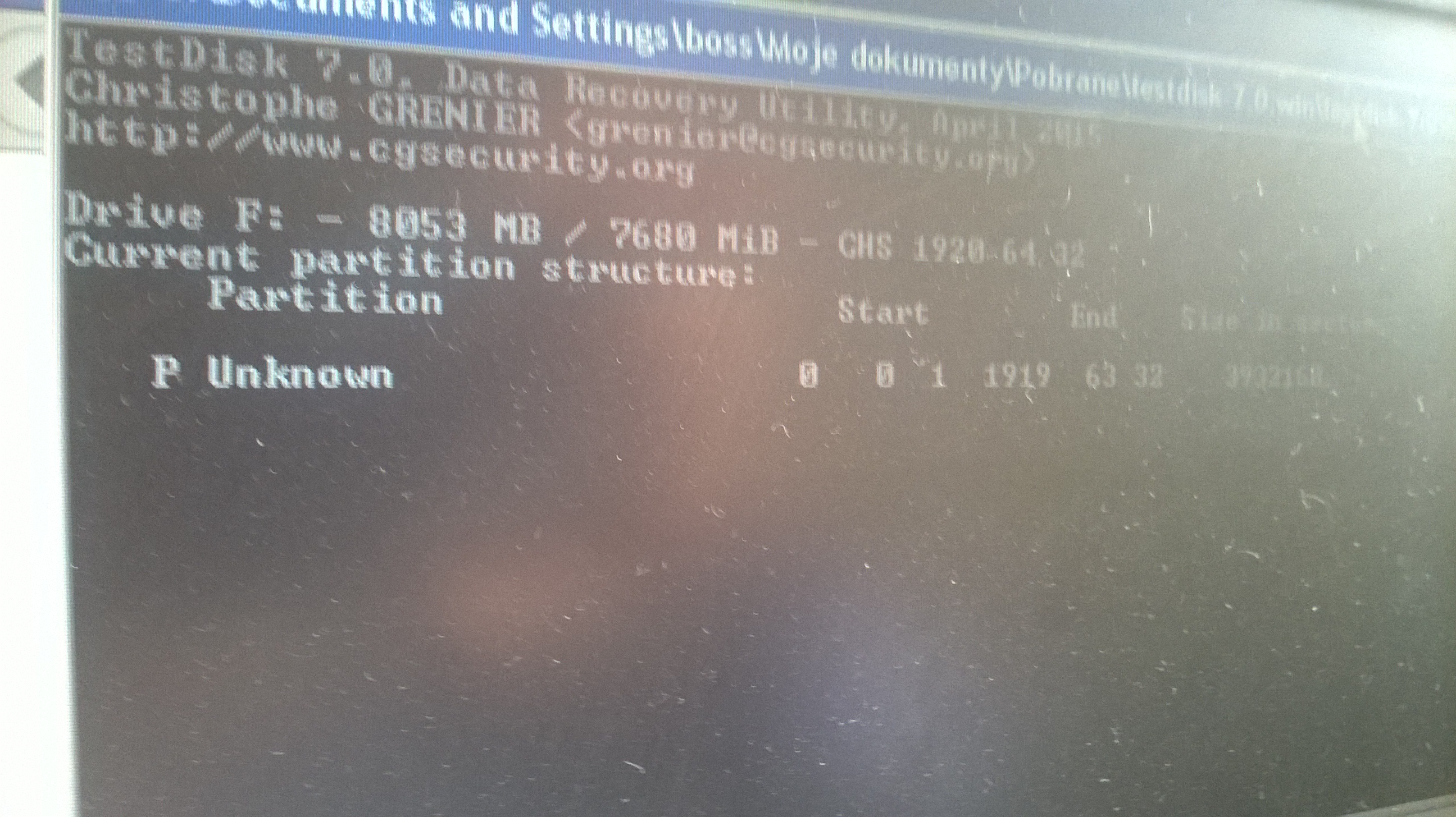

    From what I can see on the screen, it looks like a typical 4GB flash drive, but formatted with a file system unknown to Windows. Ideally, you would snap it into a file as a raw image, then you might try to figure it out. You can use the HDD Raw Copy Tool from hddguru.com (I cannot insert links :( )
  • #12 16015096

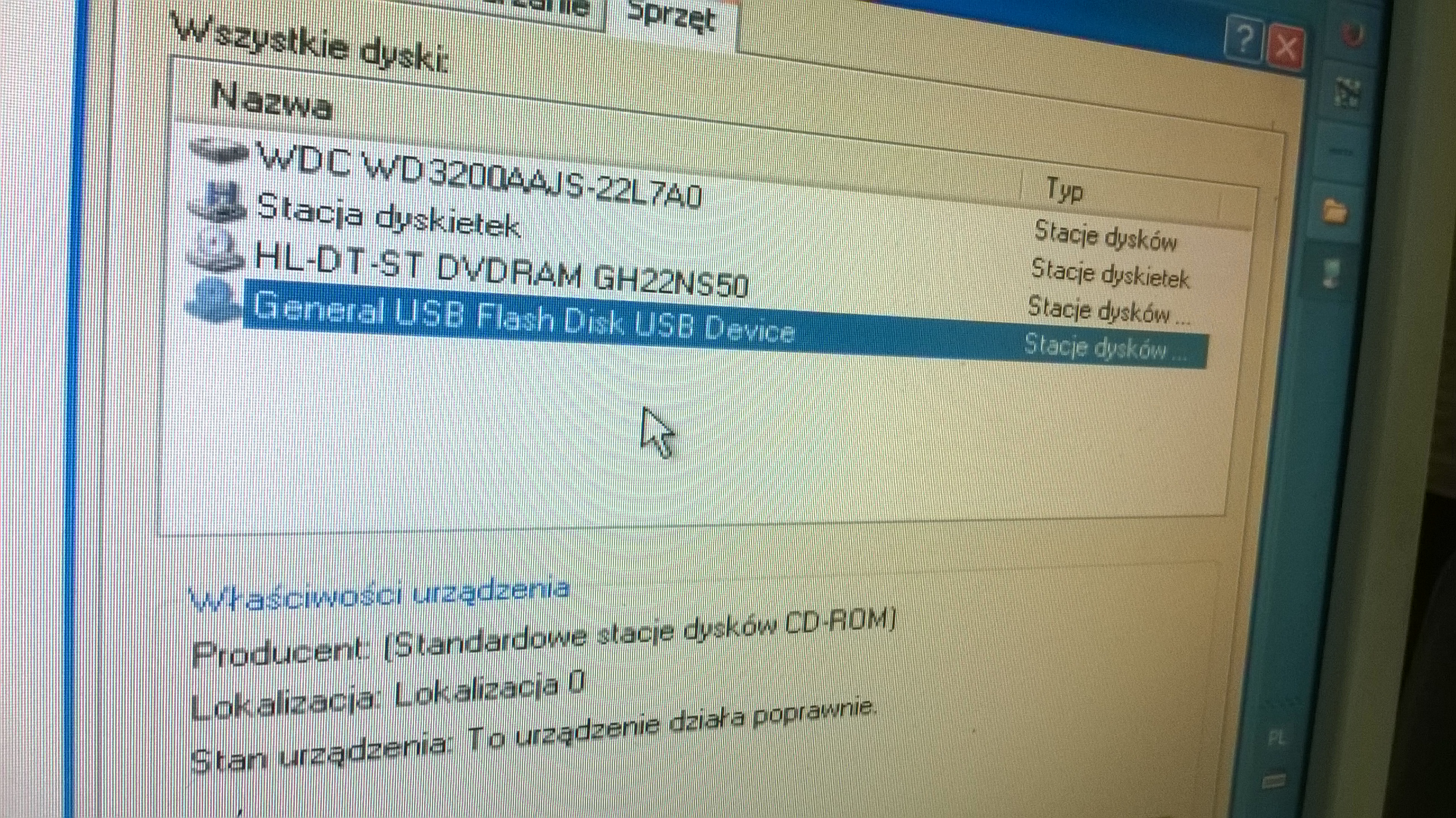

    wseh1322
    Something flickered on the subject?
    I use windows XP, I have the reader as a CD drive after connecting via USB, of course, it is impossible to enter due to the unknown file system. But I recognize the reader as 8GB. I am posting a few pics. Maybe someone knowledgeable in the subject say whether you can bite this topic? It's about the content, for example, there are 2 readers with ABC and Wega recipes, what to do to rip everything on one and make it go wild. The first 2 is disk G, because on a different computer, and a few photos from disk F
    Please contact a specialist who could help in the subject.

    Could you connect it to Linux?
    Thermomix, as I wrote above, runs on Linux.

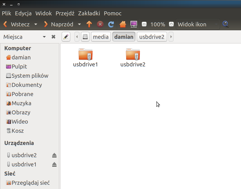

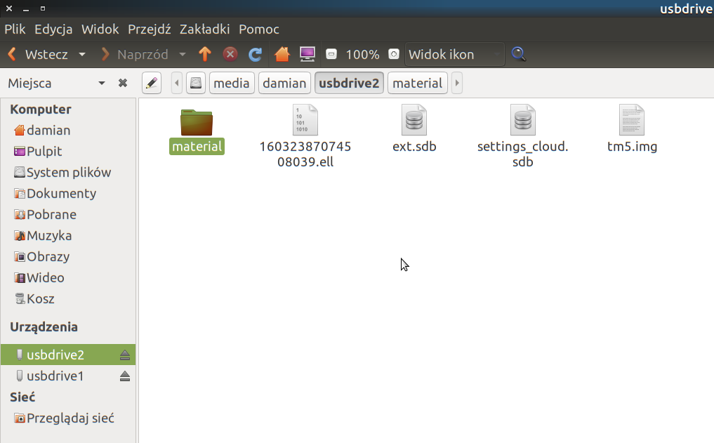

    Good morning,
    Someone asked if there was anything in the topic, so we have a small step forward. The media opens without any problems on ubuntu.
    I am throwing a few screenshots and a package with all the content.
    The medium has probably 2 partitions, on the first there is a package in which it seems to be the same as on partition 2.
    Thermomix TM5 Recipe USB Memory Disassembly, File System Exploration & Editing Recipes
    The second partition looks like this:

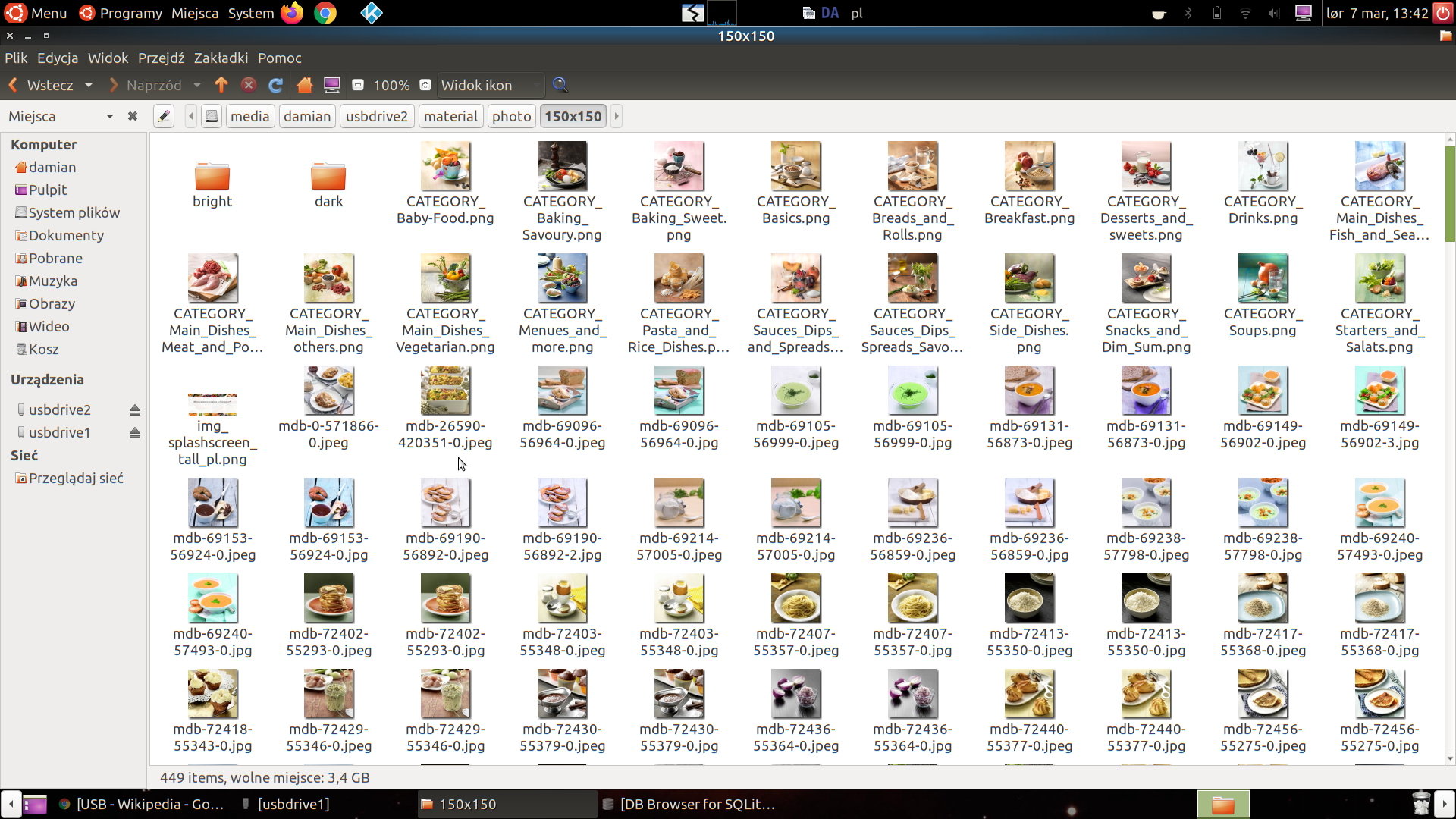

    And one example folder:
    There are a lot of * .bin files and a few sql database files, so uploading new recipes will not be that easy, but probably not impossible.
    This medium comes from a cook-key device, and I disarmed it because it stopped working. i.e. after connecting to the Thermomix, it resets it and the device cannot be turned on. Thermomix keeps trying to start up but resets again and so on. Maybe someone has an idea how to look for errors in the snap-in itself?
    So the HFS theory fell?
    Nobody opened with DMDE as suggested?
