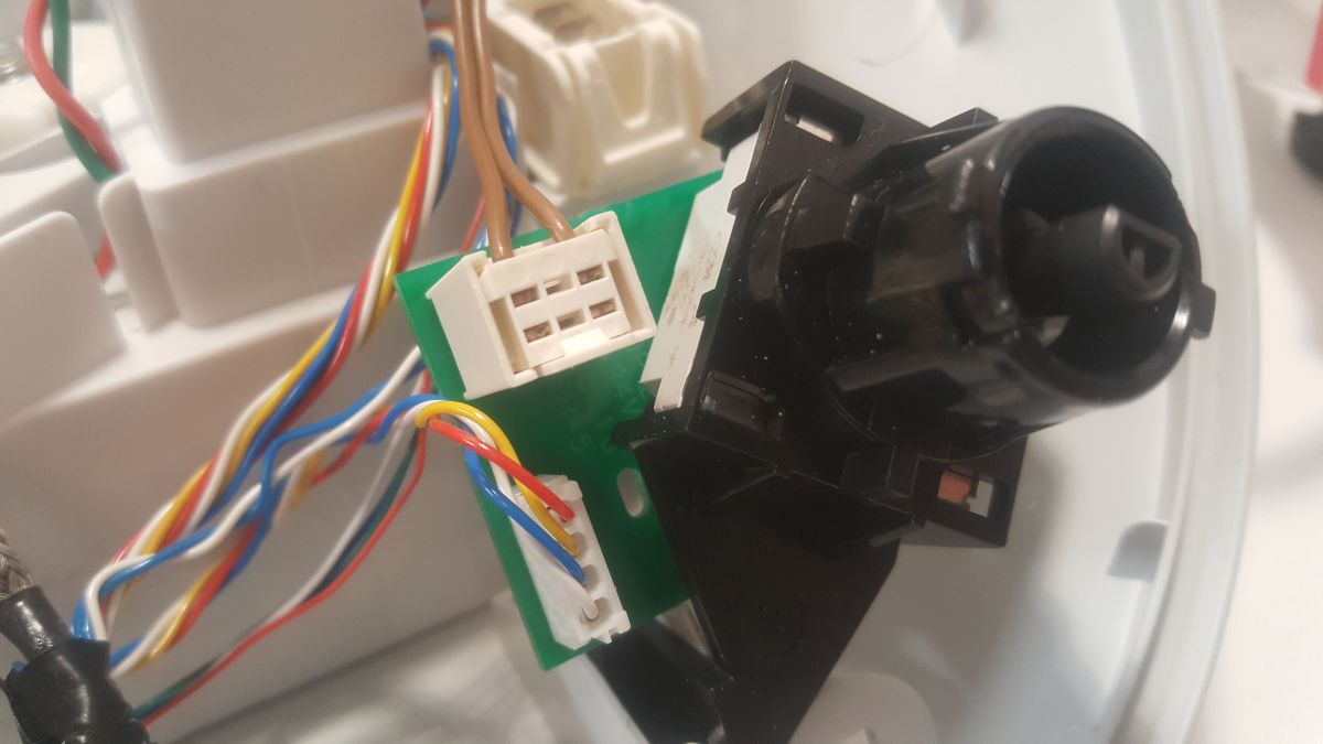

    I have a problem with "jumping" values when setting the time, temperature or revolutions.
    Writing graphically:
    I have set the time e.g. 00:10, gently turning the knob should set the value 00:11, meanwhile it jumps to e.g. 00:45, the next turn sets the value e.g. to 01:24 and the next e.g. to 00:15 or 03:43 (there is no regularity, once it jumps down once and up).
    It is the same with temperature and rpm setting.
    Has anyone had a similar problem? What was the reason?
    greetings

    Hello. Undress and lubricate the potentiometer. Unfortunately I did it.

    Colleagues, are you sure there is a potentiometer instead of an encoder?
    WD40 I advise against electronics.

    the swab in the film undresses it to a measure properly, screwdriver - torx 5 (I think). The dial is quite an unusual encoder. Absolutely NOT WD40 !! I usually use a thermoplastic preparation for contacts and potentiometers - contact pr ... you want pictures of this part (I recently repaired termomix 5)

    Disassemble the front cover, note the short wires from the "encoder".
    Disassemble the knob (lift it gently!), Under the knob the white ring (it has 2 latches) which you need to unlock and move the white ring to the left. You can then easily get to the entire "encoder". Disassemble 2 plugs and continue working with the "encoder" , clean etc. Thermomix TM5 - jumping values when setting time / temperature / revolutions Thermomix TM5 - jumping values when setting time / temperature / revolutions

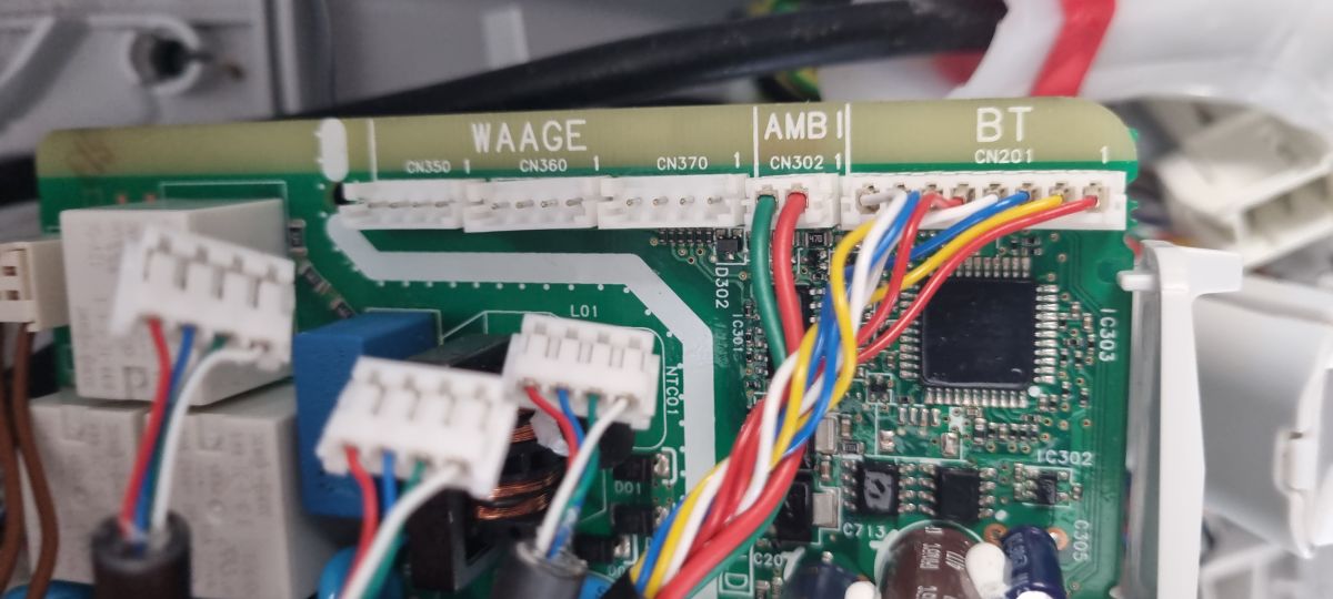

    Hi I need help with thermomix TM5 rewiring circuit board back up, theirs 3x 5 pin connectors that look the same, which connect to board labeled cn350 cn360 cn370, and the cables aren't labeled

    Hi just checking that we're talking about the same connections here a photo Close-up of a printed circuit board in an electronic device with colored wires connected to connectors.

    Yes, these are the connections. The wires are terminated with strain gauge beams in the feet of the device. It does not matter where which one is connected. Calibration takes place each time the scale is tared.
