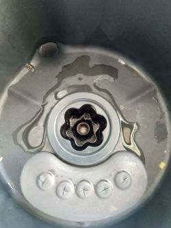

  • Hello.
    I would like to inform current and future buyers of the thermomix TM6 device about the possibility of the mixing knife wearing out too quickly (for me), which results in leaks from the bottom of the mixing bowl. During the sale, the employee did not mention anything about the knife wearing out. Of course, he mentioned that if the knife gets dull, it can be sharpened by crushing ice in the device. The user manual provides a table that informs when it is recommended to replace the mixing knife.
    Termomix TM6 - worn mixing knife, causing leakage from the mixing bowl.
    Several friends have different versions of the device and the earliest they had to replace the knife was after 6-7 years. Everything is fine, but our device is 2.5 years old, so it is just out of warranty. We crushed the ice maybe 10 times, and ground the grains a few times to test it. Generally, we cook soups and make cakes in it. I don`t think it`s "hard work" for the device. My sister-in-law has the same problem, except that the device is 1.5 years old, so it is still under warranty. In my opinion, this is an obvious mistake by the manufacturer of the device that cost a lot of money. It smells "Chinese" to me here.
    At first I suspected the seal between the knife and the bowl of the device.
    Termomix TM6 - worn mixing knife, causing leakage from the mixing bowl. Termomix TM6 - worn mixing knife, causing leakage from the mixing bowl.
    I contacted the service. The employee claims that since the new version of the device entered the market, there has been no case of the above-mentioned seal breaking down, and the knives have as well. How to recognize a used knife? After that...
    Someone will say that it is just a slight leak, and there is a drain in the device. Yes, yes, but over time the leak becomes larger (these are photos from the beginning, when I still thought that my wife had something leaking on the outside of the vessel), it fills the "star" and floods the inputs of the power pins, and in such a situation it is a simple step to a short circuit and serious failure.
    There was nothing left for me to do but buy a new knife, which I did. The cost is considerable - PLN 254 (I got it on Black Friday for PLN 204). After installing the new part, there was no leakage. There is no play on the knife axis - the old one could be moved sideways to a small but noticeable extent. The bearing seal is probably worn out.
    I`m not saying that the device is bad because my wife is very satisfied, but the quality of the knife for such use is insufficient for me. Buyers should add the cost of a new knife (it comes with a seal included) to the operating costs.

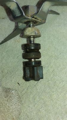

  • Bearing and seal replacement restored the mixing knife
    #11 19789387
    r3w4rd
    Posts: 145
    Help: 29
    Rate: 51
    I had a HOFFEN CE-2000 S robot repaired. Here, the "upper" bearings in the knife and the "lower" gear bearings looked like this:
    I replaced the bearings, oil seals and segers with new ones with increased operating temperature. It cost me 1/3 of the price of a new knife for this model.

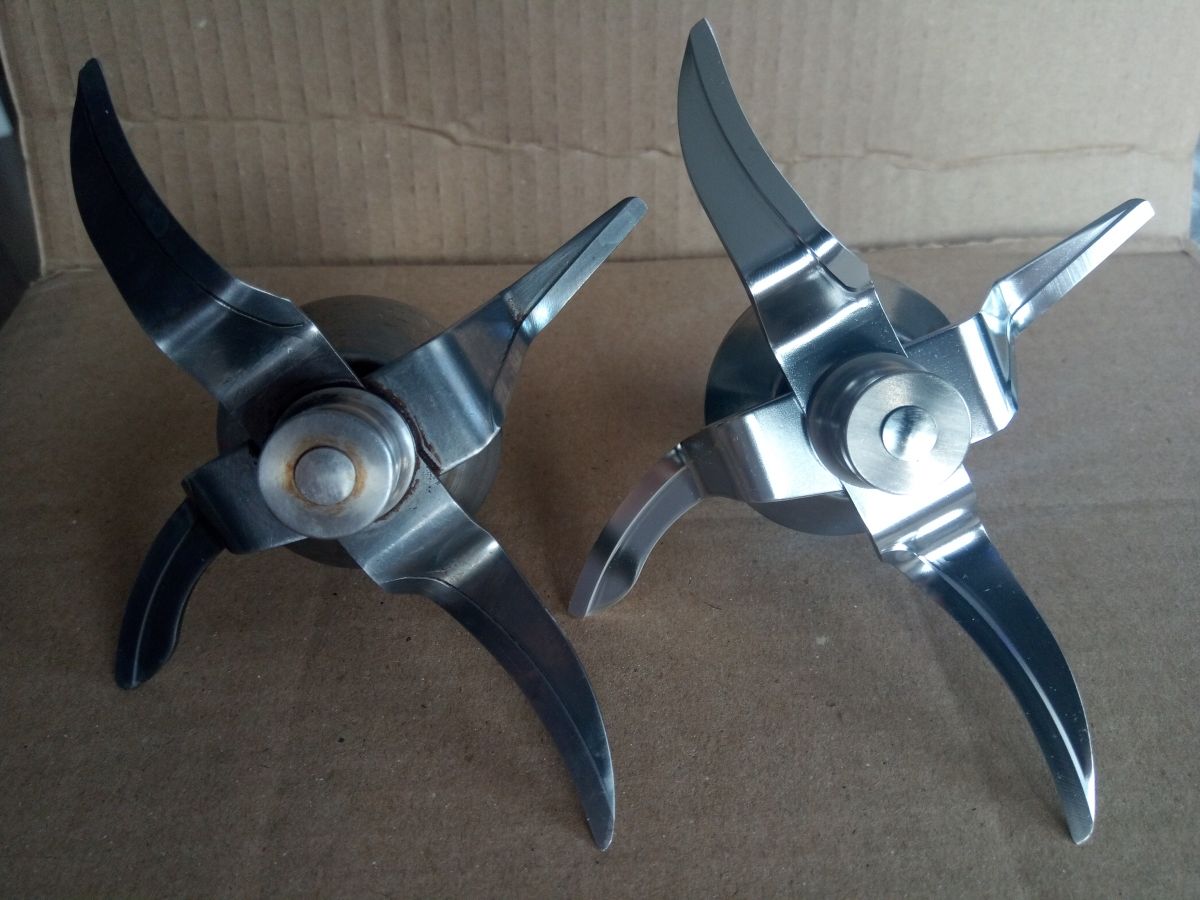

  • Knife wear appears minor; asking how to disassemble it
    #24 19792086
    afro78
    Posts: 12
    Rate: 32
    E8600 wrote:
    They invented these durak machines because "babies" stopped being able to cook. :not:
    Honestly, I would rather learn to cook myself if I couldn`t, or send a woman to Geslerowa, than invest in such a device.
    As for the price, it`s enough to go back to when 20 years ago, shows of "wonderful" stainless steel pots were introduced in our country and the exhibitors were as naive as they wanted, e.g. a set of pots for PLN 5-10,000, and today you can buy the same set for PLN 200.
    My wife cooked very well and still cooks without TM6 (although now more often with TM), I only wash it and if I cook it, I cook it "the old way". The advantage is, above all, the speed of doing certain things (chopping vegetables - uno secondo and yes, kneading dough for cakes/dumplings, etc.). With the varoma you can make an entire dinner in one go without using, for example, three pots. In general, people who use/have used it should comment on the effectiveness of Termomix, not dissatisfied people who have only seen it and heard something about it. I admit that I still consider the purchase of TM6 a waste of money (I see some advantages, but are they worth 5,000 Polish onions?), but my wife bought it and is happy, so... me and my stomach are too :D
    Added after 15 [minutes]:
    Comparison of the old and new knife.
    Old knife:
    New knife:
    As you can see, there are no significant differences. There is a small chip on the old knife, you can feel the difference in sharpness under your finger, but there is no tragedy with the old blade. You can always sharpen them and use them for heavy work - peanut butter, etc., because it does not leak through in thick "dishes".
    Has anyone taken this knife apart before? I`m not handy with tools, but in this case I don`t really know where to start and I don`t want to ruin it right away because, as I wrote before, I might have to do some work with the nuts. Maybe in two years, when I buy another one, I`ll have this one autopsied :D
    Termomix TM6 - worn mixing knife, causing leakage from the mixing bowl. Termomix TM6 - worn mixing knife, causing leakage from the mixing bowl. Termomix TM6 - worn mixing knife, causing leakage from the mixing bowl.

Can I repair the knife instead of replacing?
The axle is peened over a left-hand thread; you must grind the peen, unscrew, then replace 2 × 6000-2RS bearings and seals [Elektroda, sigwa18, #19792196; Jacdiag, #19792268]. Cost is about one-third of a new knife [Elektroda, r3w4rd, post #19789387]
How do I replace the mixing knife?
  1. Unlock bowl base and pull old knife downward.
  2. Seat new knife from below; ensure green seal faces inside.
  3. Lock base firmly; run a 10 sec speed-3 water test for leaks. Time: under 5 minutes.

What happens if leakage reaches the power pins?
Liquid pools in the star-shaped recess, floods the 230 V connectors and can trigger a short, destroying the main board that costs >PLN 1 000 [Elektroda, afro78, post #19788051]
