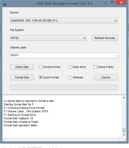

How can I restore a 64 GB USB flash drive that was reduced to 32 GB after creating a Windows 8.1 recovery drive?
Yes — the flash drive is still 64 GB; creating the recovery disk likely made only a 32 GB partition and left the rest as unallocated space, so you need to repartition it to get the full capacity back [#15306410] [#15307695] If Windows Disk Management does not let you create or resize partitions on the removable drive, use a partition tool such as DMDE to delete the 32 GB partition and create a new one on the remaining space [#15306474] [#15306964] [#15307695] After that, create a new simple volume on the unallocated space and format it as needed [#15306964] The reduced size shown later, such as 61.9 GB, is normal because capacity is reported differently by the system [#15308126]

    OK, I will try, and is there any chance that there is a FAT32 file system because it is probably like that on the rest of my flash drives ???
  • #33 15312003
    delphin78
    Posts: 33
    For now, it has moved and formats for FAT32 but they had it and it is slowly moving forward.

    OK. I can't even browse the internet ??
    Added after 2 [hours] 28 [minutes]:
    Well, it probably did not work out because now it is clean but if I want to format it from the Win8.1 level, I can do exFAT or NTFS and there is no FAT32 :(
    Please, give me further help and instructions. 64GB Samsung Pendrive - Change the capacity from 64GB to 32GB.
