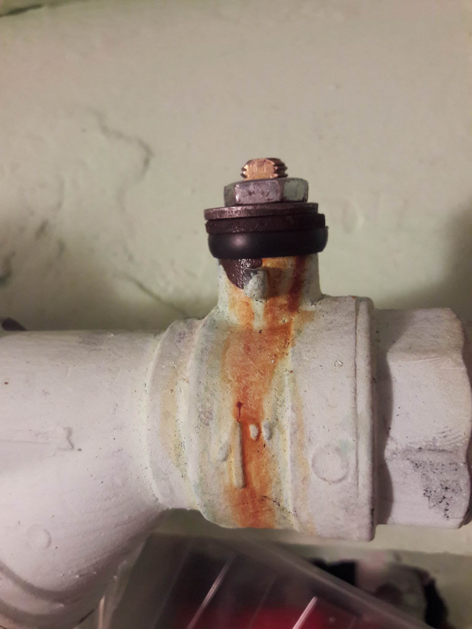

    The plumber calculated the repair cost after knowing PLN 250 because this type of ball valve was not subject to replacement of seals, so the defect was removed personally thick rubber outer diameter minimum 19 mm inner hole 10.5 mm. Metal washer and nut and holds

  • #36 20368107

    @Stanzycki But it's probably not a valve anymore?
  • #37 20368555
    Stanzycki
    Posts: 10
    Rate: 10
    This valve always works in the open position, and if you ever need to clean the filter or replace the pump, you can always close it by putting the handle of the knob on the protruding pin. It was about urgent repair of a water leak during the heating season without having to shut down the stove.
