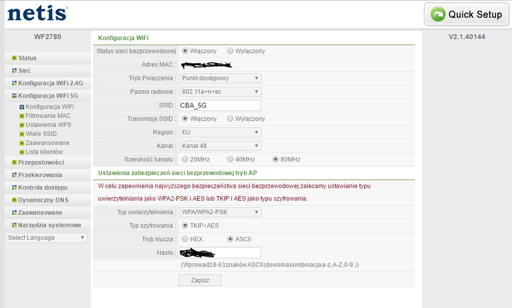

    I have been the owner of the NETIS AC1200 WF 2780 router for several hours, after configuring the settings, the WiFI 2.4 network is detected on all devices. Whereas 5G only can connect one device then the network disappears from visible wifi networks.
    If the tablet connects to 5G first, the phone no longer sees this network and similarly with other devices
    Do you know how to solve it?
    • Netis WF2780 - How to correctly configure it as a repeater / repeater ustawienia_Netis.JPG (82.11 KB) You must be logged in to download this attachment.
