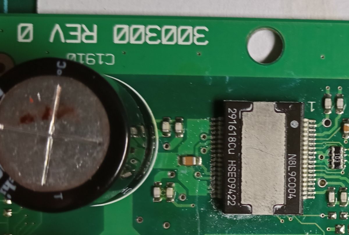

  • #45 18882737
    nohits
    Hi . I took amplifier GS1E 66 920A out of car becouse I wanted to put new cooling paste on chips and resolder problemable parts to prevent silent or machinegun sound. While I put the amplifier back to car, no sound comes from speakers. I measured all important power points on PCB (including stabilizers) and everything is ok: 12V, 12V Enable, 3.3V and 1.25V. Remote pin (AMP CON) from radio to activate amplifier have only 10,5V, but I suppose it is not a problem becouse 12V Enable pin on 5V stabiliser turns it on. End chips for speakers heat usually. No shorts on soldered parts. Cooling paste is unleaded. I suspect CS42438 chip, but there is no power output to check. Only audio outputs. I don't have osciliscope, only TRMS multimeter.
    Do you have any ideas guys? There is picture of my PCB. That mess on board is rest of clear-coat after cleaning for better parts visibility.
    Mazda 6GH 2008 - Bose GS1E 66 920A The history of a certain amplifier part 1
  • #46 18902024
    nohits
    Update: i did bypass from input pins directly to end level chips, still silent. Its warm but muted. Solving this problem could be activating this chips. Does somebody have datasheet of Bose chips? Mazda 6GH 2008 - Bose GS1E 66 920A The history of a certain amplifier part 1
