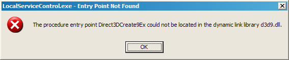

  • LocalServiceControl workaround for Hikvision on WinXP
    #41 20531823
    Gelip
    Level 36  
    Posts: 5245
    Help: 324
    Rate: 611
    dawidedziu wrote:
    On a service laptop with XP, it works in every location where I go for service/assembly.
    Quote from 2017 - and how the case looks today - I'm also interested in using WinXP for configuration and preview.
    I'm using the plugin now LocalServiceControl.exe but I had to edit the file and downgrade the kernel version from 6 to 5 for the application to open on WinXP. You have to run the file manually and then everything works, only that you have to click OK every time when an error appears:
    The procedure entry point Direct3DCreate9Ex could not be located in the dynamic link library d3d9.dll
    Hikvision Live Preview Not Working on Opera & Chrome - WebComponents Plugin Installation Issue
    I also tried older browsers than Firefox 52 and the VLC or QuickTime plugin but VLC shows only the cone icon of the program and QuickTime works only in the preview window, while in the preview windows in the settings there is no image :-(
    I tried replacing files in the system d3d9.dll from Vista and patched msvcrt.dll for WinXP, but then there are other errors related to the lack of some function in other files, e.g. USER32.dll
