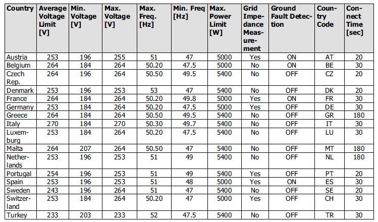

    What standard (country standard) should be set on imported SMA inverter?
    EN50438 or other?

    If there are no settings for Poland, then EN50438

    Set to Germany and it will be ok

    Undoubtedly, Germany will be better in terms of 253V for those who do not fit.
    However, there are other possibilities: setting ACVtgRPro, preferably LdVtgC.
    The latter seems to be the right way. What do you think?
    The inverter with which I had problems had the Belgian settings - more restrictive than the Polish ones. That's probably why I had problems.

    Jan only Germany

    So far, pure EN50438 and zero disconnections. With this standard, the inverter has set voltage limits: maximum ten-minute average at 253V, and maximum instantaneous disconnection at 260V.
    The maximum instantaneous AC voltage measured on the inverter that I noticed was 251.7V, and a bit later on the meter 250.8V. Sunday afternoon is the highest tension. So I don't have to worry. :)

    What are the upper voltage values according to the standards:
    - Polish
    - German GERMANY VDE 0 126 and VDE-AR-N4105
    - Italian ITALIA (CEI0-21)
  • #8 18538423
    Jan_Werbinski
    Posts: 2821
    Help: 76
    Rate: 671
    Poland is probably 230V +/- 10%, i.e. 207-253V.

    OK, and Italian and German?

    Setting Imported SMA Inverter Standards: EN50438 or Other Options?
    Partly outdated when it comes to power but voltage OK.
