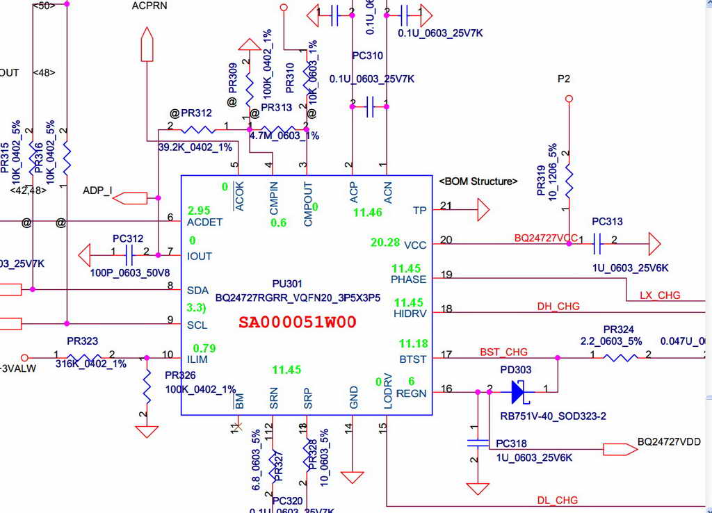

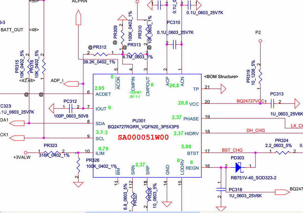

    See datasheet BQ24707, app
    - measure, for example, the voltage on the ACOK pin (responsible for charging Aku)
    - there is reference number Invers. (i.e. 0 is ok)
    - oscilloscope and measure "data exchange" after SDA
    * ACN ACP measurements.
    - on the power supply - voltage from the power supply (19V),
    - on Aku - battery voltage approx. 11-12V
    Come on Aku
    Lenovo G505s LA-A091p - Not loading - message "connected, not charging"
    With Aku
    Pin.7
    IOUT - Buffered adapter or charge current output, selectable with SMBus command ChargeOption (). IOUT voltage is 20 times the differential voltage across sense resistor.
    Interesting on Elvikom Link_ is not loading
    And from the Lenovo forum Link
    ________________
    BQ24727 Pin- Pin with bq24707A
    See appendix from behind the "great wall"
    • 0525.????,?????????????????.pdf (2.19 MB) You must be logged in to download this attachment.

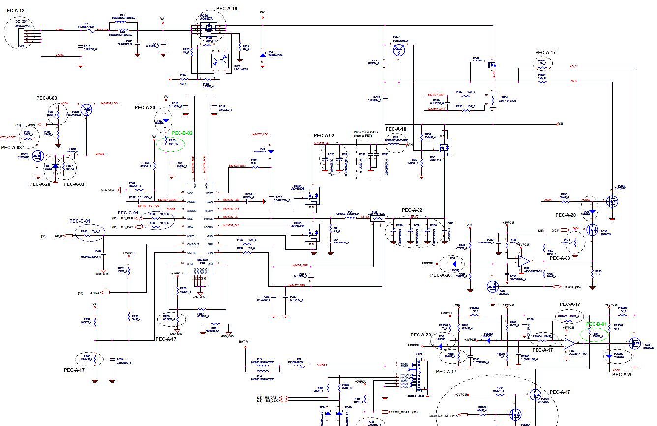

    Hello, I took out the board and for the time being "cold" I measured the charger circuit, I found a damaged 2.2? PR320 resistor and a short circuit between the legs 17, 19 PU301.
    I ordered the bq727 chip, although the board has bq737, I hope these are replacements.
    Regards
    michas

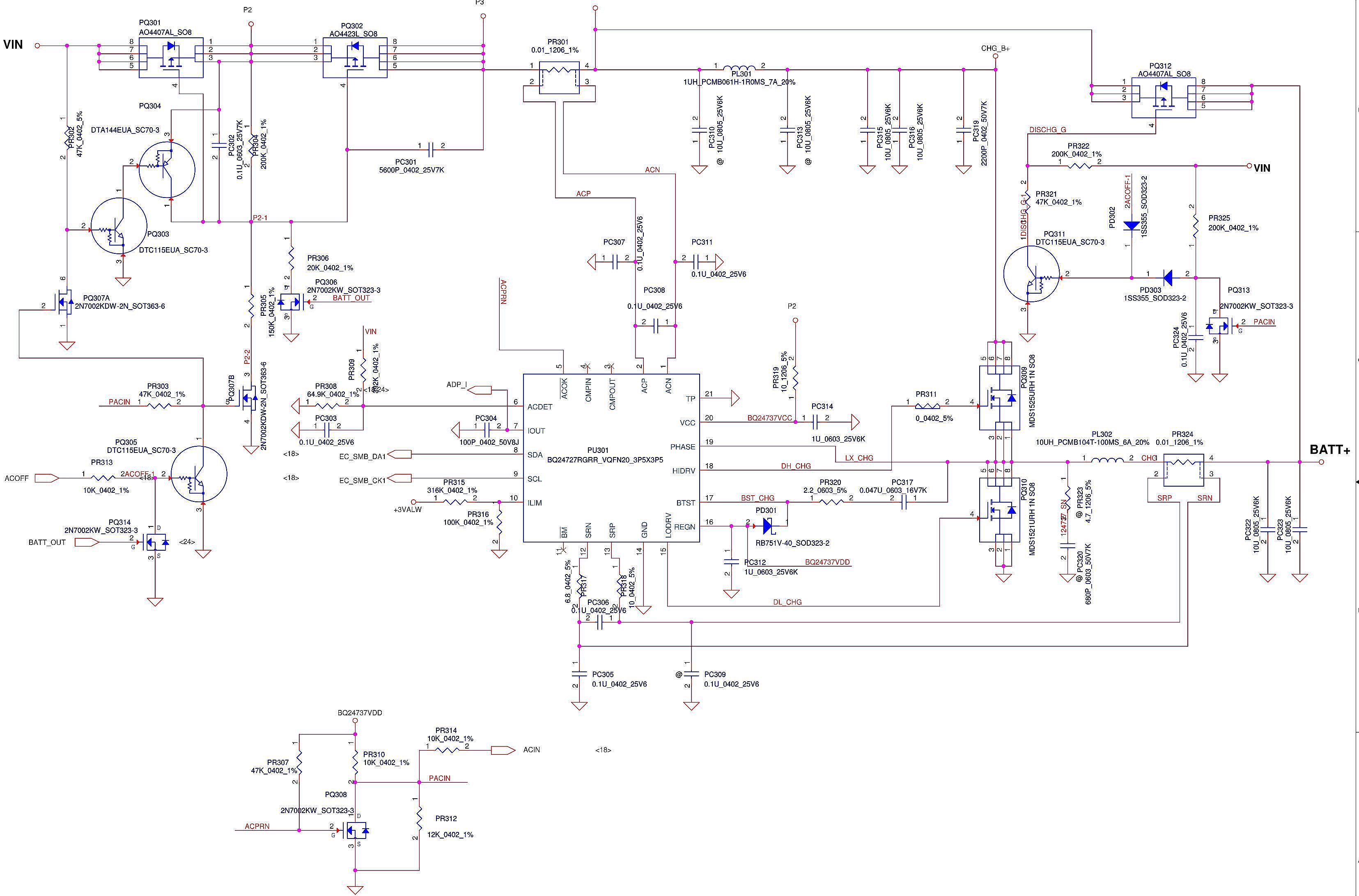

    Raczej nie pójdzie jako zamiennik.
    BQ24737 = BQ24738
    ______________________________________
    Bq24727 to b.podobny do Link_ bq24707A
    Dla niego dobre:
    REGN 6V
    #ACOK 0V (aktywny)
    PACIN ma byc 3,3V > brak lub 0V> pq307/pq308 i elementy w ich otoczeniu
    * jak ACDET pin.6) masz 2,7V oraz ACOK 4V to IC do kosza
    Z datasheet bq24707
    ACOK#
    AC adapter detect open drain output. It is pulled LOW to GND by an internal MOSFET when the voltage on the ACDET pin is above 2.4V, voltage on the VCC pin is above UVLO and voltage on the VCC pin is 245mV above the voltage on the SRN pin, indicating a valid adapter is present to start charge. If any one of the above conditions cannot meet, it is pulled HIGH to the external pull-up supply rail by an external pull-up resistor. Connect a 10kΩ pull-up resistor from the ACOK pin to the pull-up supply rail
    • BQ24737.pdf (94.2 KB) You must be logged in to download this attachment.
