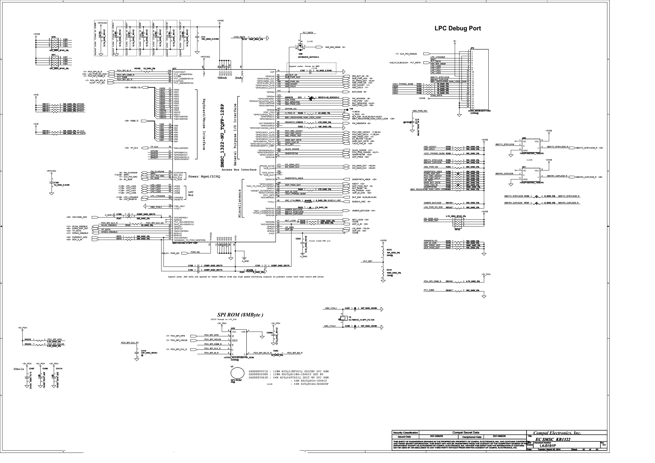

    I have a problem with the HP Probook 430 g2 laptop which does not see the battery at all, although it is new and functional. It was tested in another laptop.
    The motherboard is LA-B171P
    KBC SMSC MEC1322-NU
    The laptop does not charge and does not detect the battery, the bios does not detect it either, but when I charge it in another laptop, it works normally until it discharges. The BQ736 charging system mentioned does not change anything, the mosfets are not punctured. over KBC MEC1322-NU is it responsible for recognizing and charging the battery? Unfortunately, there is no diagram anywhere on what legs in kbc should be voltage so that the laptop can see and charge the battery. Please help

    :idea: Charger circuit bq736 (no datasheet) is almost the same as 725 (there is a datasheet) and there is e.g. a workflow in LA-B211P Link_ SM
    Also, only in this forum about bq725A
    Phrase: bq24725A Search on selected forums 68 results found (0.26 s)
    :idea: There is an SM available under Compal LA-B181P 2014 S-series (400series) REV 0.5 - HP Probook 450 G2, where:
    kbc is SMSC MEC1322-NU
    charger is based on bq736 and has the same pos. description on the board what in LA-B171

    :idea: you have noticed that this bq736 is working in the configuration of the input keys. :
    1st key is P-ch / 2nd key is N-ch
    the power half (key) from Aku is P-ch
    Do not measure the voltage on the gates, you need an oscilloscope there (you have pulses there)
    You put the right and proper halves in PQ101 / 102 ...
    Below is another application from bq736
    The described symptom was similar and was to blame for PU4003, PU4002
    * I wrote HP PROBOOK 4370S RICHIE MB 2012 S_Series Richie 13.3Richie
    HP Probook 430 g2 - Does not detect and does not charge the battery, but works o
    BQ726 / 725 have a similar datasheet and sa =? "Bq736"
    - where 726 is NOT interchangeable with 736
    because when there is Aku and you connect the power supply .. the laptop will not work on the power supply (and there is no charging)
    :idea: In return, they send 736 >>> from China BQ737 ?!
    The role of the pin
    pin.10 (ILIM) as value and when time off landing
    Read about the role (Batt_Det and Batt_Temp.)
    kbc communicates with charger over CHARGER_CLK, CHARGER_DAT

  1. Apply 19 V adapter; verify ACDET 2.5 V, ACOK 3.3 V. 2. Insert discharged battery; look for BATDRV gate pulses. 3. Monitor SRP–SRN; charge current should rise above 100 mA within 5 s [TI, 2015].
What failure stops charging even when voltages look normal?
If ILIM (pin 10) falls below 50 mV, the IC latches off until AC is removed — a hidden fault that multimeters miss [TI, 2015].
