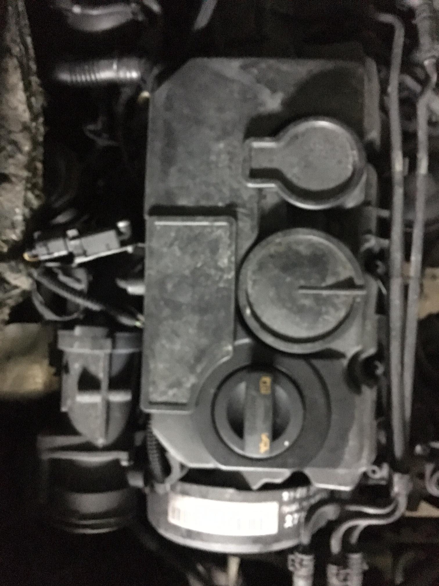

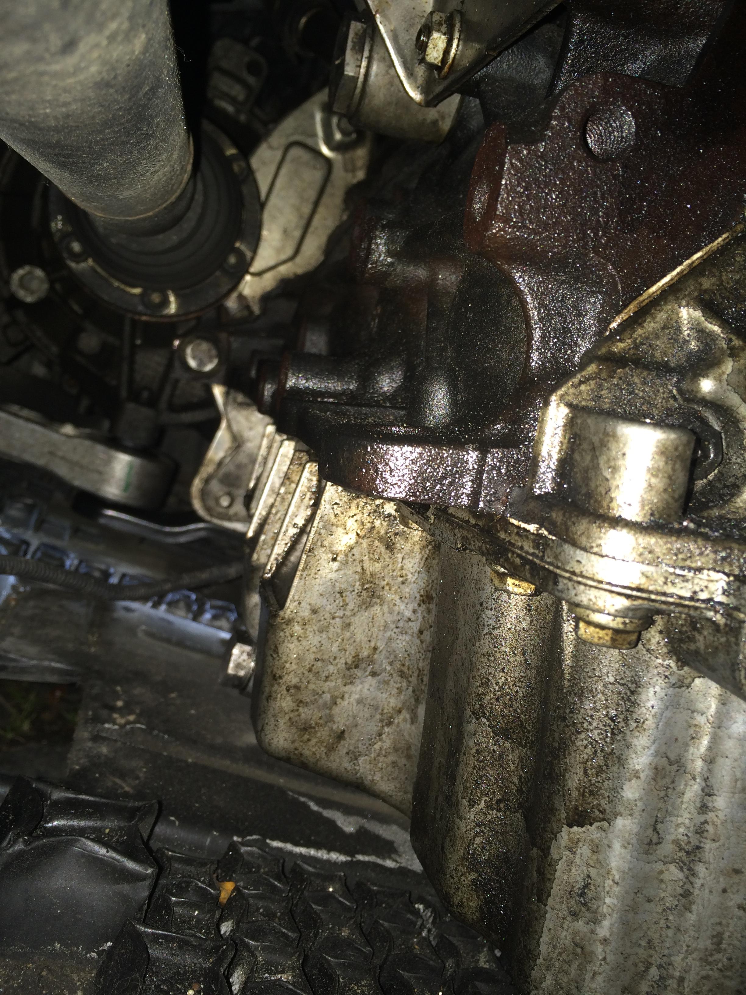

  • #33 16273804
    porfon
    Posts: 6
    Rate: 8
    Has the problem been solved? , I have the same with my bls and I did the same,
    I even pasted the whole cover with the automotive silicone gasket and the oil is still running !!!!
    I think it is from under the vacum pump.
    • 1.9 TDI BLS Engine: Identifying Oil Leak Sources - Turbo, Intercooler, Valve Cover & Solutions IMG_0674.JPG (1.01 MB) You must be logged in to download this attachment.
  • Clean leak area and replace distorted valve cover
    #34 16282582
    daster
    Posts: 84
    Rate: 27
    I think it is from the vacuum pump.
    sorry it's so late.
    If you have not verified what is leaking, buy a spray gun to clean the blocks, it evaporates quickly, you do not need to clean it with a rag. You piss and wait.
    Cover the area where you have leaks. For me it was the rear, the entire oil pan, even the driveshaft.
    Check the rear area of the valve cover from the top, if there is oil, it may indicate the cover.
    I even shortened the screws from the cover and that shit did it. I distorted the cover.
    If you are sure that it is the cover, buy a new one and clean the surface.
    I found a ****** a new seat cover for PLN 180 with screws and a gasket, it is also possible.
    good luck
