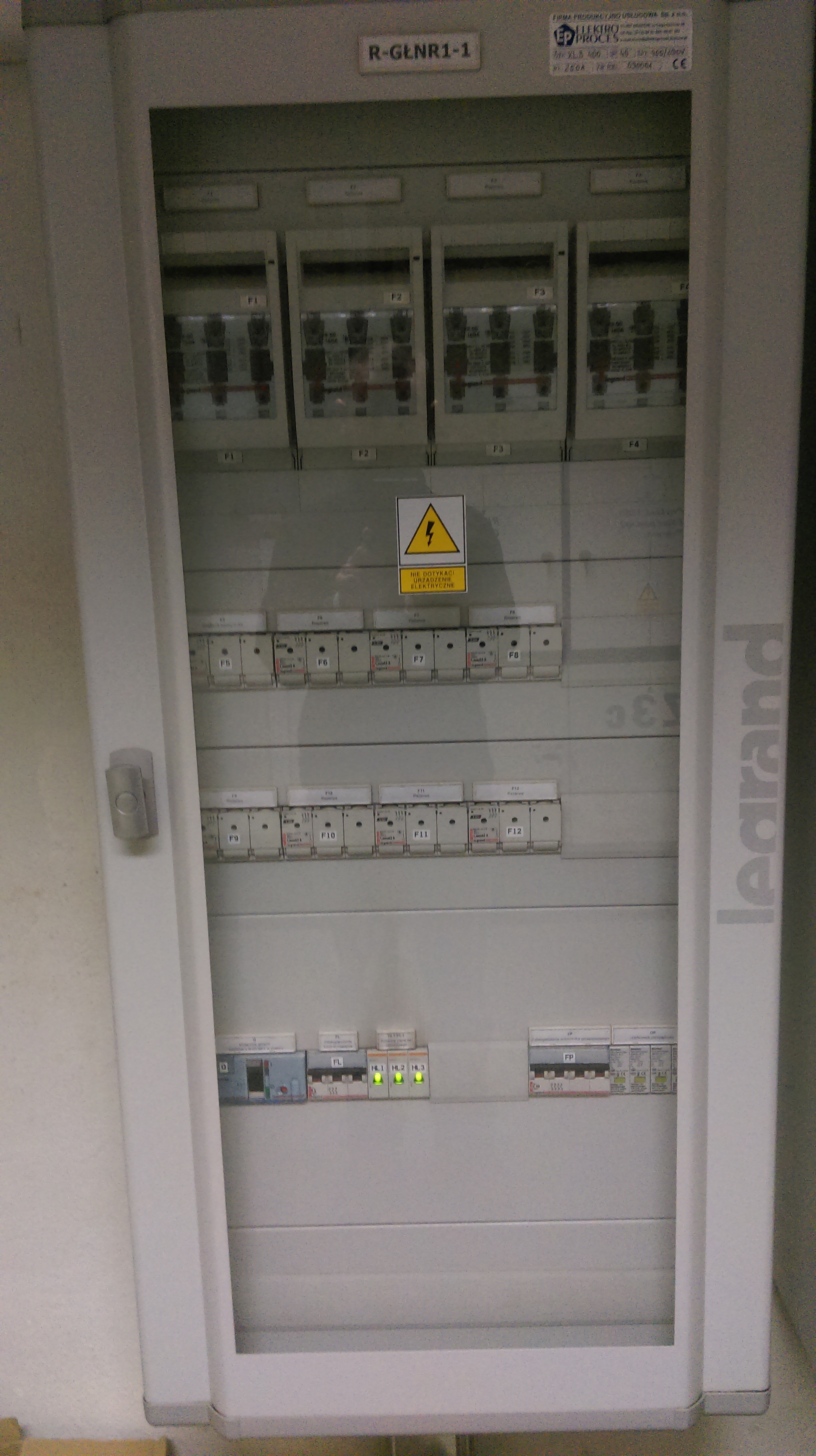

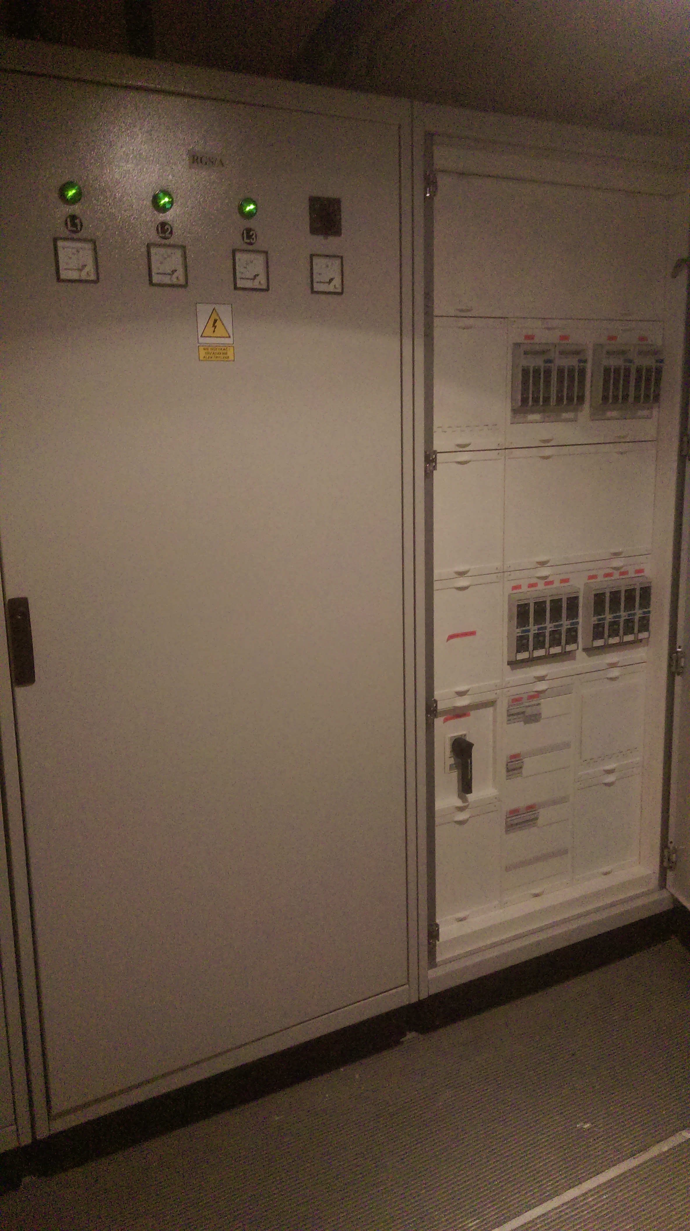

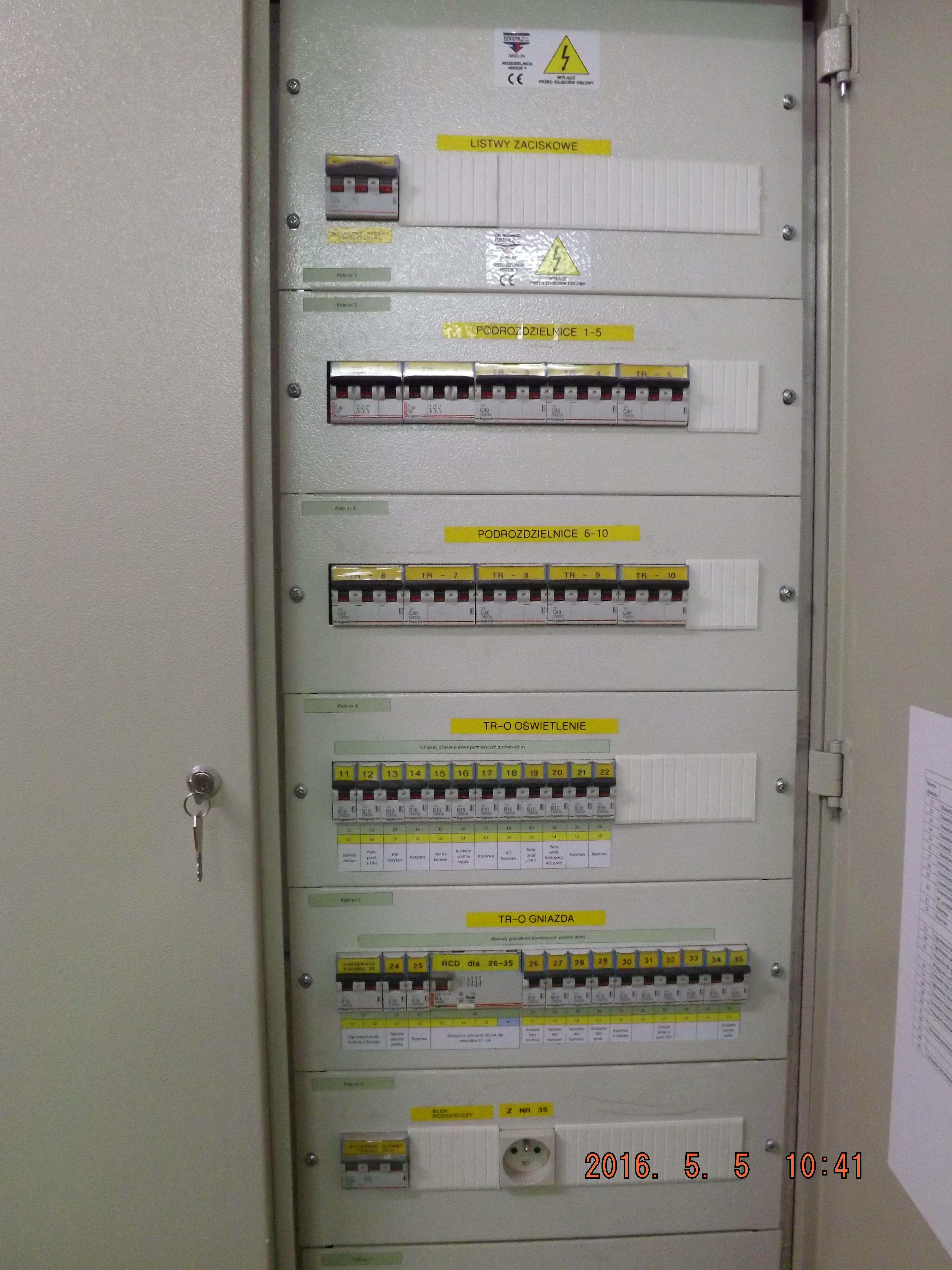

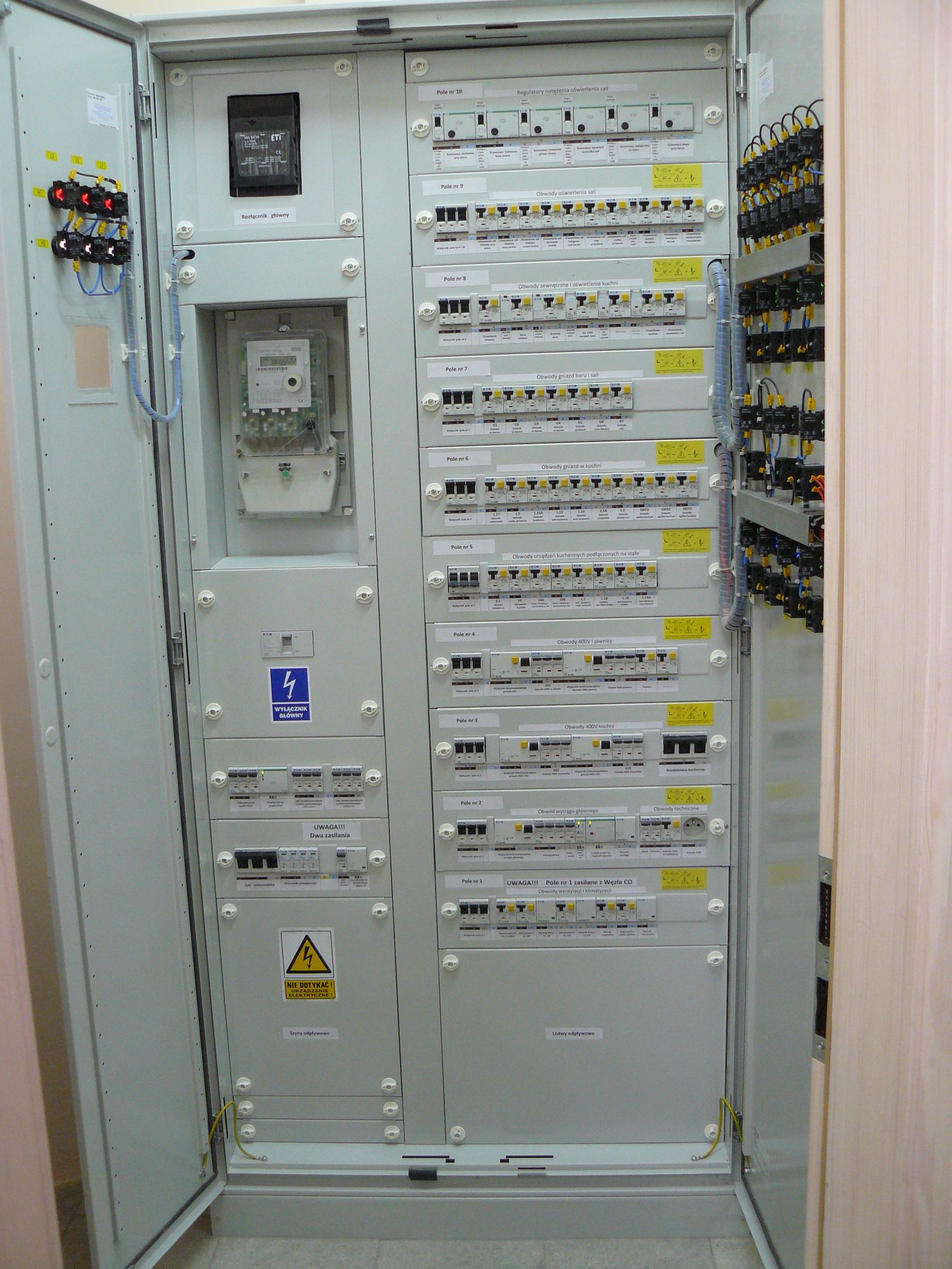

    mawerix123 wrote:
    No Word or Paint descriptions, it becomes illegible, the more so if one RCD operates several switches.
    As illegible as legible - everything in Word :D :
    Examples of LV Switchgear Descriptions: Circuit, RCD, Letter Codes (F, Q) & Photo Insights Examples of LV Switchgear Descriptions: Circuit, RCD, Letter Codes (F, Q) & Photo Insights Examples of LV Switchgear Descriptions: Circuit, RCD, Letter Codes (F, Q) & Photo Insights
    And a slightly larger caliber:
    Examples of LV Switchgear Descriptions: Circuit, RCD, Letter Codes (F, Q) & Photo Insights Examples of LV Switchgear Descriptions: Circuit, RCD, Letter Codes (F, Q) & Photo Insights Examples of LV Switchgear Descriptions: Circuit, RCD, Letter Codes (F, Q) & Photo Insights Examples of LV Switchgear Descriptions: Circuit, RCD, Letter Codes (F, Q) & Photo Insights
    There is a way for the width of the table columns to match the width of the text after printing. In Word, it is enough to set it to nine columns, then each column corresponds to the width of the eSa. Any height and number of lines.
    Printer, adhesive paper and scissors still needed ;)

    Łukasz_O wrote:
    There is a way for the width of the table columns to match the width of the text after printing. In Word it is enough to set it to nine columns, then each column corresponds to the width of the eSa. Any height and number of lines.
    A very good way - mastered. I showed in post # 10
    Also large caliber -
    One meter sixty ... tall.

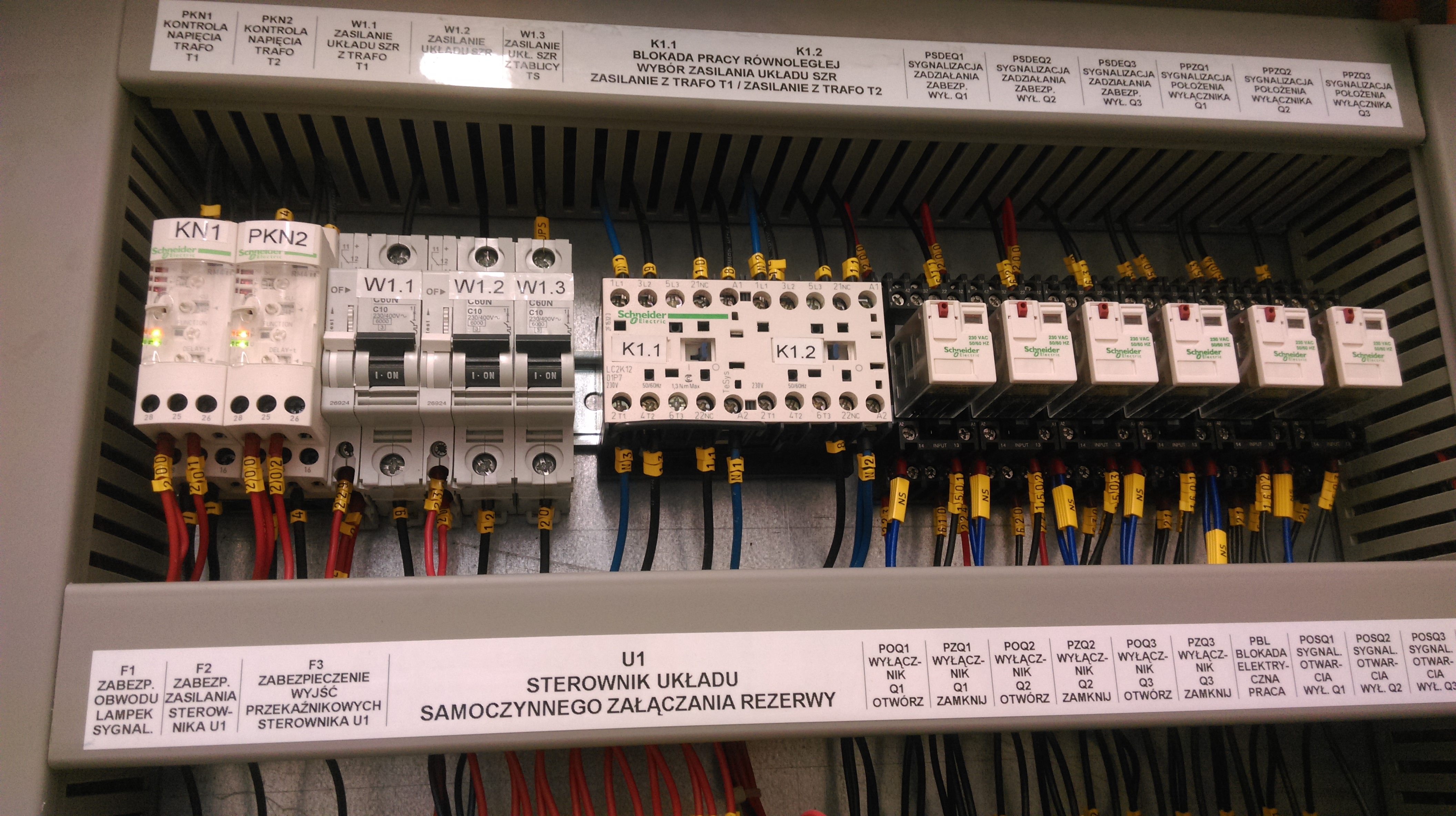

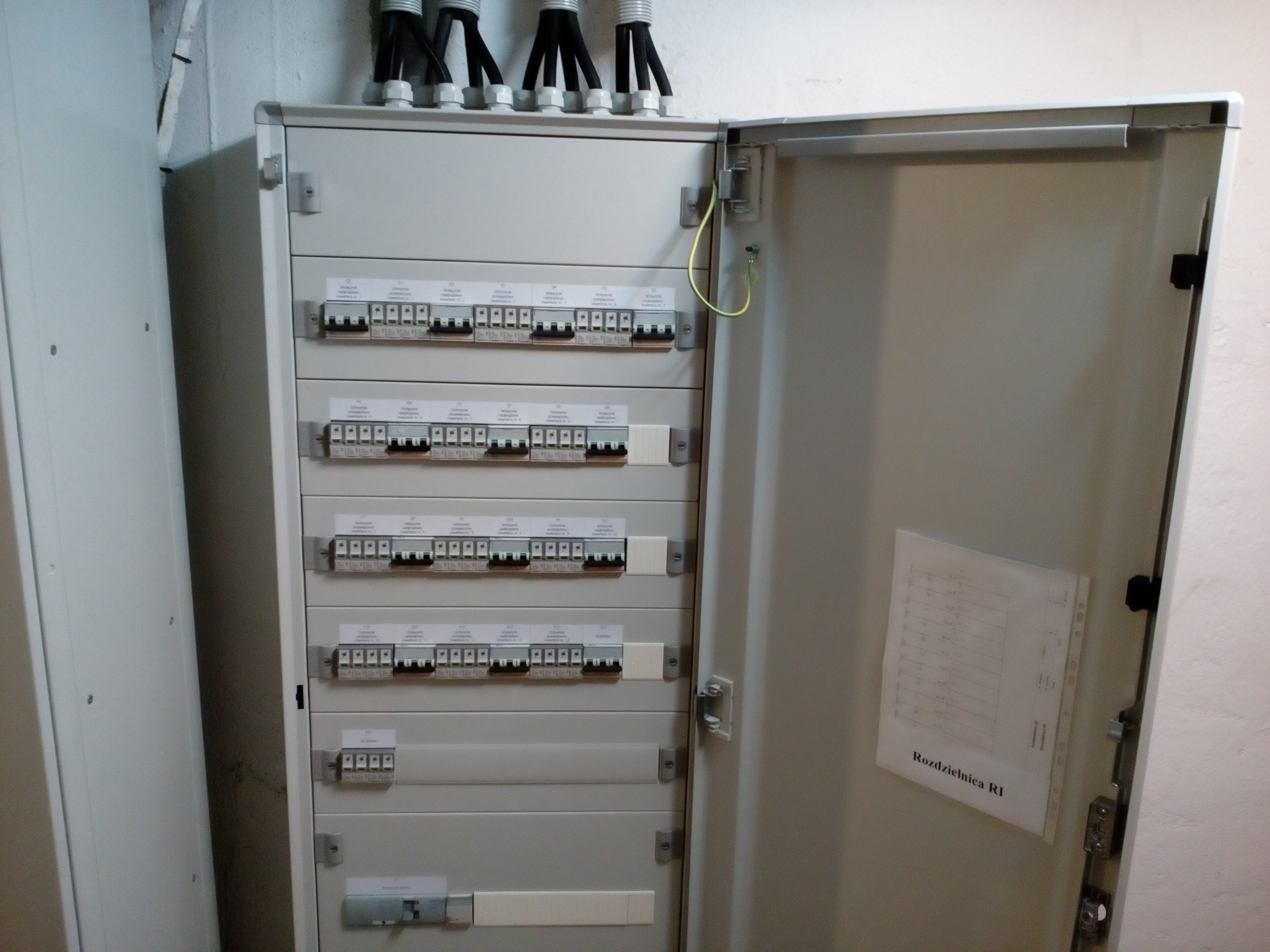

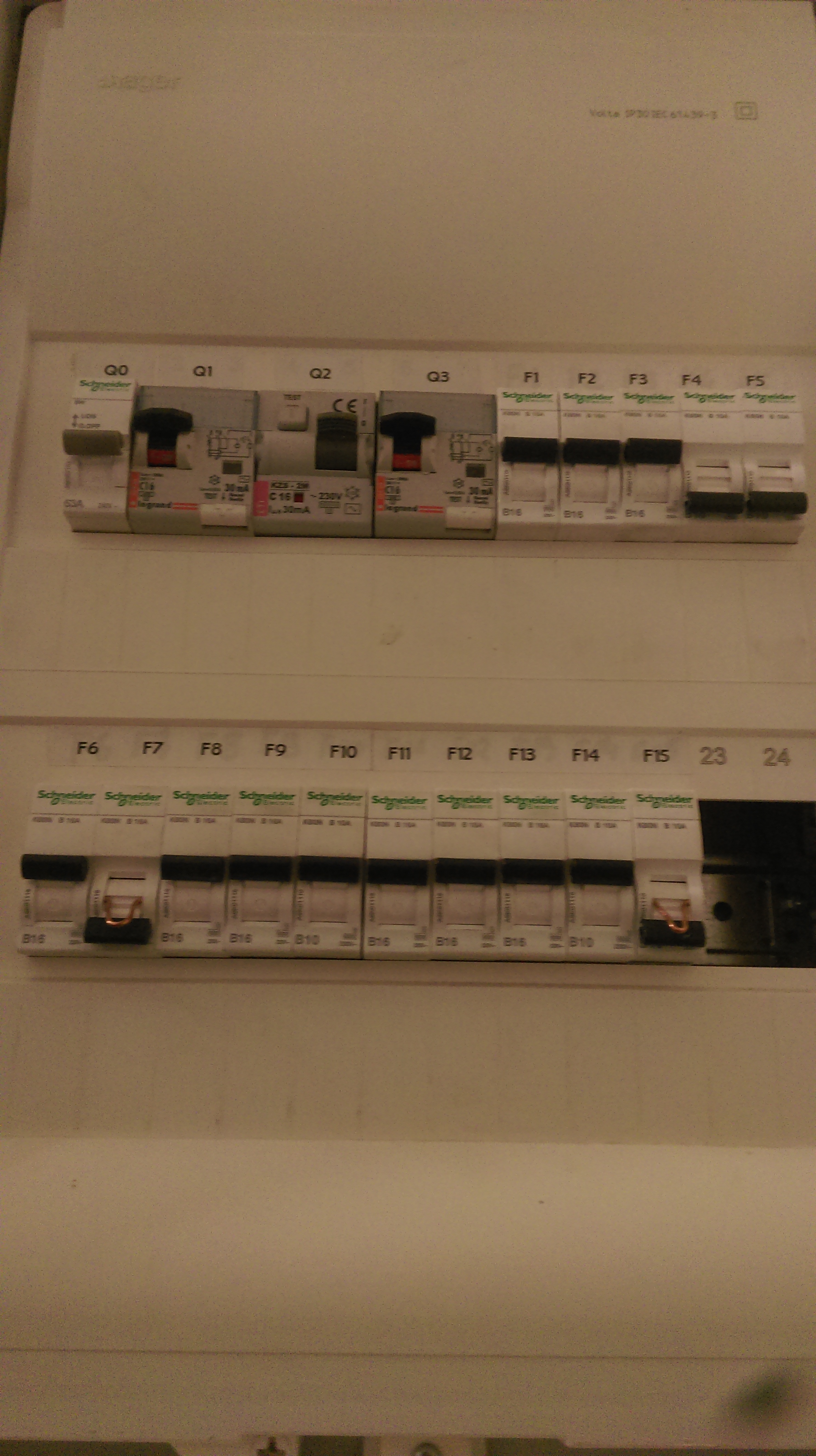

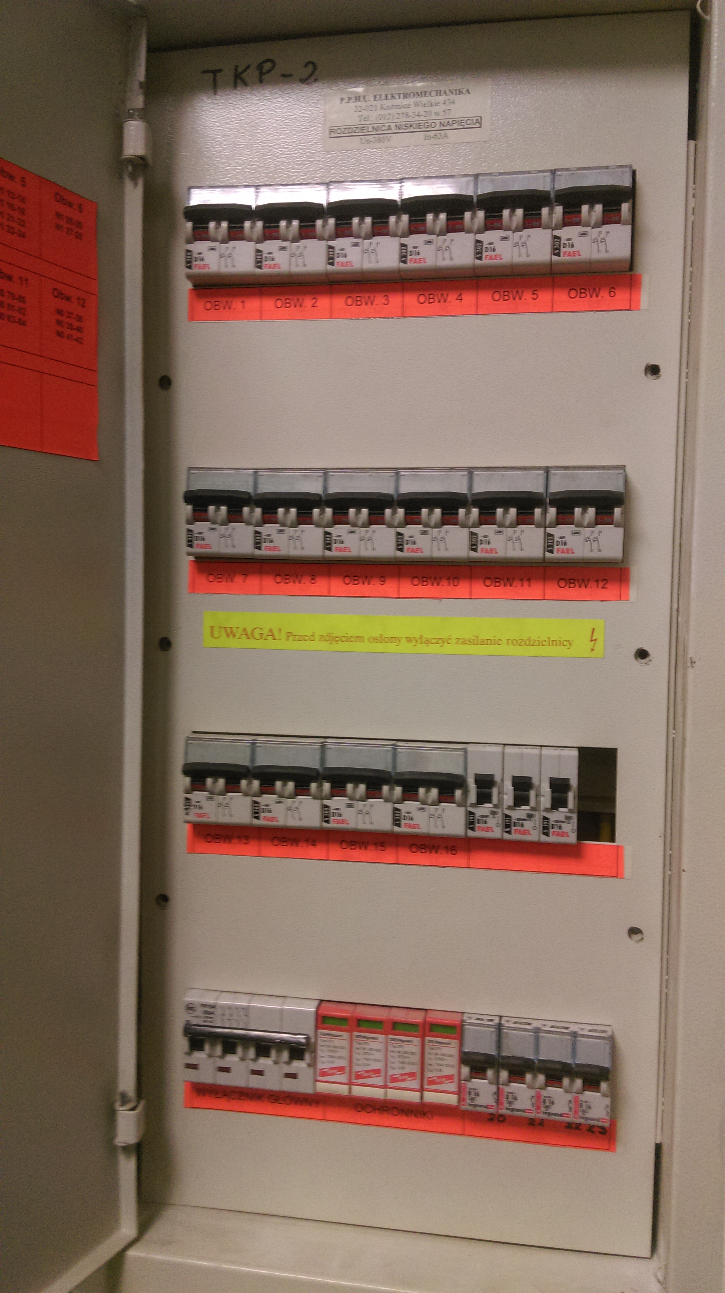

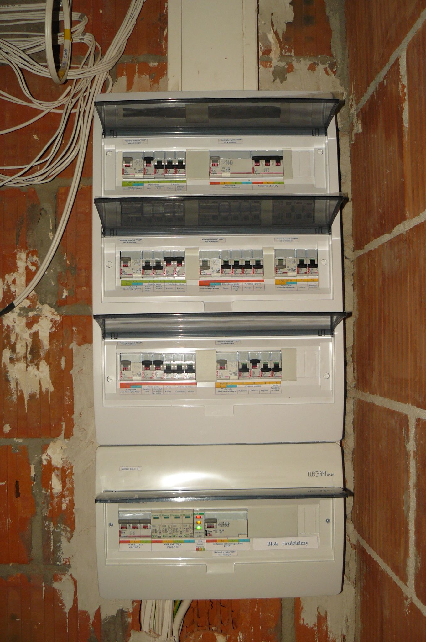

    elpapiotr wrote:
    Well, a scan, photo, excerpt from the implementation of these descriptions, please.
    Unfortunately, I do not document my works, I have some old ones, sorry for the quality of the photos
    Recently, I have been using a printer and a schematic diagram as the description.
  • #18 16046989
    elpapiotr
    Electrician specialist
    Posts: 12211
    Help: 1015
    Rate: 3532

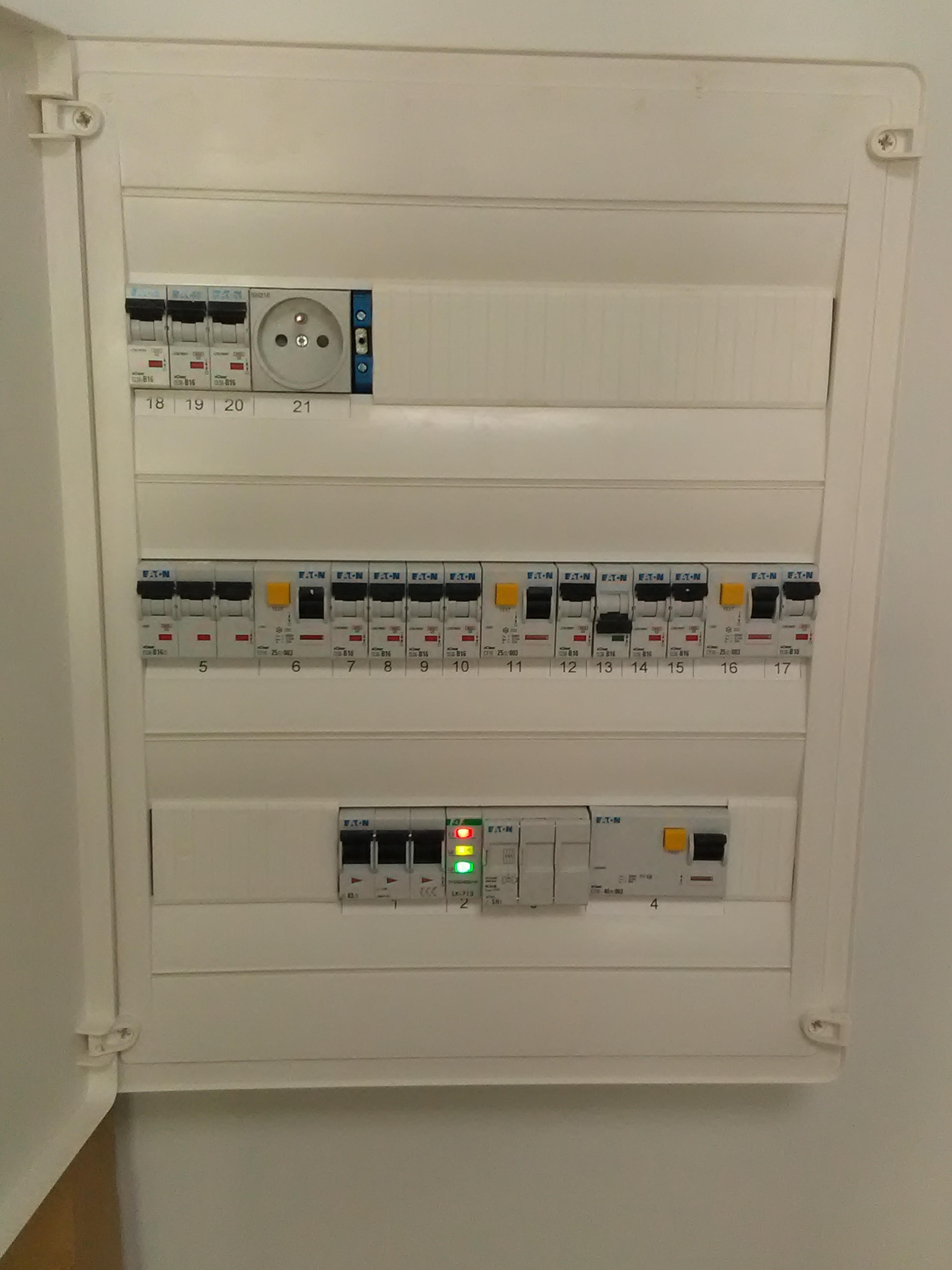

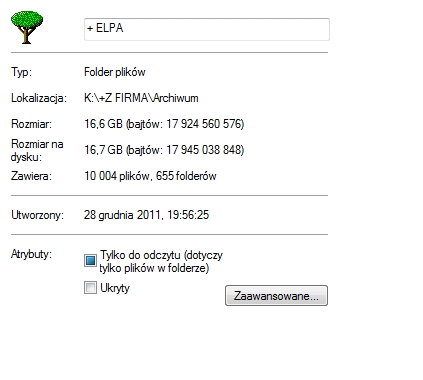

    And I am documenting. It comes in very handy.
    Creation date is much earlier than given in the screenshot.

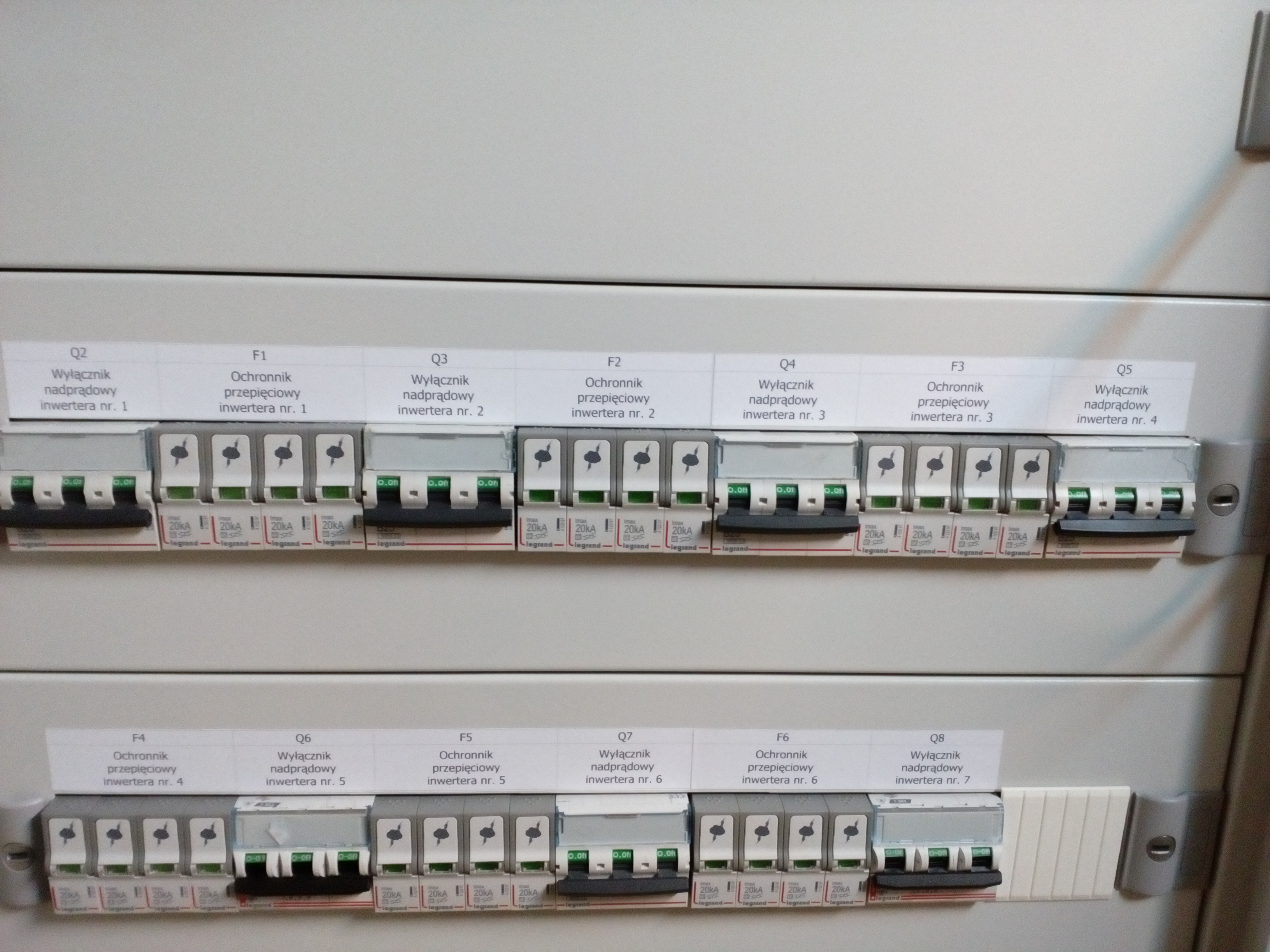

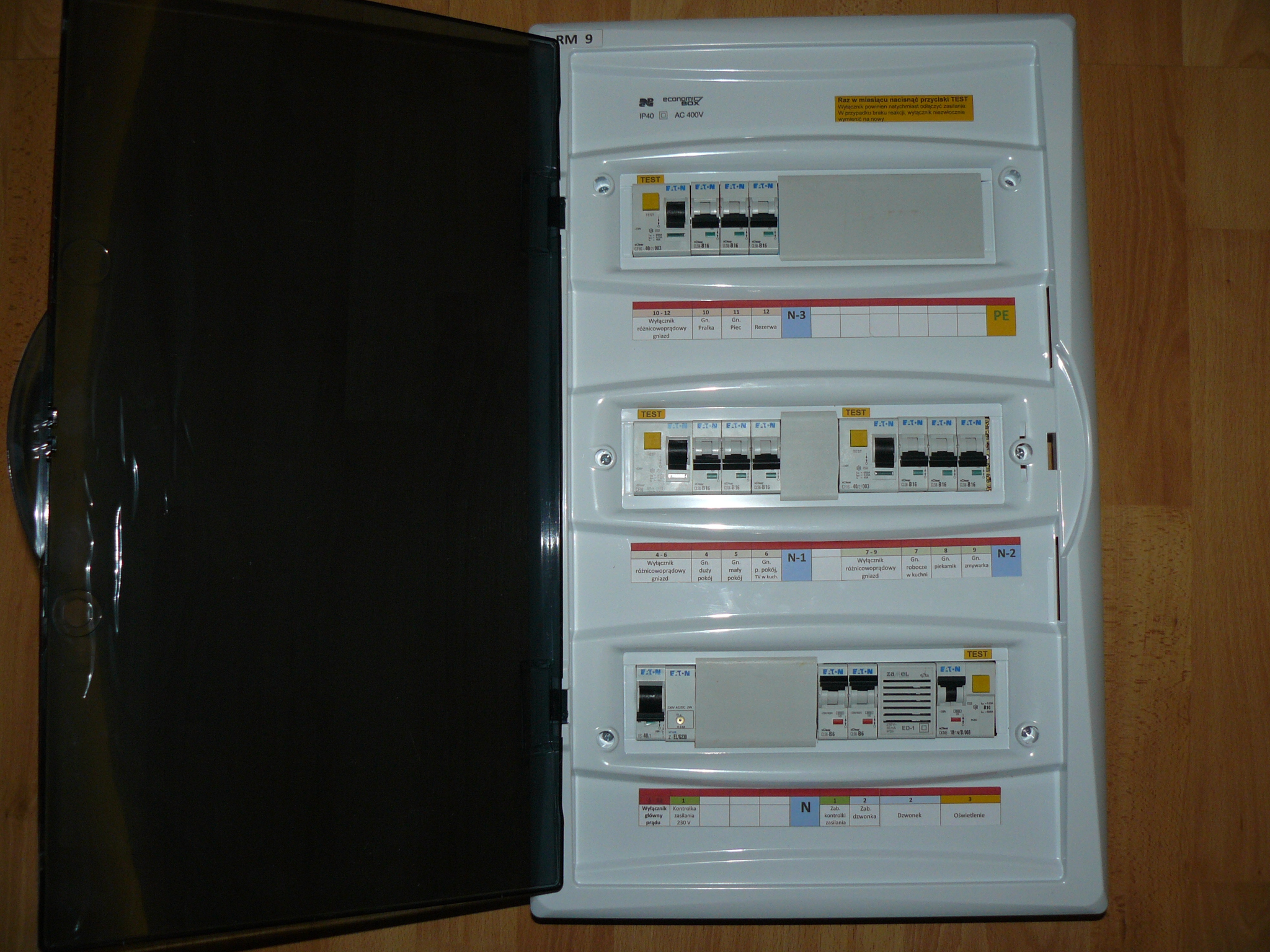

  • #19 16053335
    Adam_Bandit
    Level 20  
    Posts: 411
    Help: 24
    Rate: 59

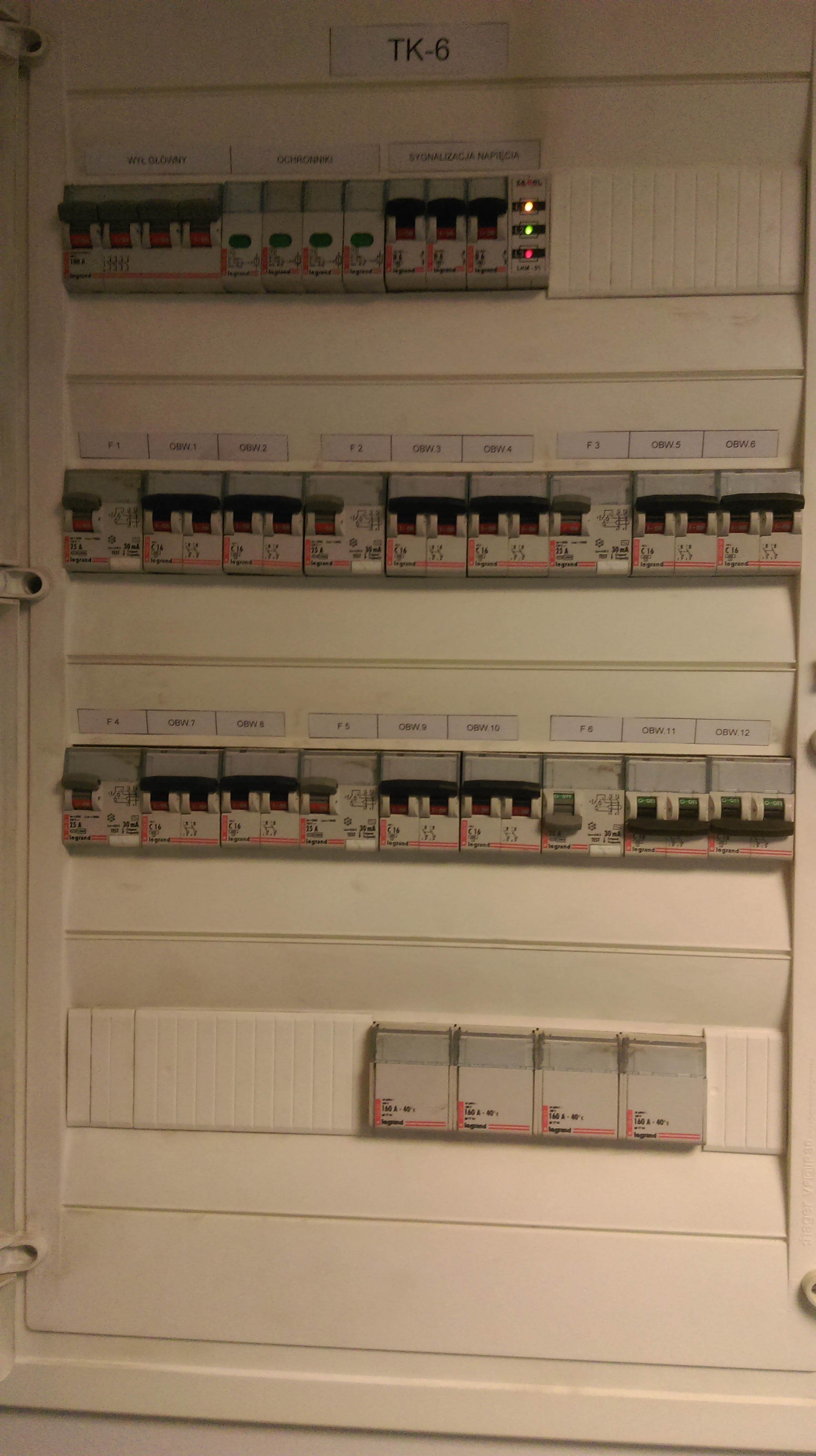

    Sometimes I also do it so that I only number the devices in the switchgear, and stick a more detailed description on the door with a diagram in a T-shirt.

  • #24 16055693
    Adam_Bandit
    Level 20  
    Posts: 411
    Help: 24
    Rate: 59
    In my case in post # 19:
    - first photo - Dymo Rhino 5200 label printer
    - the second and third are self-adhesive paper, labels made in the XL Pro (Legrand) program, the minus is that you have to cut it manually, which takes some time.
