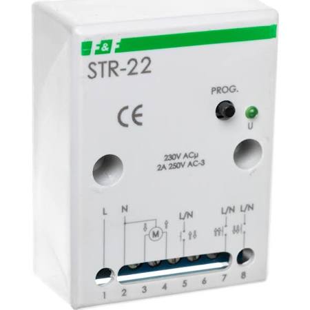

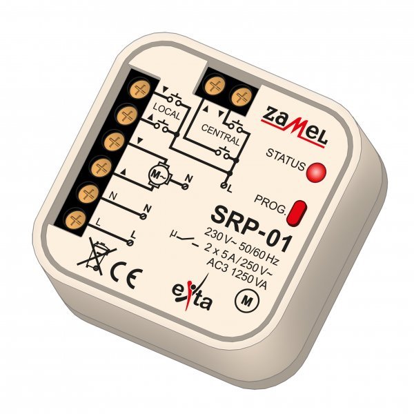

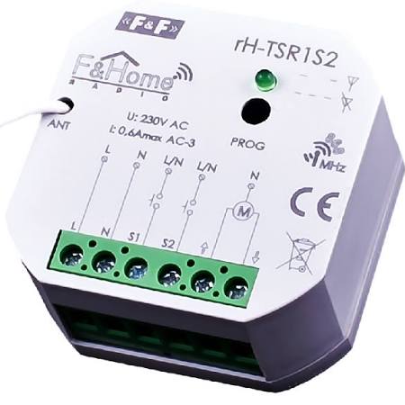

  • #5 16103161
    Marek J.
    Posts: 2368
    Help: 526
    Rate: 950
    As Zbigniew's colleague wrote, relays will solve the problem, but you need to be aware that during the whole cycle of raising or lowering the roller shutter you have to hold the G/D switch button which has to be "momentary". If you want another option you can use a ready-made one. Wiring diagram for electric roller shutter up/down control via switch and microcontroller Wiring diagram for electric roller shutter up/down control via switch and microcontroller Wiring diagram for electric roller shutter up/down control via switch and microcontroller Wiring diagram for electric roller shutter up/down control via switch and microcontroller Wiring diagram for electric roller shutter up/down control via switch and microcontroller Wiring diagram for electric roller shutter up/down control via switch and microcontroller
