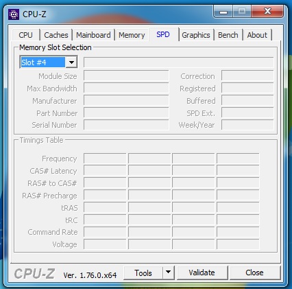

    I checked the SPD, I have empty: /, The only thing that can be useful is:
    ASUS A555LN-XO112H Laptop RAM Upgrade: 12GB Max, 4GB Onboard + 8GB Compatible Chip Info
    Below I am inserting a report with Computer, Motherboard and Devices. Maybe you can read something.
    Report

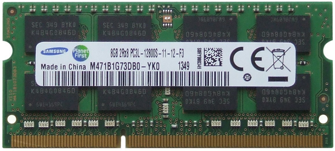

    You have "Samsung SODIMM DDR3 1600MHz 4GB"
    Buy such a bone:
    Should be OK.

    One more question, so that I should be calm because from what I can see, the bone you sent me has 1.35V and there is an inscription on the socket: 1.5V DDR3
    Should it be 1.35V or 1.5V, because, as far as I know, they do not always work interchangeably?

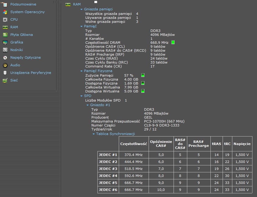

  • #11 16143967
    perlit
    Posts: 6368
    Help: 152
    Rate: 456

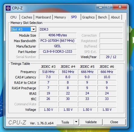

    In the SPD tab you can select slot 1 or slot 2. Select the slot where the memory is and insert screen.
    Example.

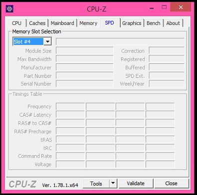

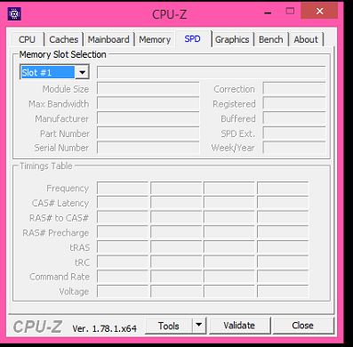

    As I said in AIDA, the SPD tab is empty. I checked the same effect in CPU-Z: /
    Man, the only chance I think was to find some info in the service manual ... but I can't find one anywhere: /

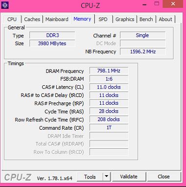

  • #13 16144272
    perlit
    Posts: 6368
    Help: 152
    Rate: 456
    Run CPU-Z as Administrator. If it doesn't help, download the program Speccy . Find the SPD tab in the RAM section.

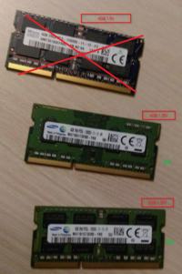

    Unfortunately, the SPD tabs are not visible in CPU-Z and in AIDA with administrator rights or in Speccy. Today, however, I borrowed 4GB 1.5V, 4GB 1.35V and 8GB 1.35V bones and I tested which chip will work.
    It turned out that the laptop turned on on the 4GB 1.5V chip, but the system only saw 4GB (those on the motherboard). I replaced the 1.35V chip, first the 4GB worked without a problem, the 8GB 1.35V chip worked and the system saw a total of 12GB. I have no idea why there is a 1.5V DDR3 inscription on the socket because these bones do not work: /.
    To sum up, someone will be looking one day - the ASUS A555L is compatible with 1.35V bones
    @ atomic99 was right and the bone he gave fits without any problems (photo below the module that was installed).
