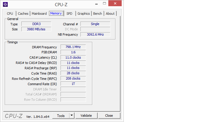

  • #4 17157879
    quiet
    Posts: 543
    Rate: 75
    I just read this information on nhl.pl and I was also dizzy and hence my post.
    Info from CPU-Z
    ASUS R510LNV-X0555H Laptop RAM Upgrade: Adding DDR3 Slot Memory & Built-in 4GB RAM Details
    In the SPD tab, zero information on each slot.

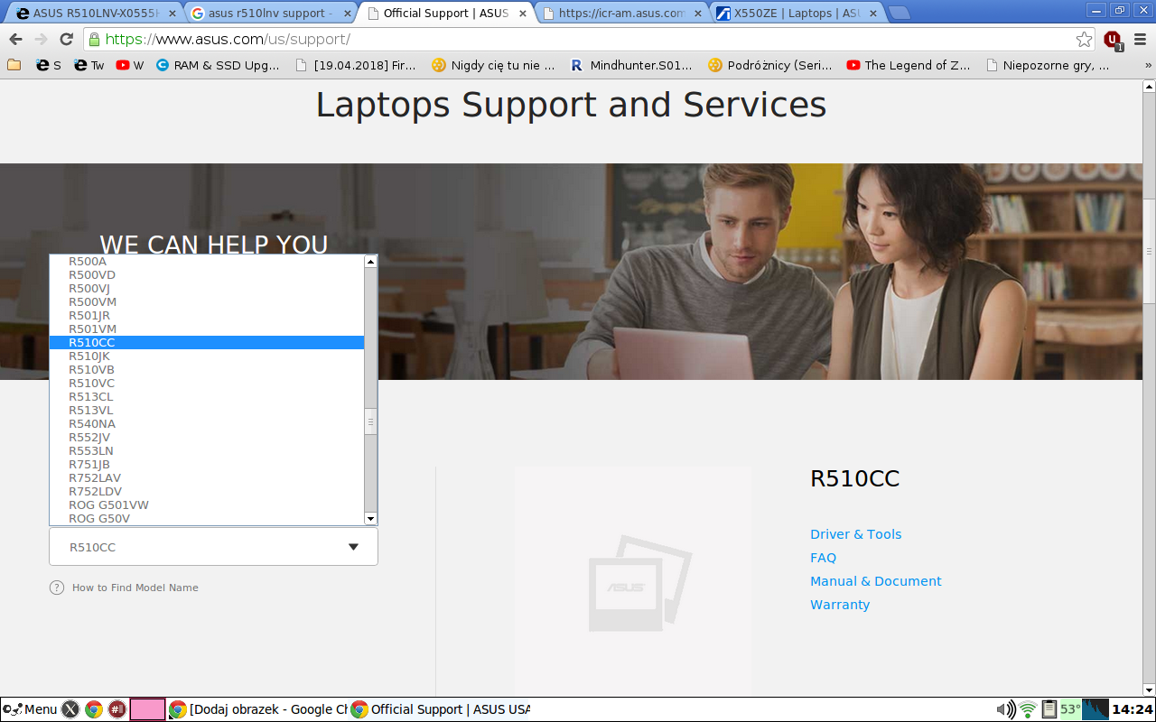

Where can I find ASUS support info for the R510LN/V family?
Use the ASUS support‑only page for R510LN; it covers this chassis family. [Elektroda, quiet, post #17157929]
