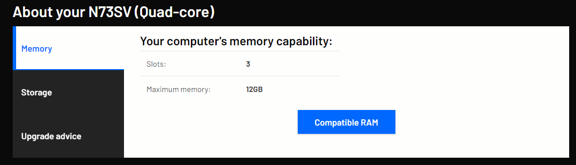

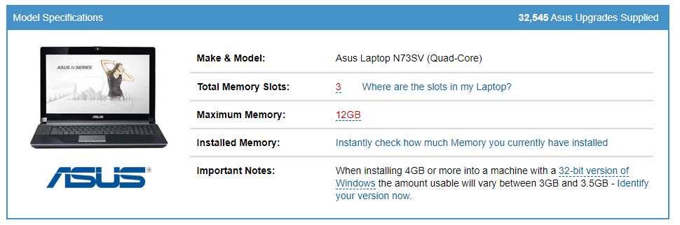

    The patient in this topic is an ASUS N73SV laptop. Most sources list its maximum memory as 12GB:
    Screenshot of ASUS N73SV laptop model specifications.
    Screenshot showing the maximum RAM capacity for the ASUS N73SV laptop.
    The seller specified the same thing when I bought this laptop years ago.

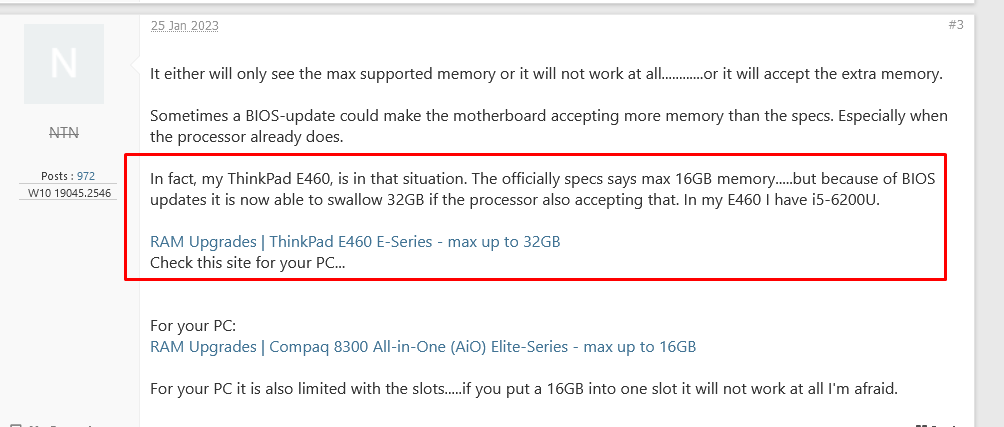

    People on forums seem to confirm this:
    Forum post discussing the possibility of increasing RAM in a ThinkPad E460 laptop.

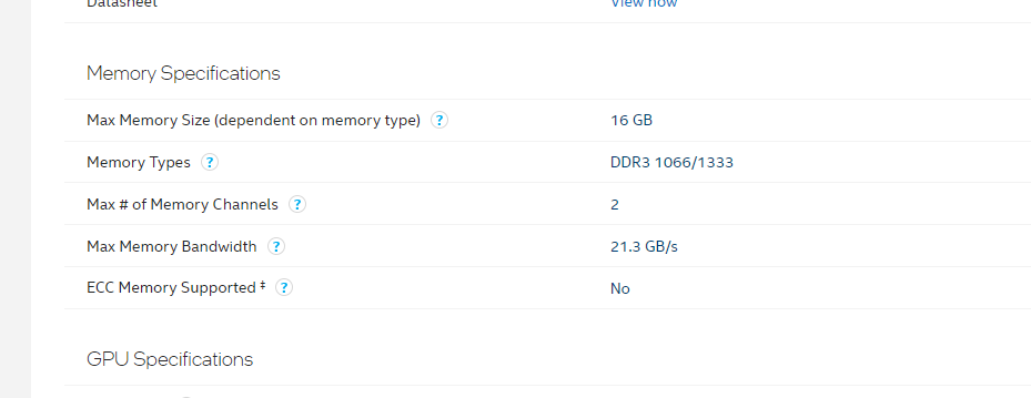

    The CPU specification specifies a maximum of 16GB:
    Screenshot of memory specifications with a maximum size of 16 GB.

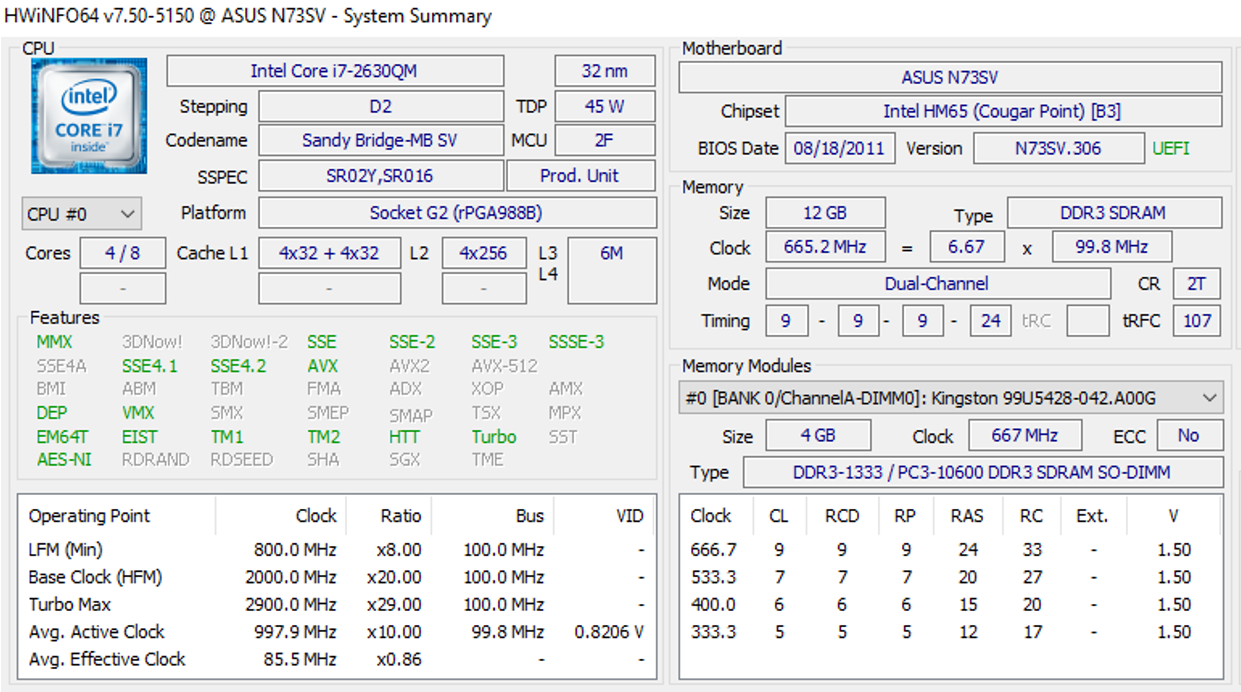

    HWinfo before replacement:
    Screenshot from HWinfo software showing the system specifications of an ASUS N73SV laptop.

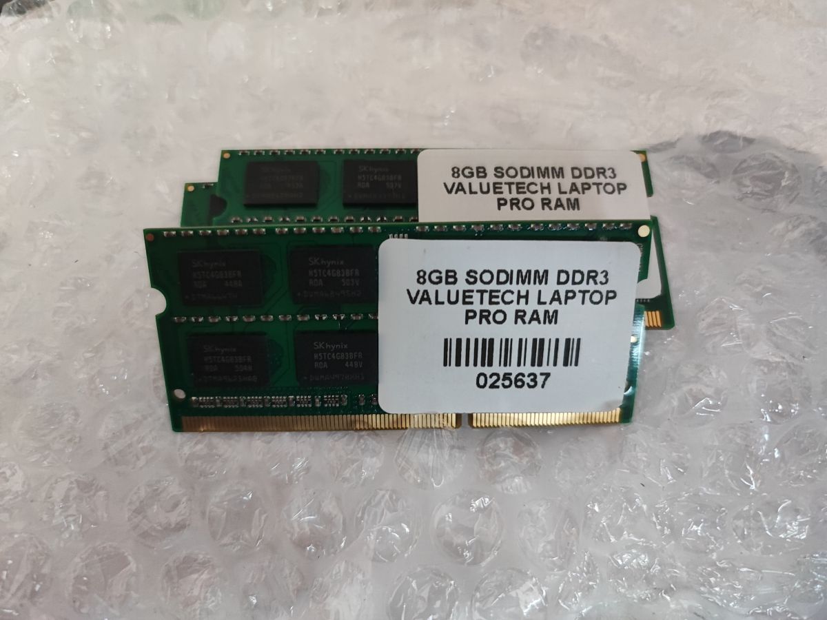

    I bought three sticks of 8GB each:
    Two 8GB SO-DIMM DDR3 RAM sticks on bubble wrap.
    Maybe we`ll replace one die at a time as a test.

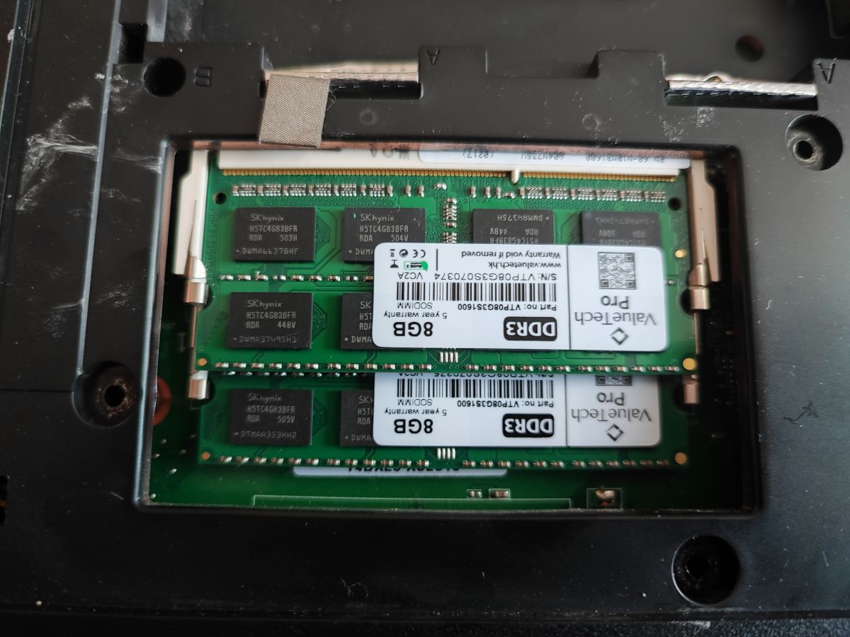

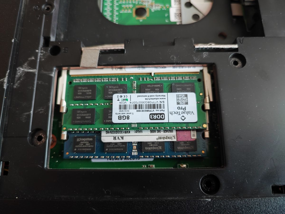

    Exchange #1:
    There are two RAM slots in this Asus under the bottom flap:
    Two Kingston RAM modules installed in a laptop.
    After replacing:
    Two RAM modules installed in an ASUS N73SV laptop.

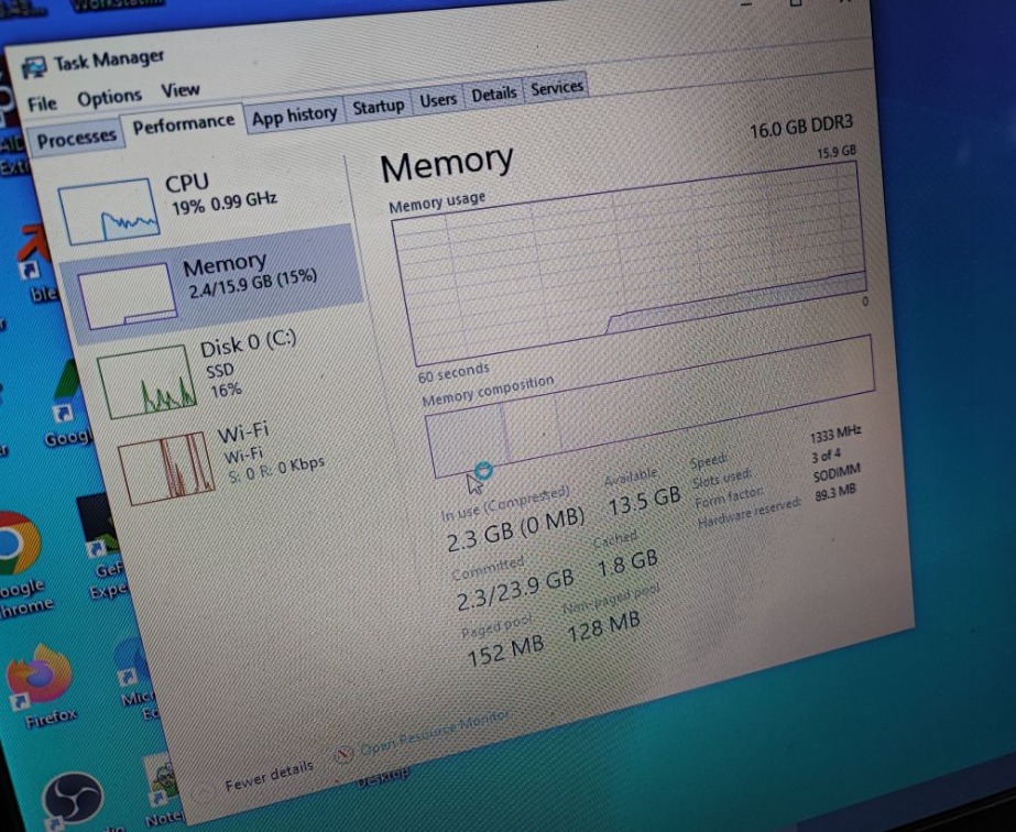

    We start it and... success, 16GB RAM:
    Screenshot of a task manager on an ASUS laptop showing 16GB of DDR3 RAM.

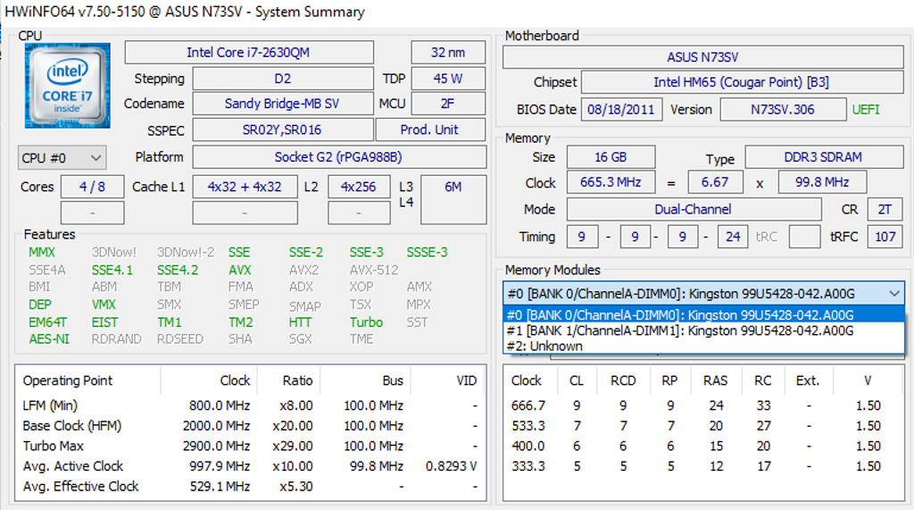

    HWinfo:
    Screenshot of HWiNFO64 program showing system specifications of ASUS N73SV.

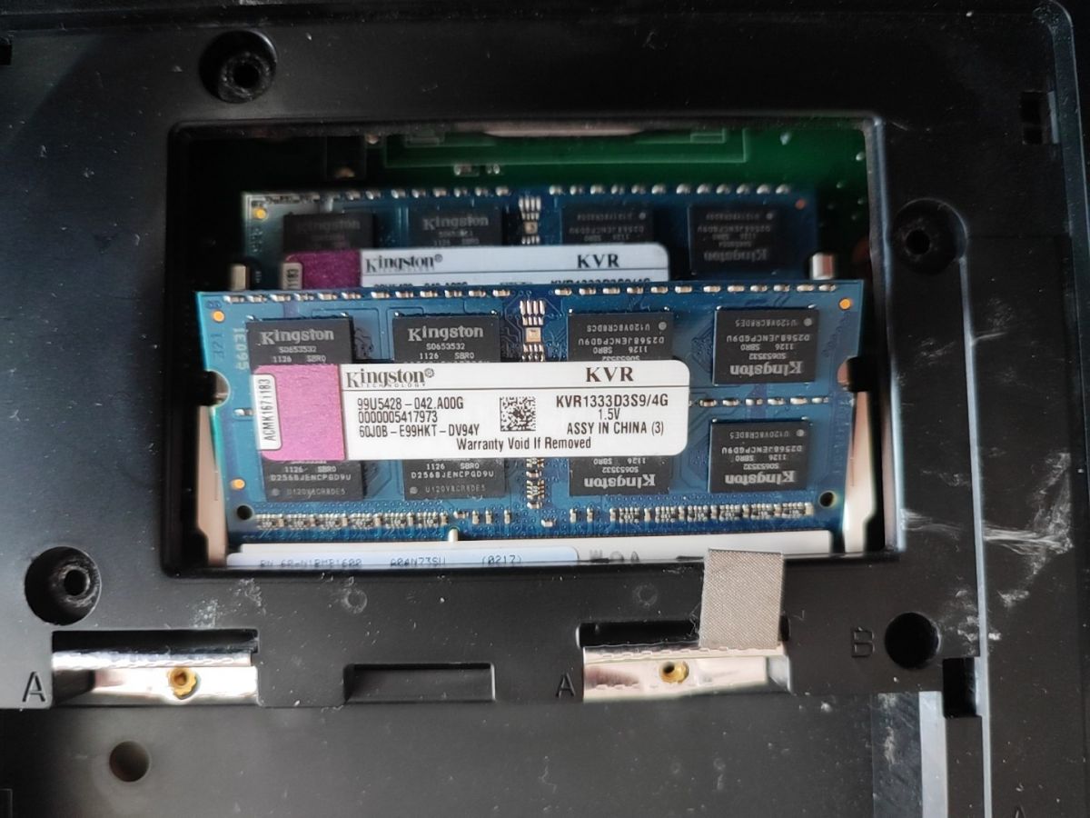

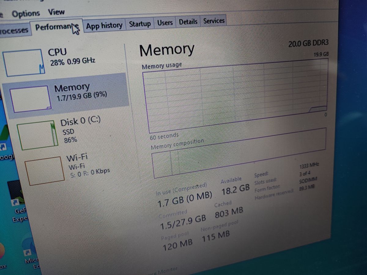

    Exchange #2:
    This is now a test of the 4+8+8 configuration:
    Close-up of two DDR3 RAM modules installed in an ASUS N73SV laptop.
    Works! 20GB RAM:
    Task manager screen showing RAM usage at 20 GB.

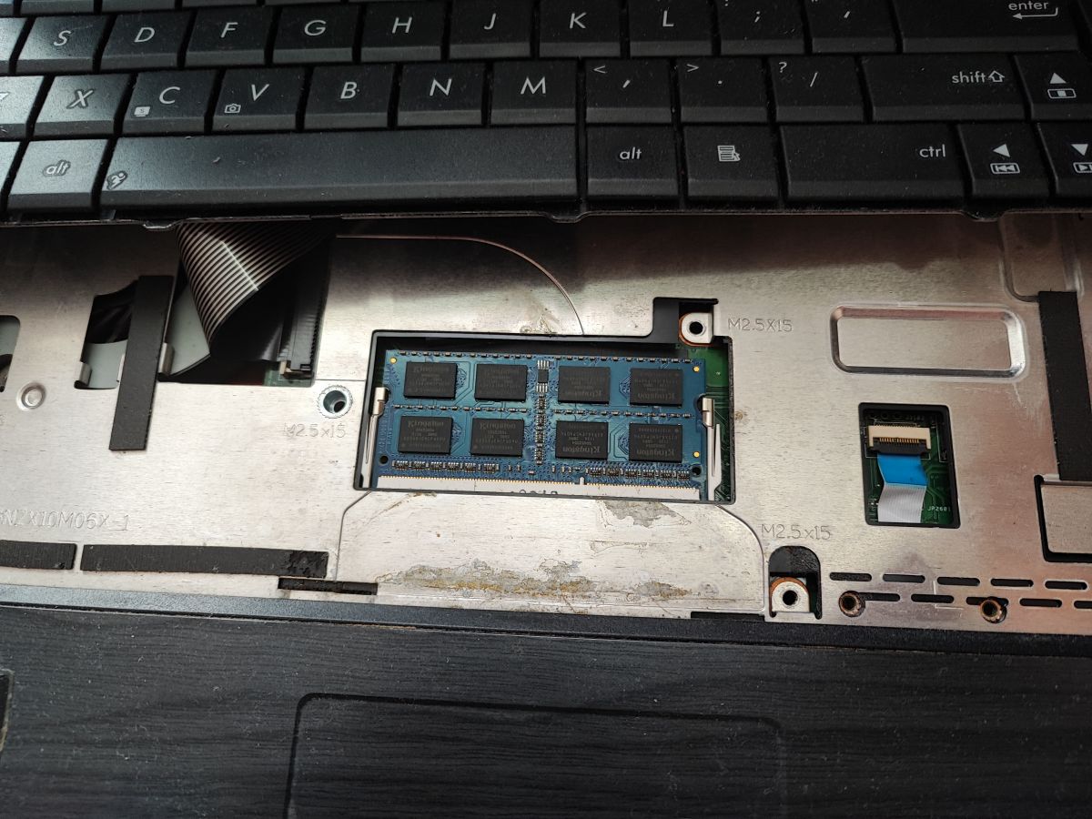

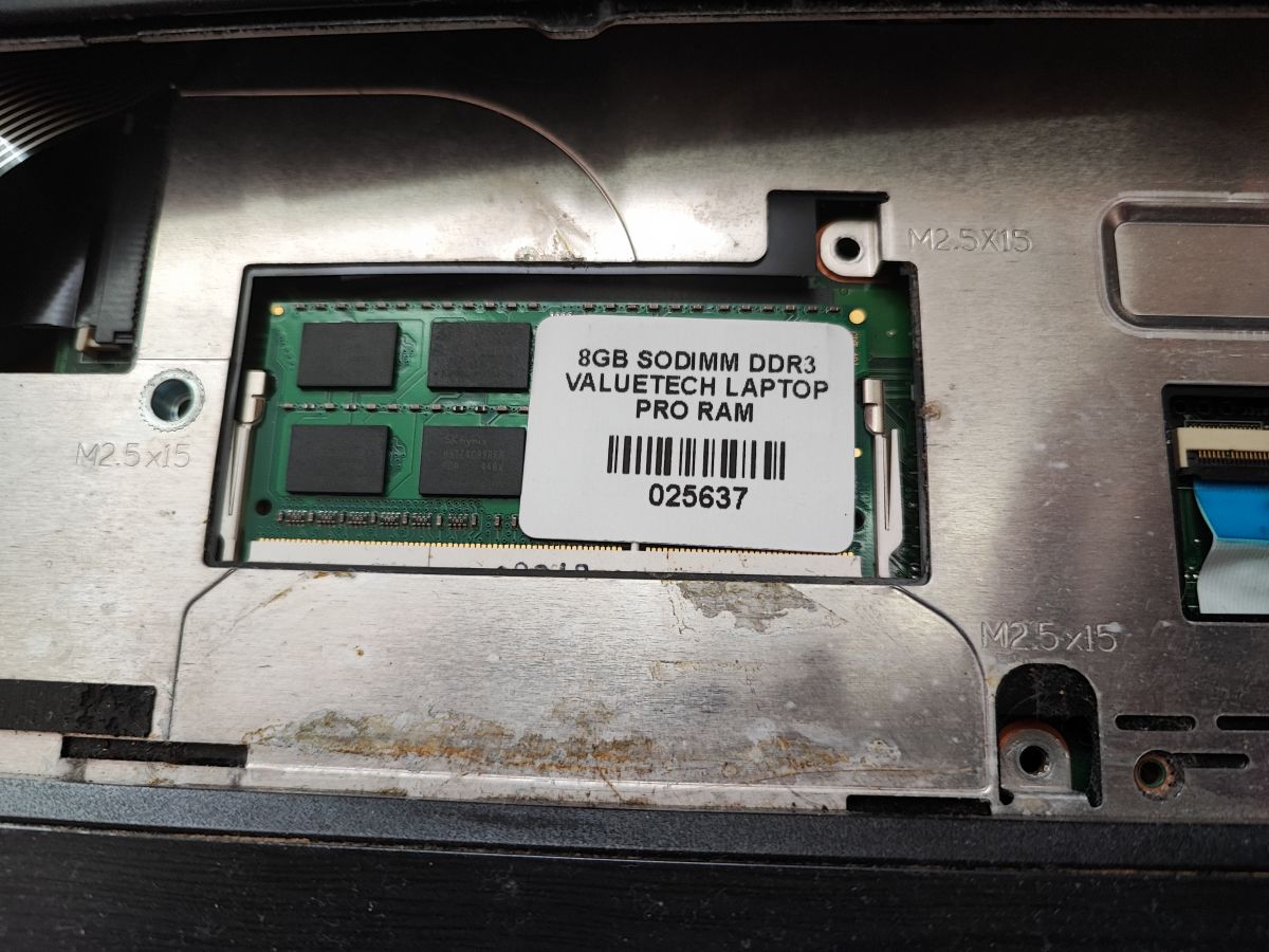

    Exchange #3:
    The last RAM stick is under the keyboard:
    RAM inside ASUS N73SV laptop with open keyboard
    We list:
    8GB SODIMM DDR3 RAM module in ASUS N73SV laptop.

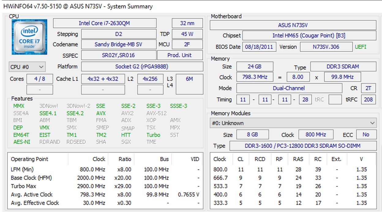

    Success, 24GB RAM!
    HWinfo:
    Screenshot of HWiNFO program showing ASUS N73SV laptop specifications with 24 GB of RAM.
    Interestingly, the memories are listed as "Unknown".

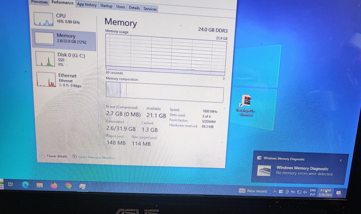

    Another mandatory memory test - mdsched : :
    ASUS N73SV laptop screen with diagnostic tool testing RAM.
    It really went through without errors:
    Windows interface showing 24 GB RAM usage on ASUS laptop.

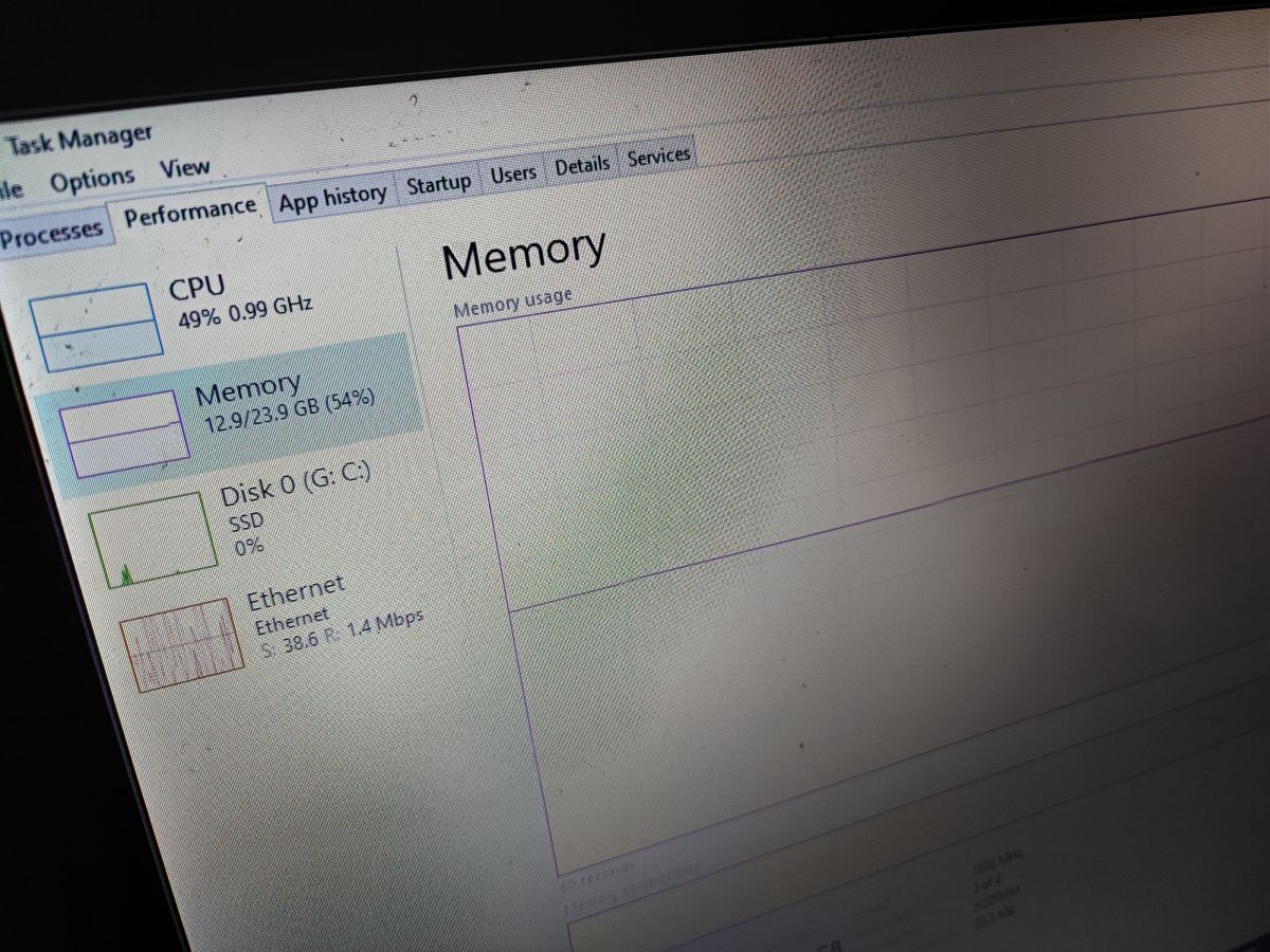

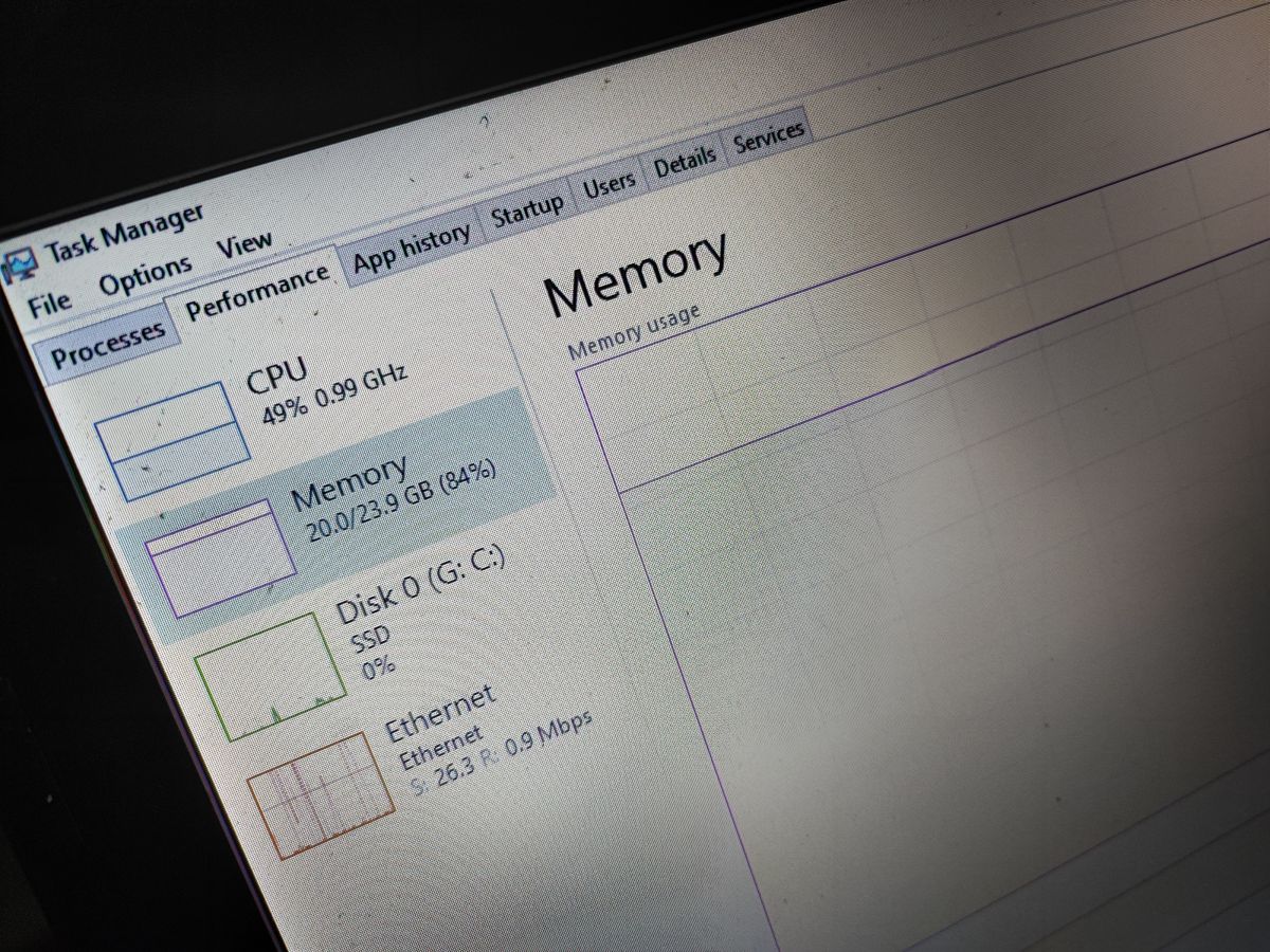

    It`s time for a practical test with my target application, which requires a lot of RAM:
    System resource monitor showing RAM usage at 54% out of 23.9 GB. Screenshot of computer task manager showing RAM usage of 16.3 GB out of 23.9 GB

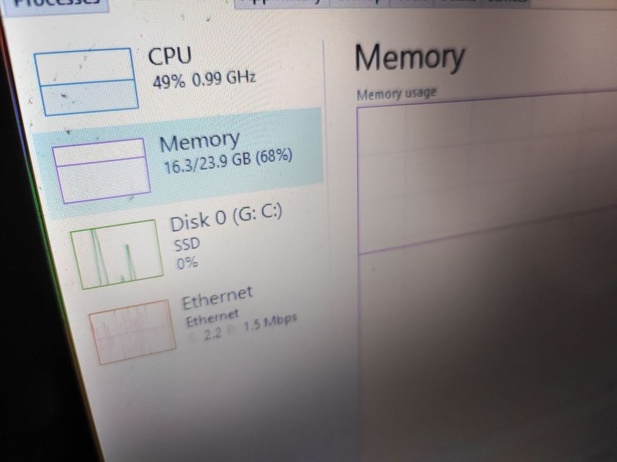

    It`s growing beautifully, over 16GB in use, everything is stable, but I want more:
    Screenshot of Task Manager showing RAM usage at 20.0 GB out of 23.9 GB available.

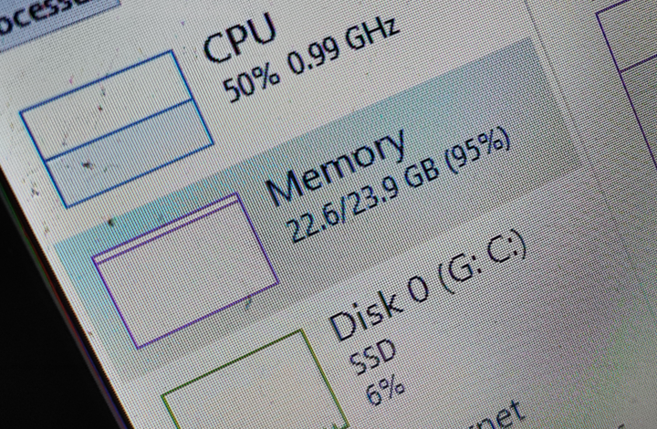

    And 22GB:
    RAM usage showing 22.6 GB out of 23.9 GB available on a monitor screen.
    22.6GB RAM in use, the equipment meets its intended use without any problems, no bluescreens.

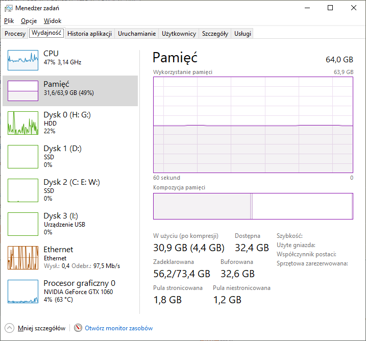

    Windows Task Manager window with the Performance tab showing RAM usage.
    but it will definitely be useful to me.
    I just wonder why it works... wasn`t there an 8GB stick at the time of production of this Asus and someone calculated the limit only by slots (3*4GB)? No, probably not... I won`t speculate, the bottom line is that it works.

  • Memory limits may be artificial or BIOS-enforced
    #8 21021342
    Zwierzak_PAH
    Posts: 1161
    Help: 127
    Rate: 269
    But you didn`t discover anything new, you only reminded or taught others that it can be done.
    This limitation that you omitted may be related to the organization of memory banks on the board (single-sided / double-sided).
    The memories have their own firmware (most of them) and it is not visible to an ordinary user.
    The specification quantity limitation itself may be physical and artificial. The manufacturer may do this consciously to distinguish between cheaper and more expensive equipment. It may be due to the time of origin of the equipment, because at the time of release and testing, no memory had yet been developed that met the requirements.
    They can even neuter the BIOS where the final one will be released in 10 years and it is unlocked, but no one will write about it anywhere.

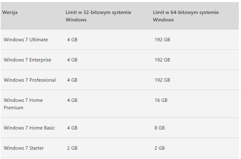

    In the glory days of w7, there was a nice table showing how RAM was limited depending on the client`s budget:
    Ignoring 32bit, look at the 64bit bar.
    Table showing RAM limits for Windows 7 versions based on 32-bit and 64-bit architectures.
