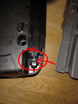

    At the end of the guide, where you slide out the guide (yellow) there is a steel pin marked with a dot.
    You need to slide it out. From the inside, lever it up with a screwdriver and when it comes out a little, then unscrew it with pliers.
    This pin is secured from sliding out by a pin, no worries, you will not break it, it is pressed in. And it is she who will put resistance when pulling out.
    Removing the pin, you will pull out the guide together with the cable.
    The black guide is detachable. It should be lifted from both sides and you will open it.
    It is best to photograph each operation, so as not to get lost later when assembling.

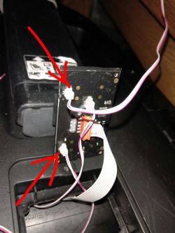

    To disconnect the cable is to unscrew the plate on which the batteries are located, solder and connect.
    Beware of the strange mechanism that tightens the cable in the guide and, of course, nothing by force, it is about the cable, so as not to break it in another place.
    I'll try to post pictures as soon as possible.
    Good luck

    Photo of the plate under the battery with the two connections of the right and left rail
    Dismantling Maxi Cosi Car Seat Base: Steps to Access Broken Wire Sensor Dismantling Maxi Cosi Car Seat Base: Steps to Access Broken Wire Sensor Dismantling Maxi Cosi Car Seat Base: Steps to Access Broken Wire Sensor
    The pin that needs to be slid out and the whole guide comes out.
    Dismantling Maxi Cosi Car Seat Base: Steps to Access Broken Wire Sensor .
