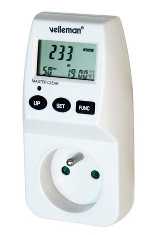

    I wanted to know how much power is consumed by the matrix in a 15.6-inch laptop with the backlight turned on?
    I measured with a wattmeter and, for example, a laptop swallows a total of about 13 W while viewing the desktop with the battery fully charged.

  • #10 16179277
    Krzysiek27
    Posts: 320
    Rate: 51
    atomic99 wrote:
    If you have a wattmeter, start the laptop and turn off the matrix, you should have a function button on the keyboard.
    Click and insert a photo of the keyboard, I will write you which shortcut, or find the same keyboard on the Allegro and send a link. On this keyboard, you have the matrix blank with the Fn + F7 shortcut (it then extinguishes the matrix without turning off the laptop)
    How much electricity does the matrix take from a 15.6-inch laptop?
    Buddy, you gave me a brilliant idea. And if I connected to another monitor using the F8 key, it automatically turns off the entire matrix electronics. E.t.c.
    I took measurements with a wattmeter.
    Laptop on, desktop viewing (brightness 1/10) 12.9 W
    Laptop on, off matrix + off backlight 10.75 W
    Laptop on, viewing the desktop on TV via 11.3 W VGA cable
    The power factor oscillates between 0.44-0.45% (PF)
    12.9 - 10.75 = 2.15 W. :P Matrix power consumption + backlight, is it possible? Unlikely. Because it is impossible to turn off the electronics that controls the matrices. You can safely add 4-5W. So it will come out 6-7 W. As my colleagues wrote.
