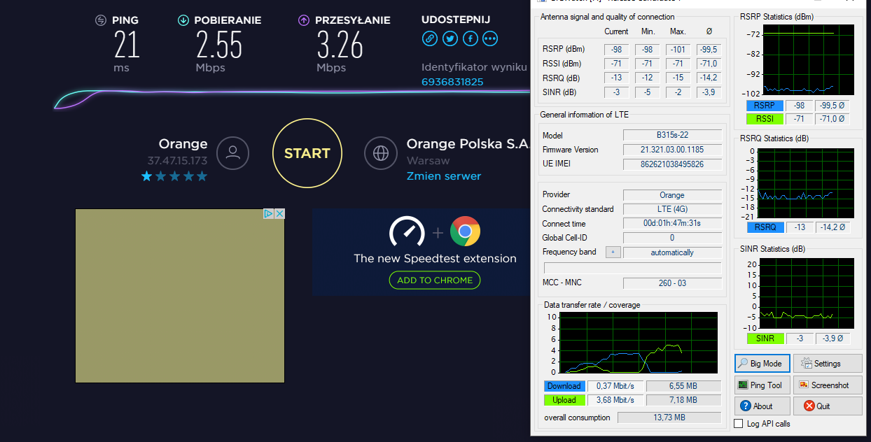

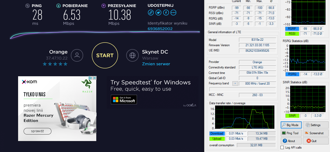

    I changed my location recently and I have quite a problem with the internet. Only one supplier (by cable) reaches the house - Orange. I took a neostrada from them with a dizzying speed of up to 10 mb / s. Unfortunately, this speed was only on paper and I get max 4 mb / s (download, upload is massive - below 1). Pings are elevated but very stable around 80
    I took the Huawei B315 router from the salon for a test. It doesn't fly very well without an antenna. It reaches somewhere around 2 mbps (down and up). From what I saw, the closest BTS in a straight line is 2.5 km away. The range on the router is 1 bar.
    The location is not the best for this type of equipment, it is quite far from civilization (Wojdyńska Street, Warsaw)
    1. Now my question, how much will the antenna improve the performance?
    2. What ping can I achieve and how stable will it be? Do weather conditions affect stability? It is of course about the occasional, relaxing playing of games without problems with jumping lag.
    3. What antenna for this type of location? Can you check which BTS is connected to? (Zdziarska Street?)
    4. The Orange network sends internet up to 10 Mb / s on the cable. Is it the fault of the place from which the signal is transmitted or very old cables?
    I care about stability and at least a bit higher DL and UL than the cable one.

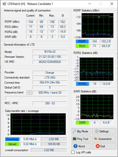

    Below are photos from LTEWatch

    I will answer 4 points.
    Probably the attic of the cables + a very long section to the nearest switchboard, probably 4-5 km.
    You can't do anything about it.

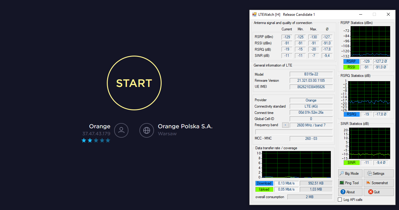

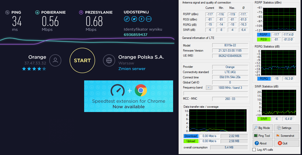

  • #6 16937067
    utyk21
    Posts: 21
    We got it wrong :) I was given this opportunity, not forced. I was looking for a solution to speed up this cable connection only. Then I got an offer from a friend in Orange to switch from neo to lte, I just had to test it what I am doing now :)
    I am throwing LTEWatch like that again only now with speed tests. On some bands the speedtest didn't even turn on. In general, the results were very cool, so I guess I did the tests around 24 when the network was much less loaded.
    automatic band:

    800:
    Antenna LTE for Huawei B315 Router - Orange: Improving Performance, Ping & Stability, BTS Range
    1800:
    2600:

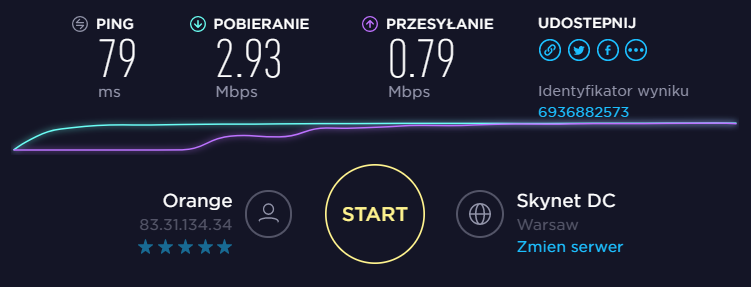

    Additionally, speedTest on the cable:

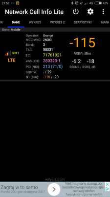

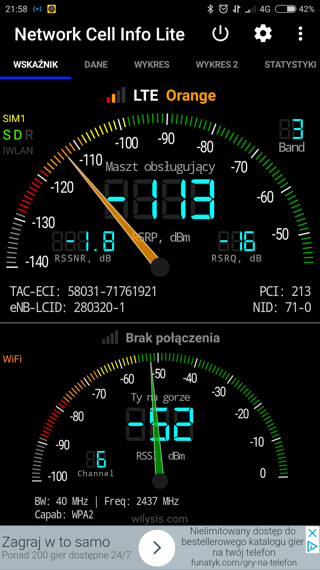

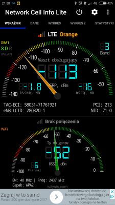

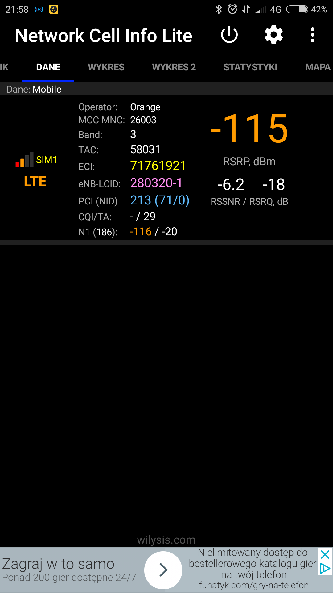

    Network Cell Info:
    Antenna LTE for Huawei B315 Router - Orange: Improving Performance, Ping & Stability, BTS Range Antenna LTE for Huawei B315 Router - Orange: Improving Performance, Ping & Stability, BTS Range

    Without whipping :) It is true that this limit would be 250gb, but at the same price. I have a package with a phone, the internet is about PLN 40
    This is how I live on the Wojdyńska street. Comparing the speedtest (at night) LTE and cable, it is better even without an antenna. Unfortunately, I have never been interested in networks, the directional antenna itself, how much can it improve the performance?

    Tough decision. Hopeless parameters LTE2600, very poor 1800, acceptable 800 which is clogged. According to stay me on LTE and order an antenna: Link
    You can return it within 14 days if it fails. The shortest possible cable, max 10m. You mount on the roof and head towards the BTSs. LTE800 has a signal borderline weak and acceptable, but it is clogged so the speeds will not be very good.
    It is worth doing tests under the local LTE1800 transmitters in the peak to check what speeds they offer.
