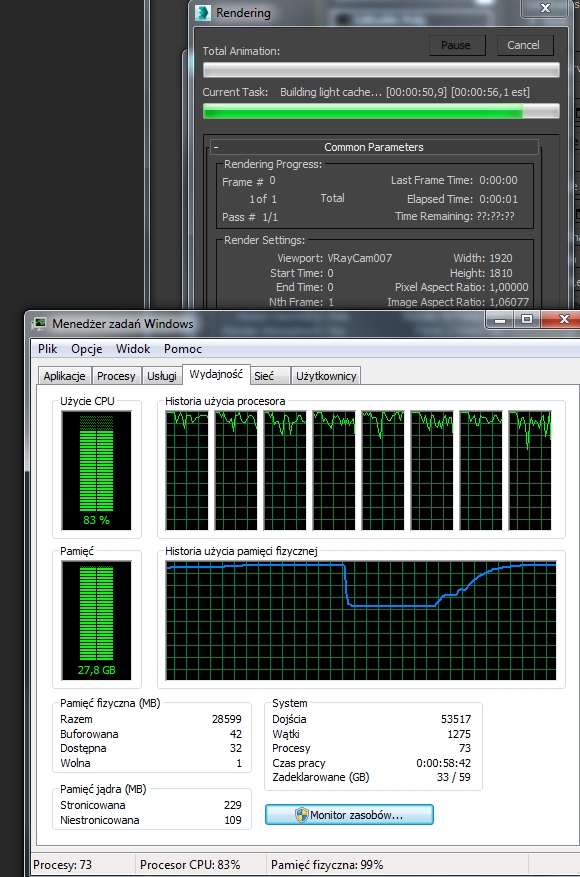

    We all know that 3ds Max has high hardware requirements and I also take it into account.
    Sometimes, with large 3ds Max projects, while rendering in V-Ray 3.4, I use all my RAM, which results in the program being thrown to the desktop after an earlier warning from Windows that the computer is lacking RAM.
    In the V-Ray settings themselves, I tried to enter different values into the dynamic memory limit but unfortunately it did not help at all.
    I try to avoid the problem by exporting most of the heavy objects to the proxy and partially pass the exam, but unfortunately not always.
    My memory is 28GB Kingston Hyper Fury DDR3 1600MHz.
    The question for you is, do you know any program in which I could set the limit of RAM used for 3ds Max?
    By default, in Windows it is possible to set affinity for individual threads of the processor, but unfortunately it is not possible to set some RAM limiter.
    I will add that 3ds Max throws out when the value of RAM consumption reaches approximately 26GB.
    So I need a program that will block the use of more than say 25GB RAM.

    bates wrote:
    SWAP disabled and set to no paging file.
    For starters, I would suggest turning on SWAP. This should fix the out of memory issue (missing physical memory will be replenished with virtual one as needed).

    bates wrote:
    With SWAP turned on, the program behaves exactly the same
    What parameters have been set? I propose to enable manual setting of virtual memory for the test and hardly allocate the paging file size 32GB. I assume there will be enough space on the swap disk.
    The parameters were set to standard, i.e. controlled by the system, and I remember that 3ds Max was also throwing me when it reached critical RAM consumption values.
    If I set it to 32GB as you suggest, then the paging file will automatically occupy so much on the disk?
    At the moment I have on the disk: C 10gb of free space, I need a format and an increase in the size of the partition, I think.
    Yes.
    Set the swap file to another drive, it doesn't have to be on C:

    Success! I set it as you indicated the SWAP rigid to 32GB and it does not throw out 3ds Max anymore! :D
    During rendering, the RAM consumption reaches the maximum value, yet the program works stably and continues to render.
    Now I wonder if it will not be like Kulik88 wrote that 3ds Max will be sluggish for me, but it will probably come out in the wash :)
    Thanks for your help, it will save me a lot of stress.

    If it starts to need a lot of virtual memory, it will definitely slow down. However, the error that you experienced does not have to be due to lack of RAM. Some programs, despite having available even a very large amount of physical memory, still require the presence of virtual memory. Why - this is a question for programmers and people who know the operation of this mechanism "from the inside", I did not penetrate. So, despite having a large amount of physical memory, it is worth having SWAP turned on.
    You can try to mix a little with the size, set e.g. minimum 8GB, maximum 32GB (or choose other reasonable parameters) and see if it will not be enough. Unless you don't mind 32GB loss on a drive, it can also work that way.
