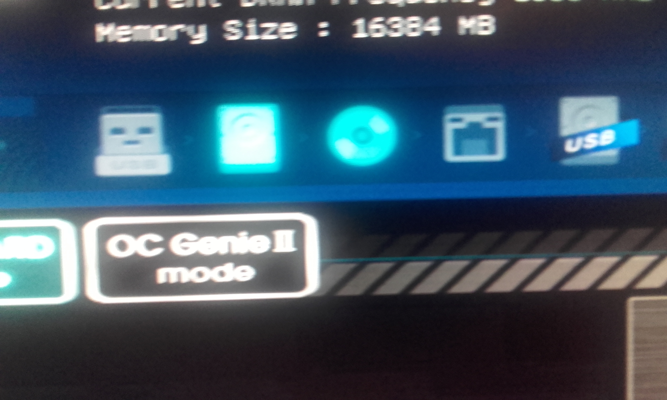

    I have a problem with the ram slot.
    I used 16GB DDR3 RAM on 2 slots all the time, recently I noticed that it only displays 8GB to me, I decided to check what the problem was, both frame bones worked, and the other slot does not read my bones.
    RAM DDR3 2x8 from Kingston.

  • #13 17094472
    Arabsky
    Posts: 8
    The problem lay in the pins on the CPU, I noticed that one pin was slightly skewed, I decided to straighten it and the problem was solved.
    Thank you all for the advice
