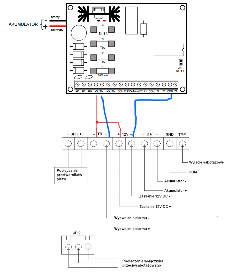

    Hello, help please connect the SL-550 alarm siren to the Satel CA4V1 alarm control panel. The diagrams below:
    Connecting SL-550 Alarm Siren to Satel CA4V1 Control Panel: Wiring & Setup Guide Connecting SL-550 Alarm Siren to Satel CA4V1 Control Panel: Wiring & Setup Guide
    I connected it like this:
    The siren "flashes" but the siren is very quiet.

    He read the manual, why the siren requires constant power supply?

    You've posted photo siren outputs where it is clearly stated that it needs constant voltage and triggering from + 12V, so?

    yes will it be ok?

    ok, so is it supposed to be like this? Connecting SL-550 Alarm Siren to Satel CA4V1 Control Panel: Wiring & Setup Guide

    Unfortunately, the siren keeps howling quietly. I will have to send back the warranty - unless someone has an idea what could "fall" in the module?
