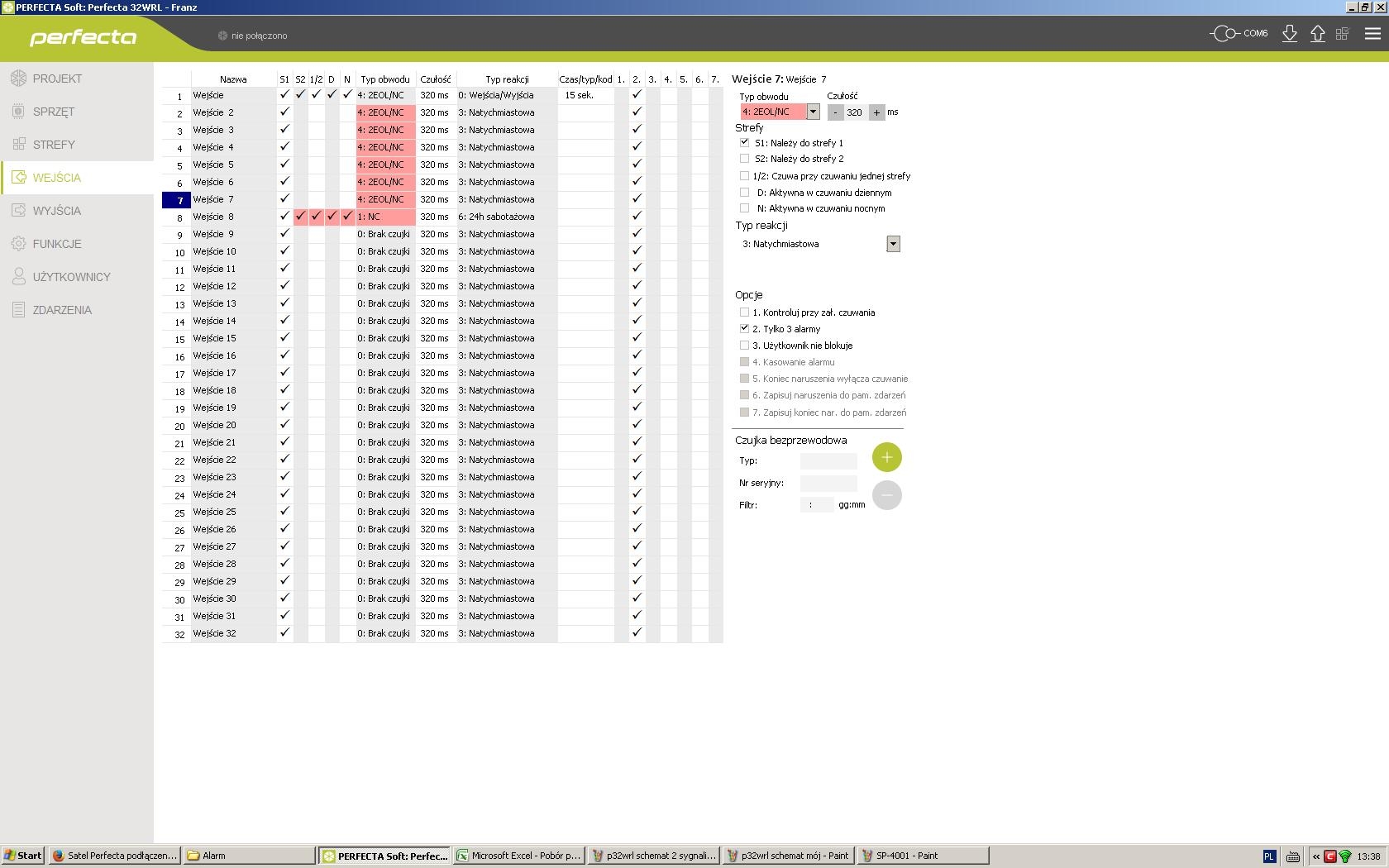

    On the 3rd screen there are output settings:
    1 -0, 2 - 11, 3 - 1, 4 - 1,
    1 and 2 are high-current outputs and 3 and 4 low-current ones. 1 and 2 are used for power supply and 3 and 4 for control. Do these settings mean that the control is from 3 and 4 and the supply of both signaling devices from 2?
    I have two beacons to connect to the perfect 32wrl. While I can handle the connection, I have a problem with the settings. SP4001 I was going to connect the control to out3 and the spw250r to out4 and set OUT3 to external signaling. and OUT4 for 2 internal siren. I don't know how to set OUT 1 and 2 to use these outputs as power supply for both signaling devices.
    I am asking for help.

    Franzelot
    Posts: 18
    Looking at the diagrams from other posts, the connection would look like this, but it was CA-5 and a 2.2kOhm resistor was also used there (between the Z8 and TMP of the enclosure, but it is probably because of the CA5 in which you have to do it) -screen1. I haven't read perfectly that you have to use such a resistor. However, when I look at information and diagrams of connecting sirens, my correct connection should look like this-screen2.
    Connecting Sirens to Satel Perfecta 32WRL: Setup for SP4001 & SPW250R with OUT1-4 Settings Connecting Sirens to Satel Perfecta 32WRL: Setup for SP4001 & SPW250R with OUT1-4 Settings
    For this setting the control panel
    Or maybe connect SP4001 SO and SA under OUT1 and SPW250R + 12V under OUT2 + and then program OUT1 as an external siren and OUT2 as an internal siren?
    I have 7 Bosch PIR detectors (2EOL / NC) and one PRF-LCD keypad for the whole system. I will put 1 detector upstairs to the corridor, but no problem, I will cover without an expander, I will connect two detectors from the dining room and kitchen to one entrance). I wanted to connect the detectors power supply to AUX both (for 4 detectors each)
    Looking further into the I / O settings, I think OUT3 should be set to 3: Burglar alarm.
    OUT1 outdoor siren SA / SO +/-, and OUT 2 outdoor siren + 12V / COM.
    Will this configuration be correct?

  • #7 17154374
    Franzelot
    Posts: 18
    I have what I have and I have to make sense of it somehow, I know that you should not connect detectors on one line but in this case I have to do it (temporary solution). As for sabotage, I didn't even know that it was a mistake in art with such a combination. Suggests a colleague that tamper with detectors and sirens and enclosures connect separately? So I would need 3 free entries - at the moment I don't have such comfort.
    In the future I will buy an expander because I want to add reed switches to wired windows and also do roller shutter control (lower / raise) and garage door control. Then with the expander I will be able to separate everything, and at the moment I have to be content with what I have and what I can do about it.
    As for the SP4001, optics and acoustics are supposed to work together for me and the SPW250R is supposed to support external operation. It is known that the outside is hardly audible inside. The siren are to work with every violation of detectors and also when sabotaging nothing more I require of them (well at least not that they would make me dinner :) ).
    Ultimately, I would prefer that this alarm never works for me or anyone (I mean correct operation), let it sit quietly.
    Thank you for your answer
    Best regards.
    EDIT:
    Then I have a problem. I connected one detector and an internal siren to the keypad and is still howling. I didn't have a battery - I thought that because of this, I connected the battery, still howling. Connection as in screen 2, i.e.
    OUT2 + -> 12V +
    COM -> COM
    OUT3 -> D
    COM -> TMP
    Z8 -> TMP
    All out settings in the control panel as unused siren howls, after setting OUT2 and OUT3 as an internal siren, they continue to howl, even when I disconnected the power supply and batteries.
    What am I doing wrong?

  • #12 17158363
    Franzelot
    Posts: 18
    norbert.s. wrote:
    Buddy, howls because you haven't reversed the polarity of the siren trigger output, any of it can even be low current. This signaling device is triggered by loss of weight or plus, in the case of Perfektta it is to be set to loss of weight -D. That's all about controlling this siren.
    And I checked this setting, because I read about this polarization, I do not know how it did not work before, you can see something wrong. Probably only OUT3 marked correctly. Thank you, the dog was buried here.
    suworow wrote:
    It will eventually be a colleague connecting detectors in DEOL or with a tamper loop, because I'm a little lost in it? As in DEOL, someone recently asked on the forum how to connect two detectors in this way to one line. Just review the max topics from last month.
    Detectors in 2EOL / NC, when I wrote about tamper, I meant connecting the tamper from the housing and sirens to COM / Z8 terminals. Here, I have set the input as NC and the reaction type as 24h tamper-connection and setup, I just saw in the forum.
    suworow wrote:
    This is the problem of self-declarations and life. A friend declared to us that he wants to learn and is blindfolding. After all, I wrote that it is worth training yourself by connecting the siren on the table directly to the battery ... After all, he drew in the diagram the release of this siren .....
    I do everything "on the table", everything is undressed connected with only one detector, without battery, sensor tamper wrapped in an elastic band :P The makeshift herself.
    Now only notifications remain set and assemble everything. I will connect the second siren when I mount the housing with the control panel where it should be. I have the schematic, I should know no polarities. Tomorrow I will put everything together, I will mark the post as resolved.
    Thank you all for the advice and patience.
