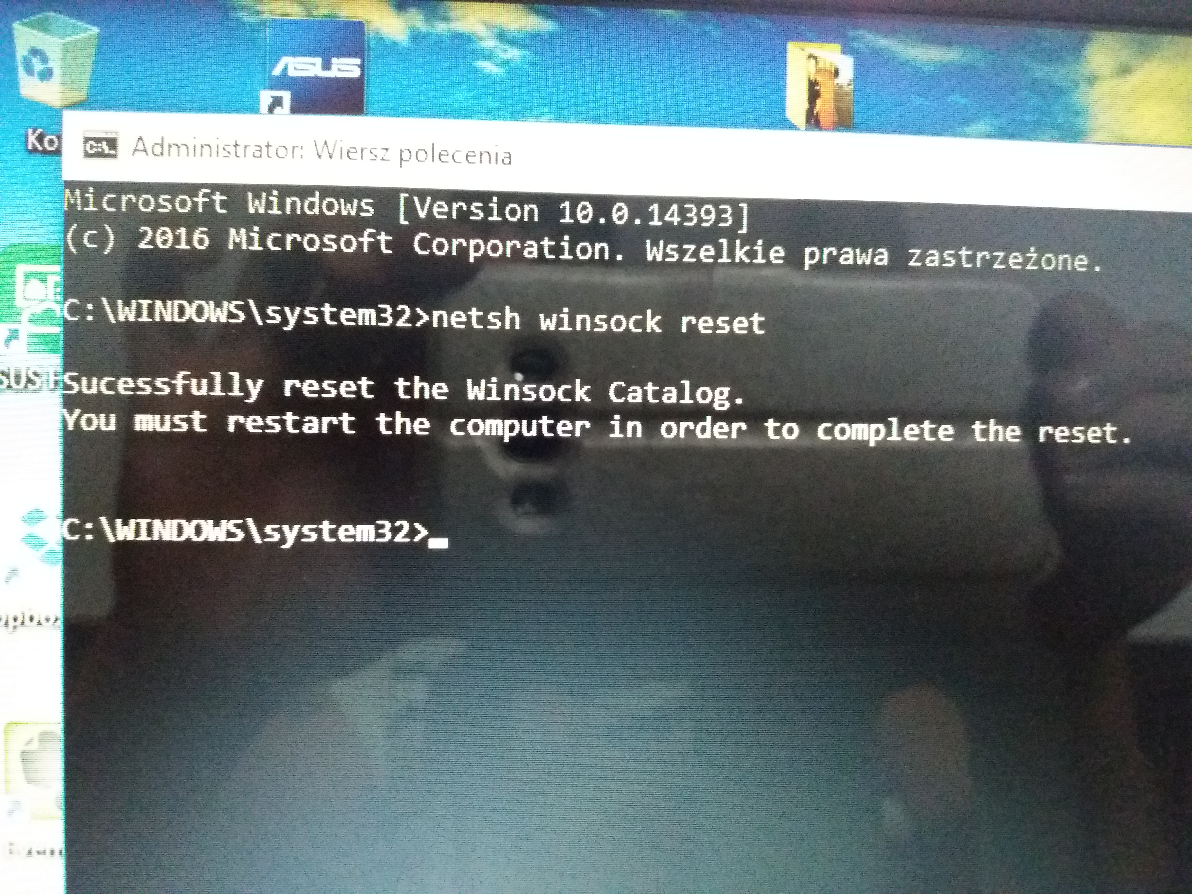

    dt1 wrote:
    Run netsh winsock reset from a command prompt as administrator
    Right-click on the start menu and select the command line (administrator) from there.

    I think I already did that order! Please check.

    I understand that still nothing has changed with the operation of the network?

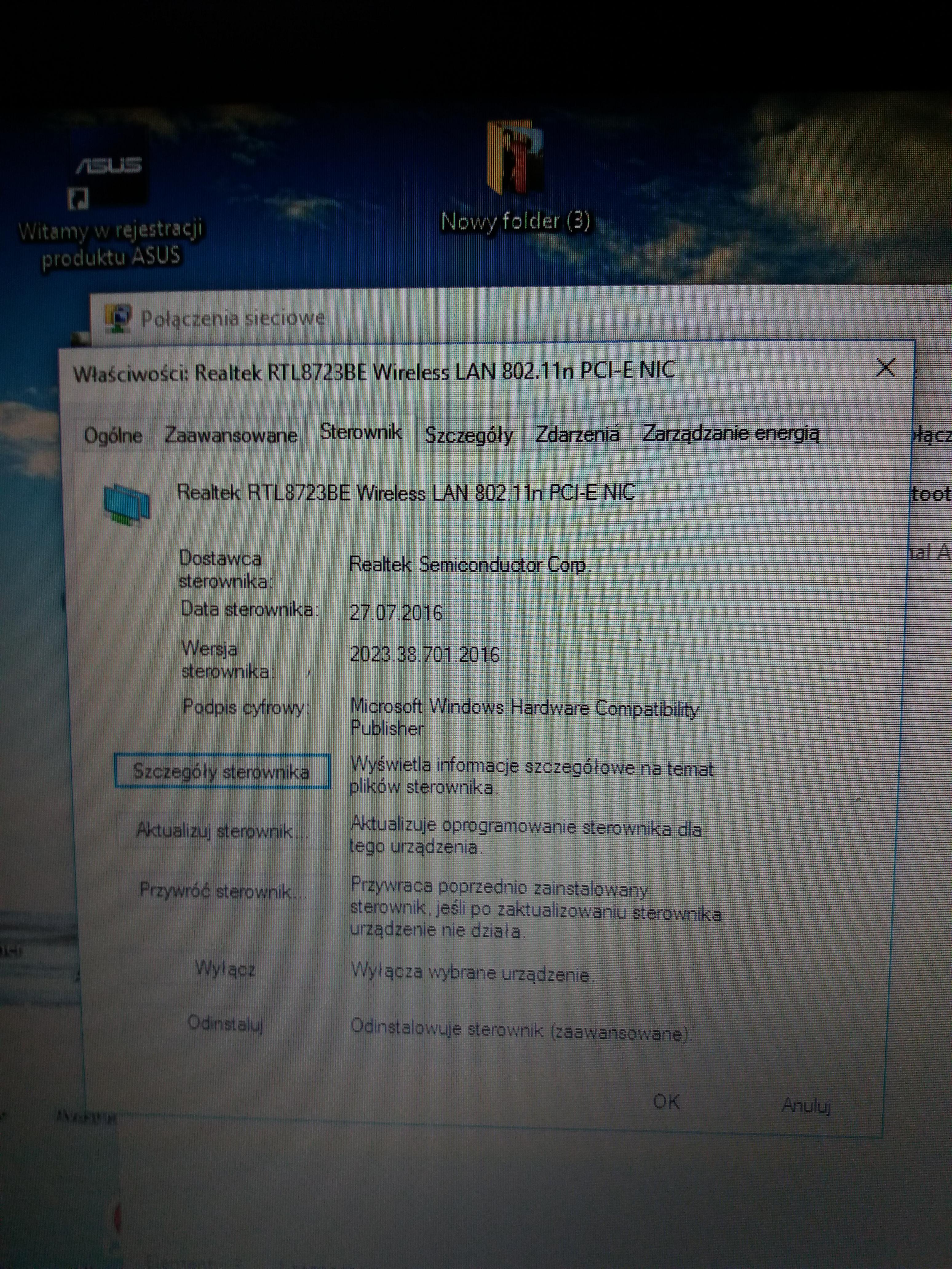

    Returning:
    dt1 wrote:
    What is the version and release date of the WiFi driver? This can be checked in the device manager by entering the properties of the WiFi network card (Realtek 8723BE) and in the driver tab.

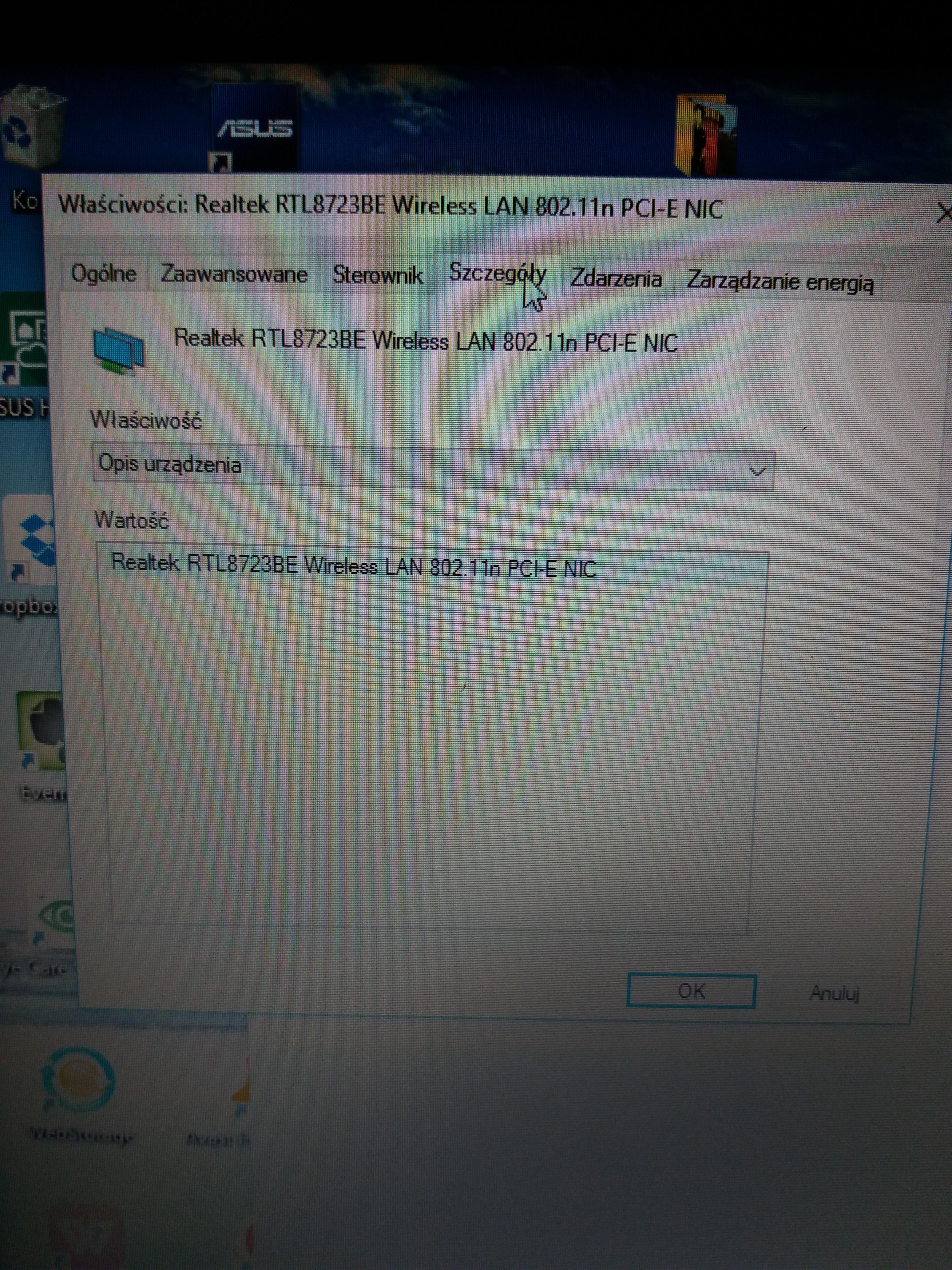

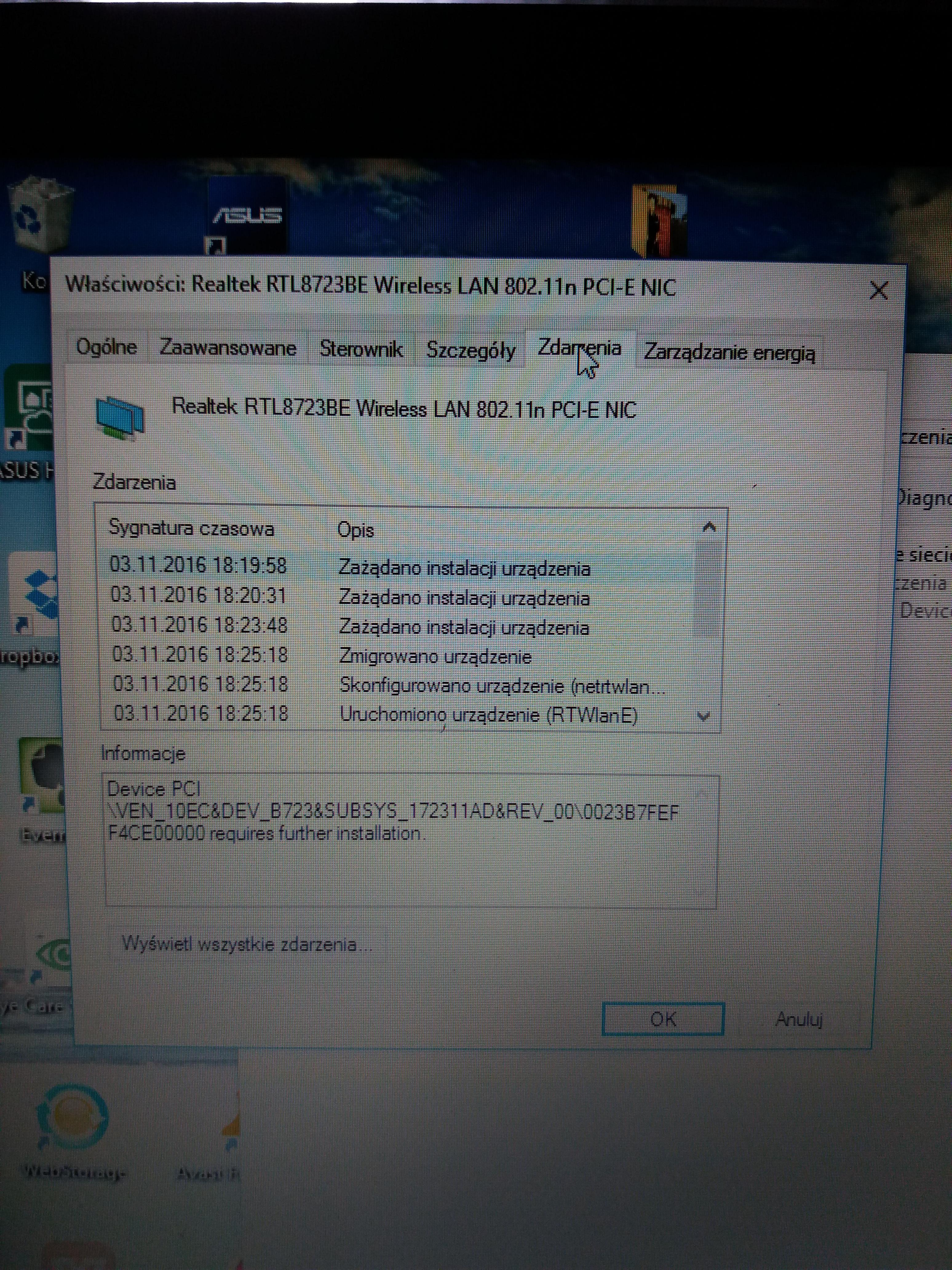

  • #37 16213646
    feerbe
    Posts: 31
    Rate: 40

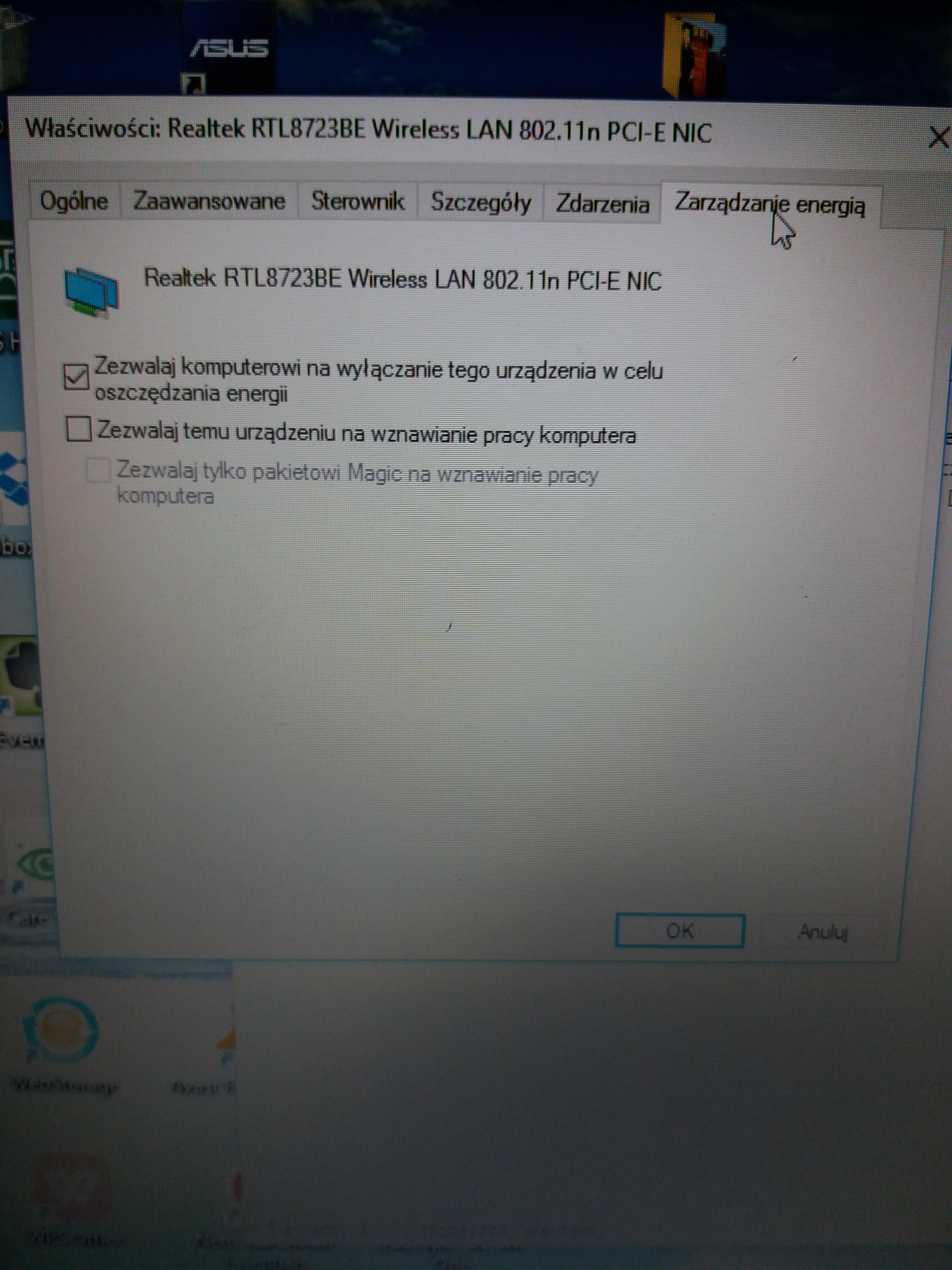

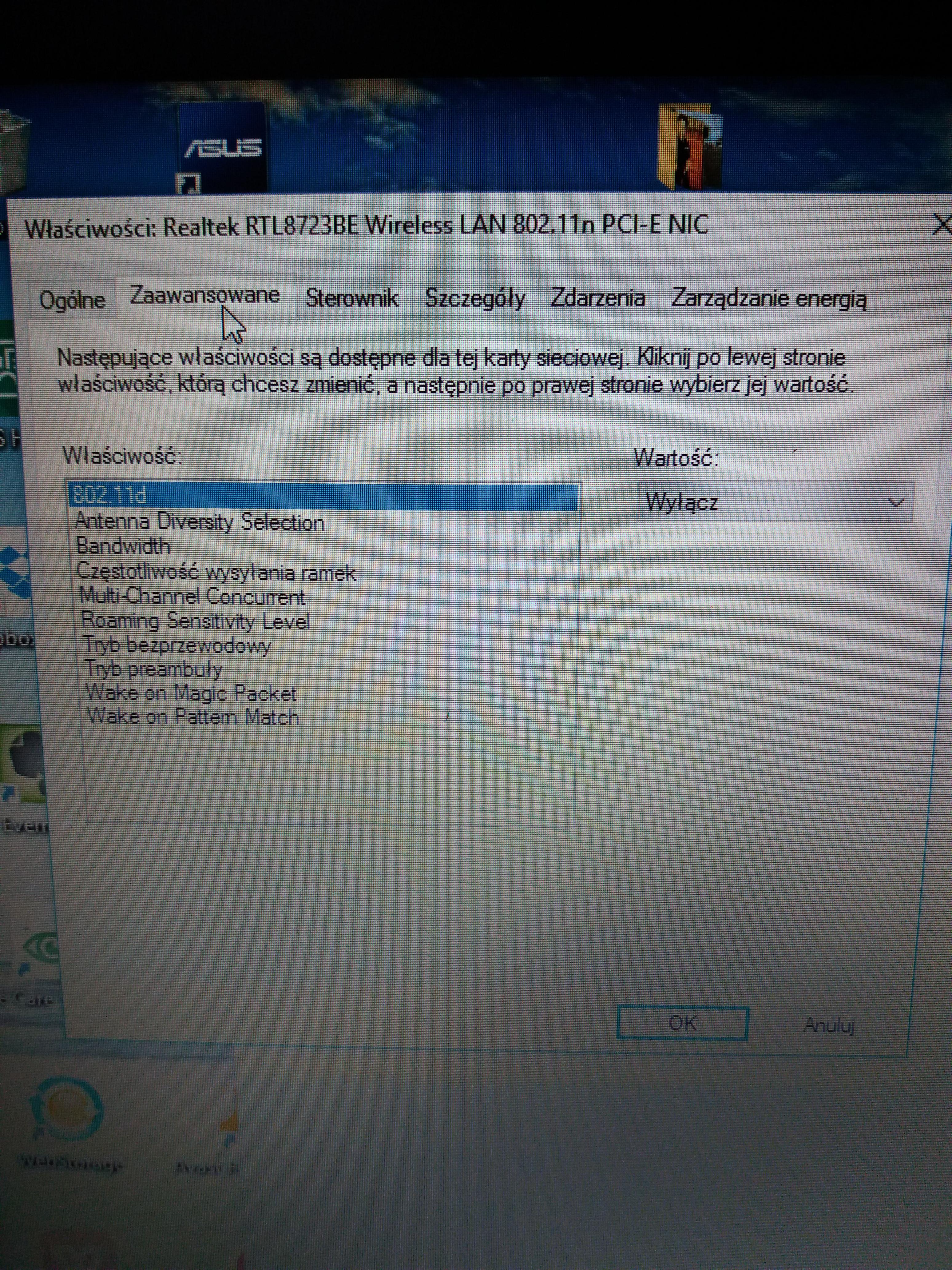

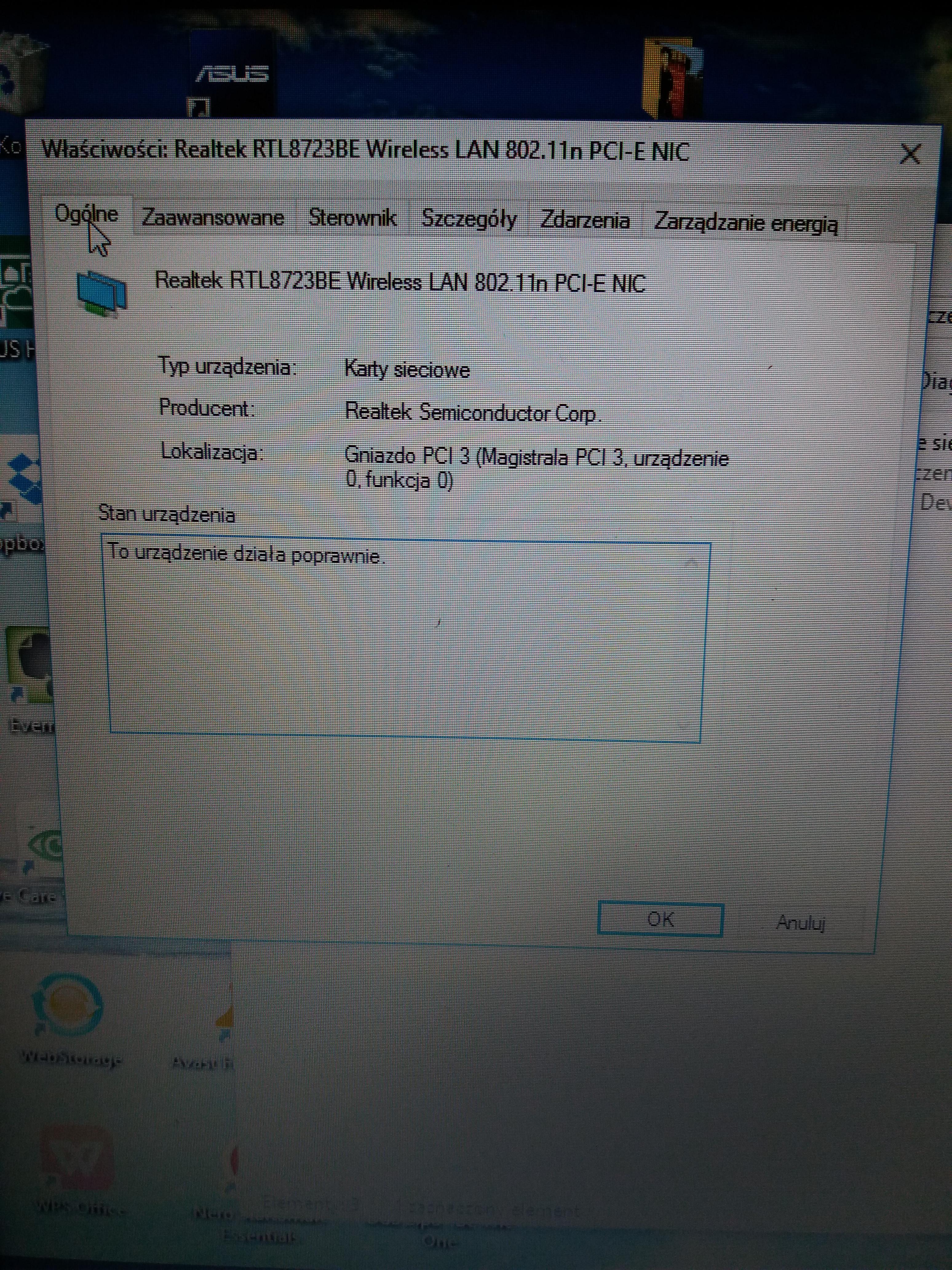

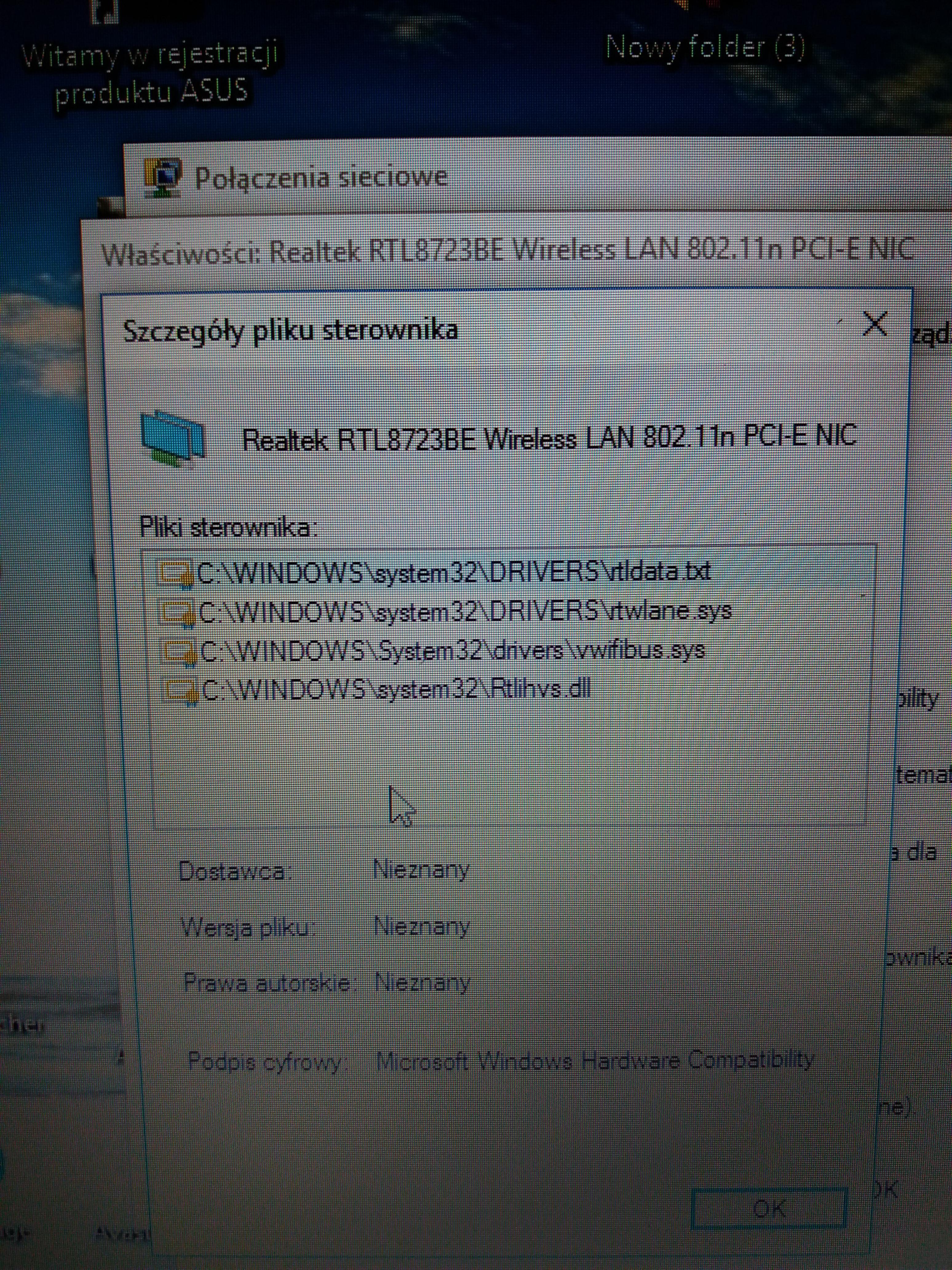

    Hello. I will give you a few photos regarding. driver
    • Incorrect IP Protocol Configuration on WiFi Network Adapter: Laptop Modem Connection Issue 20170120_100712.jpg (1.4 MB) You must be logged in to download this attachment.
    • Incorrect IP Protocol Configuration on WiFi Network Adapter: Laptop Modem Connection Issue 20170120_100703.jpg (2.71 MB) You must be logged in to download this attachment.
    • Incorrect IP Protocol Configuration on WiFi Network Adapter: Laptop Modem Connection Issue 20170120_100655.jpg (2.46 MB) You must be logged in to download this attachment.
    • Incorrect IP Protocol Configuration on WiFi Network Adapter: Laptop Modem Connection Issue 20170120_100641.jpg (3.23 MB) You must be logged in to download this attachment.
    • Incorrect IP Protocol Configuration on WiFi Network Adapter: Laptop Modem Connection Issue 20170120_100632.jpg (2.92 MB) You must be logged in to download this attachment.
    • Incorrect IP Protocol Configuration on WiFi Network Adapter: Laptop Modem Connection Issue 20170120_100420.jpg (3.49 MB) You must be logged in to download this attachment.
    • Incorrect IP Protocol Configuration on WiFi Network Adapter: Laptop Modem Connection Issue 20170120_100329.jpg (2.34 MB) You must be logged in to download this attachment.
  • #38 16214257
    dt1
    Admin of Computers group
    Posts: 48250
    Help: 7315
    Rate: 8292
    Try to install these drivers (installation from device manager, update driver button in your last photo.
    • RTL8723be-w10-x64.zip (2.76 MB) You must be logged in to download this attachment.

    Unfortunately, it didn't help. It was written that the driver is up to date.
    Added after 24 [minutes]:
    In addition, when diagnosing the problem, there was a prompt "default gateway is unavailable"
