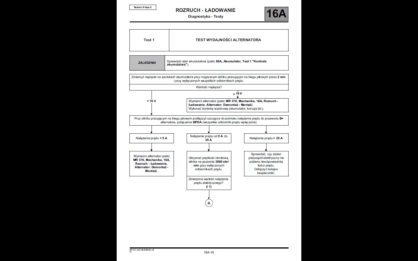

    Renówka began today having a delay after pressing START to start cranking the engine. There was a message for a moment, but I didn't have time to read it. I started to bet on the battery because it's already 9 years of work. Fortunately, I have a CLIP, but after connecting it did not show anything except the saved errors of the STOP switch (foot brake), which I fixed two weeks ago. In addition, the manual module had three errors with 326 km / h as vehicle speed.
    I looked at various parameters of the car and my attention was drawn to the voltage in the 15.4V installation on various modules. I confirmed this value with a multimeter on the battery. After a few minutes of engine operation, the voltage dropped to 15V.
    I plan to replace the battery anyway, but I'm worried about the voltage in the installation. Now the question is, in this model, is the voltage regulator built into the alternator or is it controlled by the vehicle's computer?
    The car is from 2008, petrol engine 2.0 (automatic).

    It is built-in, additionally the voltage is controlled by the motor controller. If you have such charging, it is probably a scrap battery.

    On the alternator.
    Measure the voltage in the installation on the battery and on the alternator with a meter.

    I think you should first insert a new battery and then possibly replace the regulator. At least for the test. How will the charging voltage change. Did you measure the voltage with the battery dead?

    Charging at the level of 15.4 is acceptable but it indicates a large current expenditure of the alternator and either the battery is weakly charged (you will not check it if you do not replace the battery with another one - connecting additional power sources in parallel to it does not change anything because they will load all the time charging system) or the regulator is actually damaged, but this will only come out during the alternator current tests performed with a working battery.

    Practice shows that when> 15V packs, it warms up. Max is 14.8 in a few cars and not all the time. Replacing the regulator should help
