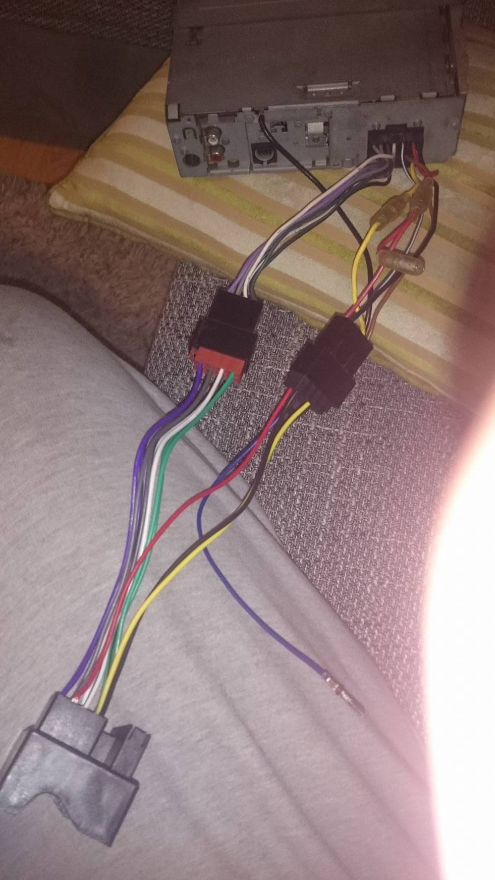

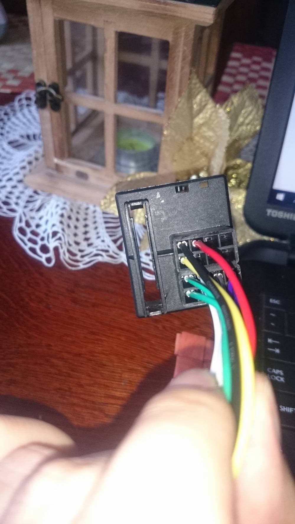

    Hello, I can not connect a non-factory JVC radio to the original radio installation in C3 from 2005. The original bone consists of two cubes, the upper is from the power supply and the lower is probably the speakers. It is about the upper one, namely in the car that I take turns counting from the left there are two rows to connect the cables:
    from the top I have:
    1 box thin green cable
    2 empty field
    3 empty field
    4 pole green thick cable.
    Second row from the left I have
    1 empty field
    2 boxes thin red cable
    3 empty field
    4 box of green kabalków thick as above.
    I know that to connect an unoriginal radio I need to buy a switch to normal ISO and I bought such a switch but after mounting, as it is, nothing happens.
    In the adapter, on the other hand, I have this cable configuration:
    1 square from the left, black
    2 squares red from left
    3- free
    4 - free
    Second row:
    1- yellow field
    2,3,4 free.
    I know that I still need to have an antenna separator but I have already purchased it and I need to connect it to somewhere but I have a blue wire to connect to it but smaller with it. The original bone has these two green cables and one red. How to rewind it to radio

    konrad.p73 wrote:
    red is probably a plus after the ignition and thin green is a plus for lighting (when you turn on the lights)
    For this advice you should get banned from the finish line !!!!
    This is an installation on the wall - after connecting something under a thin green or red there will be a million errors in bsi soon and may not start the car!
    There is no ill and acc in this installation!
    kasidi wrote:
    and this adapter I bought
    Is the transition to C3 or any on iso2?
    C3 has the opposite + and -.

    This is how it looks from the radio to the passage :) I got an info from someone that this car has no plus after the ignition and one of those thick green is a plus and the other mass and that the radio works I should connect red bridged with yellow under green plus and black under minus? And it will work what you think about it?
    • Connecting JVC Non-Factory Radio to 2005 Citroen C3: Wiring & Antenna Separator Guide 16251082_1287780737934132_972979474_o.jpg (157.74 KB) You must be logged in to download this attachment.
    It will only work if it is not known whether it will drain the battery.
    Make a bridge on these rubber connectors on the radio.

    that is, I will connect yellow and red with these connectors and I will give red one to green with plus in the radio cube and the other to minus and it should work :)

    Hello. Topic overwhelmed. One of these two thick greens and more specifically the one without the strip along the cable is a plus and the other is a minus. As here colleague above suggested in Citroen plus minus were swapped, minus at the top and plus at the bottom. I checked with a diode that lights only as there is a plus to minus and minus to minus, otherwise it was impossible, in one configuration it only caught fire. And so I connected the radio using only these two wires. Antenna fakra separator is still mounted. Of course, there were surprises, namely in my car not only there was no radio but also loudspeakers heh. I managed to buy a set of 6 original pieces for a penny so now everything is nice. It was also a surprise that I was expecting the lack of beam in the rear door, but to my surprise there were ankles originally plugged into the connector in the door, you only had to unplug it to the speakers. I still lack speaker mounts on the back because I didn't know I would need them, but they are on the way. As for the discharge of the battery I measured the power consumption and when the panel on the radio draws 0.02 And if no panel, the power consumption is 0 so there is hope that it will be ok. I think the topic is solved. So to close. Thank you colleagues for help and suggestions. I think it is worth leaving this topic as someone would have a similar problem as me.
