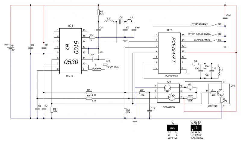

    Due to the lack of time, I had the Scenic II card repaired quickly.
    After returning the card from the service, I put new batteries in two cards.
    The card that returned from the service took care of the battery within a week, the one that was not used still has a working battery.
    I changed the batteries and the same after a week.
    I decided to dismantle the card and it turned out that the capacitor is missing - what is its value? Two photos (before and after the service).
    Can the lack of this capacitor affect the very quick consumption of the battery or look for a short circuit on some element?
    Has anyone ever measured the current consumed by the card during "rest" and operation?

    This capacitor often crumbles when opening the card. Rather, it does not affect the discharge of the battery, I have it without it and nothing happens.

    Using the photo, can anyone provide the values of the capacitors?
    I put in a picture of the Scenic 2 card from HF. If someone wants to, please add the known element values to the appropriate number. Together, you should be able to enter all the values. It will be for posterity :) .
    Renault SCENIC - Scenic II Card: Rapid Battery Drain & Missing Capacitor Value
    HF - antennas around 80R
    2 - 220pF
    3 - 1nF 50V
    4 - 8.2pF
    6 - 1nF
    17 - BCR108

    I soldered the elements around the transmitter and for some time the resistance at the battery connectors was ok.
    After a while, however, everything returned to normal.
    Damaged print somewhere?
    I also fired those metal buttons and still unchanged.
    Anyone have a PCB board for sale with HF?
    INFO: The HF card also works with only one antenna. I checked it this way.
    Megane II and Scenic II card schematic without HF.

    I did not go into the diagram of what's what, for me some of the elements had to be soldered. As I said, my card is missing condensate, but it works fine.

    Most often the 5100 transmitter is damaged. Buy a better used card and solder your PCF7947 to it.
    The TDA5100 chip is hard to come by and comes in a variety of housings.
