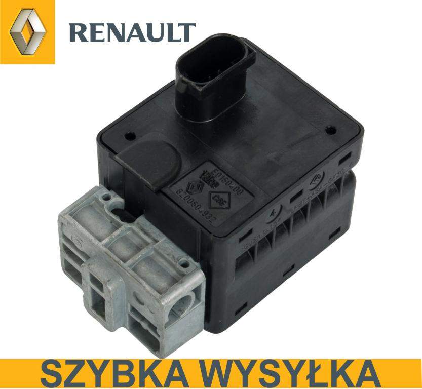

    Hello, I have a problem, the car after inserting the card into the reader does not respond (only the message is displayed: Turn the steering wheel + START but I have already tried it. The worst thing is that no counter-lights ignite when inserting the card (do not arm, hear the unlocking of the steering wheel)
    I would add that the battery is functional, I checked both cards in the reader, no difference. I suppose the reader fails and my question is whether it is possible to disassemble it or check it in some way?

    Yes, charged. What do you mean bolt? Only if it was connected to the steering wheel lock, at least after inserting the card should I do a test of onboard systems, etc. and here I hear nothing
    I added a photo in the attachment, was that what you meant?
    • Renault Megane III (2011) - No response from the card reader, does not start blokada-kierownicy-renault-scenic-megane-ii-nowa-3726331073.jpg (49.38 KB) You must be logged in to download this attachment.

    That was what my friend meant. I had such a case in Scenic. There was no response either, and the message was "steering locked". And there is no characteristic buzz for unlocking the steering wheel?

    It could be this blockage

    You need to remove the steering wheel cover underneath and there I will locate on the steering column. When you unscrew it, be careful because in Scenic I had a left-hand thread and I needed a torx t30 or t40 I don't remember exactly. But if the bolt is damaged, it should throw an error after connecting to the computer

    The test would not be complete. A broken lock will not let you through. You can still try to move the steering wheel, but after what you write, I bet on the bolt.

    The problem is solved, the service is replacing the lock module with another one, used and programmed, the second matter is the replacement of the cable bundle that has broken due to friction
