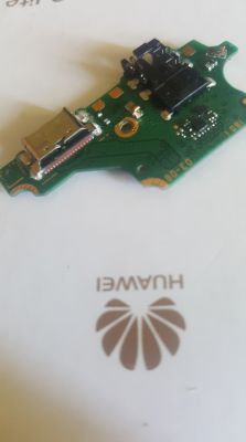

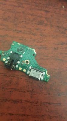

    Hello. If this is the wrong department please move it.
    I have a problem with the huawei p20 Lite, namely when I connect the usb board (photo below) to the main motherboard with the main tape (the black one), the gsm network disappears and writes that there is no coverage or emergency calls. The phone charges normally, when I connect to USB, the computer can see the phone, but the huawei program already has problems.
    Tile photo:
    Huawei P20 Lite: GSM Network Disappears when USB Board Connected - Possible Short Circuit?
    Should the USB pin connector be this color?
    I'm not sure but the phone was flooded.
    Please tell me what the fault may be, maybe a short circuit? Just what a short circuit.

    If it was flooded, first unplug the battery, and then wash the plate in isopropanol, oraw the charging module.

    But the main album too? Because so far I have washed this plate from the USB.
  • #4 17358250
    nutergsm
    Posts: 8429
    Help: 1034
    Rate: 1665
    Wash the entire disc, not the USB connector itself.

  • #7 17367194
    kamil2114
    Posts: 110
    Rate: 12
    The bottom plate has an antenna connector, so it must be connected to the range and if the signal disappears immediately after connecting the bottom plate, then some system has a short circuit.

    But on the bottom plate, yes?
  • #9 17369272
    kamil2114
    Posts: 110
    Rate: 12
    Yes, take the meter in your hand and measure whether any of the capacitors on the circuits are shorted
