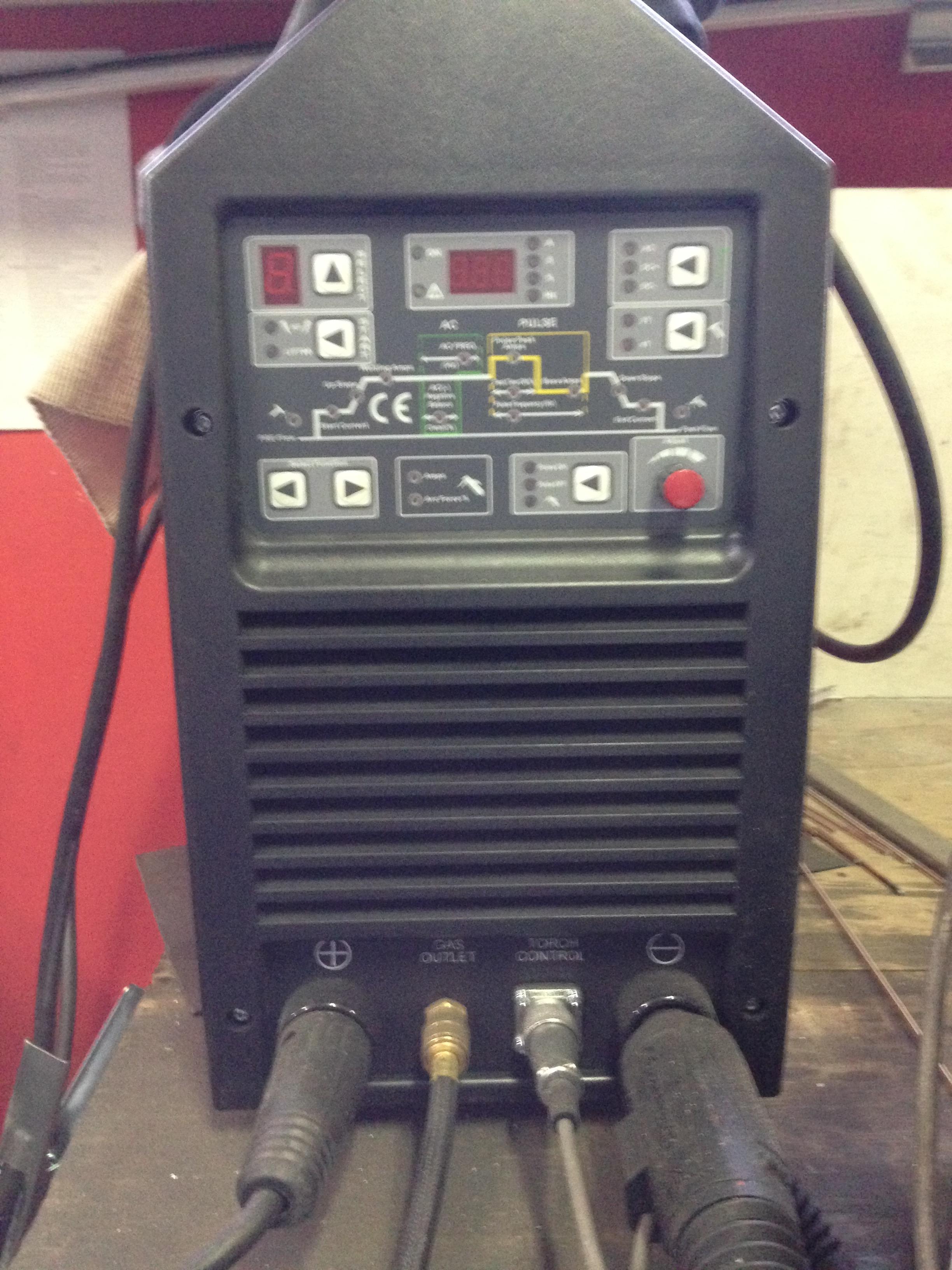

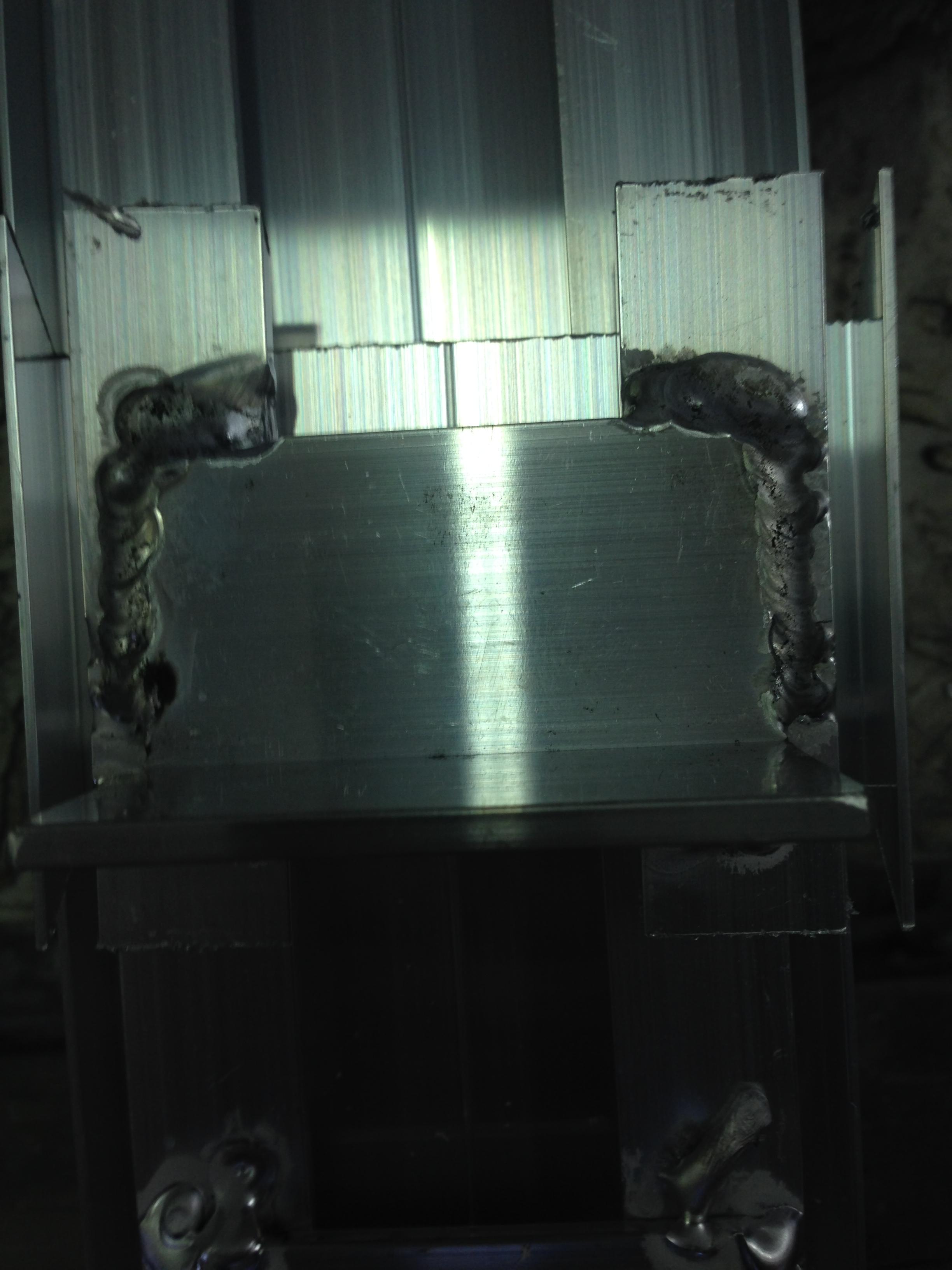

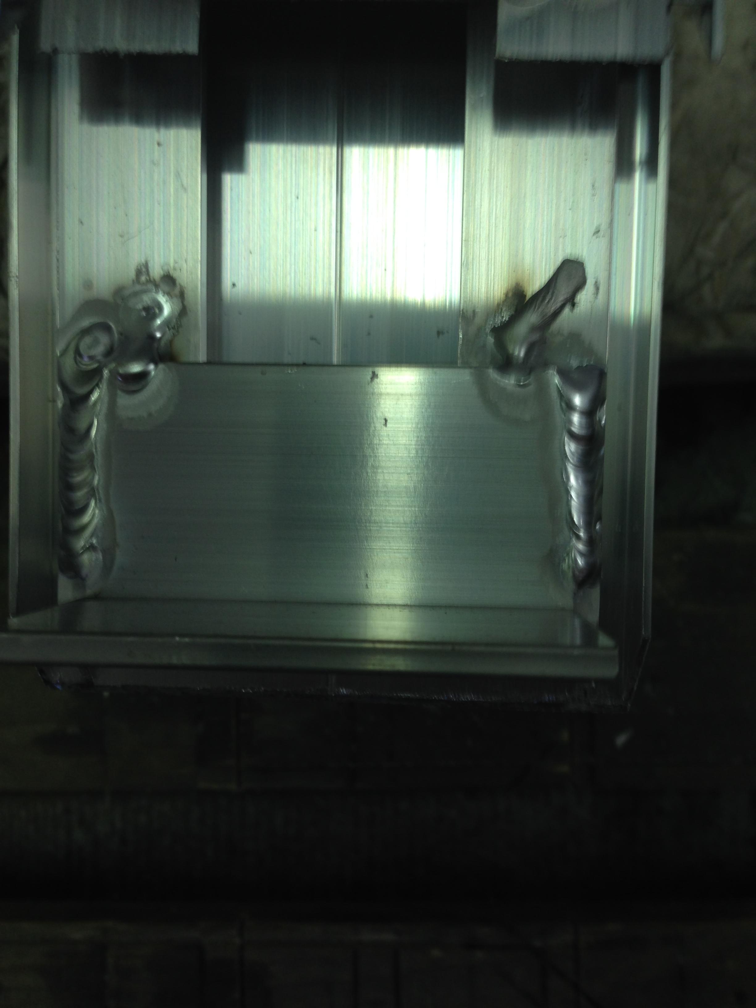

    I have been welding aluminum from time to time for several months, I don't have much knowledge, which is why I would like to advise you on what may be causing my problem.
    Is it possible that I got poor quality gas?
    I add photos showing the welds located on the old and the new cylinder, the parameters were identical, the material was the same, I did not even sharpen the electrode, only changed the gas cylinders.
    - the material was 3-4mm thick,
    - I welded at around 120A,
    -Hz I always have 150
    - balance set to 35 (on a 10-90 scale),
    - gas is Argon 4.8.
    I will be grateful for all tips, advice etc.

    Is. I use 4.9 myself and sometimes have problems after changing the cylinder. It only reveals with alu. The distributor justifies this by the fact that a small amount of gas should be left in the cylinder, nobody does, and in large companies, cylinders land under the cloud, with valves open. When filling, no-one sucks the contents, only pumps by weight, so you can hit almost everything including water. There are companies that have cylinders with built-in reducers and then you have a guarantee of purity, but financially it comes out ...

    many thanks for the answer, can you complain about such poor quality gas? does it not make sense?
    the pictures also show poor cleaning around the joints is also a fault of the gas or balance set wrong?

    Theoretically yes, but a lot depends on the will of the seller. Set the balance at 50%, frequency at max.

    Joining the discussion - the problem the author describes is a classic example of shielding gas contamination (usually by moisture or residual air in the cylinder). Although theoretically Argon 4.8 (99.98%) should be sufficient for basic work, with aluminium, which is extremely sensitive to oxidation, any deviation from the norm comes out immediately in the form of a "black tarnish" or "floating" of the arc.
    Some technical notes to check:
    Argon 5.0 is the standard for professionals: With TIG AC and aluminium, the difference between 4.8 and 5.0 is noticeable not only in aesthetics but also in arc stability. With 5.0, cylinders go through rigorous drying and vacuuming procedures before filling.
    System tightness: before you ultimately blame the gas, check the seals (O-rings) in the TIG handle and the tightness of the hose at the regulator. Often, when changing cylinders and jerking the kit, there is a micro leak through which air is drawn in (Venturi effect).
    Can test: do a short weld on a clean piece of sheet metal with a new electrode. If the weld is dull and you can see a wide band of soot around it, the gas is 90% 'baptised' or the cylinder was badly prepared.

    Also a classic symptom of an unstable source made in china! Also, water in the air and relative humidity above 75% can produce all sorts of interesting symptoms, especially when argon is excessively 'spared'.
