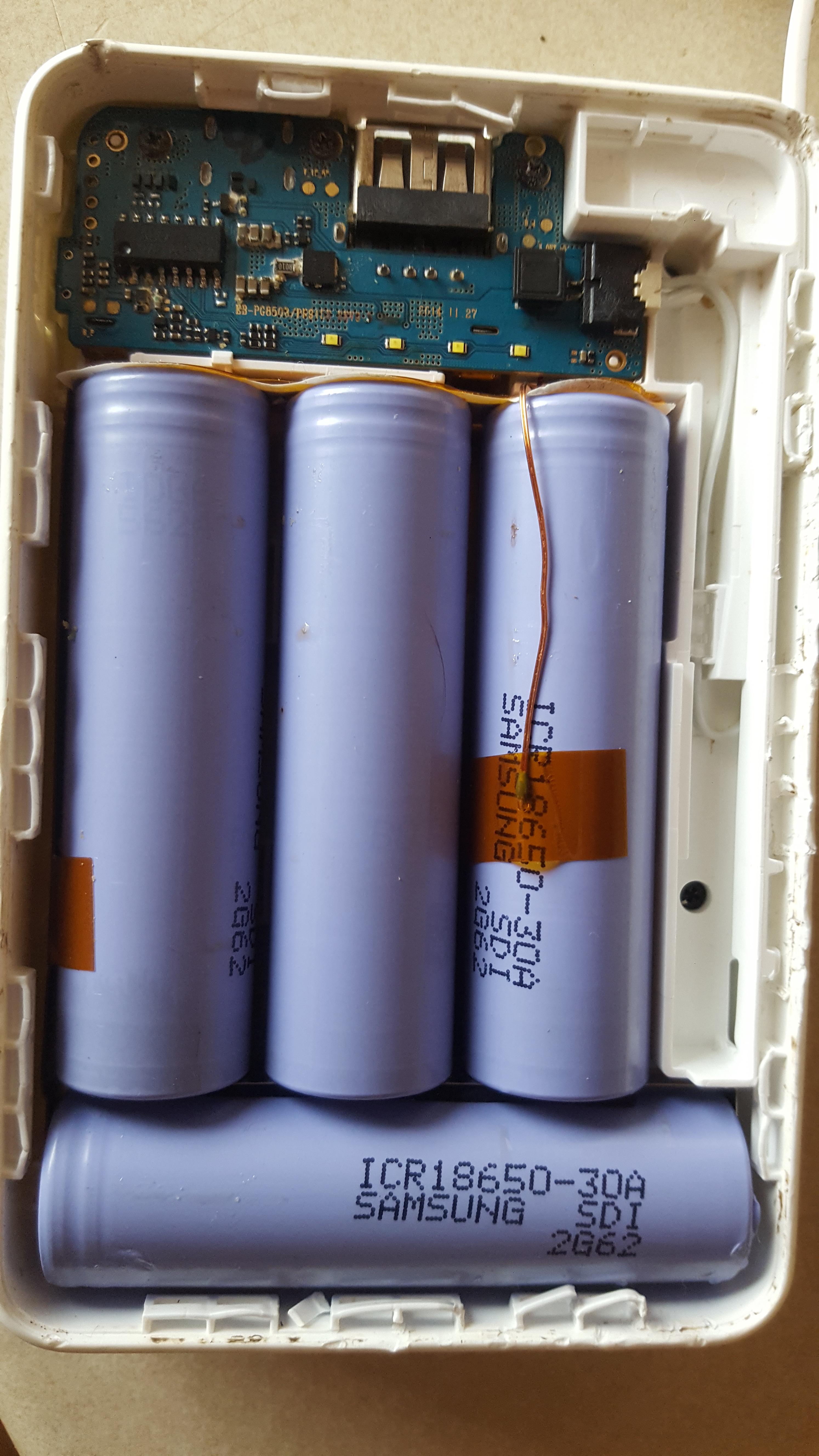

    I have a problem with the samsung 11800mAh power bank. The problem is that it does not charge, and when I connect the power bank to the charger and connect it to the phone from the output, it charges the phone and when I disconnect the charger from the network it will not automatically charge the phone anymore. The electricity flows so I don't know what the problem is and what could have broken. Has someone had a similar problem or is able to help solve it? best regards

  • #4 16275532
    Piotreek97
    Posts: 16
    The output voltage is 4.98V but my phone is not charging and when I connect the phone with a weaker battery it charges.
    This is how it looks from the inside Samsung 11800mAh Power Bank Not Charging: Phone Charges Only When Plugged, Auto-Charge Issue
  • #5 16275851
    mariann
    Posts: 3474
    Help: 549
    Rate: 646
    Is the voltage measured after connecting the phone? Did this power bank charge with the same cable in the past? Is the cable OK?
