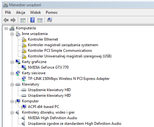

    Today I started my computer now for the evening and the same thing again. There are no exclamation marks next to the graphics card, but they are higher. Adds a snip from the device manager. I will check the second method you gave me. It will scan the computer with Antivirus. Then, if nothing works, I'm going to insert the Windows disc and choose the repair option. I have a question about this activity because I haven't used it yet. Will I lose my files in Documents, Installed programs?

    There are no drivers from the motherboard.
    I can never guarantee you that your documents will be safe during system repair, but that also applies to system recovery. Better to keep them on the second partition.
    I am not able to help you because you do not do the activities I am writing about, good luck.
    Install drivers and scan for malware with FRST
